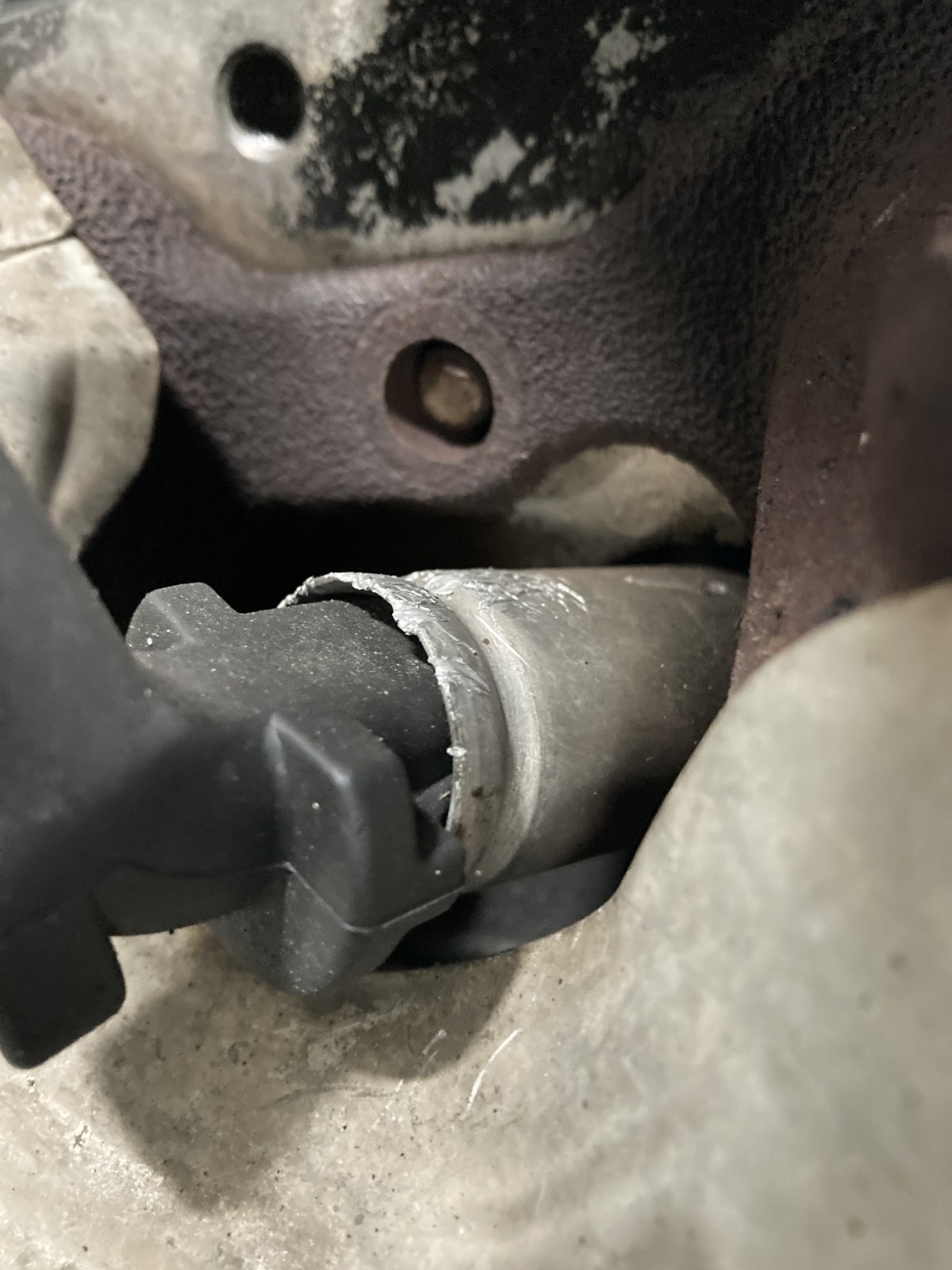

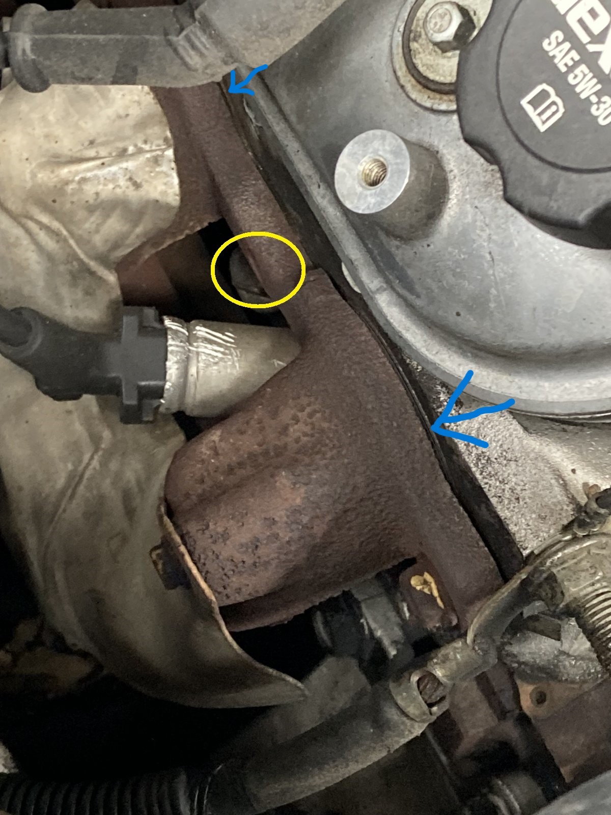

So these come with gaskets installed behind the manifolds? I got one broke off on the pass side front.
View attachment 432492View attachment 432493
Yes OE uses a MLS (multi layer steel) gasket there. They make other types of gaskets to use but I'd stick with OE.
That bolt looks like my drivers rear bolt. I plan on removing all bolts and if need be the ones at the collector/Y-pipe to get enough room to tack weld a nut over what's left of the bolt. The heads are aluminum and these bolts shouldn't be torqued too tightly (15-18 ft lb) but they corroded due to different metals. Ya know, that steel into aluminum thing happening.

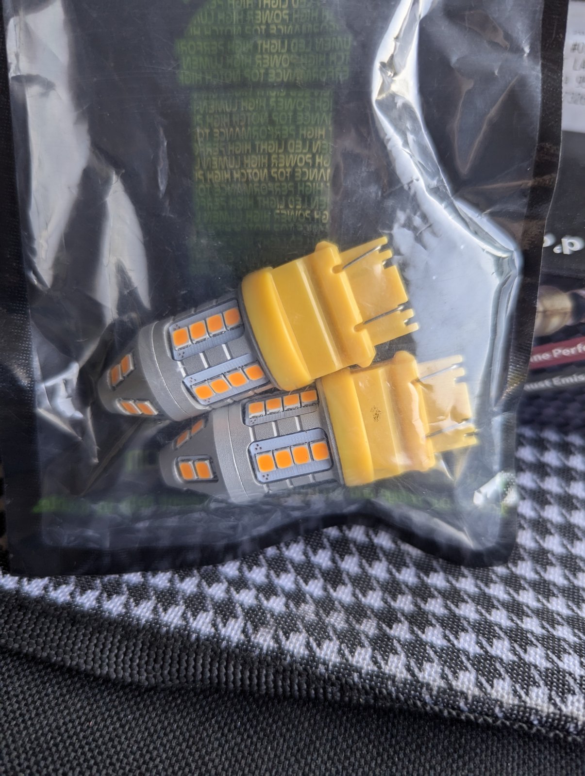

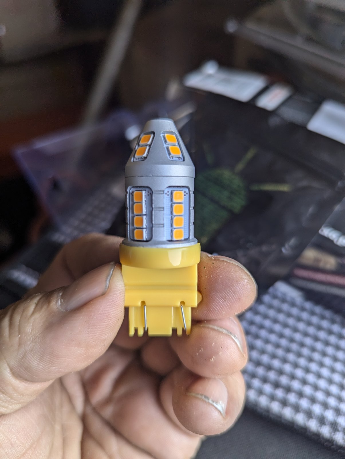

I use a amber LED and resistors, thought about switchbacks but they seem unreliable atleast that's what I gathered from poking around
getting the resistor wired correctly was a hoot

those led's looks serious, but you say you needed a resistors? I'm guessing to stop the fast flashing?
30,578
48,070
ha.. you're right. I forgot about the running/parking lights.
ya, led's will hyperflash, some bulbs now have resistors built in but I never found any for the yukon (that worked), I did for the silverado which was a stroke of luck because there is no way to install resistors the headlight assembly is all integrated with it's own circuit board.
