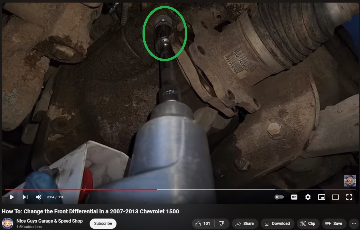

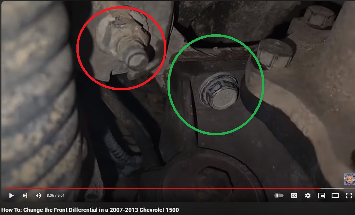

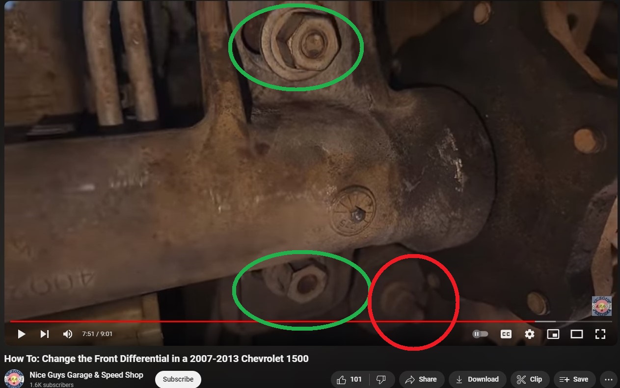

So there are bolts that go through the diff housing themselves into the diff mount brackets aren't there? Then the diff mount bolts are different? I was under the understanding the bolts going through the diff housing into the brackets were threaded holes with no nuts and the diff mou8nt bolts had the nuts? I am pulling mine out soon so I am trying to clarify all this.
There are four mounting points that hold the front diff to the truck. On the driver's side there are two frame mounts that have bolts pointed down, with nuts accessible from underneath. The bolt heads are (for now) very hard to access.
In the videos I watched to prepare for this they make it look easy (it actually is), and just zip them off with impact guns. For whatever reason the nuts only loosened a little bit, free-spun to the moon.
The passenger side nuts came off easy-peasy. They actually attach to a intermediate, short, fore-aft mount that is itself bolted to the frame. Ignore that intermediate part, and just unbolt the diff.
There is access to put a socket on top of one of the free-spinning (driver's side) bolts, but I'll have to remove the wheel to have any hope of using two hands to reach both sides of the bolt. The other bolt is buried under the steering rack, and I didn't even bother trying to figure that one out. It's like 95 degrees with all teh humidity here. Like I said before, it'll probably have to be addressed when I pull the engine.
What if you use a pry bar to torque the housing laterally and put clamping pressure on the bolts?
This is one of the videos I was referencing planning for mine. He says to remove the crossmember as well.
So the bolts I circled in green are the ones I thought were "fixed" or "threaded" holes that would not spin out on you or require a wrench on top? The ones in red I am sure they will spin.
