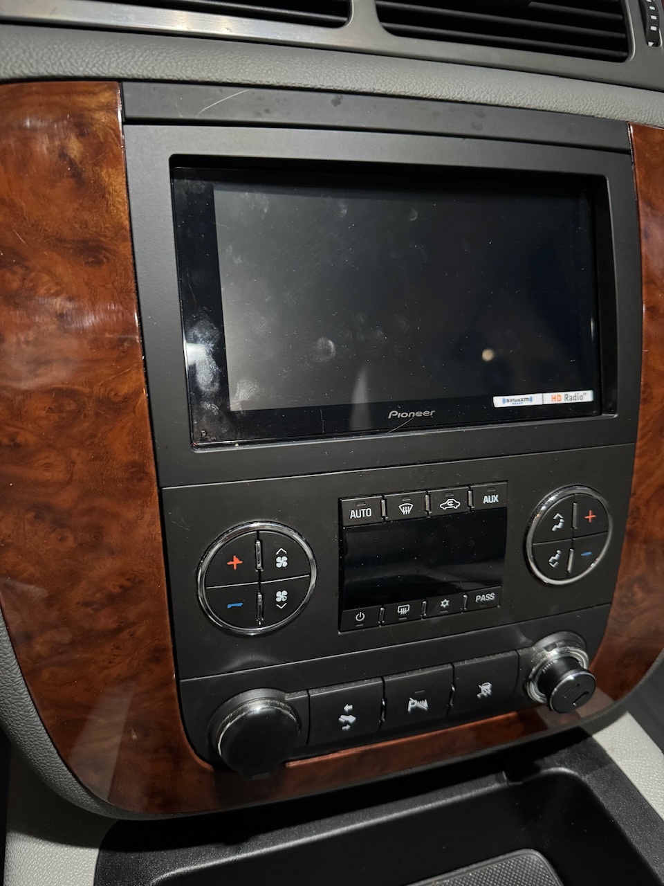

All the stereo bits are sitting on the bench waiting to be installed once I finish the paint correction. Not sure if I can post a link here but its the
Pioneer DMH-W3050NEX​
That I got from Crutchfield. Nothing too over the top, my crank it up days are over. I’ll reserve the right to add a sub later if i can find one that doesnt take up real estate. Might look at the under console ones but that’s down the road. I listen to a lot of am radio and podcasts nowadays but the OEM unit and speakers are just so garbage plus the wife wants a camera in addition to the sensors.

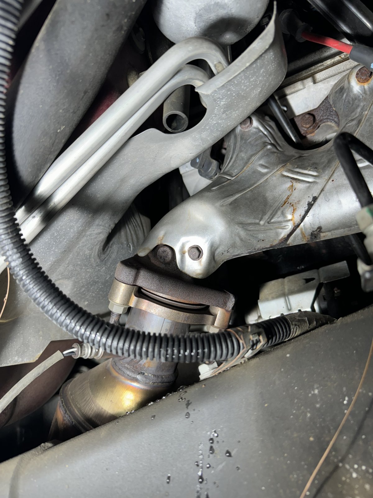

Replaced the plugs. No threads pulled out of the heads, which was good.
#8 was tough. Just pulled the wheel and liner and still had trouble getting to it because of the rear heater lines.
Someone wanted a pick of the head unit. And I installed new GTR LED Minis in the headlights

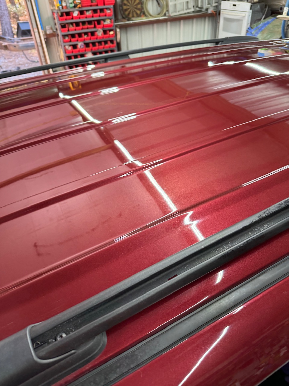

And finished wet sanding and polishing the roof.
