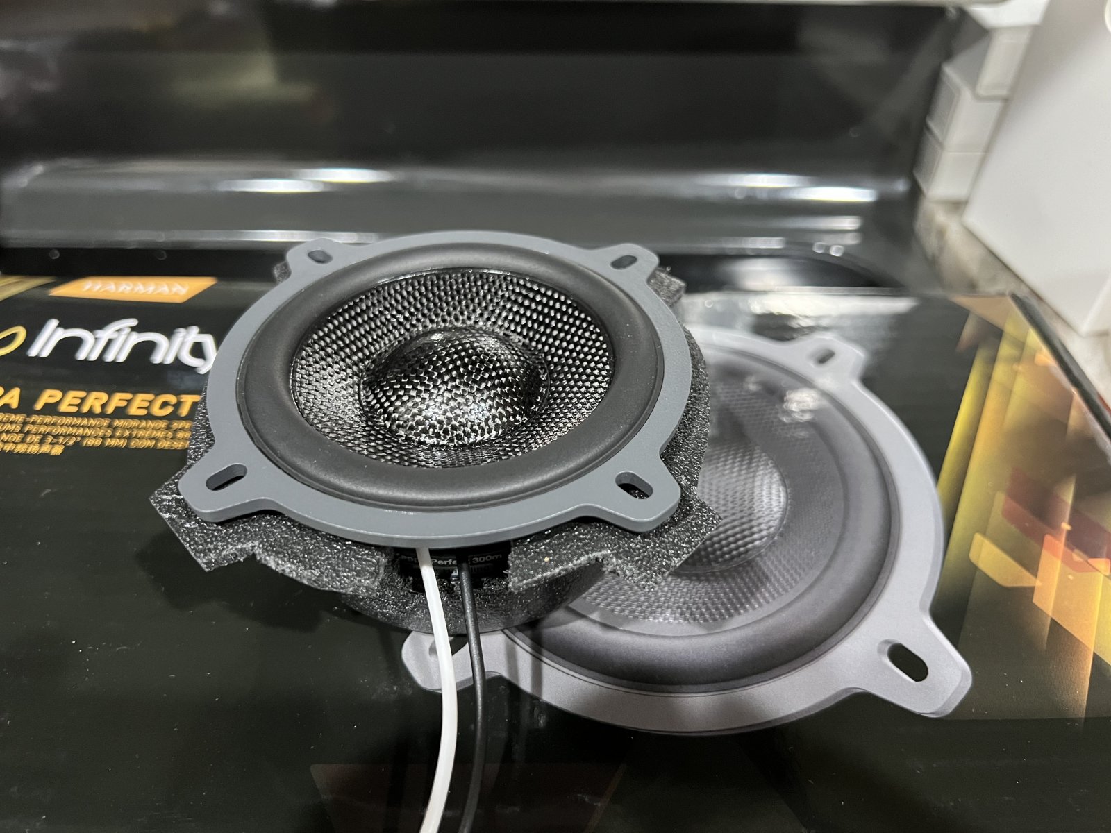

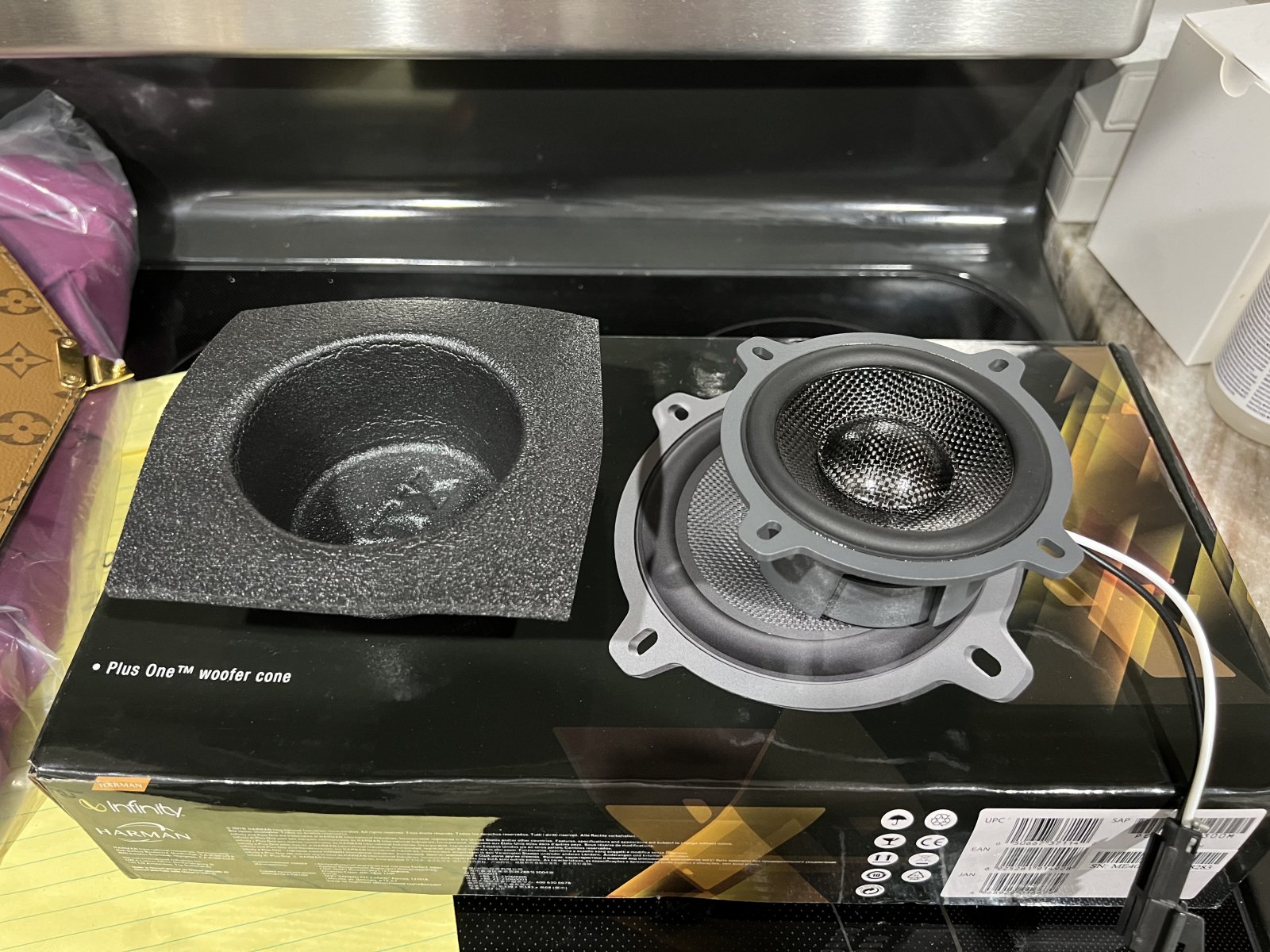

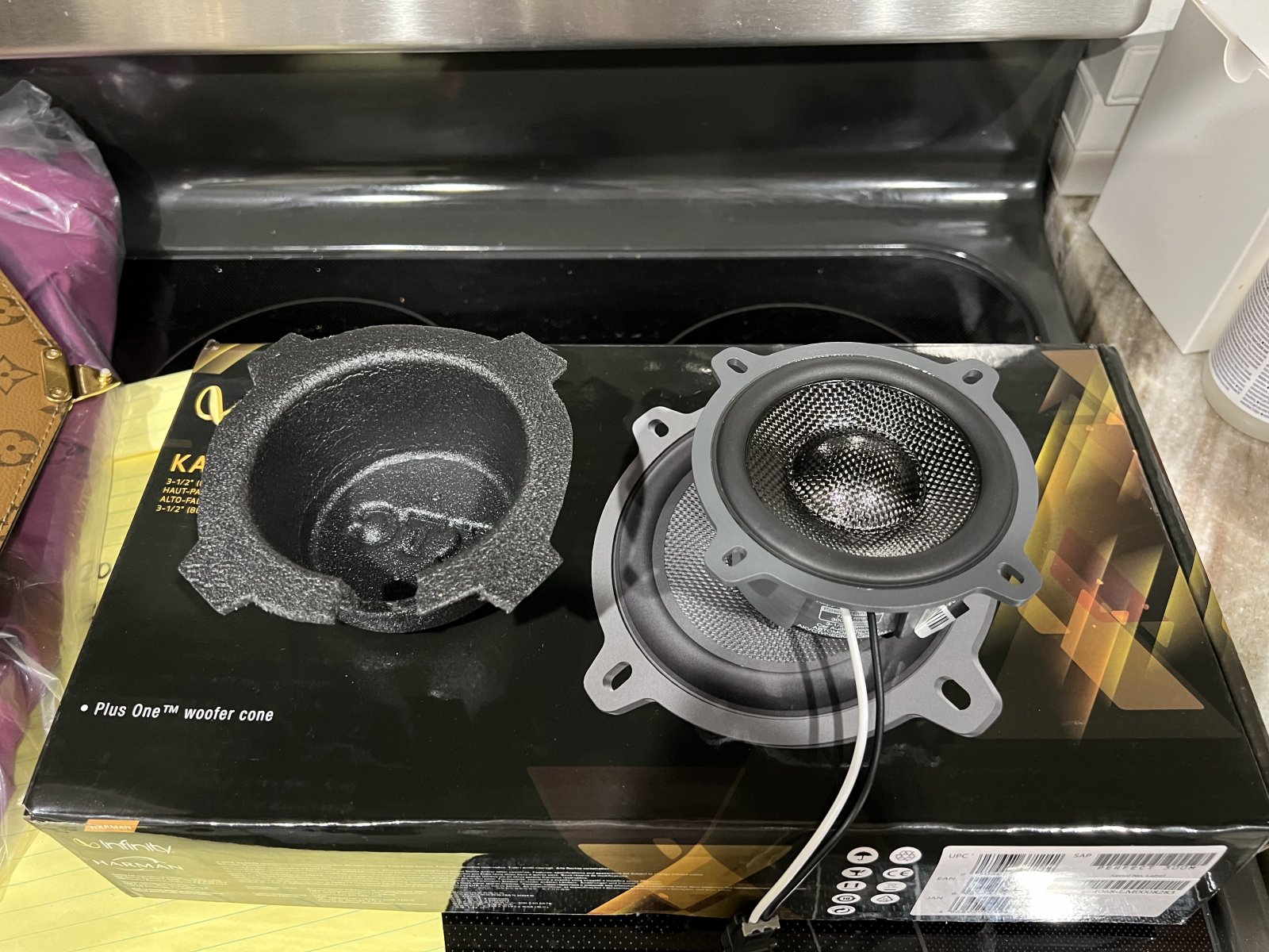

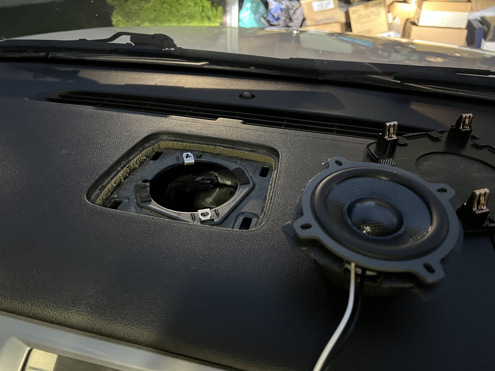

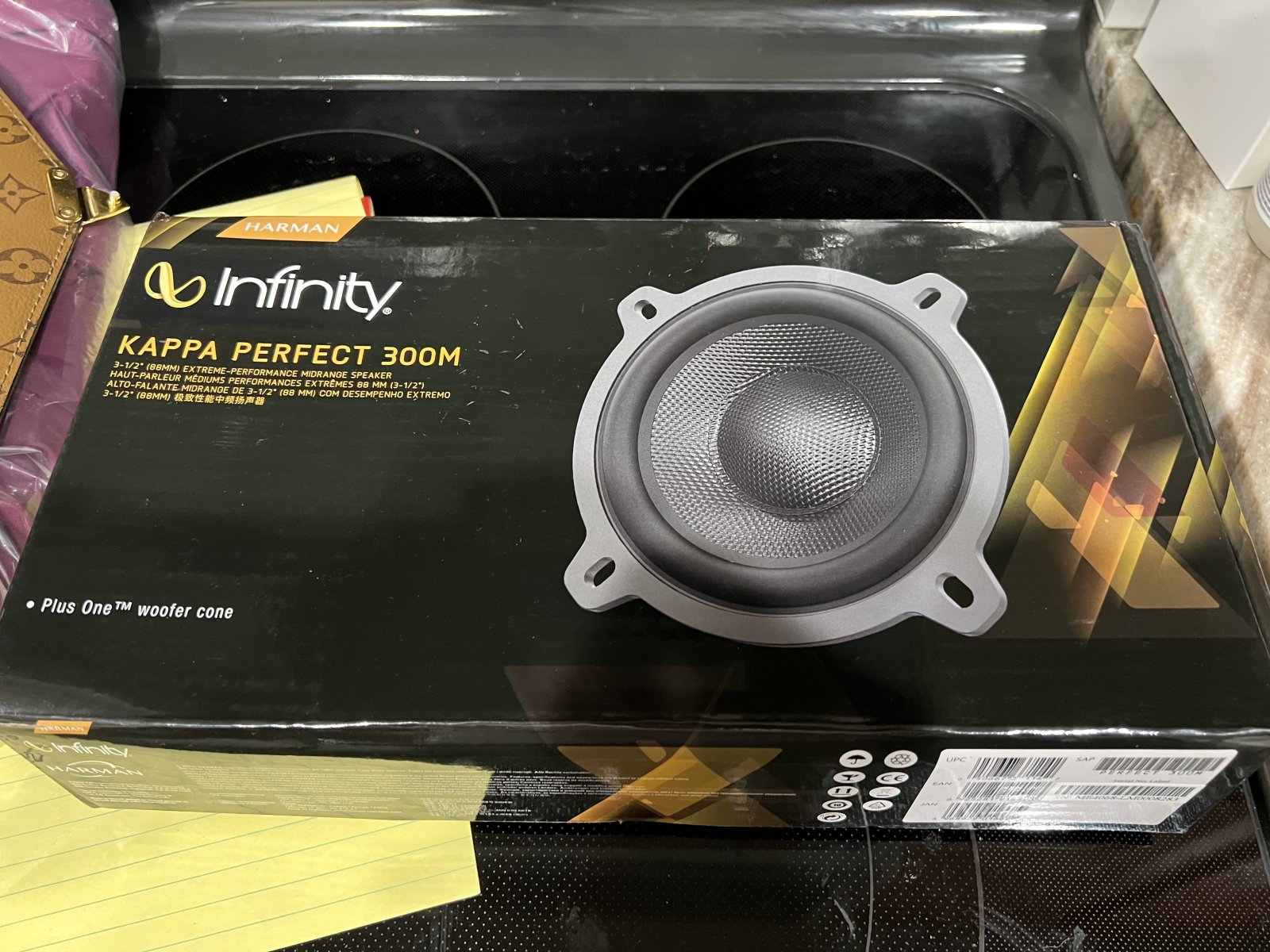

Dusted off my car audio hat and put it on. Something that I haven’t done since high school/college.
Had a blown center dash speaker in my ‘13 Escalade ESV with factory Bose. Did some digging on the line and found the center dash speaker is a 3.5” mid and is 3.35 ohms. 3.35 Ohms is very odd (as are all the Bose speakers). I wanted to find something as close to that as I could and found these:
They’re discontinued, but sonicelectronix had (2) sets in stock at the time. They’re 3.5 ohms so I figured that was probably as close as I was going to get.
Picked up some GM speaker wiring harnesses and some 3.5” foam baffles.
Turned out great! This 3.5” Infiniti blows the old 3.5” Bose dash speaker away! Now I’m just worried that I’ve opened Pandora’s box because I just know how much better the stereo could sound if I upgraded all the Bose speakers. Other upgrades are a higher priority…
Some pics:

Great choice going with the Infinity speaker.
I have never been a Bose fan.
If I wanted decent sound on a budget I would choose Polk Audio over Bose any day.
My daily driver Kia Optima has the Harmon Kardon stereo and I think it blows away any factory Bose setup I have ever heard.
Plus, I can pause and rewind live radio! :cool:

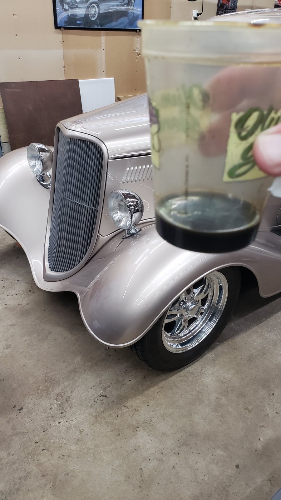

Just replaced the passenger fog light bulb. While I was doing that I also decided to check/drain the catch can.
Nice hot rod.

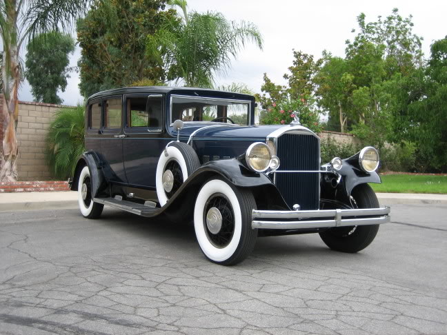

While I appreciate the craftmanship and skill needed to do one right, I prefer bone stock prewar cars.
You know, more along these lines.
It's in my garage, right now.

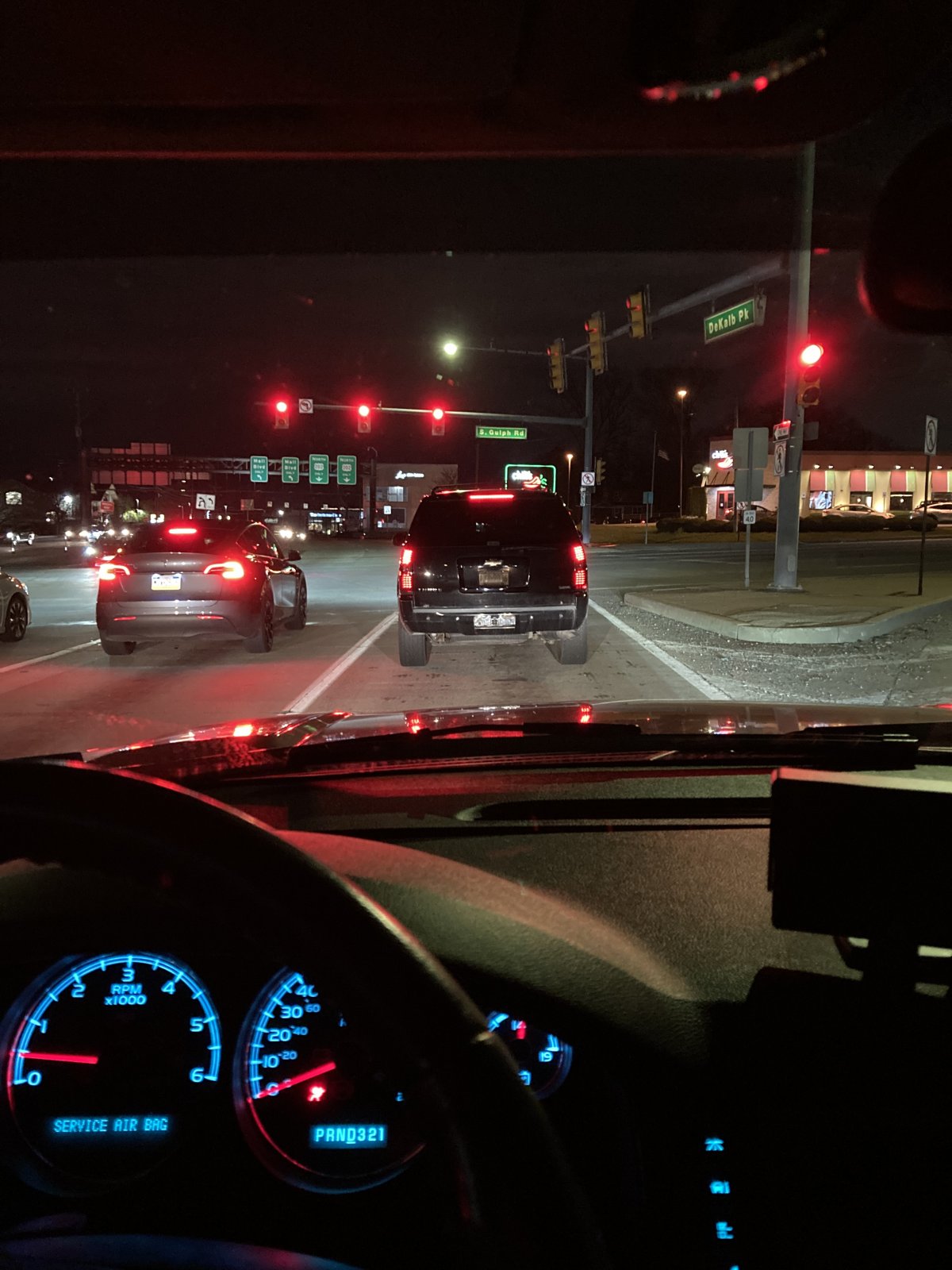

Yeah I blew the fkn doors off that Tesla BTW,,,

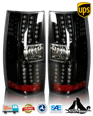

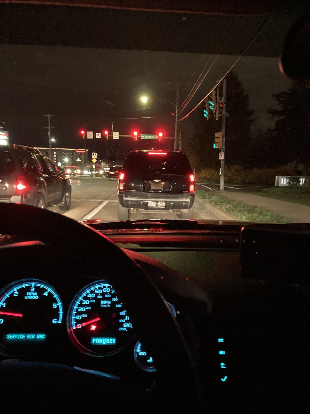

What kind of LED taillights are these?
View attachment 425773View attachment 425774
To me they look like these:
