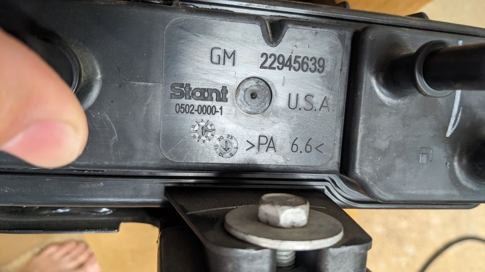

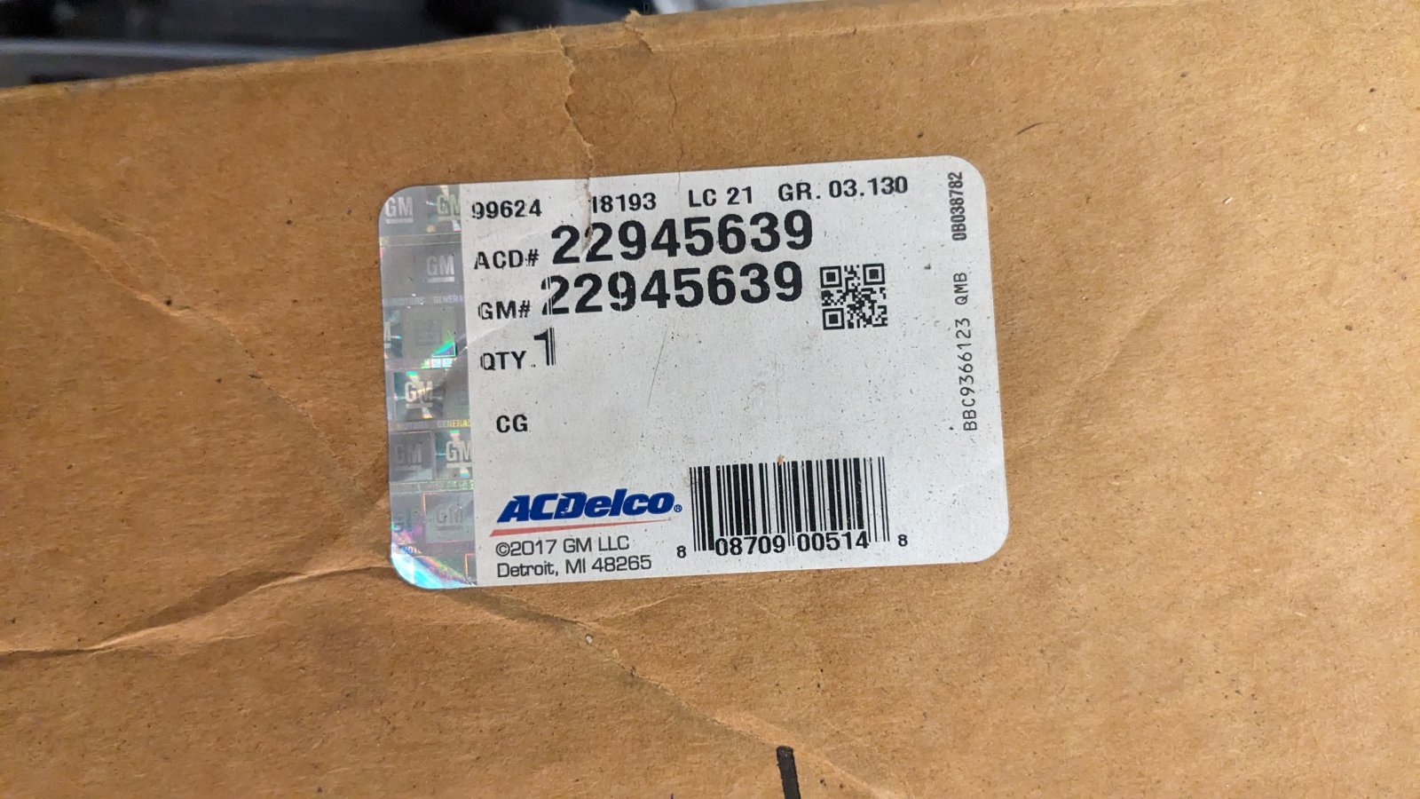

acdelco? The one I ordered says GM genuine on Rockauto. I wonder what the difference is.
huh. I was curious so I double checked.. yeah, acdelco.
maybe it's different somehow? no clue.

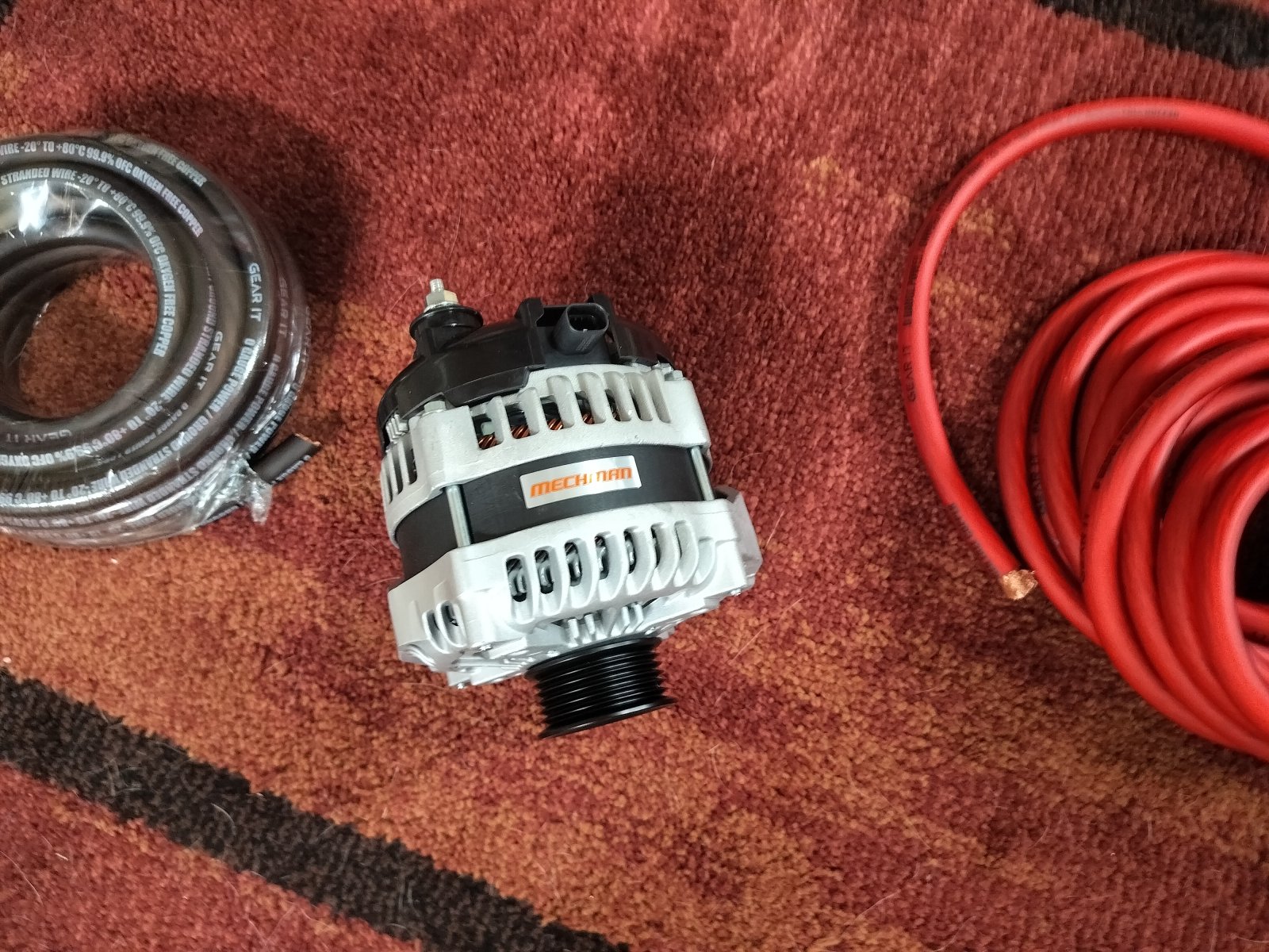

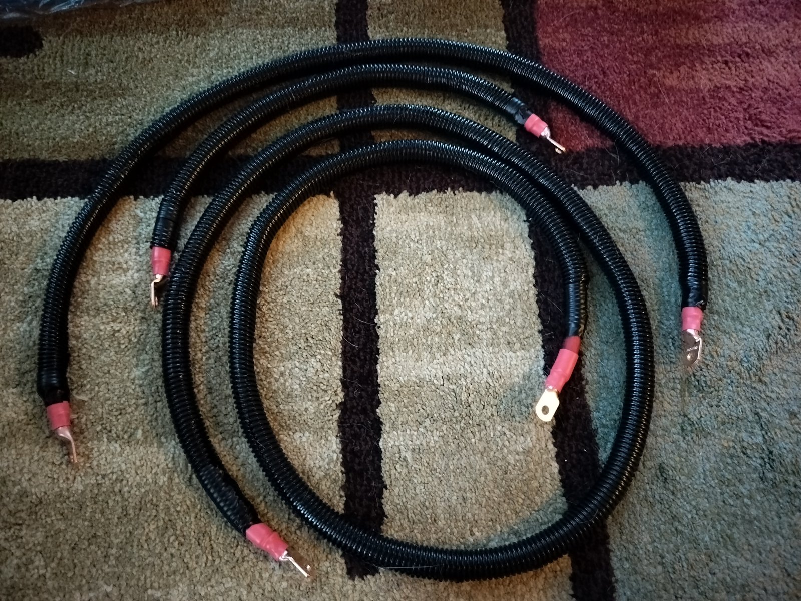

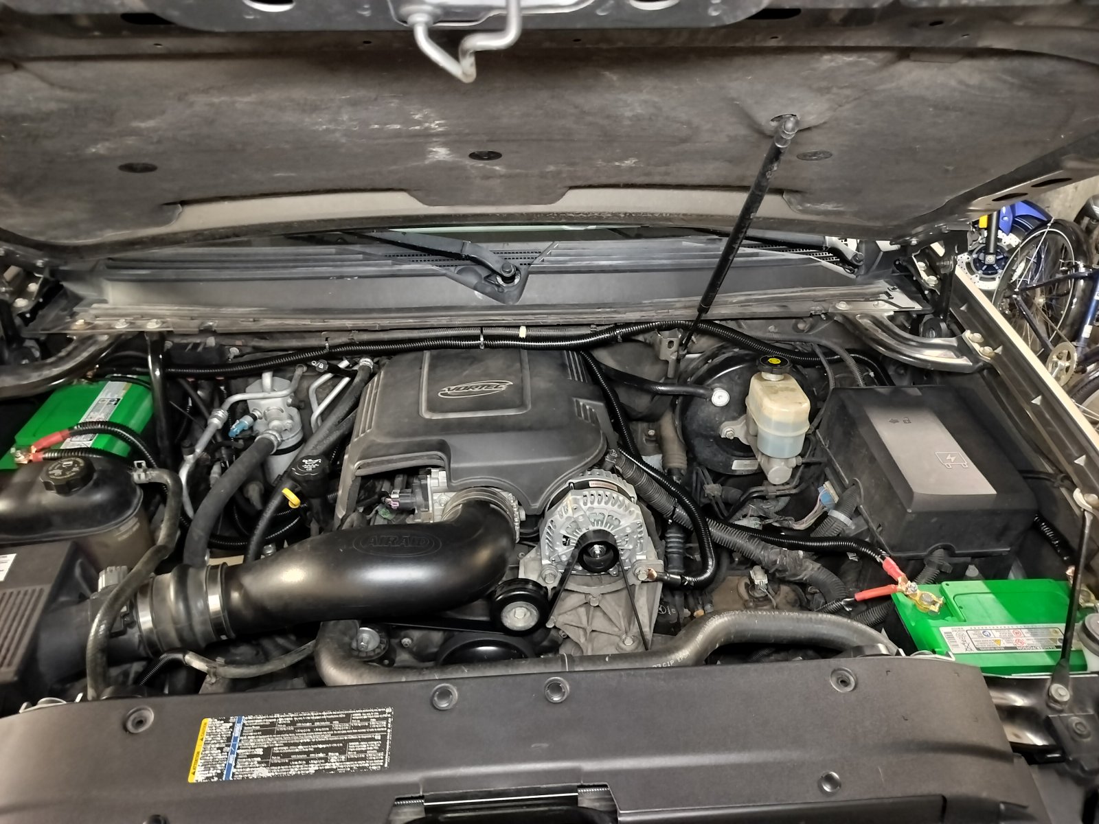

looks right, but where is that ground wire from the alternator bracket going? I ran mine from there to the frame on drivers side.
I assume you ran it to the firewall?
It runs through the RVC sensor then to the negative side. It's how the instructions told me to do it. I still kind of find it odd..
30,566
48,044
I have both battery negatives connected together for the sensor, but the alternator mounting bracket ground that I added just goes to the frame.
I don't think that one has to go thru the sensor, pretty sure the sensor is just for the battery ground, otherwise all grounds would go thru it.

my alternator is wired to the main battery positive
then the battery posiitive splits to small fuse bracket/link to -vehicle main fuse box, etc
the battery positive also goes to the starter and then from the starter to the 2nd battery positive
main battery negative goes thru the rvc sensor to passenger side head and the litle 8 gauge goes to the passenger side frame
2nd battery negative goes to the main battery negative.
alternator bracket I added a ground to frame
everything works fine. been that way for 4 years now
previous to that I had the 2nd battery grounded to alternator bracket and frame like the early gmt800's only the main battery was connected to the rvc sensor
and both batterys had positive to alternator and starter.
but had a bad battery and while trying to figure out the issue just wired it as above and 2 new battery's and no problems since
