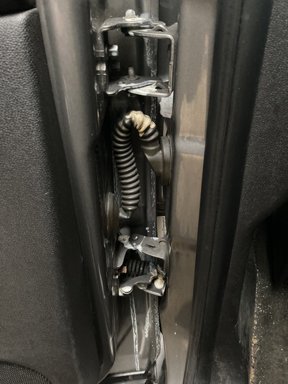

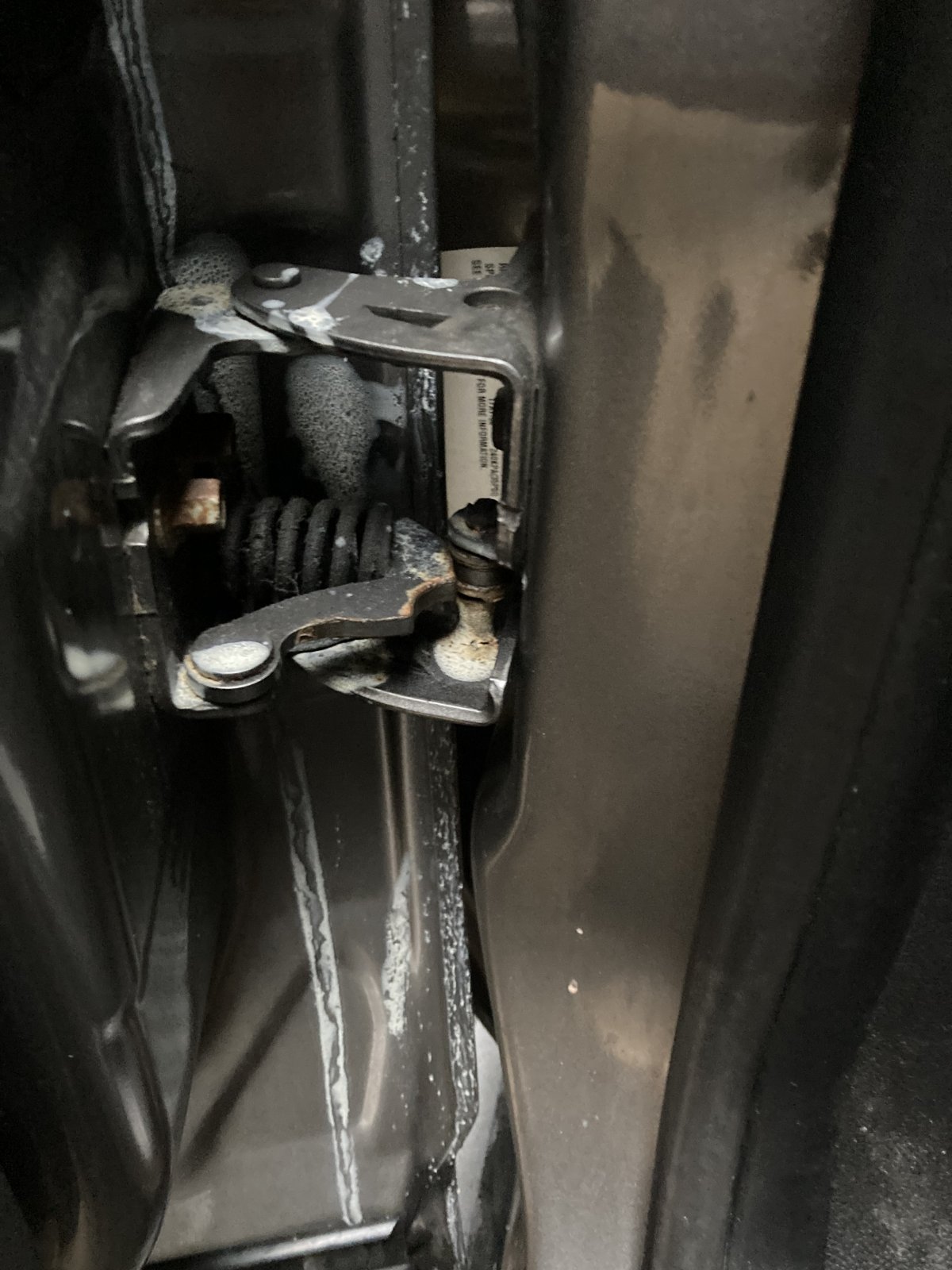

It's that hold door bushing! My driver side was worn so bad, it was off center. I had to pop the spring out to keep it from creaking.
Now I have a floppy door when open. I have a new door hinge, just need paint/install, BUT someone posted a cam roller repair kit not long ago..
j91z28d1
Feb 28, 2022
4,611
5,864
there's a tool for the spring removal.. it's pretty cheap too. I picked one up for my obs.
