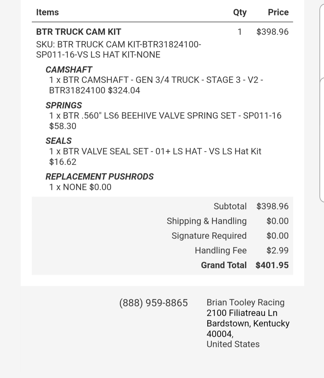

I have the BTR stage 2 combo in my avalanche. Same springs as well. I also have the trunnion upgrade but I think mine are the needle bearing type. The replace the stock bearing/bushing on your stock rocker arms.
You will need a stall as well. I did Circle D 26-2800 and it feels pretty good. A little looser than I really wanted but its fine.
