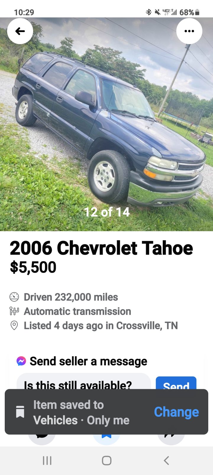

Please note I did not pay 5500 for this it was much less.

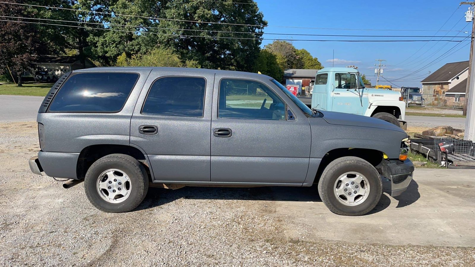

Step 1. Acquire tahoe. It had an immaculate interior. done

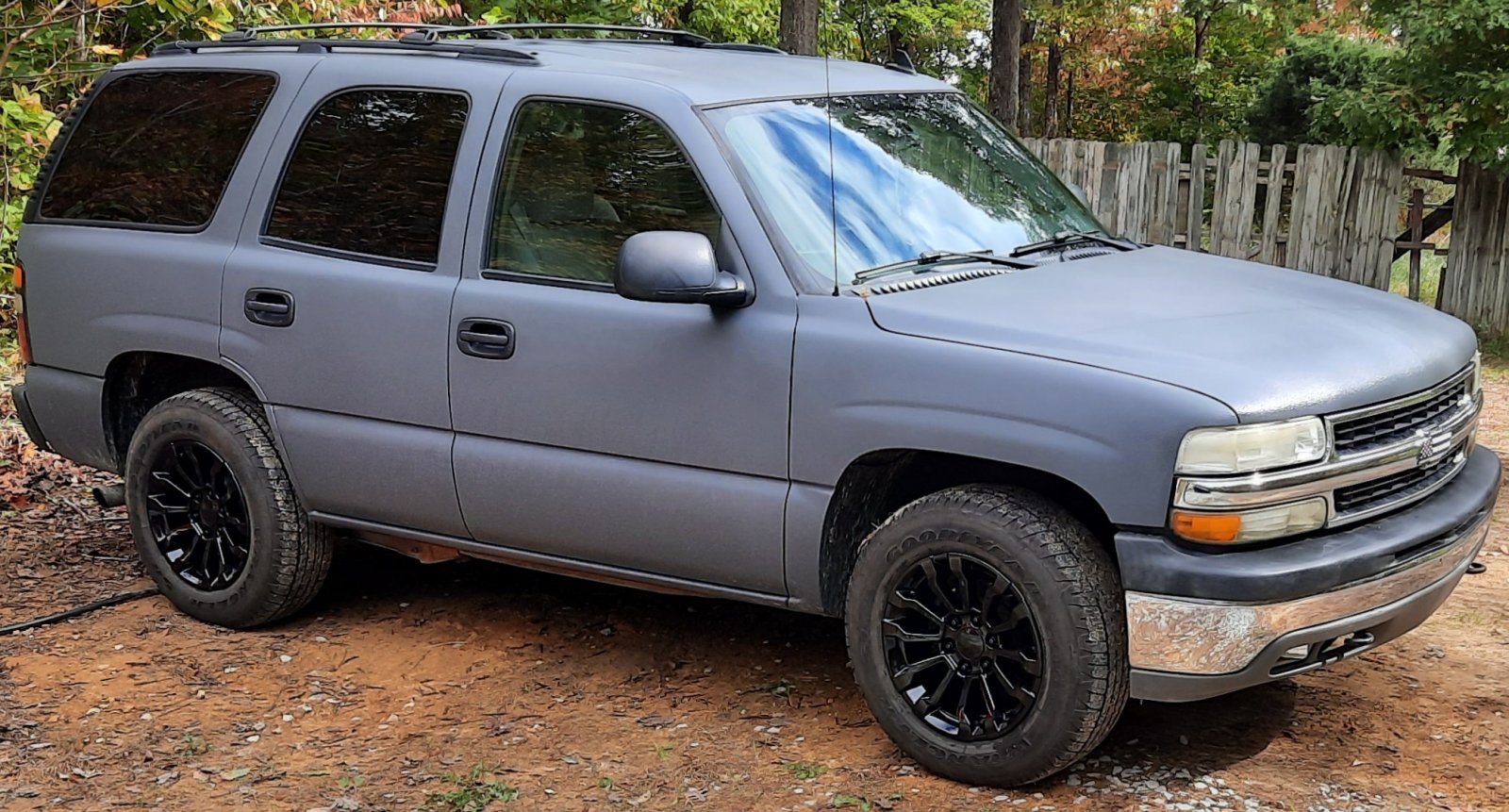

Step 2. Have it raptor lined in charcoal gray. done
Step 3. Acquire 265/65/18 tires done
Step 3. Acquire black wheels, tpms sensors, and lug nuts. done

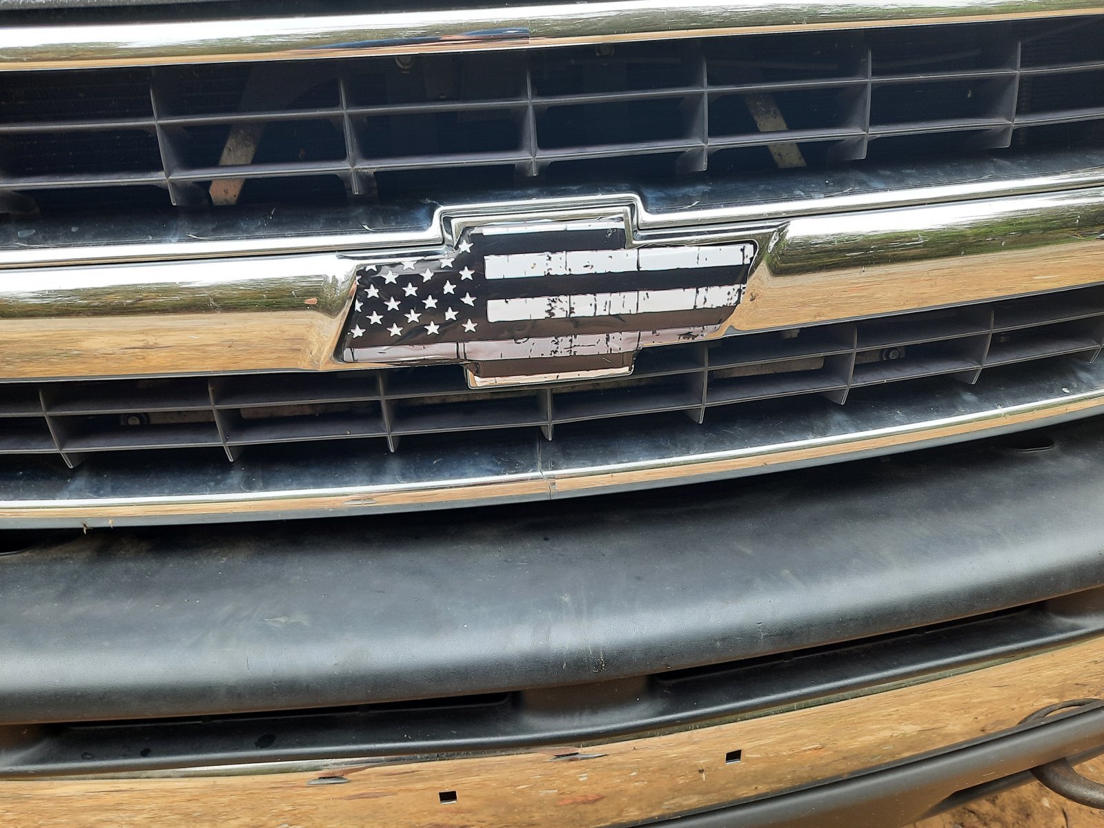

Step 4. Install thin gray line flag overlay on grill. Done

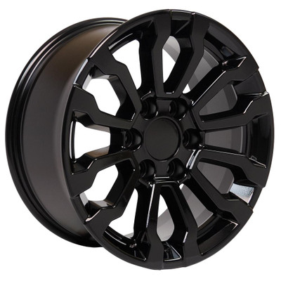

I'm going to put goodyear wrangler sra 265/65/18 on it with these wheels on it. Hopefully they fit. The wheels I test fitted and they stick out maybe 5mm.
The stock wheel offset is +31 and the stock wheel is 265/70/16. I'm hoping they will work and look good.
The offset on these wheels is +26

Apprehensive that these wheels are going to fit with 265/65/18s without having clearance or rubbing problems. I am beginning to second guess my choice and wonder if maybe I should have gone with 255/65/18s instead
I guess we will find out tomorrow.
21,278
30,213
Should fit, they are stock size on GMT900 Z71 wagons.

I like the Raptor liner. I’m considering it myself because it will hold up better squeezing between the brush off road. If I can find a shop at a similar price it’ll be a done deal. I *could* DIY, but I really hate painting.
I have tried my best to deliberately scratch it and it has yet to scratch.
That really looks good, I like it. I was strongly considering the Raptor Liner for my old F350 but I think I am going with Durabak 18 so I can get a smooth finish instead of the rough textured one and it is available in the two tone colors I need to match the stock paint. It is cost prohibitive to re-paint a 1994 F350 CCLB ( about 20' long) as it would be more than the old girl is worth. Seeing your Raptor Liner makes me believe it is the right choice.
