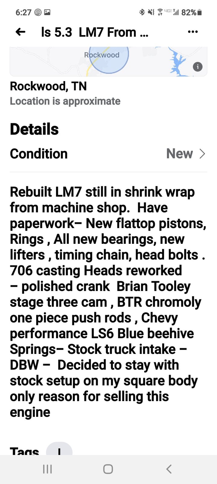

I'm going to probably put a built 5.3 with 385 horsepower in it from summit racing.

Here's the specs on the motor I'm getting.

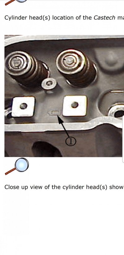

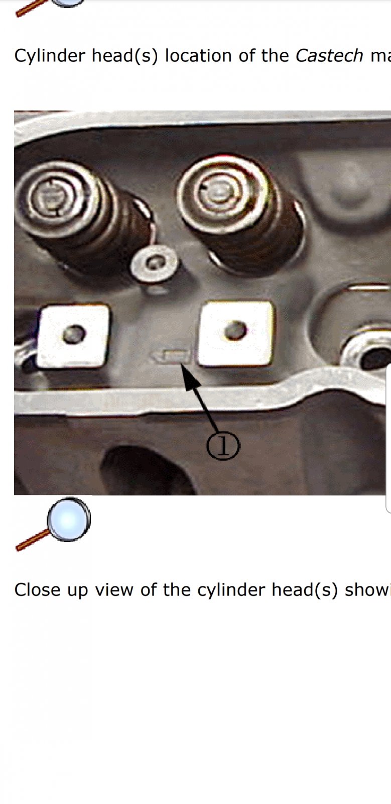

The motor is completely built so I don't know how to tell if they are the caltech or not. It says that the heads were reworked whatever that means.
You could always remove--or ask him to do it-- a valve cover and look. That little battery insignia will be plain as day on the head.
