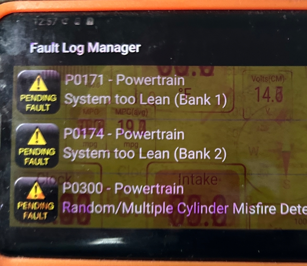

This is going to be a long one, but bottom line is, had some things repaired and now we get P0171 and P0174 (bank 1 and 2 LEAN). Trying to troubleshoot it.

When it's really cold, the idle will stumble until it warms up. If you put it in gear right away when it's cold, the check engine light flashes and you get "P0300". But once it's warm, that goes away. If I clear the LEAN codes and drive, they both go PENDING, and Bank 2 usually sets the code, and bank 1 stays PENDING.

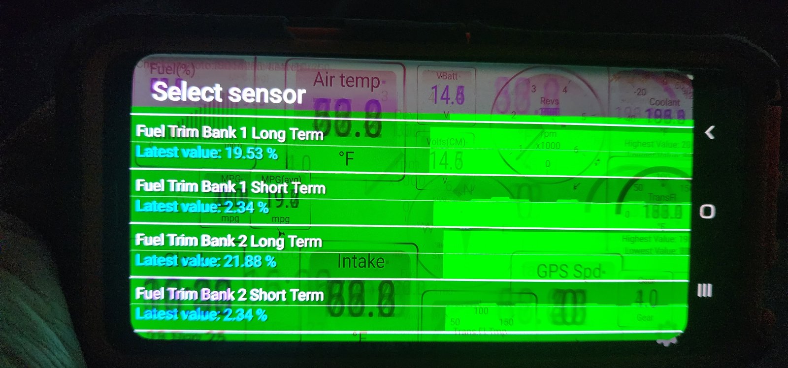

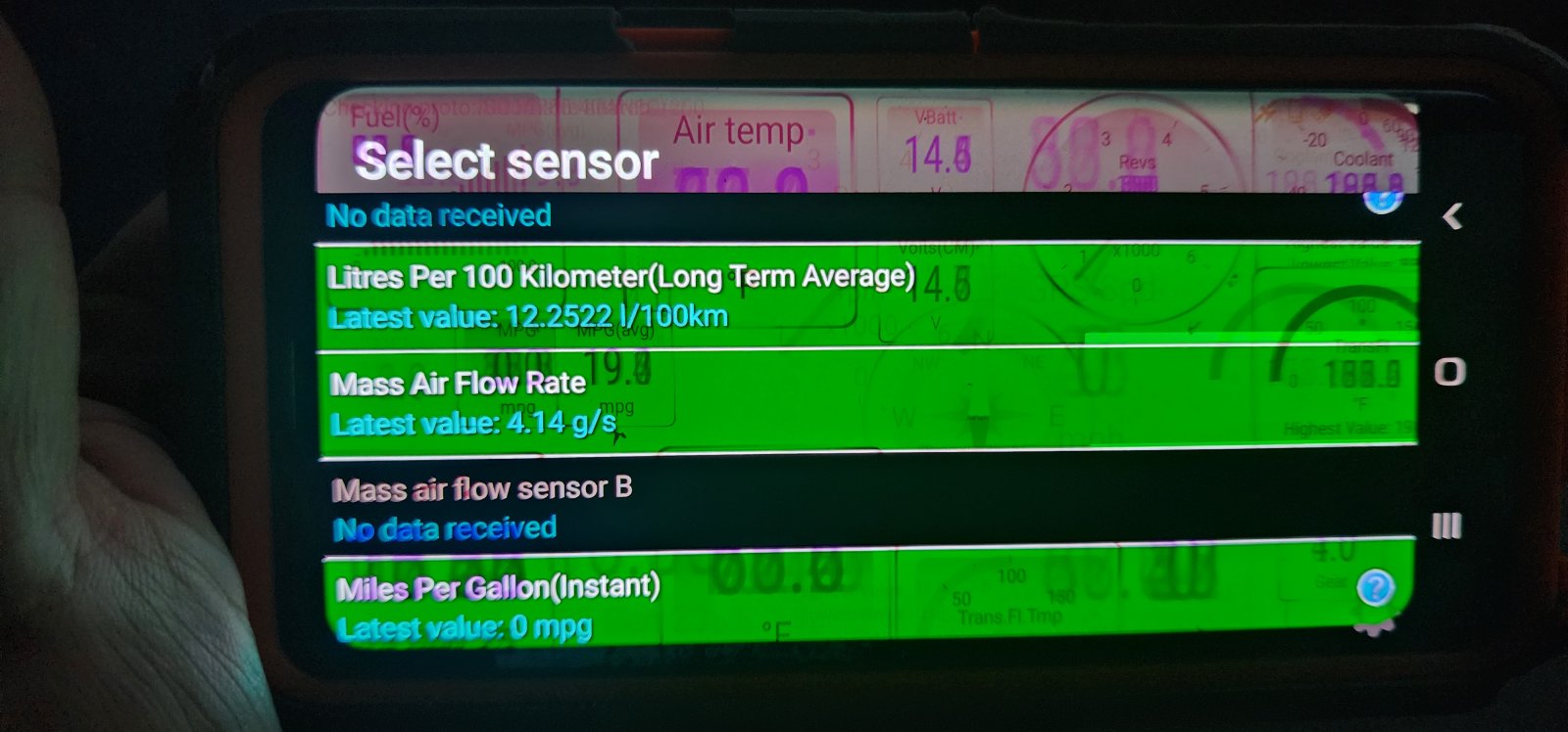

I took some fuel trim and other readings when it was at operating temp

Usually a lean on both banks within a few points of each other is fuel delivery issues, but your pressure seems okay.
Can you monitor your fuel trims at 2,000 and 3,000 rpm? If fuel trims improve (get closer to zero), then it's most likely a vacuum leak.

The MAF seems to be under-reporting. At hot idle it should be very close to the engine displacement in liters. E.g., 5.3 in g/sec. Recommend trying a different OE MAF.
