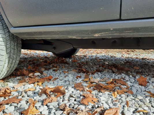

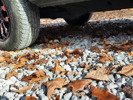

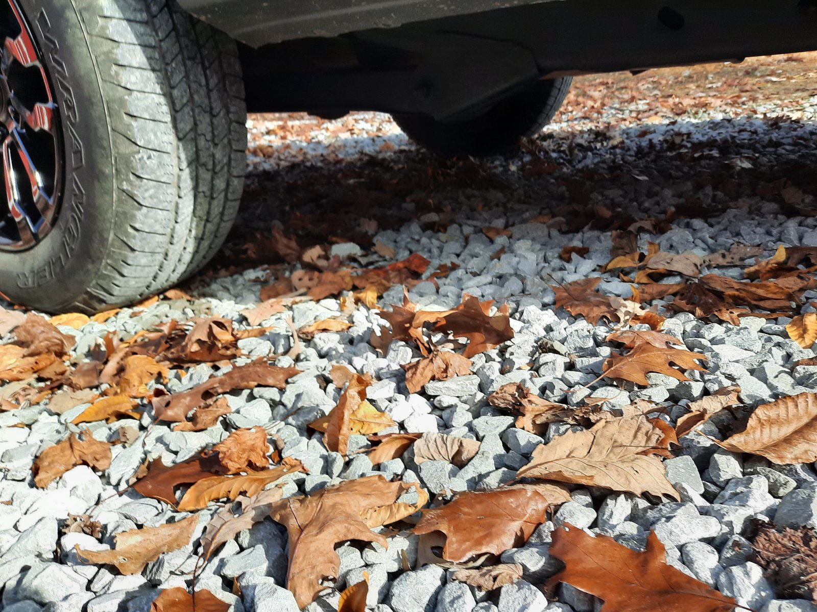

I painted the tahoe frame in a rustoleum 2in1 paint primer combo in matte black. I put on 3 coats of it and once it dried I put on 3 coats of rustoleum high heat ceramic paint.
