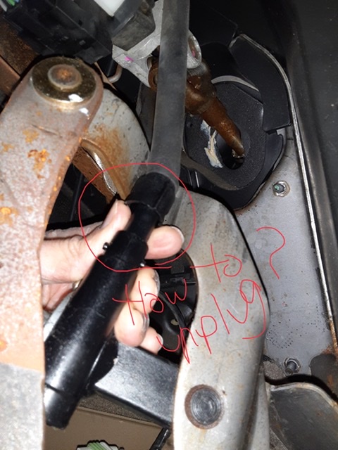

I’m trying to replace my accelerator pedal sensor assembly on a 2004 Yukon. This is an adjustable accelerator and the wire that I don’t know how to unplug goes to the adjustment motor. I’ll try to attach a photo that shows the problem area. Does this pull straight out? Do I need tools to unplug it?

I’ve figured it out. There are a couple of locking clips that you have to release to free up the motor wire.There is a little access opening below each nub that sticks out (the nubs that secure the protective plastic collar). I freed these clips by inserting a microscrewdriver (flat head) into the hole and pushing in and up. Once they are freed, the motor cable pops right out
