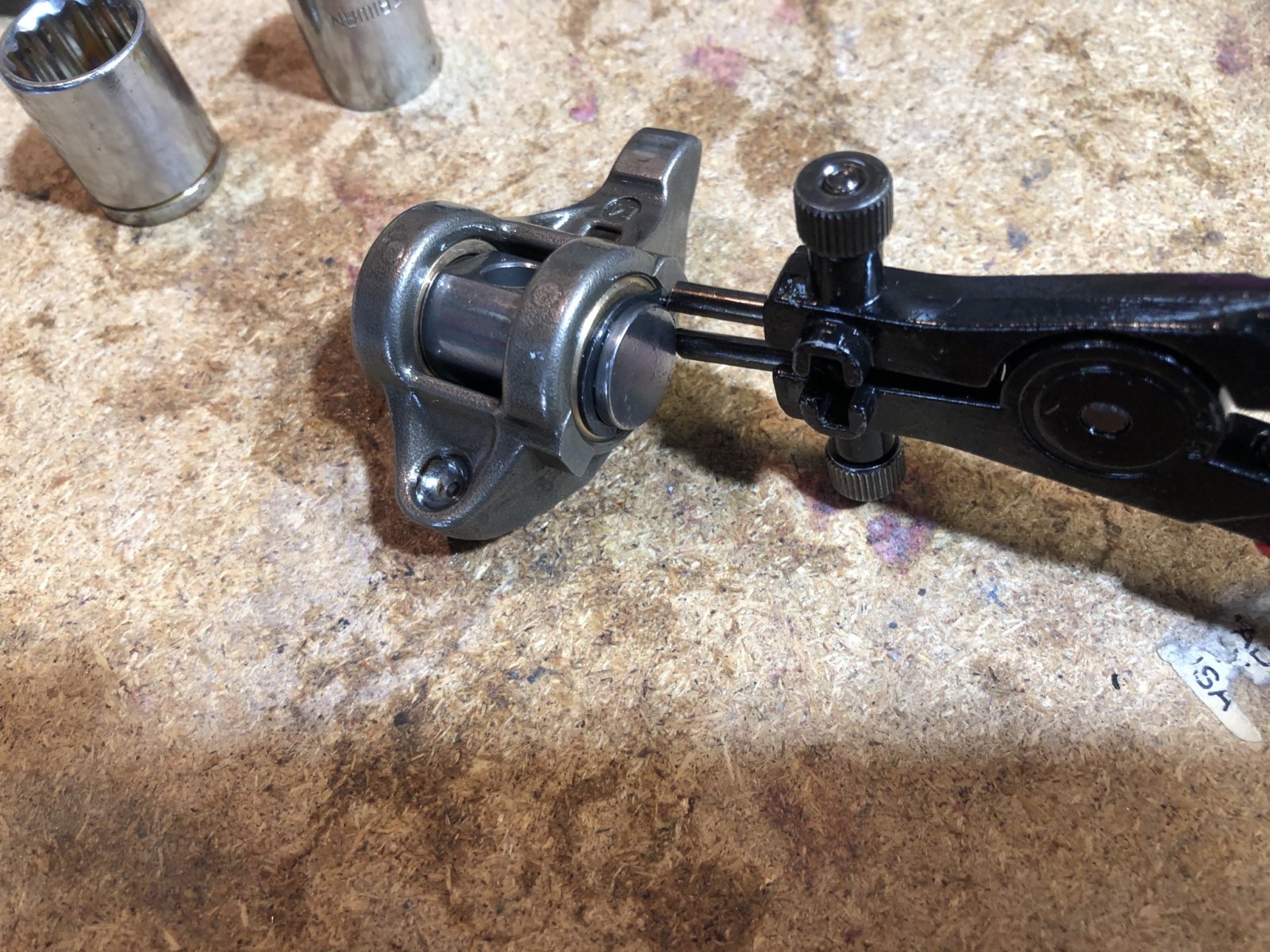

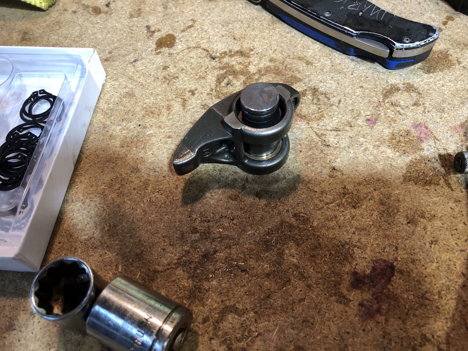

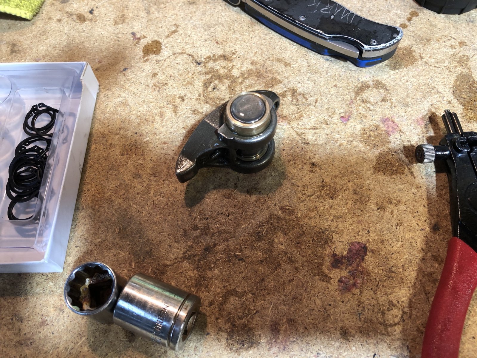

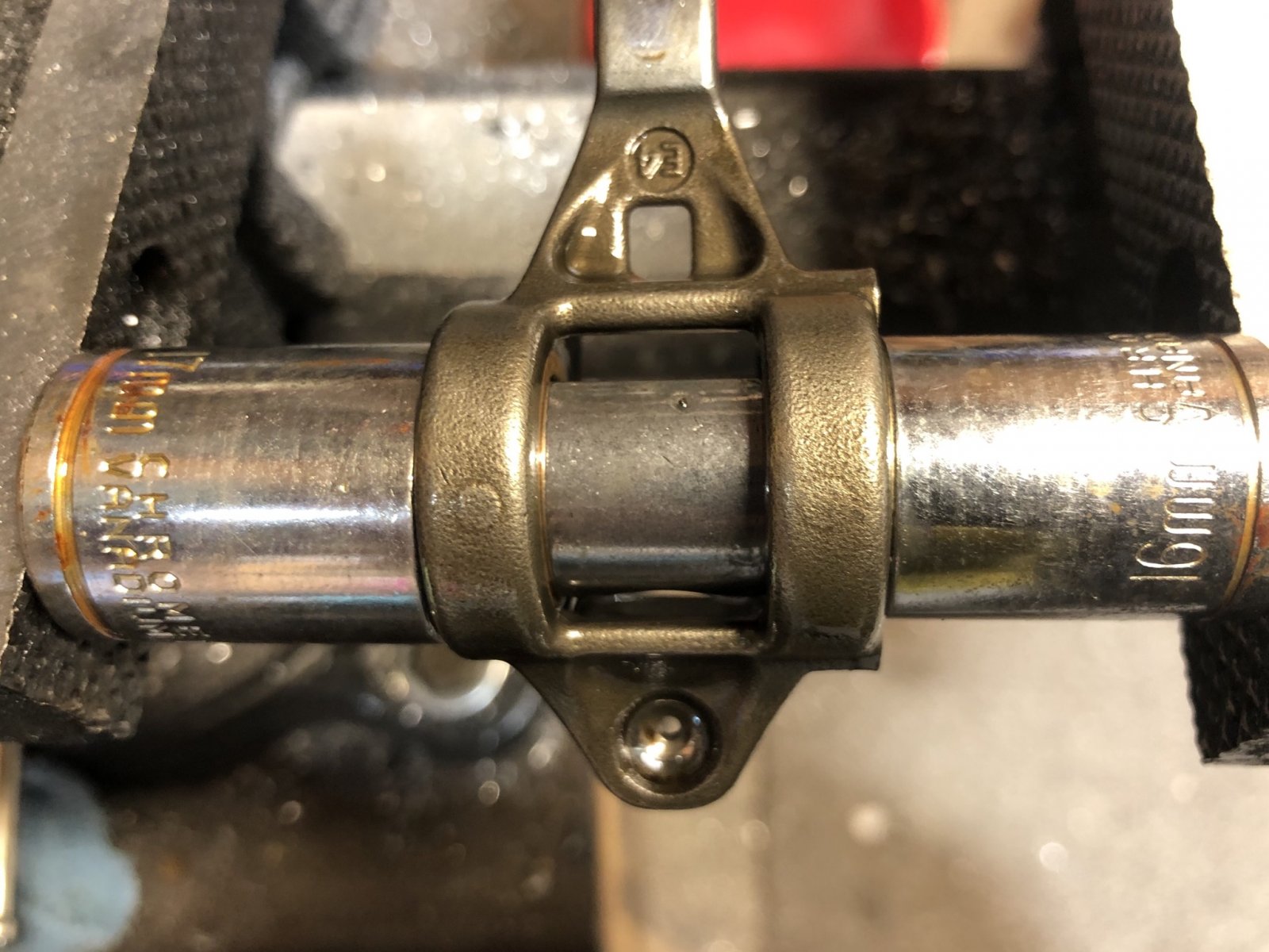

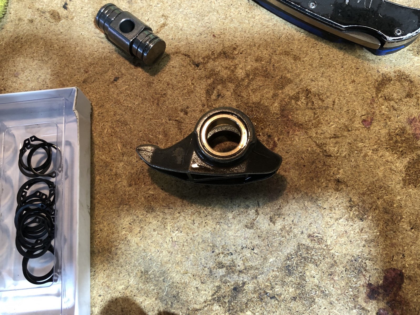

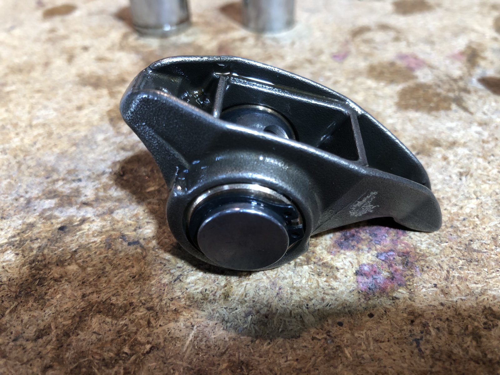

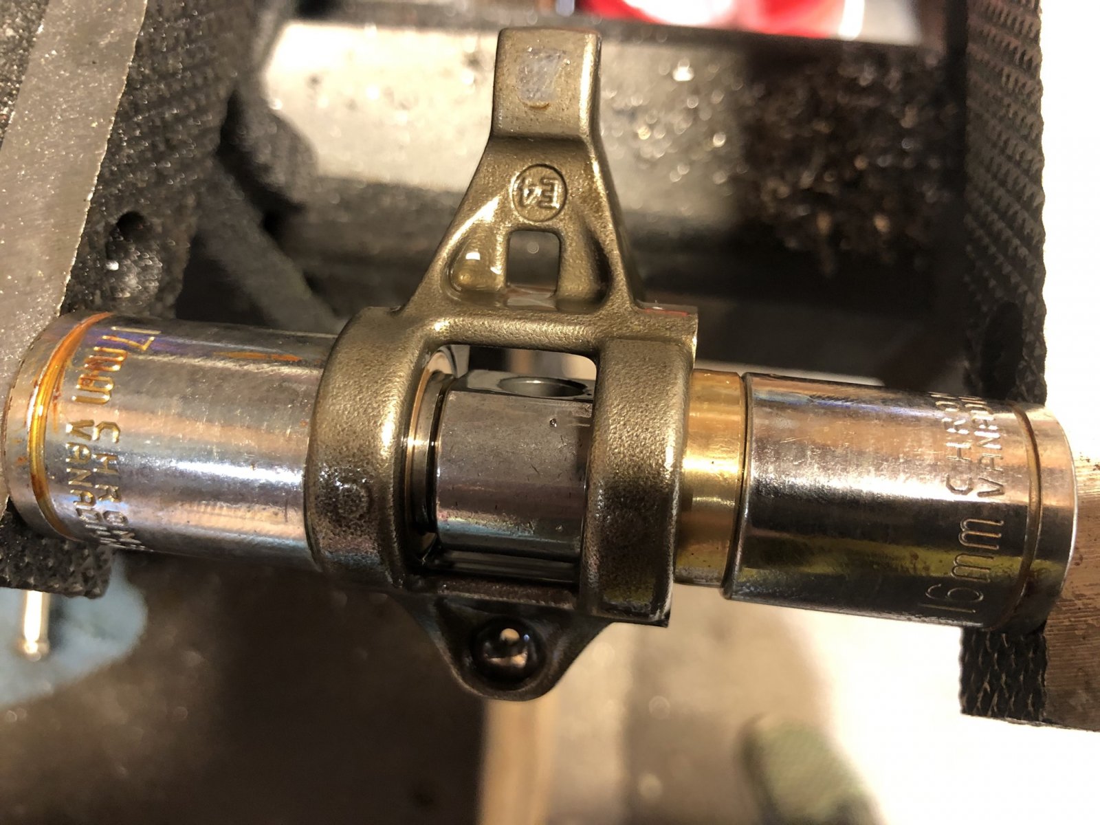

In case anybody is interested in the process of installing a rocker trunnion upgrade, I took some pics. I use sockets of appropriate sizes, in this case a 16 and 17mm 12-point for installation. Removing the old parts is a reverse of this install but using a slightly bigger socket on the receiving side so the whole trunnion slides inside it. First thing is you install one of the brass bushings on one side. I set the rocker on my toolbox and set this with a deadblow. The goal is to get it flush with the outside edge. Then you dip the trunnion in oil and set one end in that bushing, dip another bushing in oil and set it on top of the rocker, lining it up. This is where a press would be easier than a vise but I manage.

Then you need to press that bushing into the rocker until it’s flush. At this point I test for excess play or it might be binding if it’s too tight. For play, I look to see if one or both bushings need to be set further and do that in the vise as necessary. If it’s binding it’s back to the toolbox, where I set it on the 18mm socket and smack the trunnion with the deadblow until it moves smoothly and if I go too far, it’s back to the vise. The instructions just say to flush the bushings with the outside of the rocker but I have noticed there can be what I consider too much play so I adjust the bushings until I’m happy.

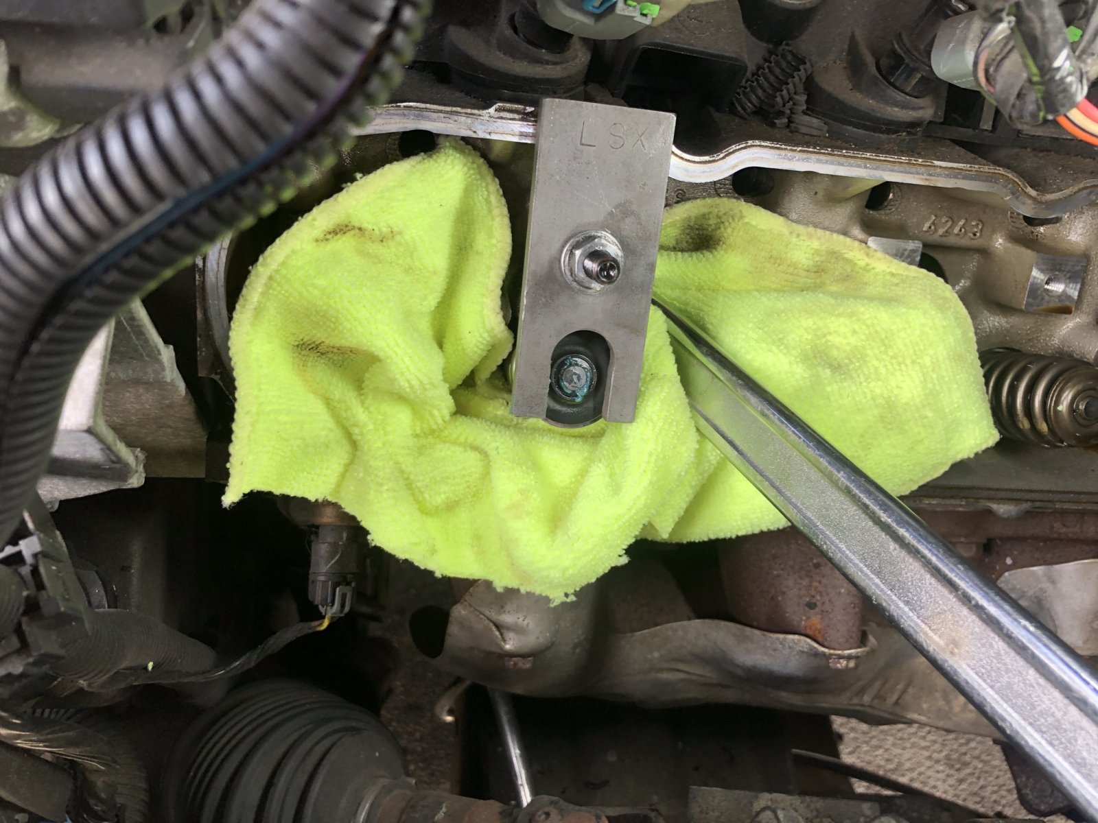

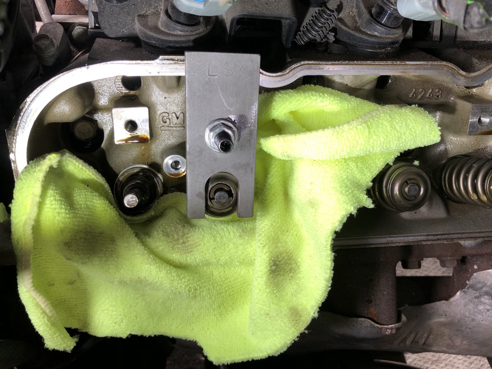

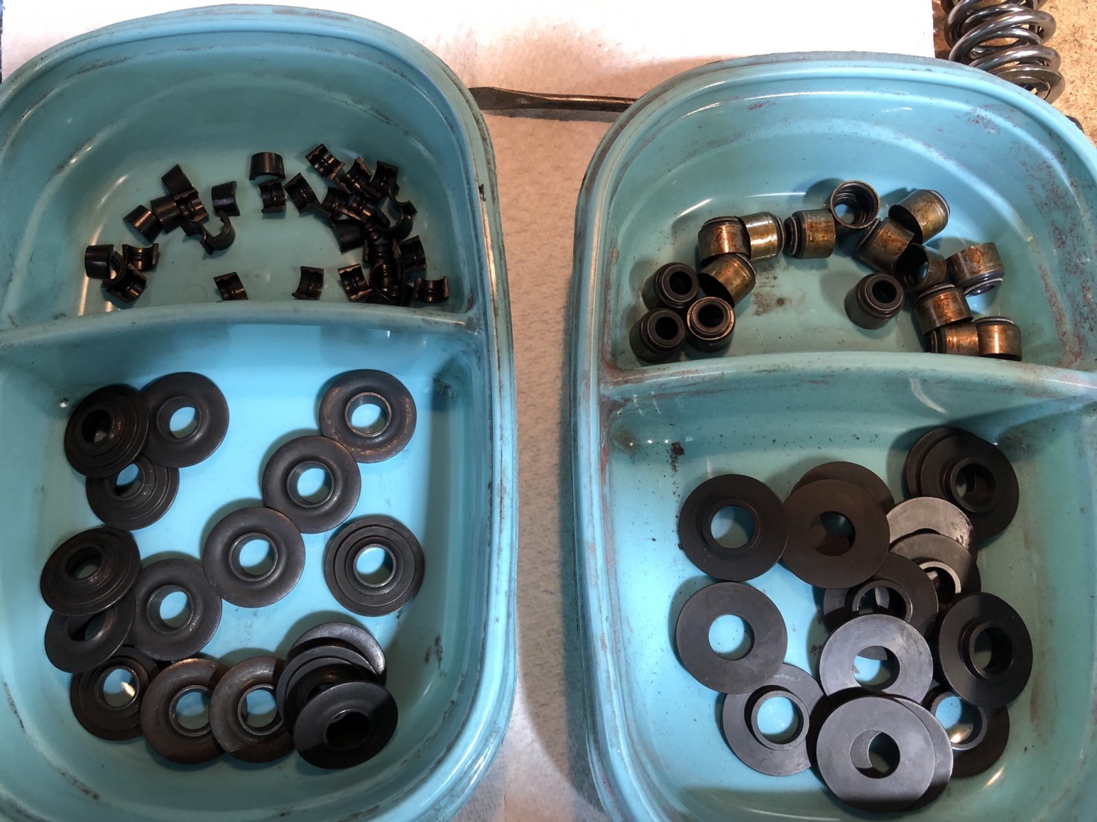

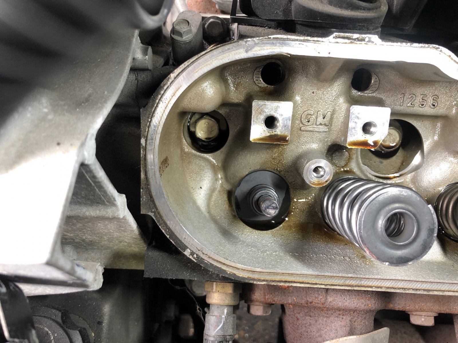

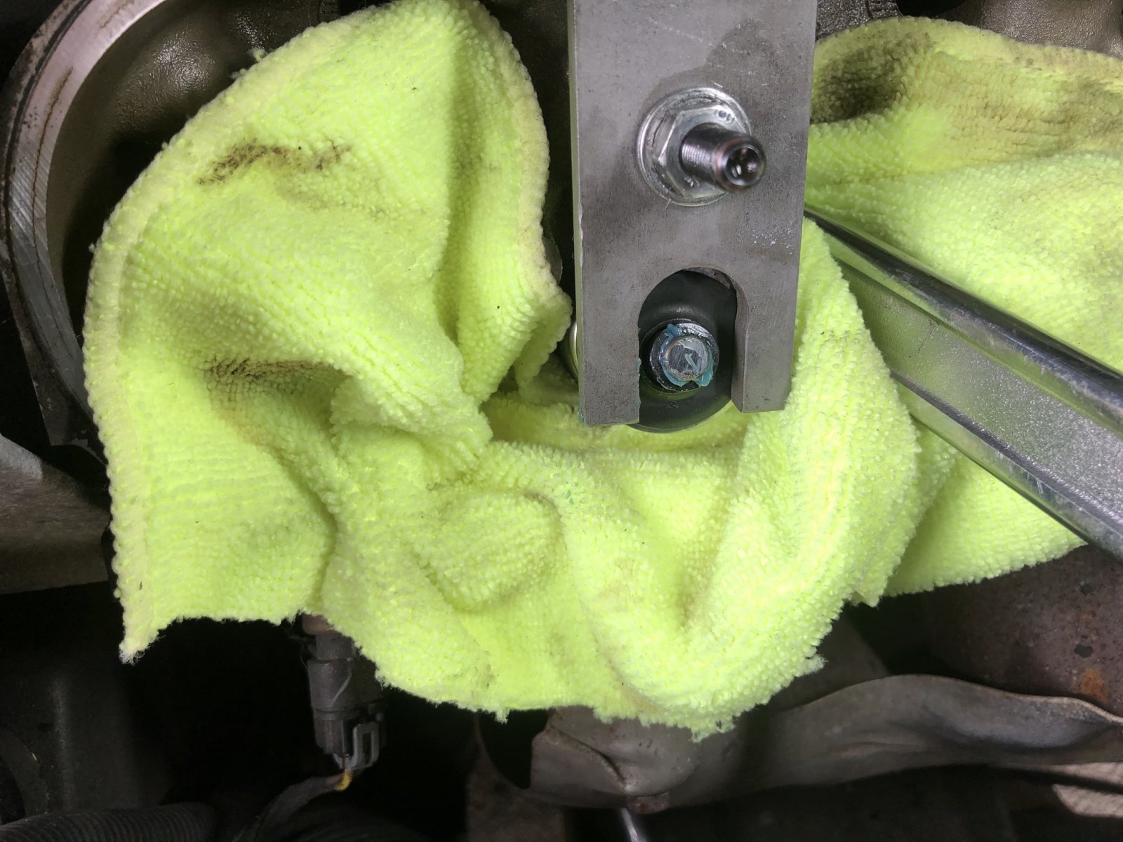

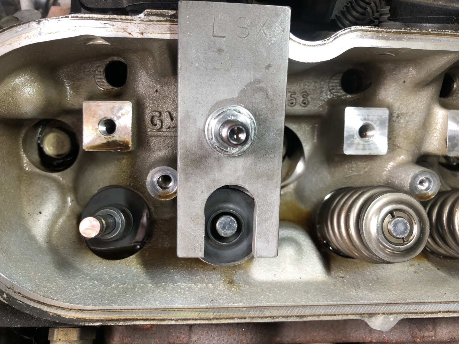

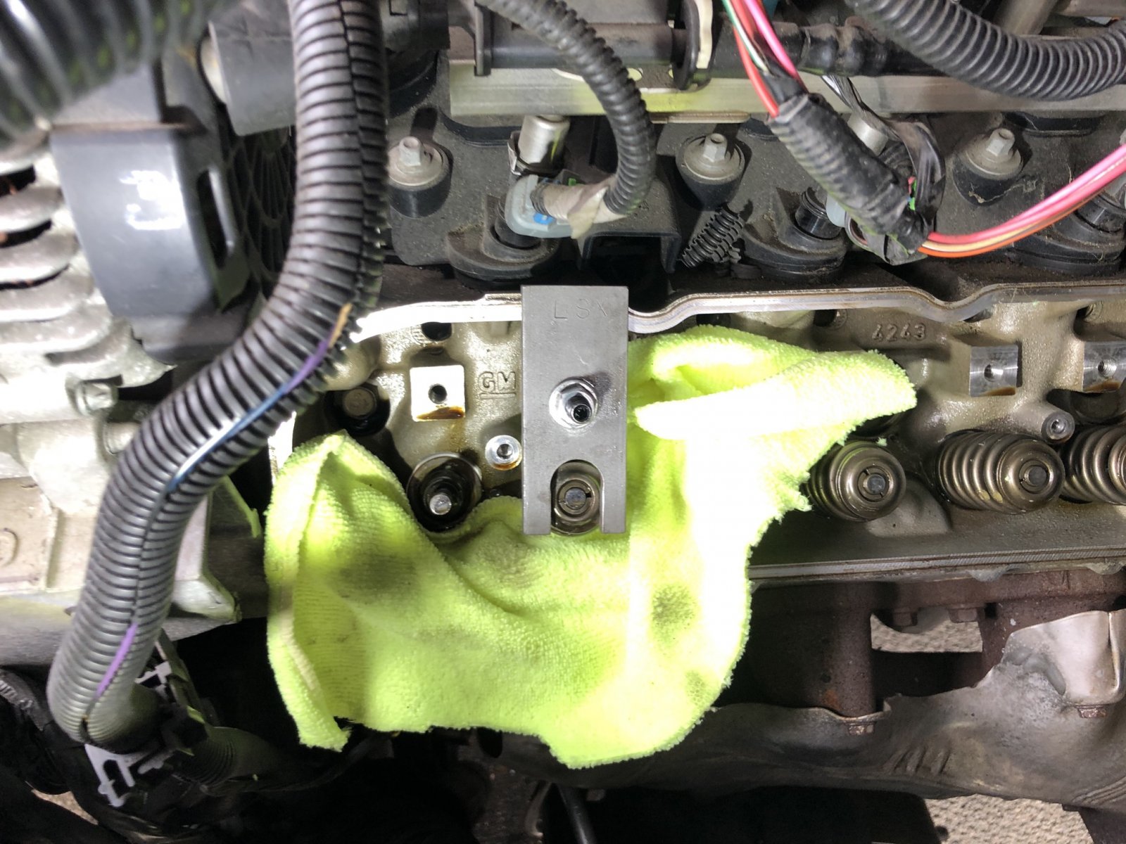

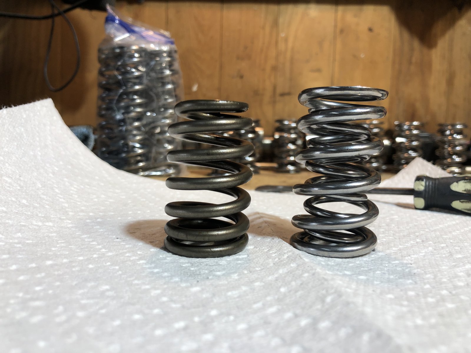

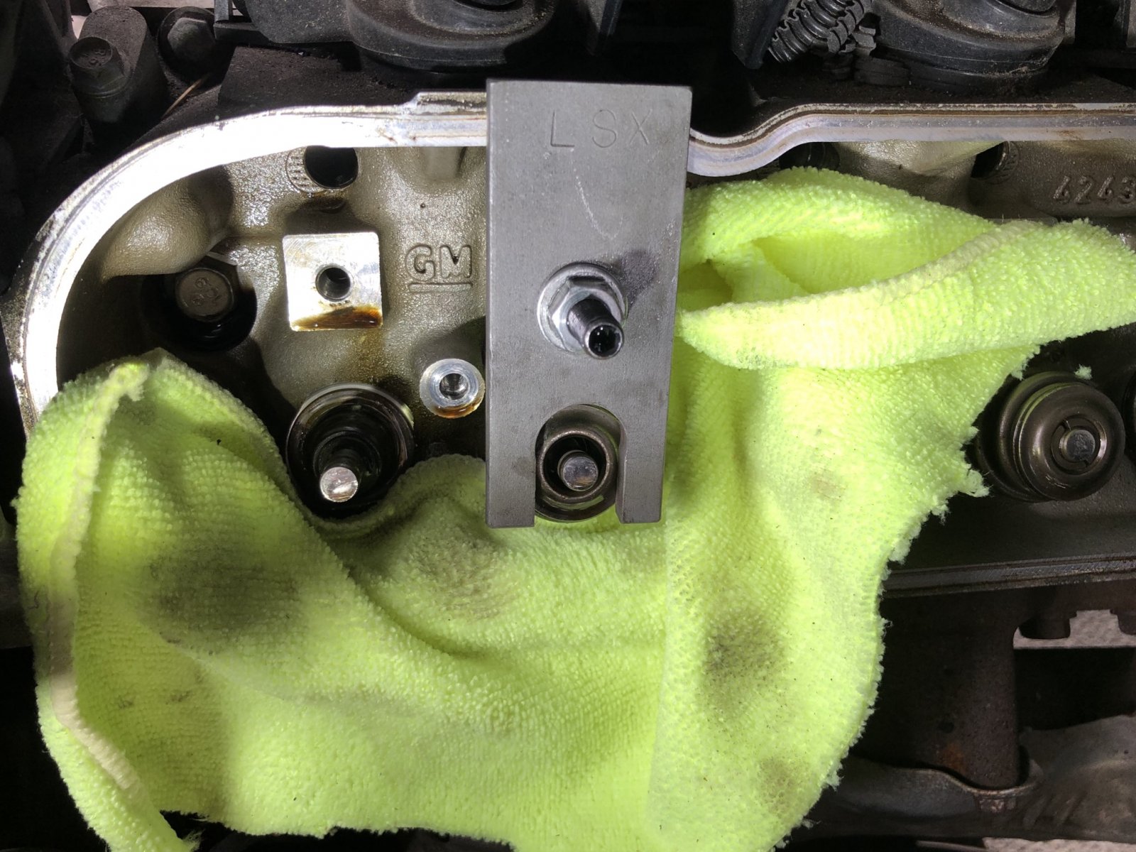

This shit is taking me forever! The cam gear came in this morning so I got the cam lined up right and installed it. Then I pulled the plugs and decided to pull the front wheels so I could lower the truck down to do the valve springs. And this is what’s taking forever. Here’s a few pics on swapping them. First, you’ll notice the height difference between the new duals and the OEM singles. Next pic is the new seats, hats, seals and keepers. Next is the spring compressor installed, then compressed, and finally the keepers removed with a pen magnet. This part is easy, it all comes off great.

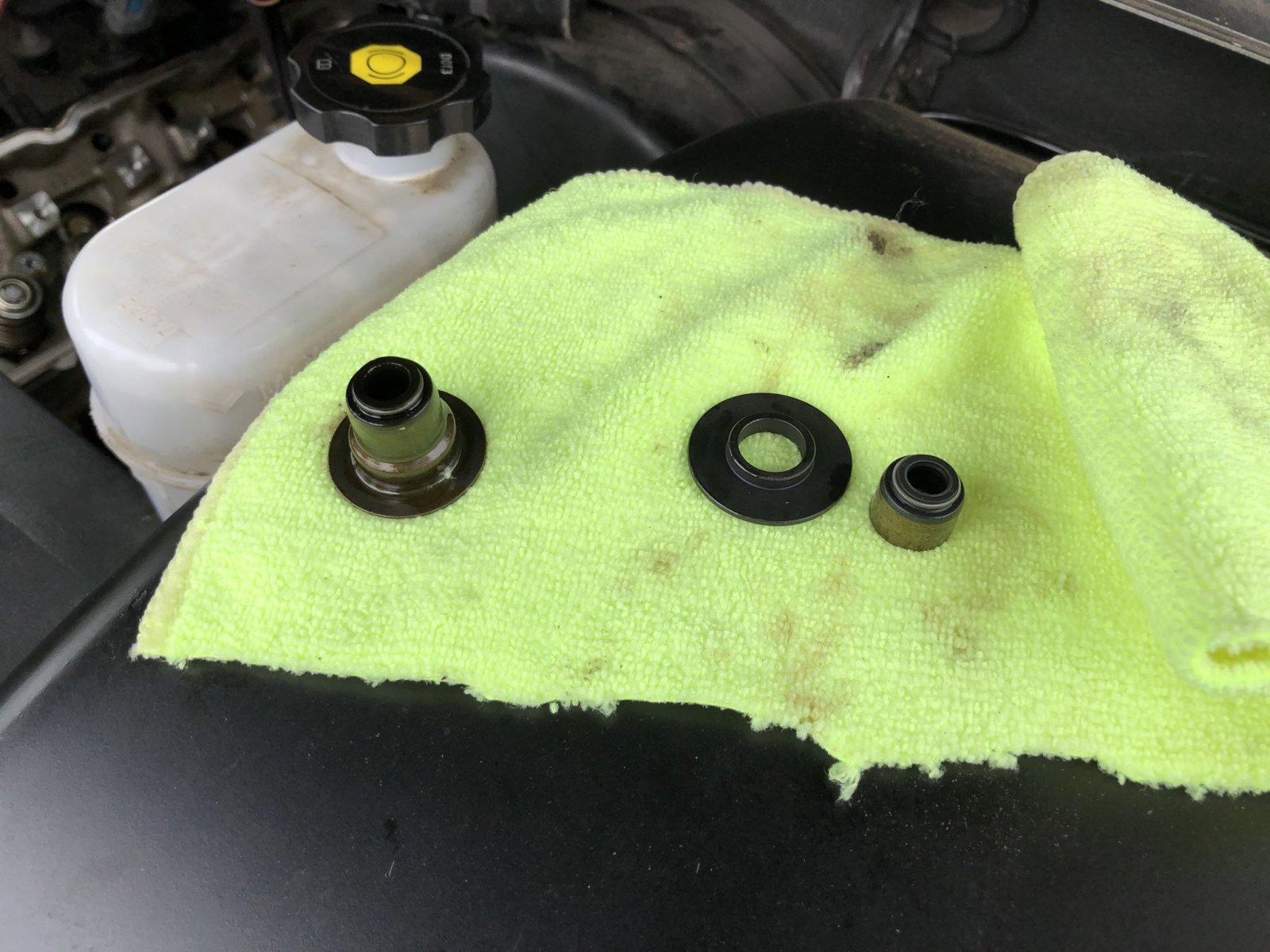

First pic here is the old hat-style seals which incorporate the seat, next to a new seat and Vitron seal. The hats would interfere with the center spring on the dual spring setup. Next up is installing the seats and seals. This part is easy too, just slide a seat down and then slide a seal over the valve stem and use an appropriate size socket to tap it down until you feel it seat. Notice the new spring height uncompressed. It makes it hard to keep the hat centered perfectly as you compress it. And it has to be perfectly centered to get the keepers in.

And the last part is what is taking me forever. I got #1 cylinder done and I swear it took me 45 minutes. The first one went smooth but the second didn’t want to center and I fought and fought to get the keepers in. I add a dab of grease to the keepers to stick them to the valve stem while I slowly let off on the compressor. I’ll probably get better as I go but it’s as hard as I remember the last time I did this.

What are you using to keep the valves closed?
52,954
The top dead center method. With the dots on the cam and crank gears lined up, 1 & 6 are at top, rotate the cam 45* and it’s 8 & 5, rotate and it’s 7& 4, and finally 3 & 2. When a cylinder is at TDC the valves can only fall down a bit, and I can usually compress the spring and then pull them all the way up and they stay. I have a tool to hook to my compressor to pressurize a cylinder but it’s a PIA, it’s like doing plugs and I don’t want to do plugs more than once. And then the compressor is running all the time.
With a piece of nylon rope in the cylinder or just metal to metal?

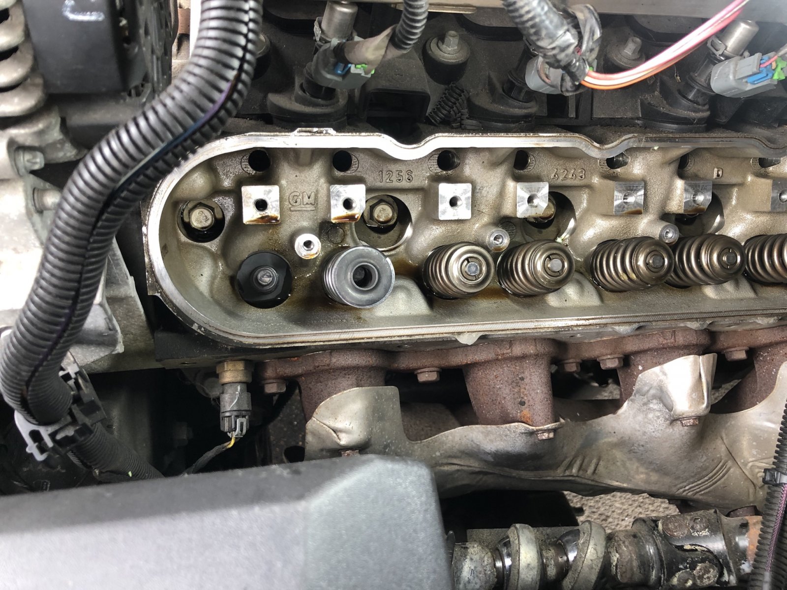

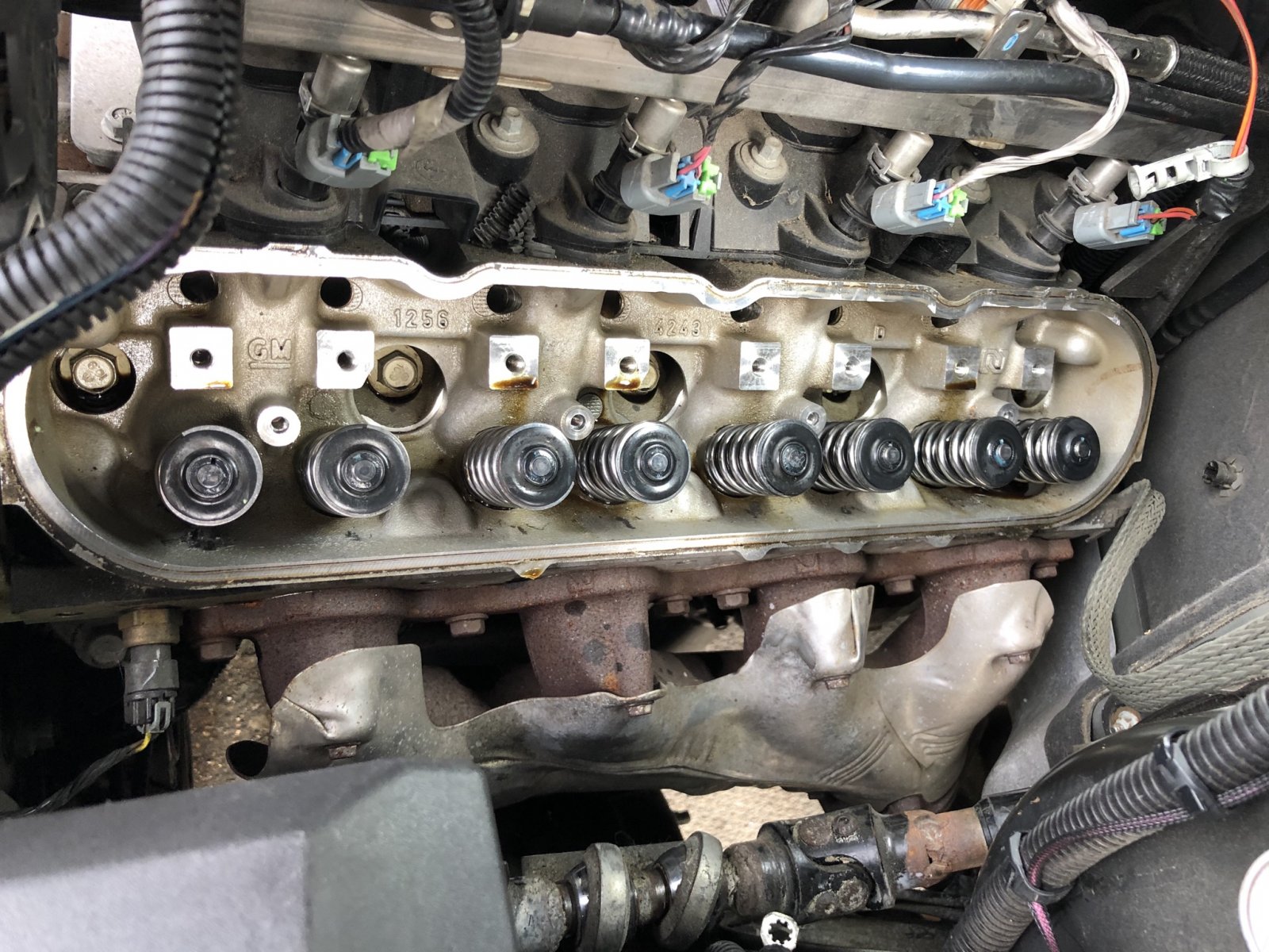

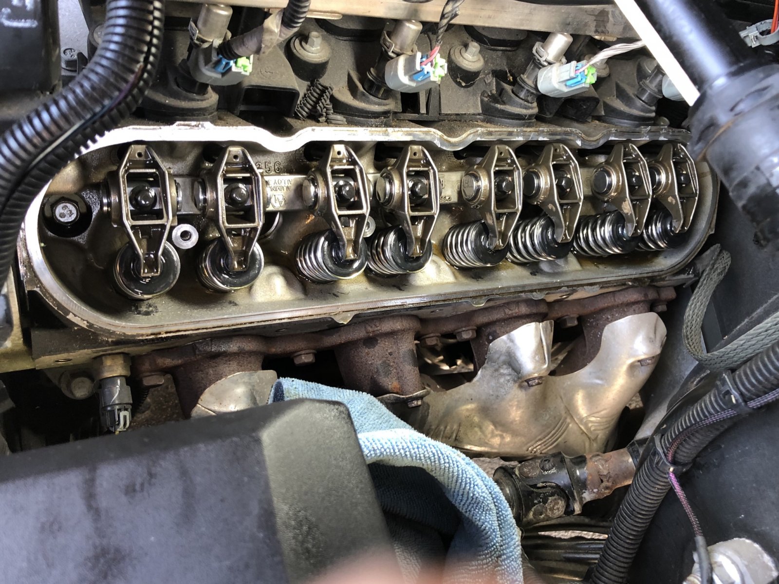

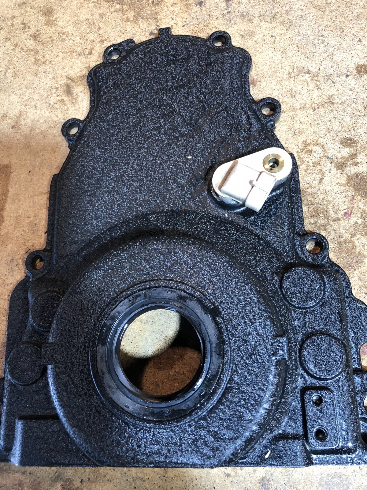

Springs and rockers done, and I’m starting to reassemble. I’m painting a few parts like front cover and valve covers but not getting too crazy. I wish I’d painted the water pump but I did that on The Beast and prep is a ***** so I’m leaving it. Plus I need to get this finished tomorrow because it’s gonna rain for a few days.
