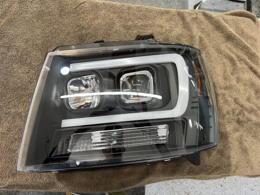

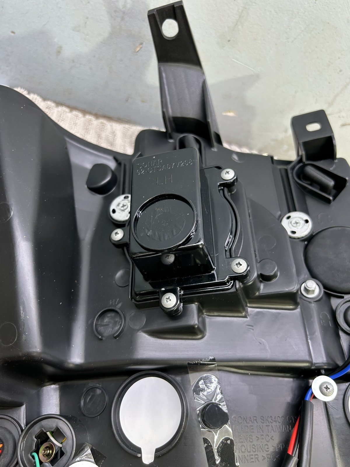

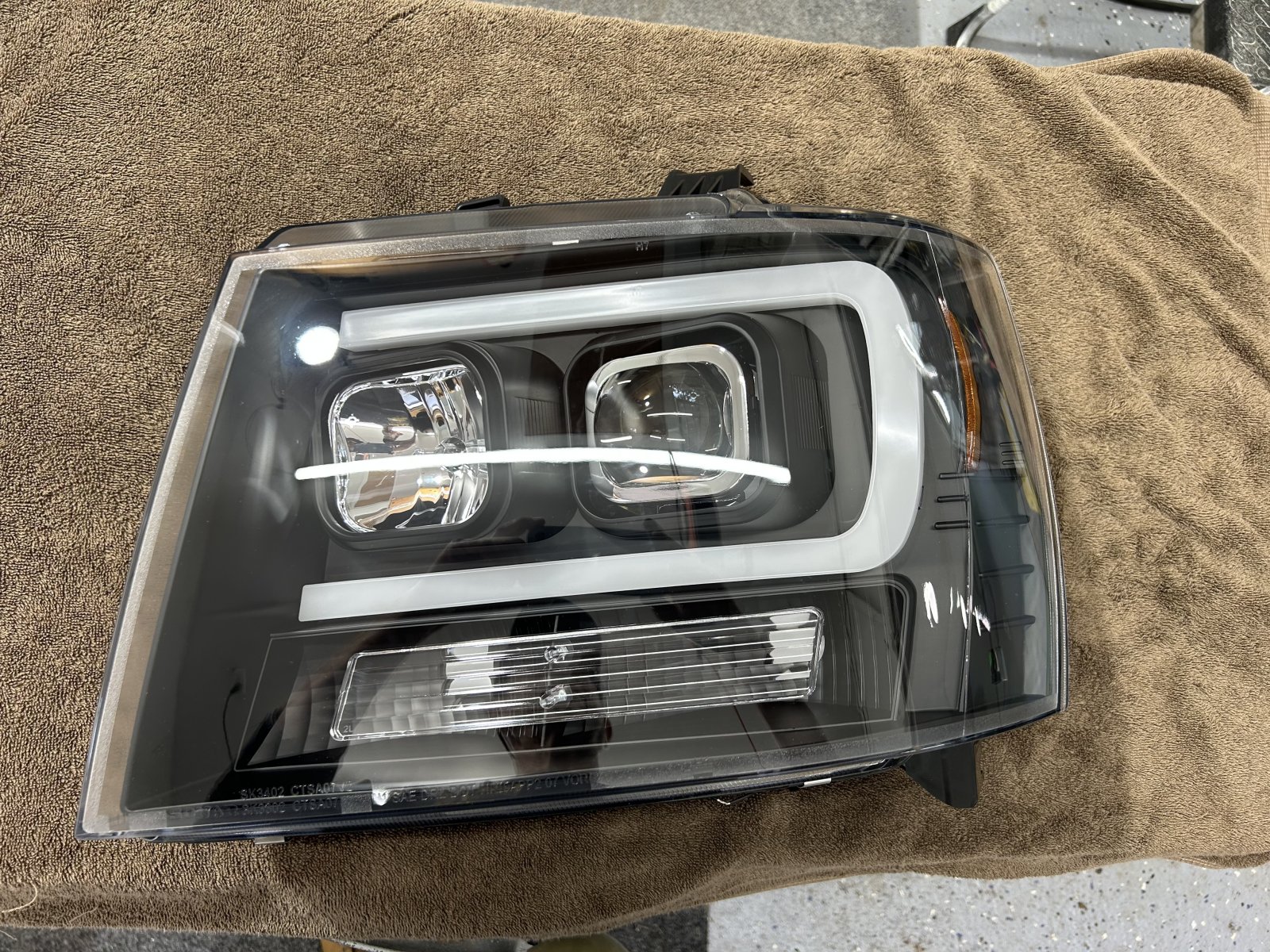

And the headlights came in but now I’m waiting for H1 and H7 LED bulbs to replace the halogens they came with. The low beam is a projector and I’m going to leave it unmolested except to swap in the LED. I was going to see about retrofitting with the etched MH1 projectors I have but after looking at these, it looks like too much work for me at this time plus I believe these projectors look fairly decent. I’ll see. These are branded as ACANII but came in a Spyder box. It looks like they’ve been modified with a box that makes the tube do some cool routine when I apply 12 vdc. Might do other stuff, I’ll find out when it’s all hooked up to the factory harness. These feel and look quality. The adjusters look decent. I like them so far. They came with a second set of covers for the projectors that have holes in them, possibly for heat sinks if you’re doing a big bulb with a fan. The ones I ordered are 1:1 size with original bulbs so no need.

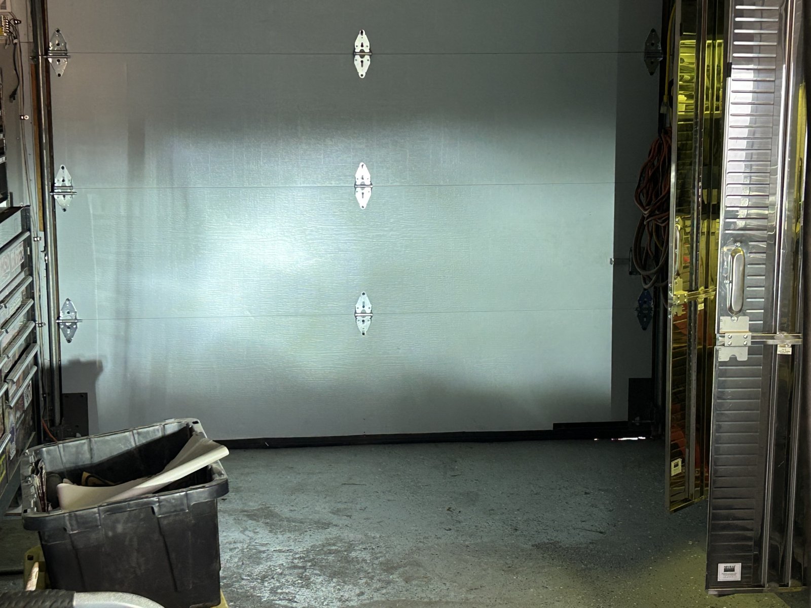

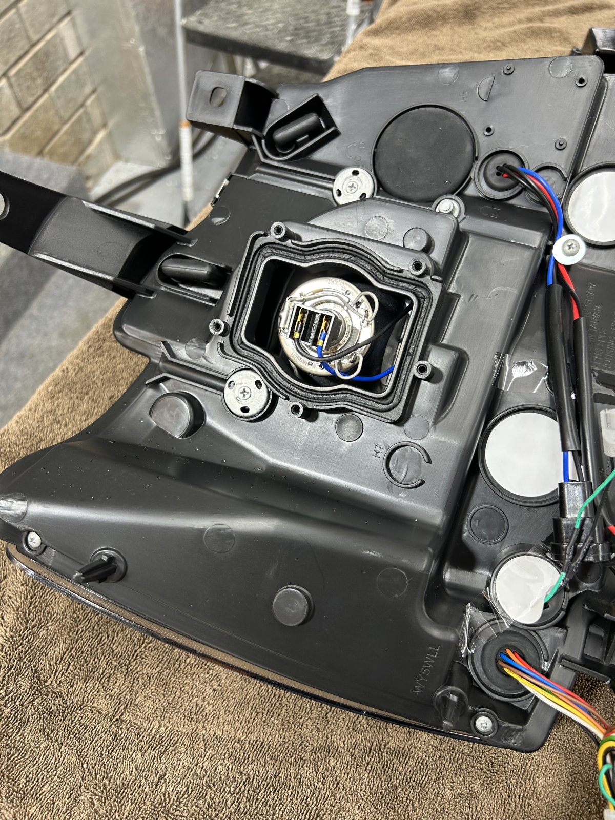

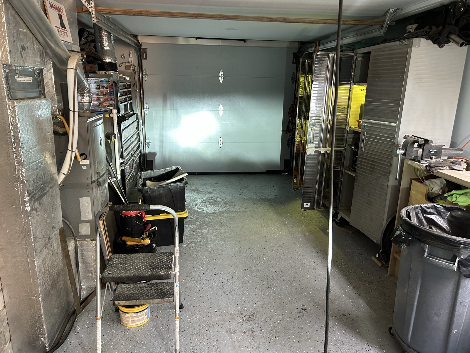

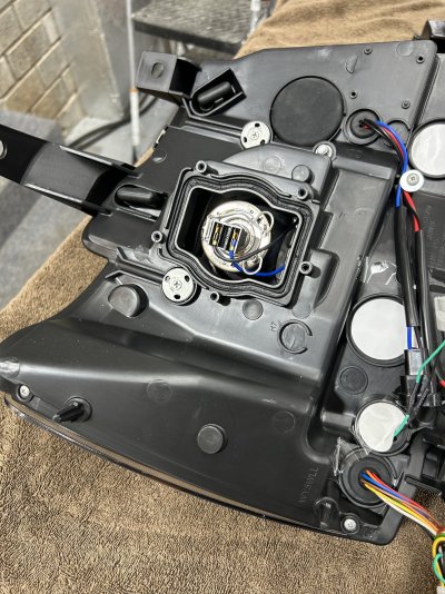

Swapping out the H1 and H7 headlight bulbs in the new Spyders with LED’s went fine with the Fahren H7’s in the low beam projectors. They have a nice sharp cutoff line. Their H1’s are a different story, as well as what appears to be with most all of them. They are clocked at about a 45 degree angle and I can’t find any with collars that either lock or have a set screw so that you can rotate them until the leds are at 3 and 9 o’clock. These are locked at 4:30 and 10:30, not ideal and the scattered beam is evidence. I’ll install the halogens if they don’t have a solution. Fahren is looking into it for me. The last 2 are the H1 high beams.
52,954

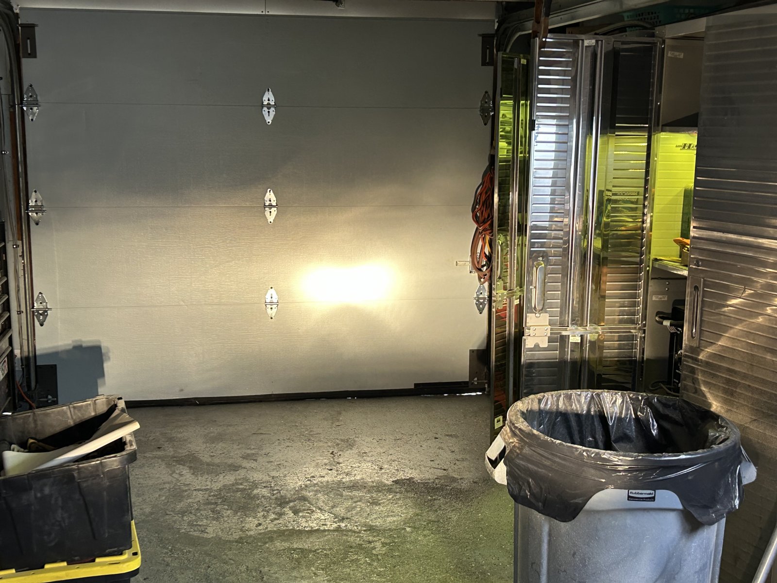

I started a build thread for the Tahoe but I want to put stuff in order there so for now I’ll post this here. I installed the headlights with LED bulbs in the projectors for low beams and halogen in the high beam reflectors because I couldn’t find H1 LED bulbs that I could orient vertically, they’re all at a 45 degree angle unless you spend $150 for a pair of bulbs. You can see the scatter on the led (white ) high beam pics.
