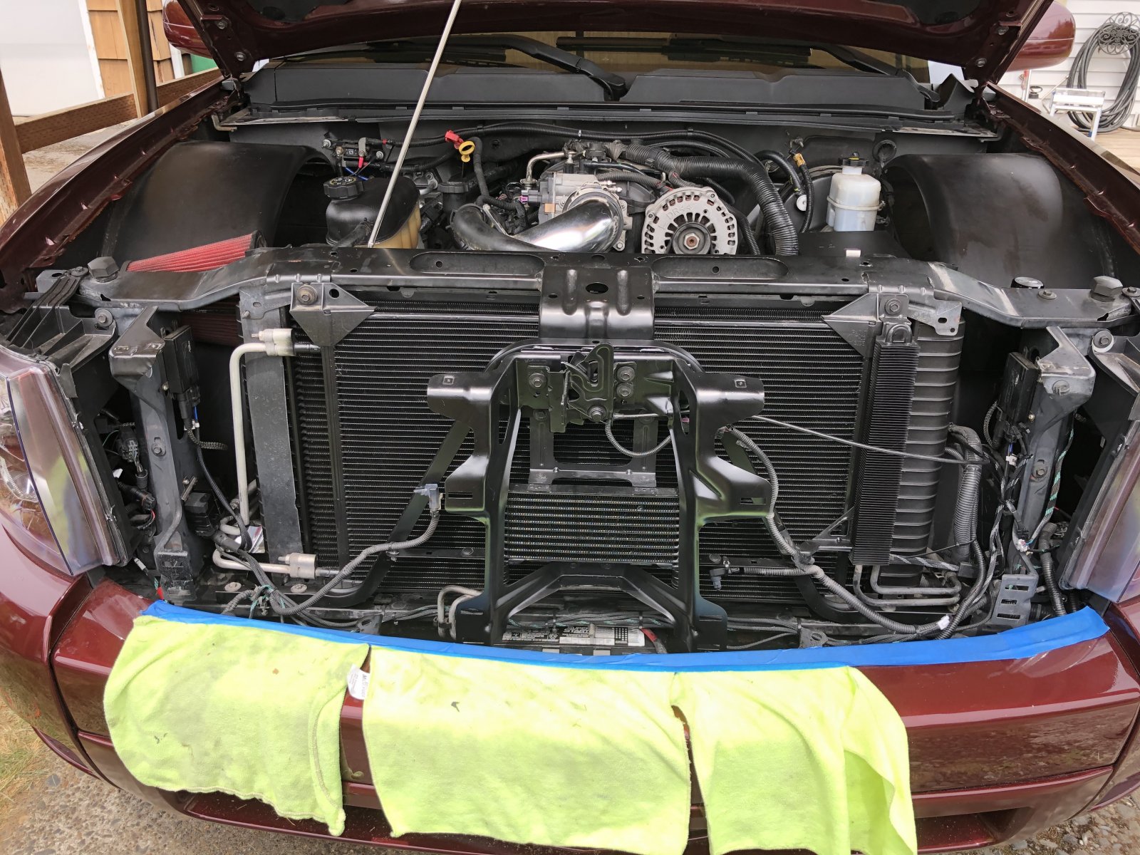

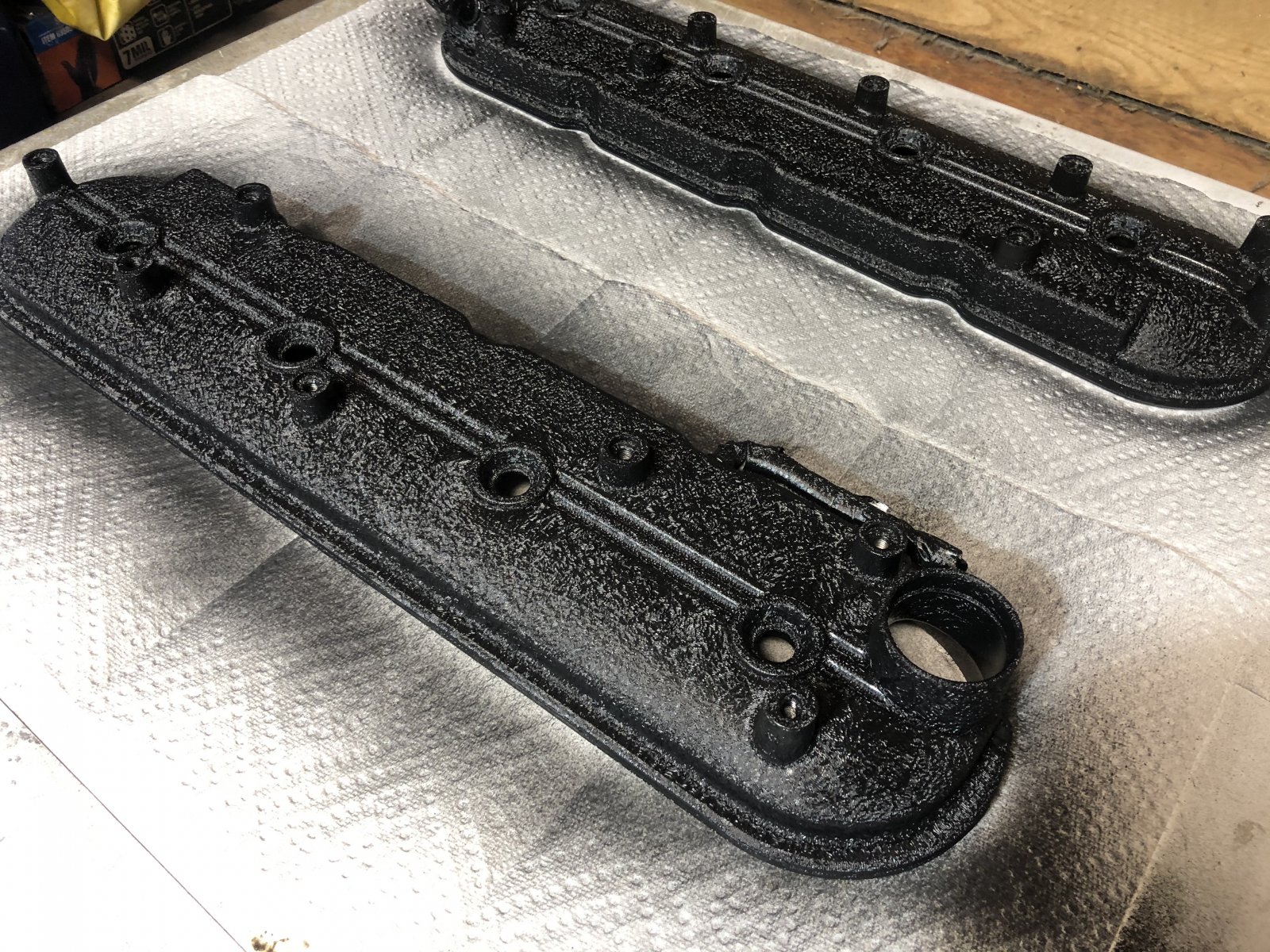

The valve covers came out awesome. I’m pretty well finished, just have the radiator, core support ( I’m painting it tonight) trans cooler, valve covers (waiting to cure) and coil packs left to install.

The valve covers came out awesome. I’m pretty well finished, just have the radiator, core support ( I’m painting it tonight) trans cooler, valve covers (waiting to cure) and coil packs left to install. View attachment 249327
I hate to be the bearer of bad news, but in case you hadn't noticed, your paint came out all wrinkled up.... guess you will have to sand it all back down and try again.

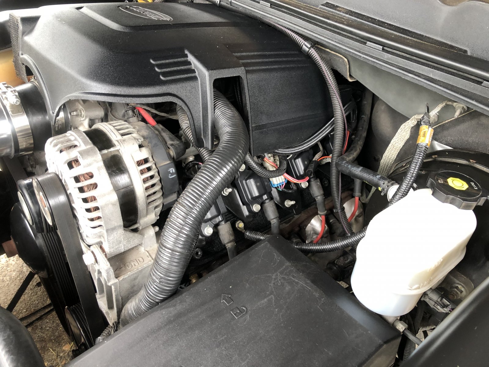

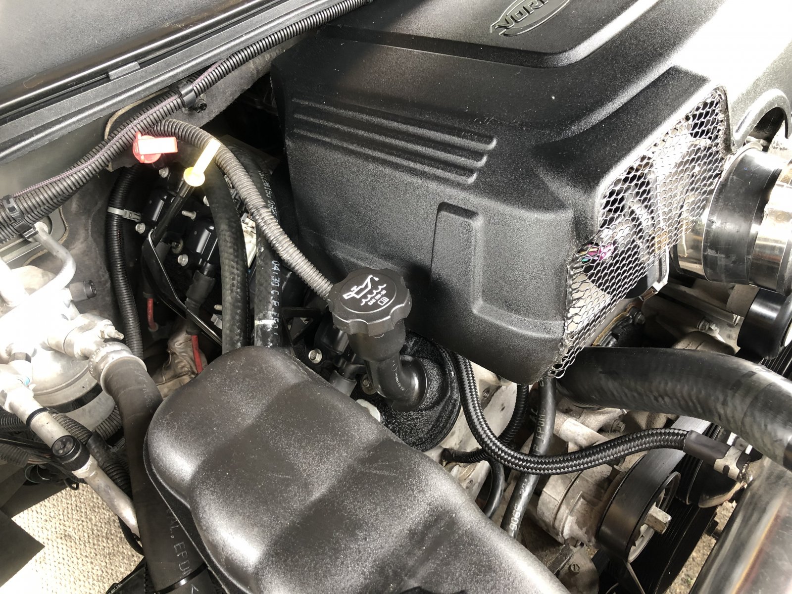

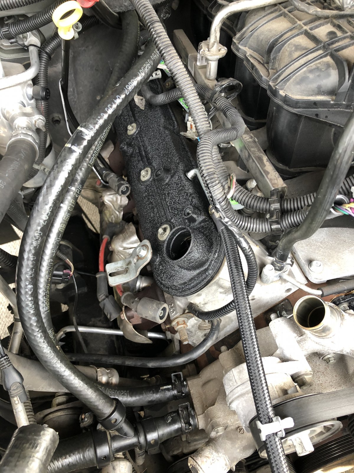

Upgraded the PCV lines with braided hose I had laying around. The valve covers look good but then you install the coil packs and oh well. I’ll order some ICT Billet mounts. Painted the core support and radiator, transmission and oil coolers so it will look better behind the grill.
View attachment 249390 View attachment 249391 View attachment 249392 View attachment 249393 View attachment 249394
So, that oil filler tube, you installed it after the covers were in stalled. Is there a part number for that? Does it fit nice and snug at the base? So far my experience with those has been total ******* shit and I am still looking for the right part for mine. And from what I researched they are very difficult to remove and replace without removing the cover. And still difficult even so without breaking the plastic keeper tab.
52,954
It s solid now, not so much before. The OEM part number for the filler tube is 12574386. It has to rotate a full 180* to be removed or installed and I think since my overflow tank is relocated and is in the way of doing that, it never got installed right. IMO it’s easier to install it with the cover installed so you can twist it good and seat the big o-ring without the valve cover moving. I grab it with both hands, turn and push, then pull to remove, or push slightly when installing so the tabs engage.

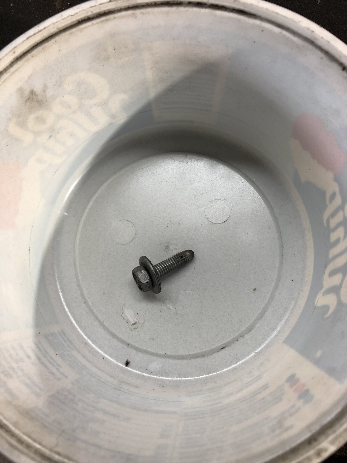

There’s always that one damn bolt left over when you complete a project like this. :sad72:
Hard to judge the size, but it looks like one of the black 10mm bolts that secure the plastic wire harness mount to the front side of the oil pan or cooler lines on the side or plastic flexplate covers (but you'd know if one of those were missing). But if it's a 14mm or 15mm...
It’s just one of the hundreds of 10 mm bolts that go everywhere. I checked everything over a couple times but can’t find where it goes. Probably holds something in place in an out of the way spot. I’m not worried. If I hear a rattle I’ll know I guess.
No. The job is incomplete and this is now a game.
It looks black on my screen- is it?
Could it be one of the three that hold the engine cover mount to the intake manifold?
