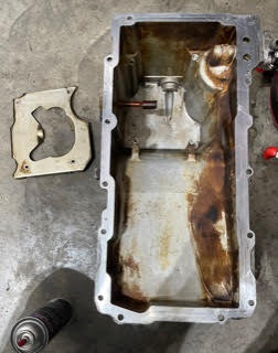

Had a curious question. I'm replacing oil pan gasket on my 2005 tahoe LT. I removed this plate to better clean the bottom and was wondering if this plate is really needed for the pick up tube?
afpj
Sep 16, 2009
816
383
Had a curious question. I'm replacing oil pan gasket on my 2005 tahoe LT. I removed this plate to better clean the bottom and was wondering if this plate is really needed for the pick up tube?View attachment 348005
Don't be "that" guy who takes apart stuff and puts it back together then has parts left over....
Gunnyj1
Jan 27, 2013
LOL!!! I would never do that. Just didn't see the purpose of that plate since the pick up tube is emerged into the oil any way. Everything's bak together.
