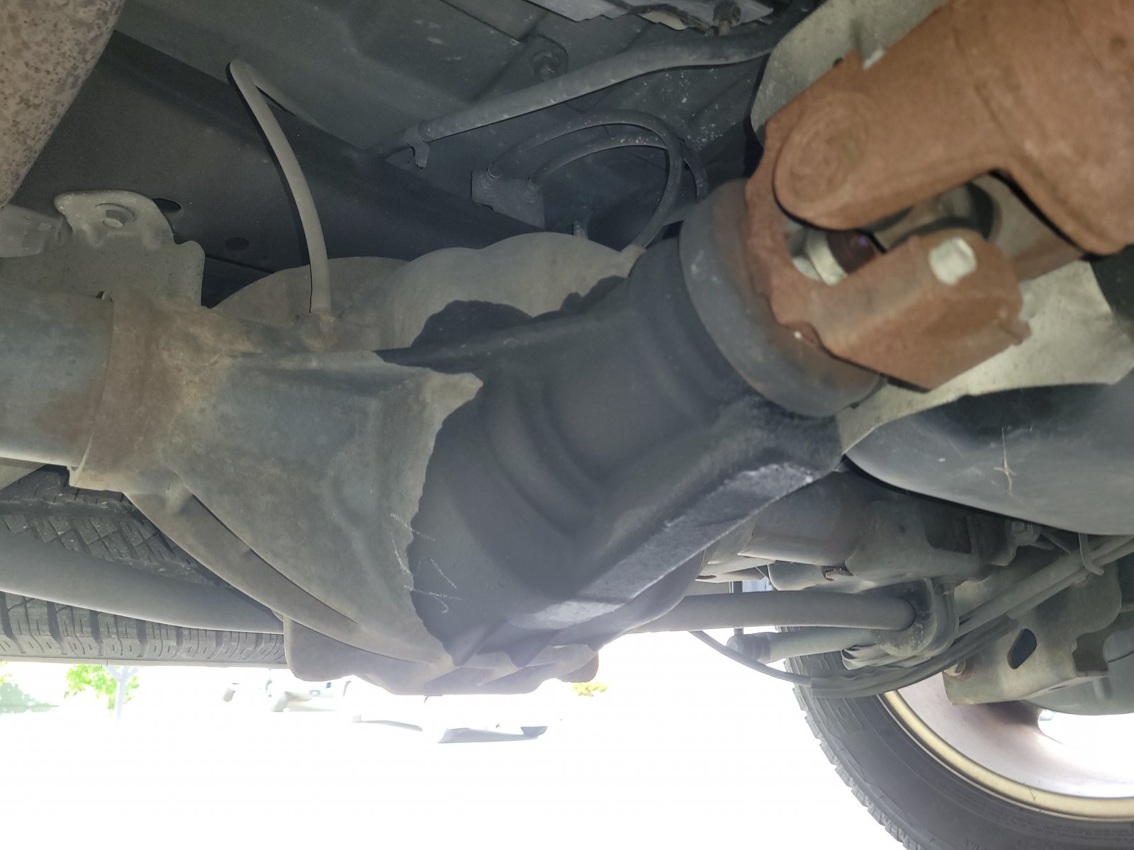

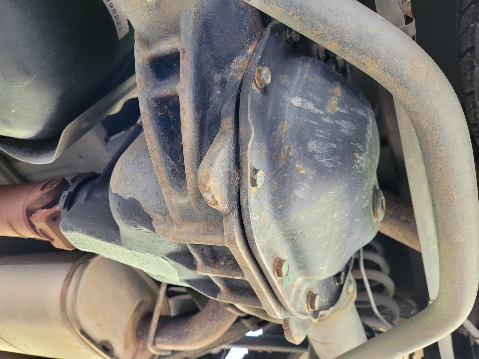

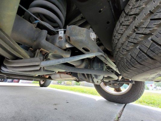

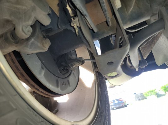

I recently brought my wife's 2012 LS 2WD 5.3 Tahoe in to the dealer for the Takata Airbag recall. They did their multi-point inspection, and noted the Pinion Seal and Axle Seal was leaking
Their repair quotes were typically expensive for dealer rates. I've been researching how to repair this myself, and have a few questions
See Photos
Rear End is a 14 bolt, 3.42 (opt GU6)
Are there known correct size pinion / axle seals for this axle?
What is the correct size socket for the Pinion Seal for this rear end?
Is it typical for just one side of the axle to leak? The leak doesn't look bad... Does it really need attention right now?
I don't have a lot of good access to the rear end diff cover plate. Is replacing the axle seal going to be more trouble than it's worth versus paying a shop to do this job?

Looks like a typical 10-Bolt 8.6" rear axle to me. 14 bolts and Tahoes had 6.2 engines in 2008 and 2009 only AFAIK.
Anyhow, the axle shafts have to come out to replace the seals and the C-Clips can be a pain to get out. The brakes have to come off to get to the axle shafts. You also have to remove the pin in the center chunk, hope the locking screw doesn't break in half and hope the center section doesn't rotate too far to throw off the orientation of everything to where you have to spin the diff in 300 different ways to get everything aligned up again. The pinion has a crush sleeve but people cheat with an impact gun, scribing a line on the nut and housing and then when putting it back together, tightening it to the scribe mark and not torqueing to spec.
The leaking axle seals will eventually take out the parking brake shoes and maybe the brake pads if it gets worse. If you keep the fluid level in spec, you can kick the can down the road a while. If she runs low or out of fluid, a complete overhaul would be in your immediate future.

Axle Seals are 291-315/12471686.
The Pinion Seal is 26064029.
You can use an OTC 4508 to pull the seals out.
You would use a J-38694 to install the pinion seal.
You would use a J-21128 to install the axle shaft seal.
Lots of DIYers use a block of 2x4 as a seal driver.

Well the Tahoe is still at the axle shop waiting on parts. The bearings / carrier parts that came in didn't match up. I'm told the Pinion Bearing and Carrier Bearing was very worn, and there was no carrier preload from the bearings being so worn.
Axle shop states they were surprised the rear end wasn't making noise
