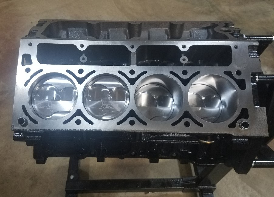

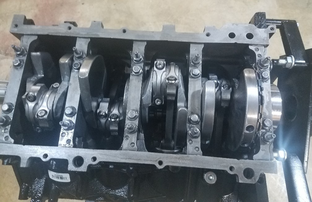

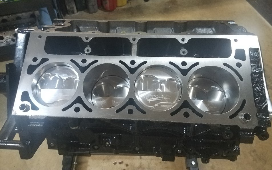

Here are the pictures. I did pull the number 7 piston and the rings all looked good. Reinstalled and it went in much easier this time. One of the rings must of got slightly hung up in the compressor.
Left side - 1, 3, 5 and 7
Right side - 2, 4, 6 and 8
