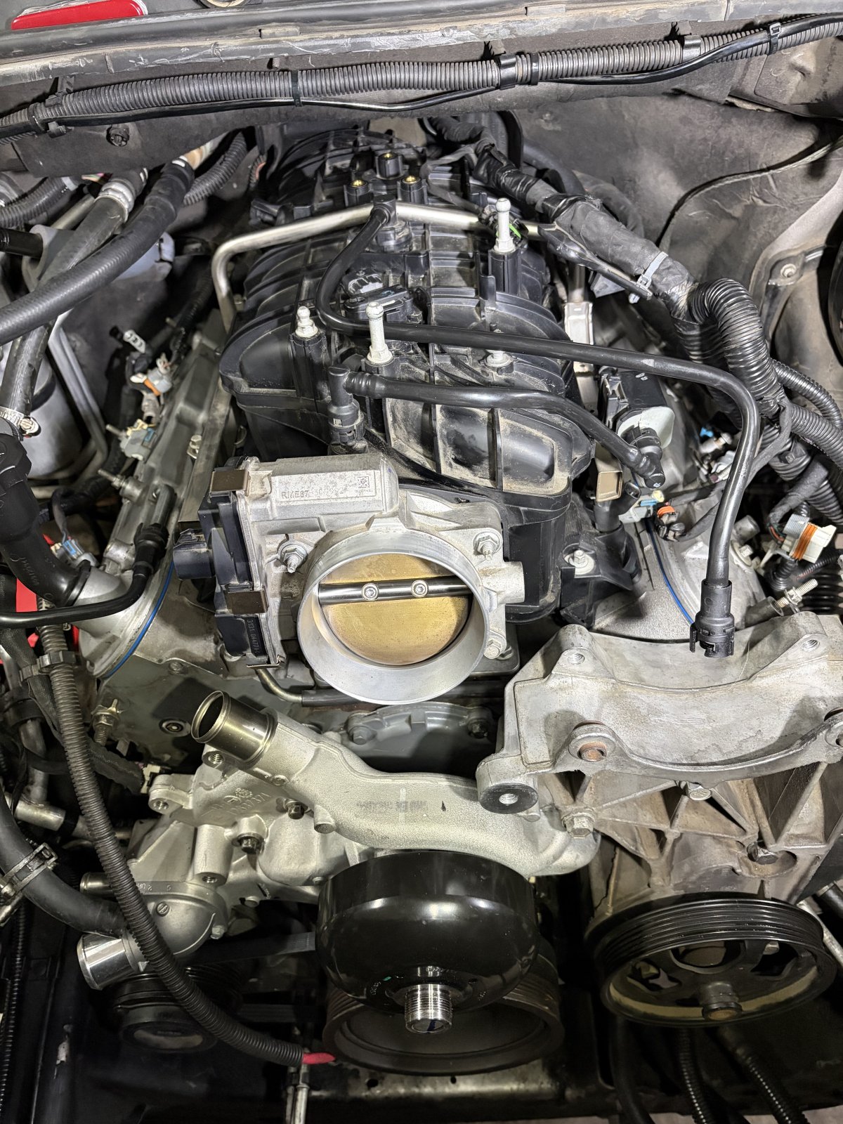

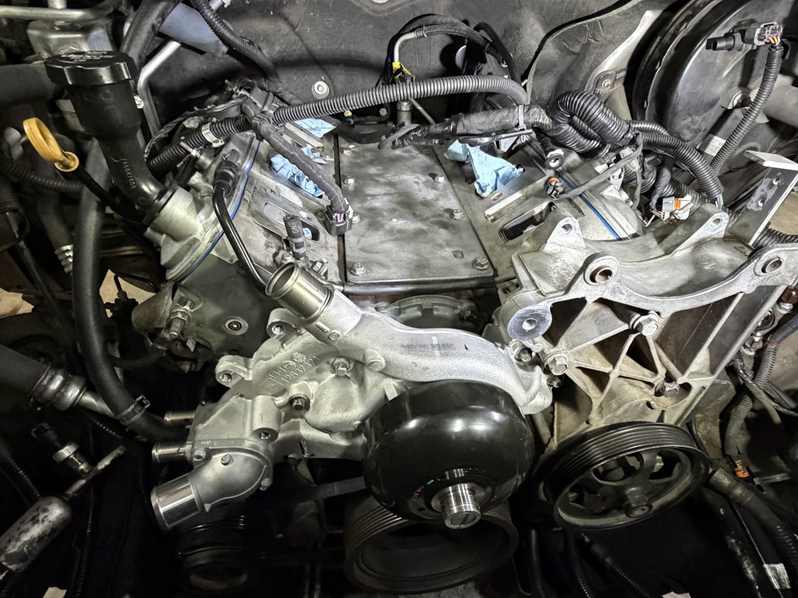

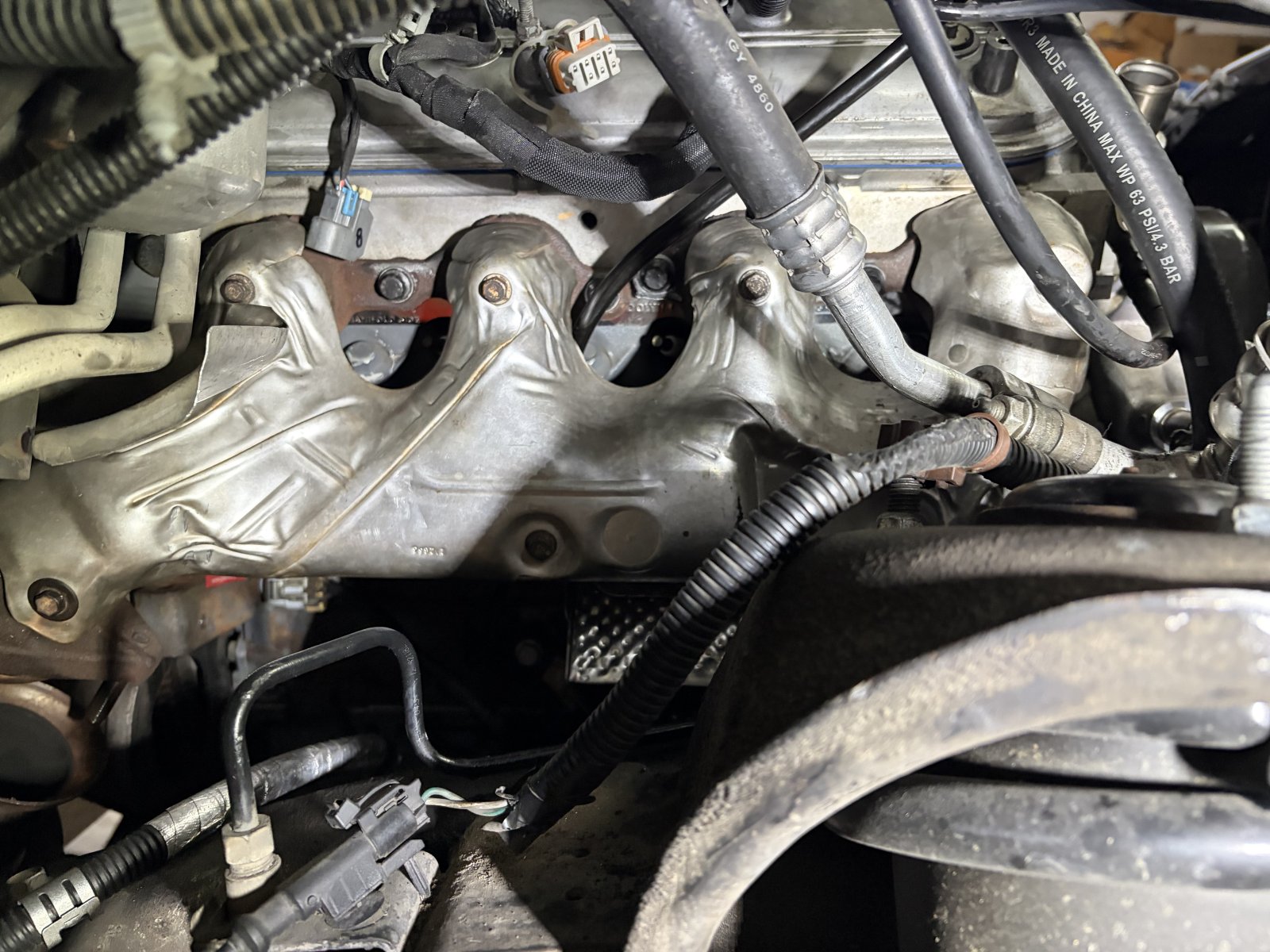

On weeknights, I only have enough time to do a few things on the swap. Last night it was AC belt, water pump, power steering bracket and pump. Tonight it was exhaust manifolds and some other small parts.
New ARP bolts for the manifolds. Hopefully no more broken bolts.
Question on manifold to y-pipe connections. For PS, I ordered a new mahle donut gasket. For DS, instead of the the metal ring gasket, I ordered a Walker triangular plate gasket. Does that all sound correct? I’m assuming I leave out the old ring gasket on the DS?

I agree, use the donut just like the factory did. I know you have the tranny bolted up now but make sure the torque converter spins free inside the bell housing. If it does not your only option is to remove the tranny bolts and back the tranny off to gain room to spin and seat the converter. It is super easy to get it on one or two of the splines inside the tranny while it needs to seat on all three splines. It slips back a little more with each engagement.
When I did my Escalade tranny 3 years back I let the torque converter slip forward off the third spline as I installed the trans. Did not catch that till I had it up and in place. Such a pain to waste time fixing an avoidable mistake. I double and triple check now before mating the tranny with the engine.
Looking forward to hearing about your power increase over the 5.3L. I have only owned one 6.0L, it was in a 2001 Denali and at 320 HP with only a 4 speed tranny that rig was a beast back then. Screamed to 6,000 RPM any time you asked. My only issue with the early 6.0L was morning piston rattle. Never failed, just not what you wanted to hear with every morning start up.
Went with the ring on drivers side as suggested, seems to make a good seal, thanks.

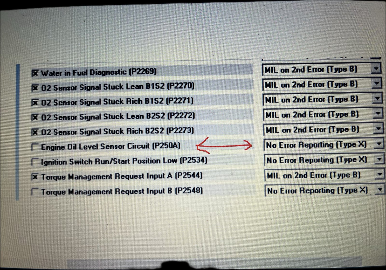

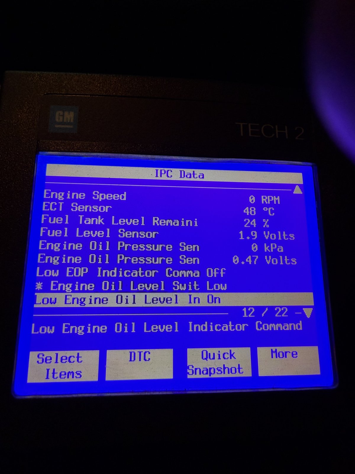

It runs! I’ll post up a video later, but I have an immediate issue I'm trying to solve.
I'm getting a "Low oil level - add oil" warning in the DIC. Problem is, neither my old LMG nor the new L96 have oil level sensors. My tuner uses TunerCAT. He needed to find a similar 6.0 that uses the same OS as the LMG. He ended up with a 2013 L77 - aluminum 6.0 from a Caprice PPV. My first thought was that the L77 flash has a low oil
level feature that just needed to be turned off in the tune. I've been in contact with my tuner and he checked the flash - it does have that feature, but it's already turned off. The other weird thing: I'm not getting a DTC for the issue, it just gives the warning in the DIC. I'd have thought it would throw a code if it was expecting a signal from a sensor. Any ideas on how to get this warning message disabled?
I obviously have checked the oil (about 20 times) and it's OK. Oil pressure is good - over 30 psi at warm idle.
Is it OK to drive with the low oil warning? It won't go into limp mode or anything like that? I'm going over to see tuner tomorrow.
Just FYI - check engine light is on, but not from the oil level issue. I'm getting two codes. 1. P2067 Fuel Level Sensor 2 Circuit Low voltage. 2. P0557 Brake Booster Pressure Sensor Circuit.
Both of these error codes were disabled in my original flash, and tuner has already disabled them for new flash. That is why I am going over there tomorrow.

I think the BCM plays a part in the path for the Low Oil Level signal....not just the ECM.
Could be wrong, but pretty sure that's the case on earlier models that had it. (2003 for example)
rdezs
Nov 6, 2023
1,368
2,540
The signal comes from the ECM....but I'm not sure if the BCM is "looking" for the proper signal to keep the DIC message off after starting. (In other words, is the low oil display the default for the BCM, unless it receives the correct info on oil level from the ECM? Which the tuner turned off?)
Just a theory from looking at some schematics ....if I'm correct, the ECM needs to be programmed to send the signal that the oil level is ok. (The sensor switch is normally closed with full oil....if tuning isn't an option, the two connectors need to be bridged. )
I don't think even HP Tuners will modify this far into the BCM tune....might need a different BCM?
Logic says your ECM has the pin outs for the sensor...I would bridge them, and have the tuner reactivate the function so the BCM sees what it expects.....

Thanks much. Both tuner and I were doing research after I posted this and we both came to same conclusion that BCM is involved.
Pinout list for E38 ECM
Looks like pin 33 on X2 connector is for oil level warning. Definitely no expert, but I'm assuming that when oil level is OK, switch closes and sends 5V to that pin? So, by your theory, I should just be able to apply 5V to that pin, turn the sensor function back on in the ECM tune, and I'm good? If that's correct, where do I get the 5V from? (my tuner will probably know this when I see him this afternoon)
An interesting thought for down the road: I could get an oil pan that has the sensor bung (or drill and tap mine?) and install a sensor so I actually have monitoring for low oil level?
rdezs
Nov 6, 2023
1,368
2,540
The sensor is a simple switch...when there's oil, it closes the circuit. All you need to do is connect the pins, mimicking the closed circuit. (And turn it on for the ecm)
And yes, you could swap oil pans, install the sensor and run the two wires from those pins to it....or just check your oil once in awhile :cool:
Note: your 5v is likely sent down one wire, follows the circuit when closed back to the other pin on the ecm. (Which is why simply bridging the two pins should do the trick.)
