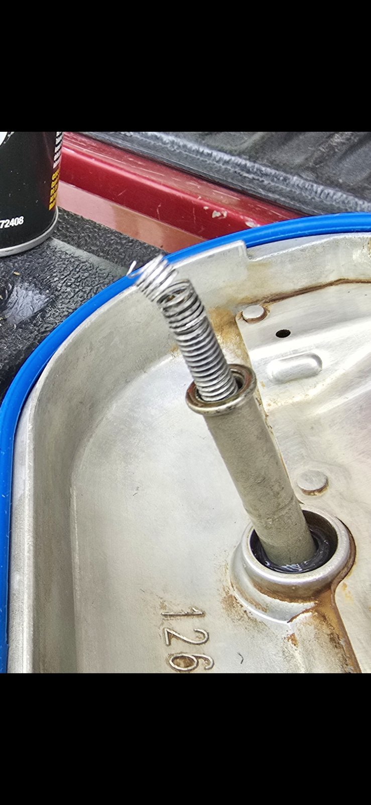

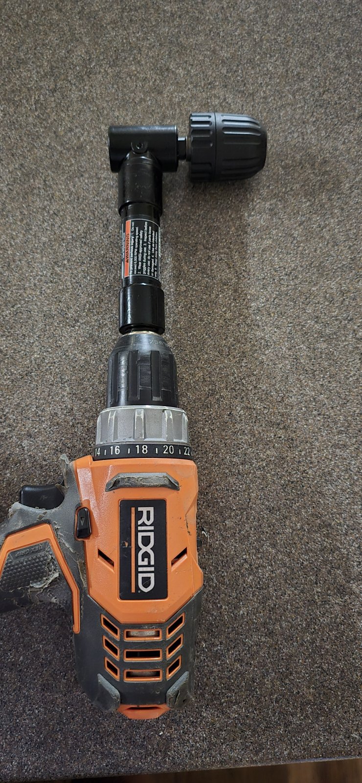

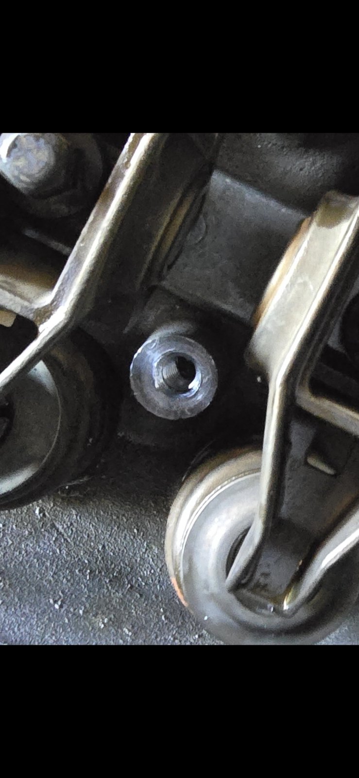

FWIW just did my first helicoil 2-weeks ago at age 67. Have wrenched on cars since I was 14 and never needed one until now. We had bought our '13 Tahoe used and the PO took it to dealer/shops for service. Had leaky valve cover gasket which should have been easy... found out why it was leaking. Whoever changed the valve cover gaskets before had massively overtightened all the hold-down bolts. Should only have been 99-108 inch/lbs. Thought I was lucky as all the hold down bolts seemed to come out fine except for rearmost on driver's side which wasn't anywhere near as tight as the others. Cleaned up everything, installed the new gaskets bolt seals and proceeded to torque them down with a small 1/4" ratchet and 8mm socket. Snugged the front three and when I got to the rearmost bolt, it initially started to grab but it gave way and just spun... stripped. Removed the bolt and the aluminum threads were still wrapped around it.
A $40 6-1.0 metric Helicoil tap, $40 insert key and $10 drill bit all to install the $1.89 helicoil insert. Also had to buy a right angle drill adapter at Harbor Freight ($20) so I could drill-out the damaged threads before re-tap and install the helicoil insert. Pretty straightforward and saved having to pull the head!
Wishing you best of luck as you proceed w/swapping out those heads!
