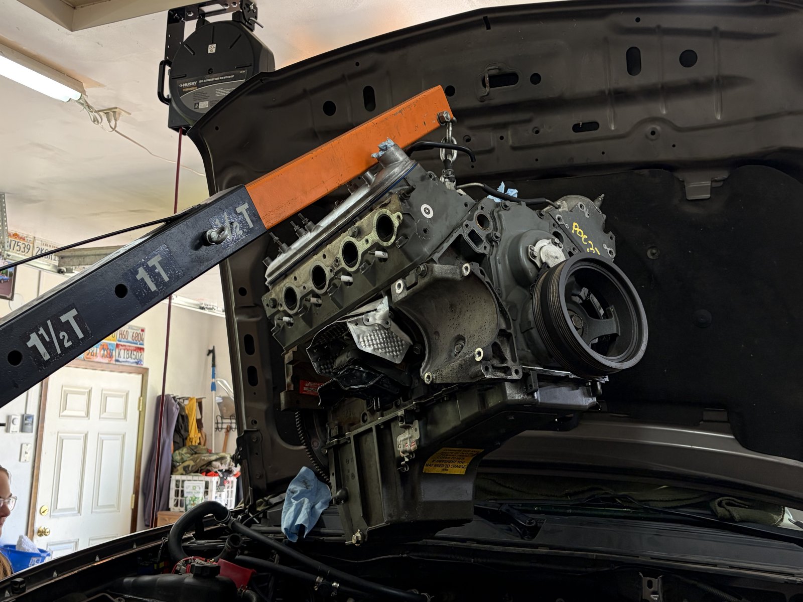

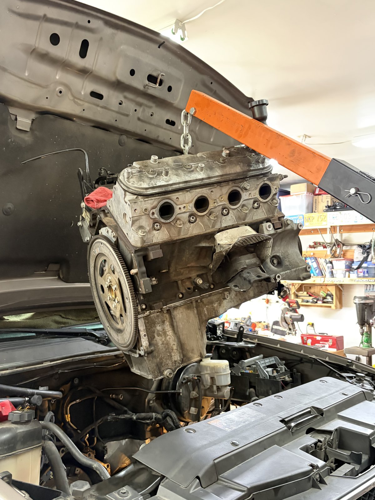

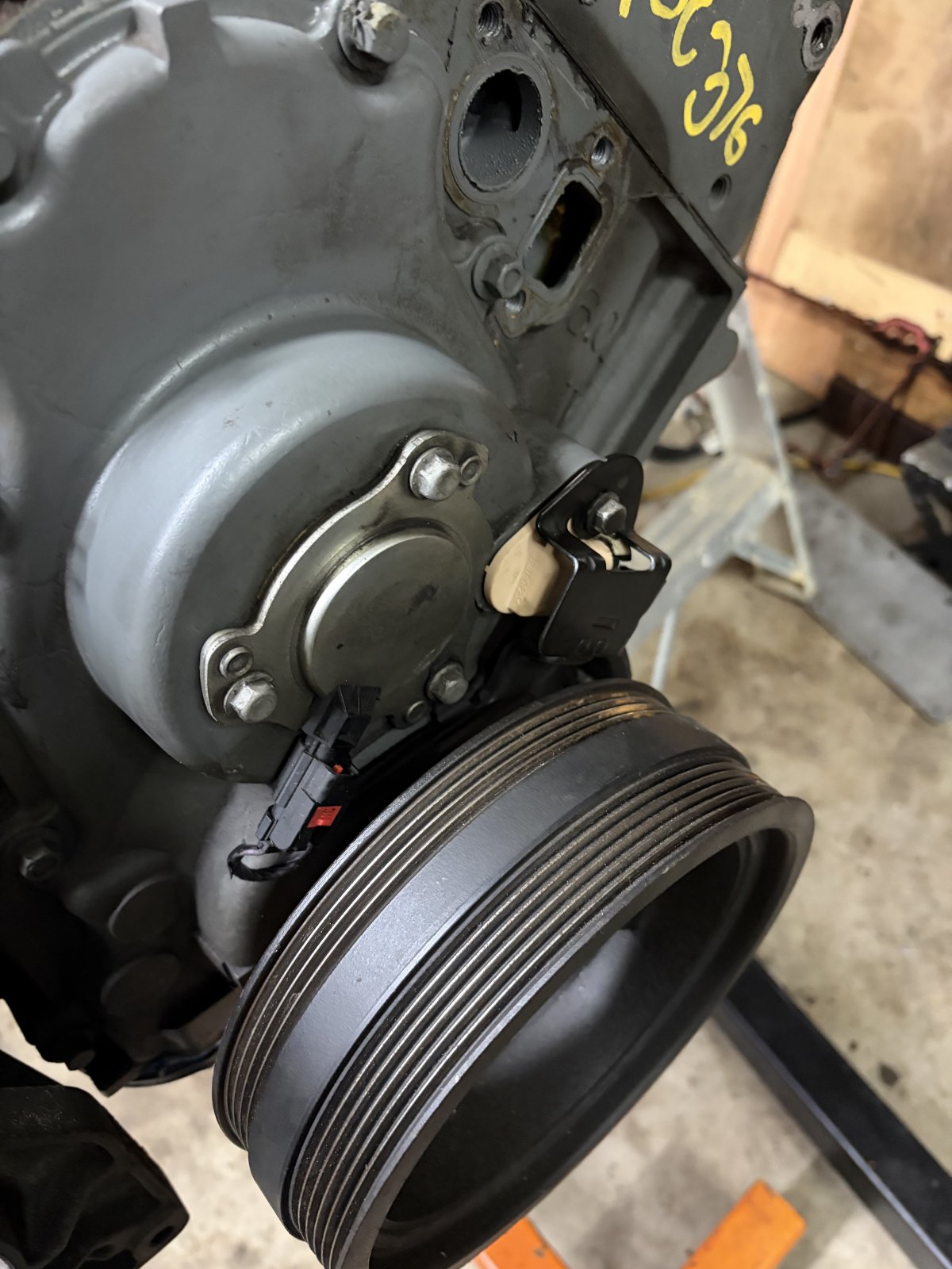

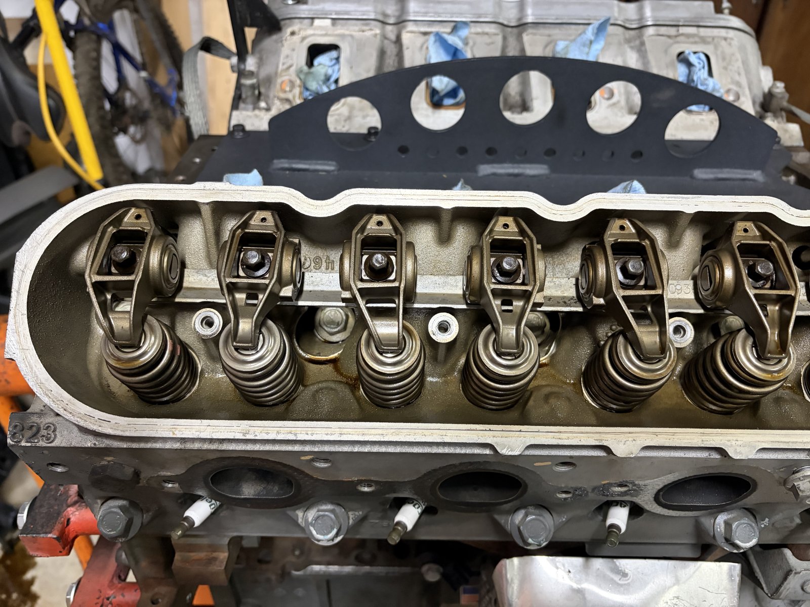

Tonight was installing the last parts on the engine before it goes in. (Except flex plate - has to be off the stand before that)
New genuine GM knock sensors
New Delphi crank and cam sensor
New AC delco iridium plugs
New fel-pro valve cover gaskets

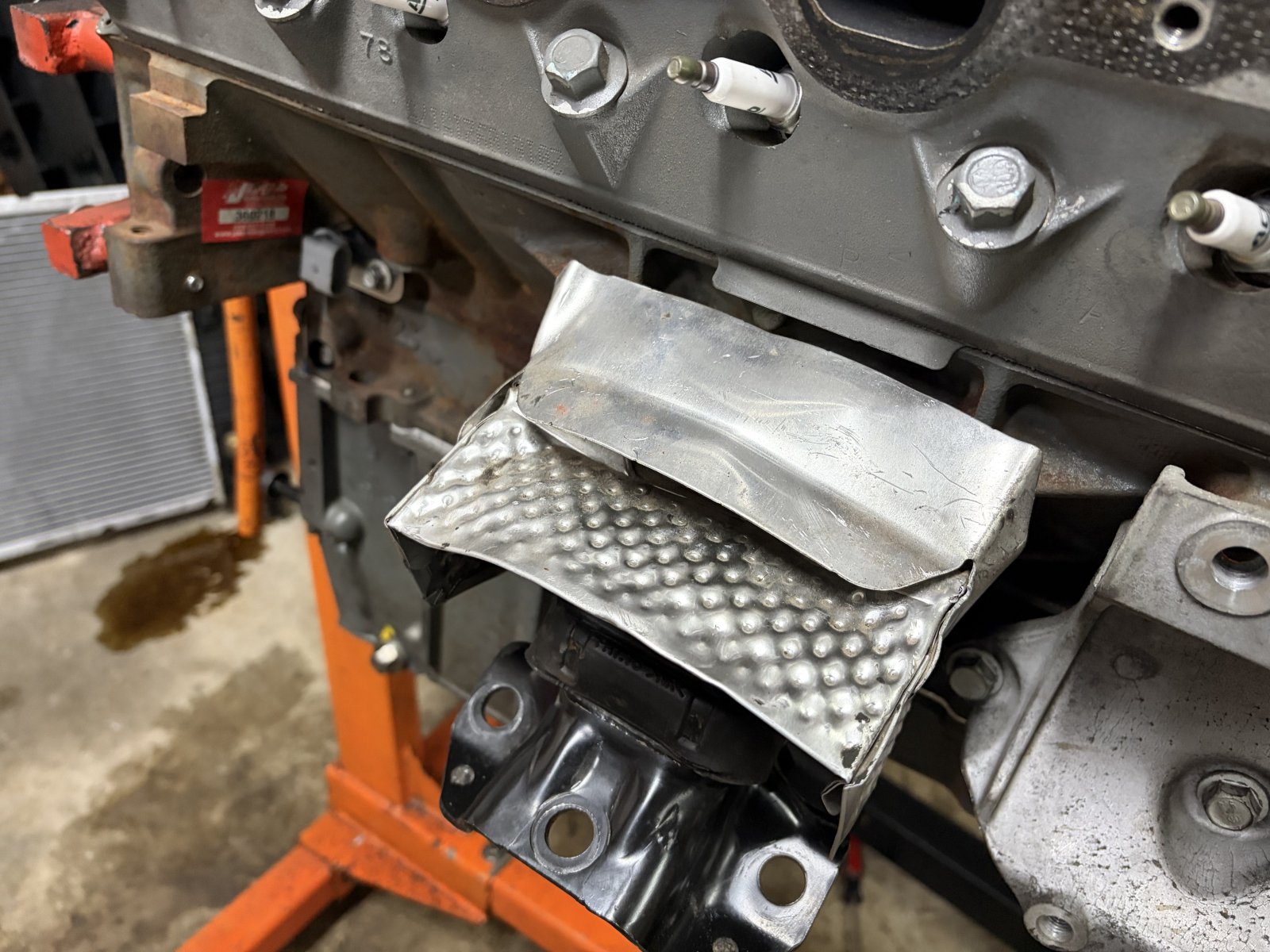

Brand new OEM GM motor mount for DS and one year old GM mount for PS (PS got the mount I installed on DS a year ago.
Everything else will get installed when engine is situated to give plenty of room to maneuver. It had to be turned sideways to get it out so I’m sure I’ll have to same getting it in.

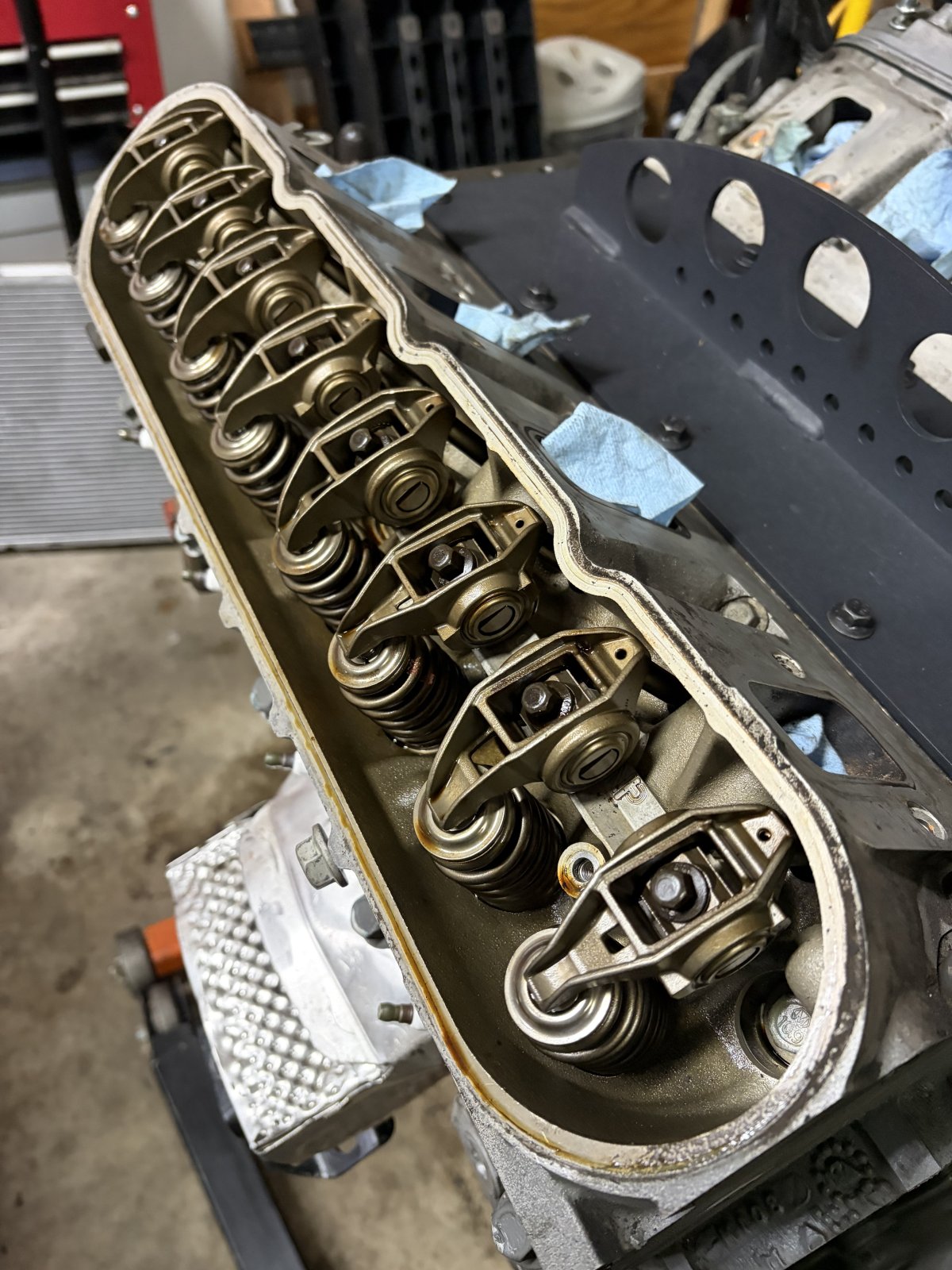

Rocker arms and related inside valve covers are amazingly clean. The drivers side cover itself was a little dirty due to PCV, but it cleaned up easy. I’ll use a catch can which will help.
Had to spend some time organizing the tool table too. Hoping to get bulk of install done this weekend.

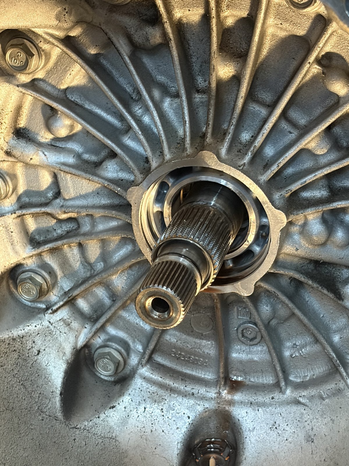

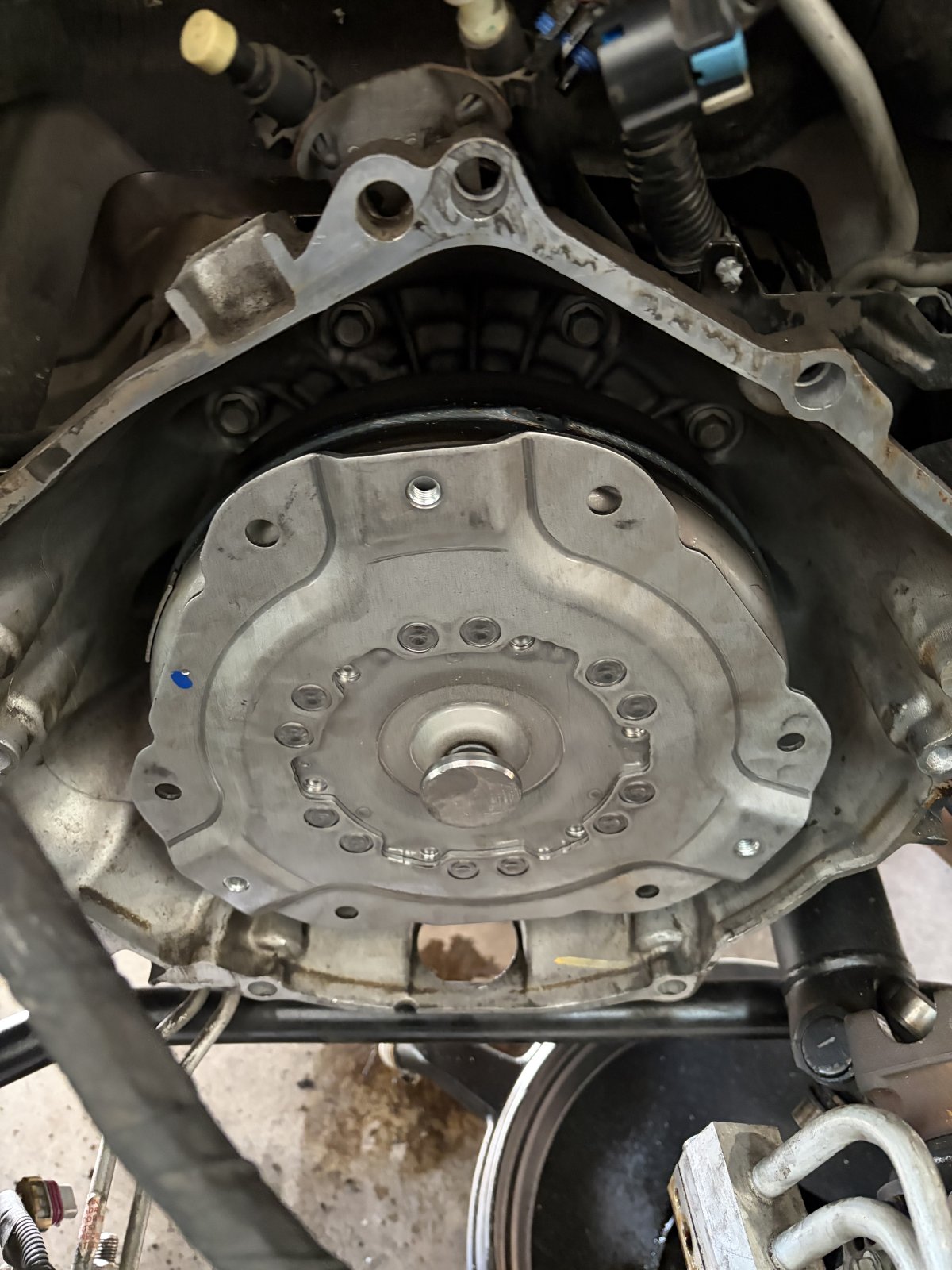

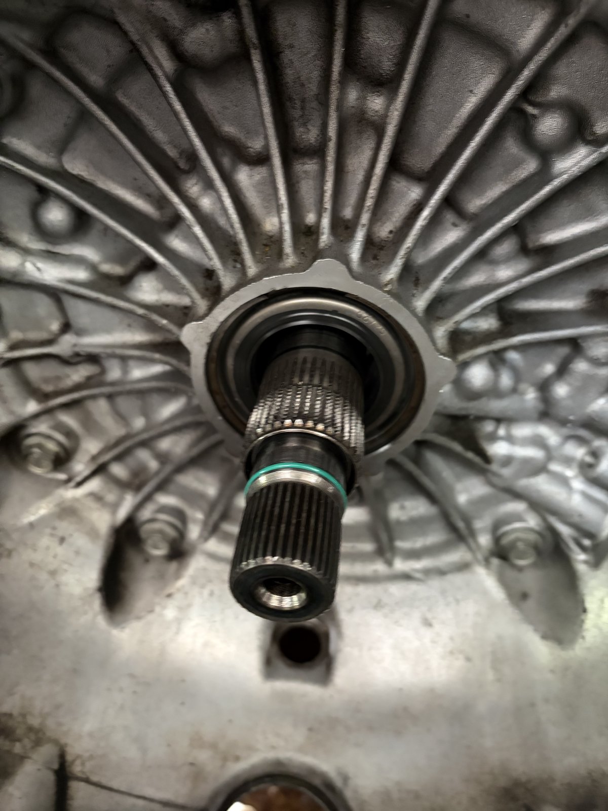

Input shaft seal and o-ring replaced today, Luk torcon TC filled with 1 qt delco dexron VI, and in place in bell housing. Ready for engine drop in tomorrow.
Interesting how much smaller the Luk is than the JMBX. I should have taken a pic of them side by side.

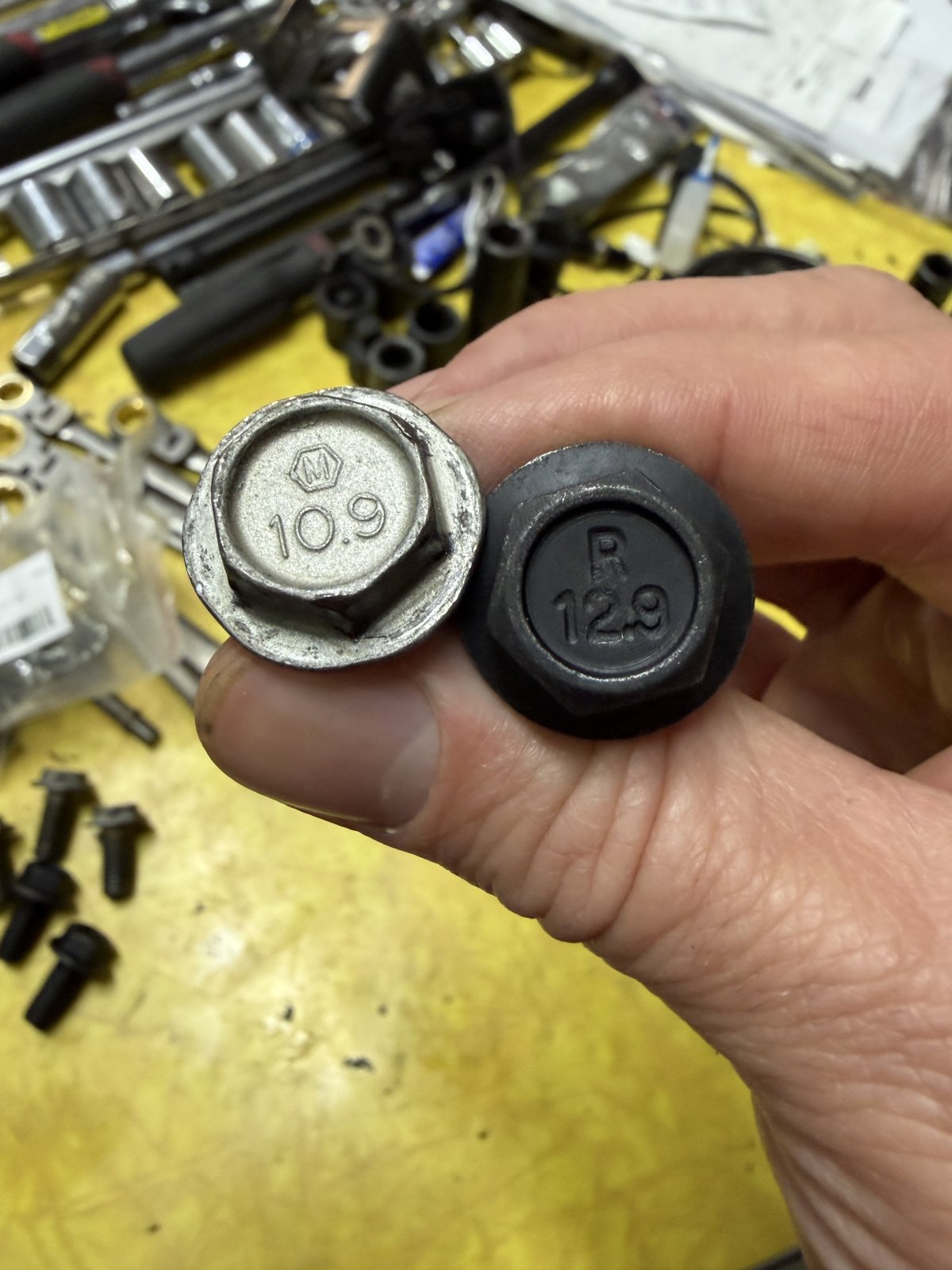

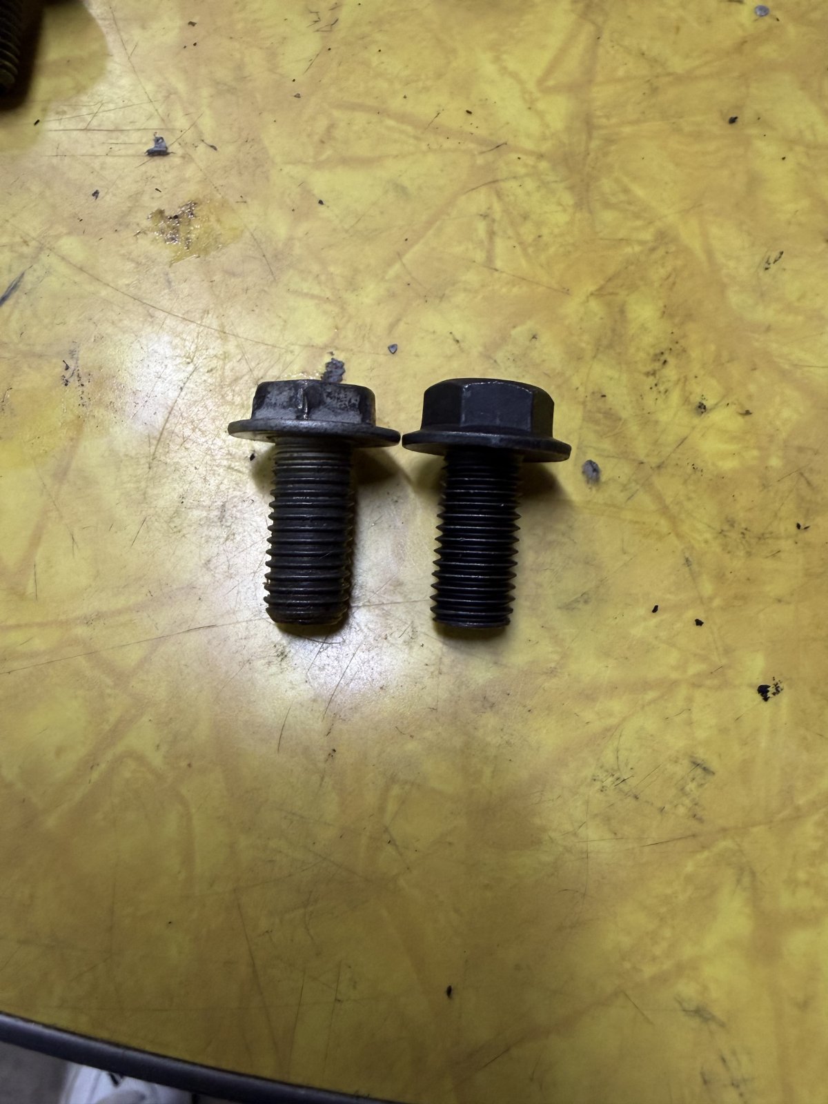

A dilemma on the flex plate to crank bolts. Plan all along was to reuse the bolts that came with Jasper engine, as I don’t believe they are TTY. But yesterday I discovered I was missing one so I ordered a set off Amazon.
But then today I found the missing bolt, so now I have a choice - new 12.9 gr from Amazon (China) or the 10.9s that came with the engine. Pretty sure I’ll use the new ones, but just slightly leery regarding quality. They are GSTP brand and 4.6 rating n Amazon. Bad reviews were about not threading properly into crank, but these go in fine. Any concerns?

I would use the old bolts. Your new ones have a taller head on them, wondering if they are flywheel bolts and not flexplate? Had that issue a couple years ago... The nose of the torque converter made contact with the bolt heads about a 16th of an inch before the mounting pads contacted the flex plate.
If you want to use the new bolts, Mount your flex plate and check the clearance by test fitting the torque converter.... The bolts have a short head on them for a reason.

Definitely a good thing to check, thanks. There is plenty of clearance, tho. I put all six crank bolts in the flex plate and then lined it up with TC mounting tabs. The way the Luk is designed, there is a lot of clearance back there. With plate snug against TC I could push the crank bolts far enough back that they’d fall out.
And yep, using blue loctite

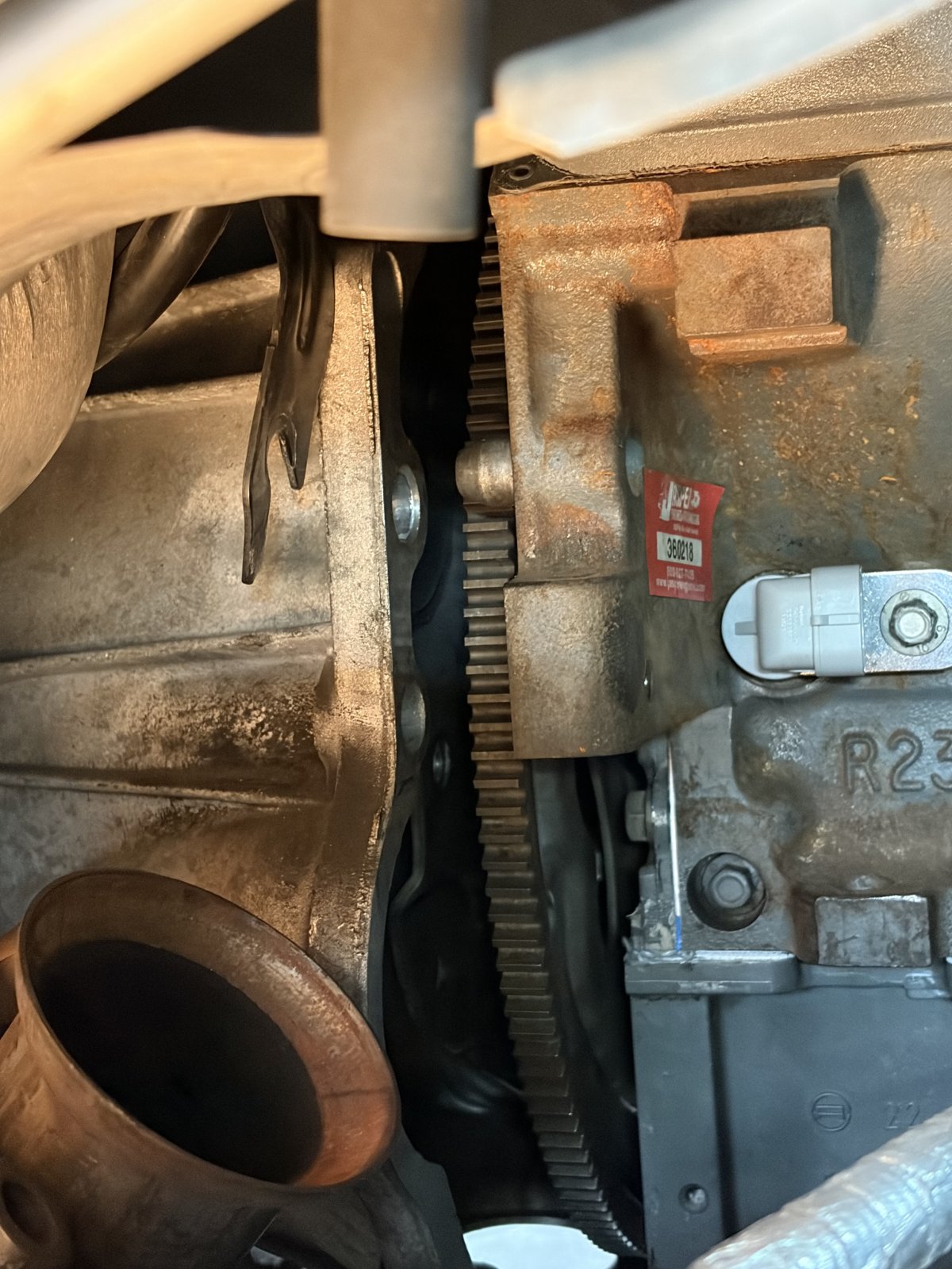

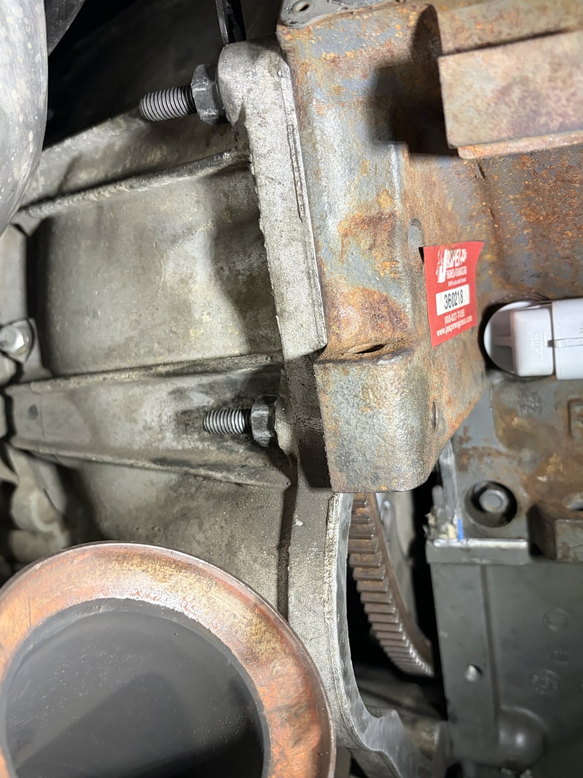

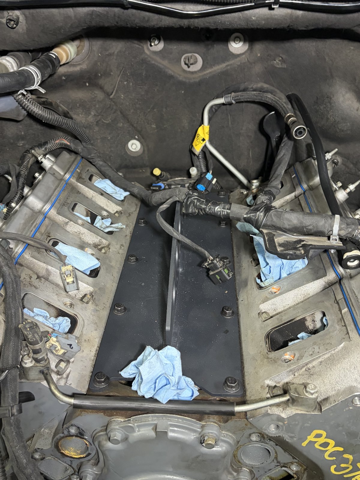

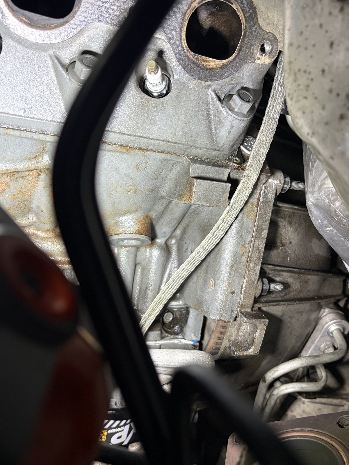

Engine in! Got it on the motor mounts and got the trans at the right height, simultaneously trying not to crush any harnesses or cooler lines/making sure they were in right location, getting AC comp in its bracket, etc. Got the dowel pins to line up and got trans to mate part way; had to very gingerly and slowly use the bell housing bolts to snug it up and fully seat. As of tonight all 8 bell housing bolts in and tight.

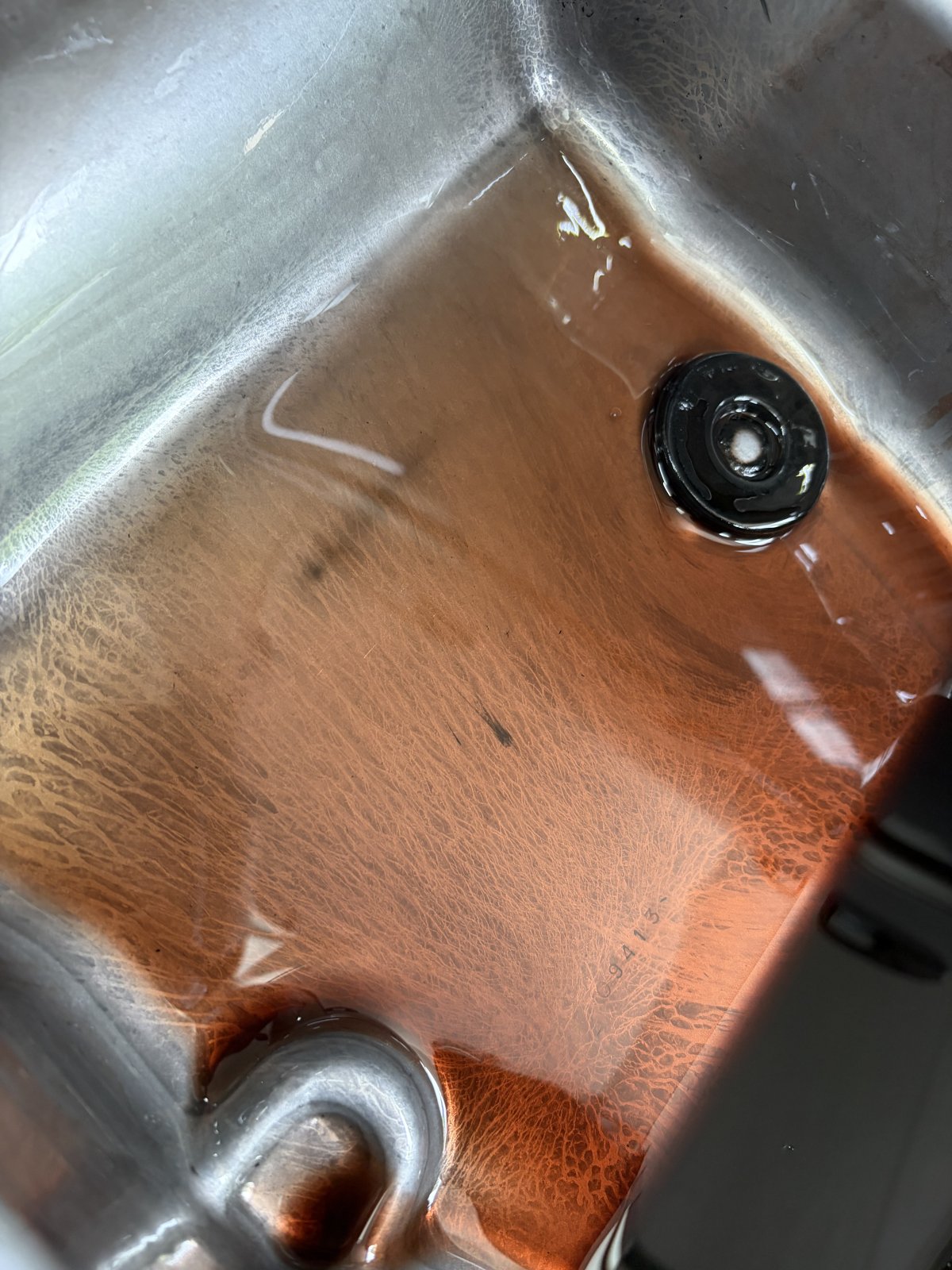

Pam drop and filter change today, as mentioned above. Saw some very fine silvery residue in the bottom of the pan. How bad does this look to y’all?
rdezs
Nov 6, 2023
1,368
2,540
I always go by the feel. If it feels like find powder between your fingers, normal wear of things like clutch plates. If it actually feels like larger particles that are sharp and gritty.... The transmission is further along in it's lifespan and you might want to plan accordingly for the future. Even then though, with regular fluid changes driving it normal, it could go for a long time
