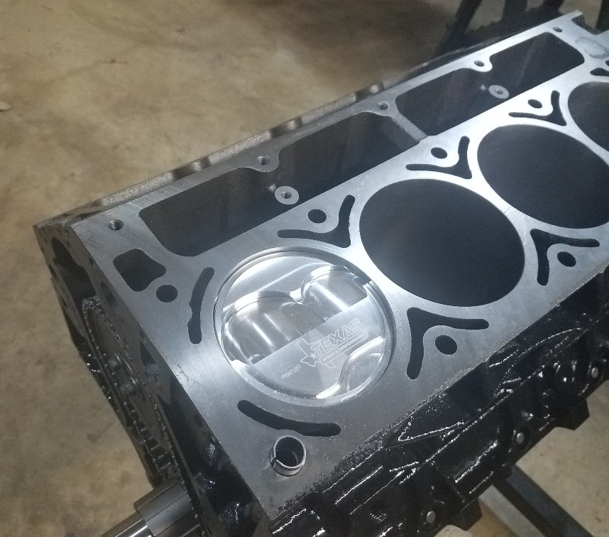

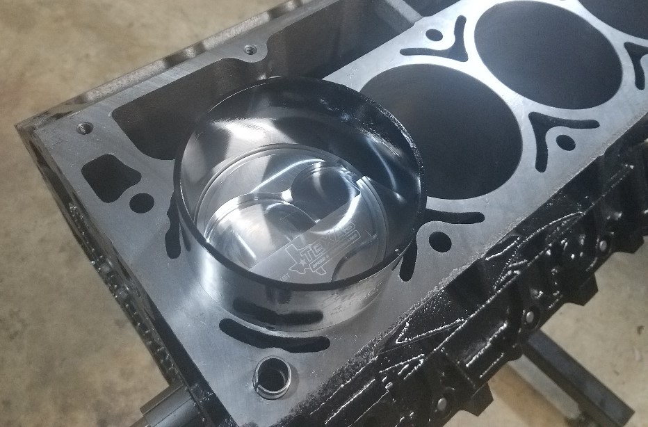

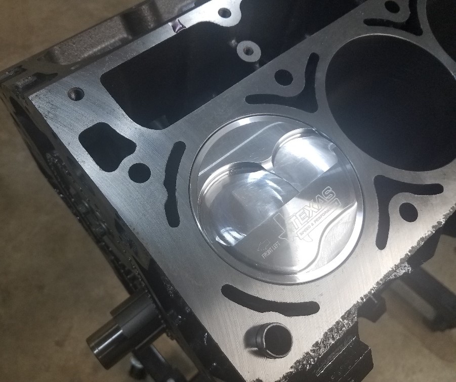

I found time last night to install a couple of pistons. I wanted to ensure the piston ring compressor would work. I was going to install just piston number 1, but it was so easy I installed number 2. The key was to lubricate the cylinder, the inside of the compressor and the piston/rings. After that just slip the piston into the compressor, make sure the rings are correctly aligned and not off to the side, then tap into the cylinder. As the piston slides down the compressor the rings get compressed and slides into cylinder. So Simple. End play/clearance checked good. Six more to go - hopefully this weekend.
