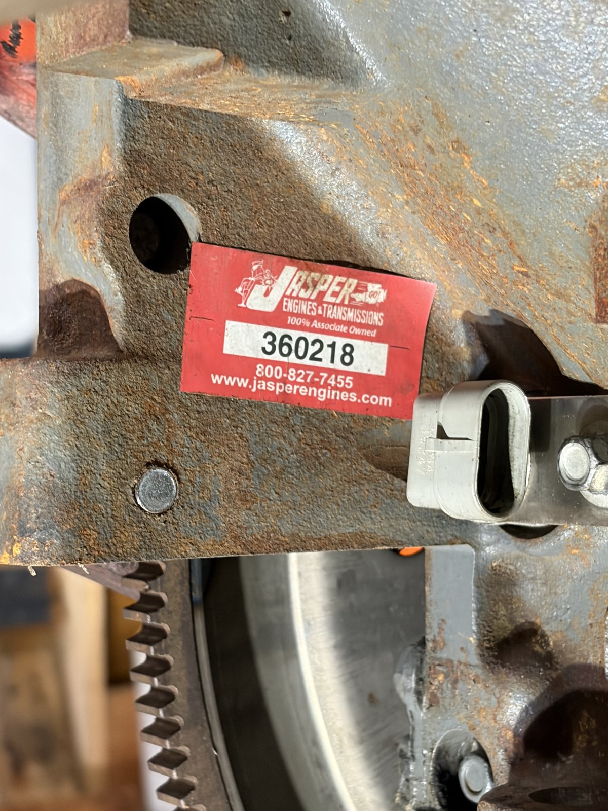

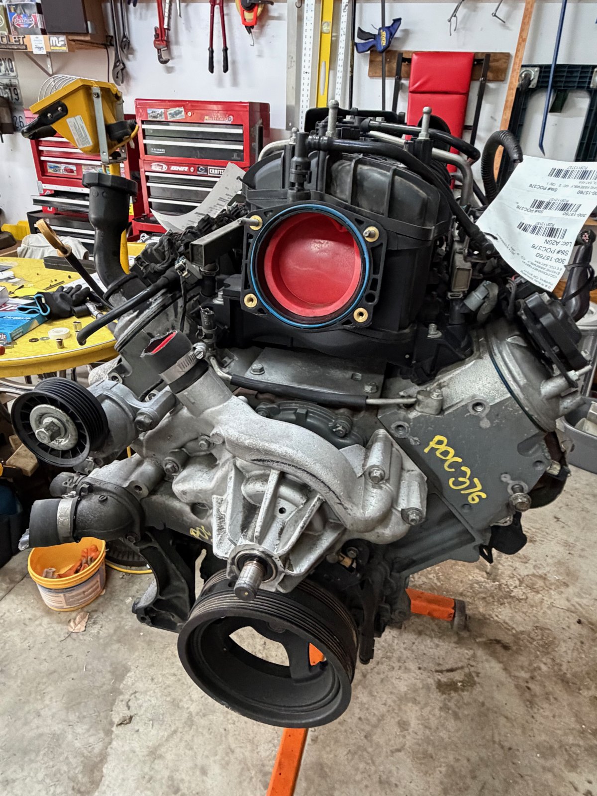

Say hello to my new engine - L96 6.0 from a 2014 2500 Silverado. Bought it from B&R Auto Wrecking, Portland, OR yard. The truck had 197k on it, but engine has a 6 month warranty and compression values 190-200 psi in all cylinders. Plus I'm wondering if it's a crate replacement, see later in the post.
This will be my build thread - over the next 2-3 months I want to get it set up properly and then install. More in subsequent posts.

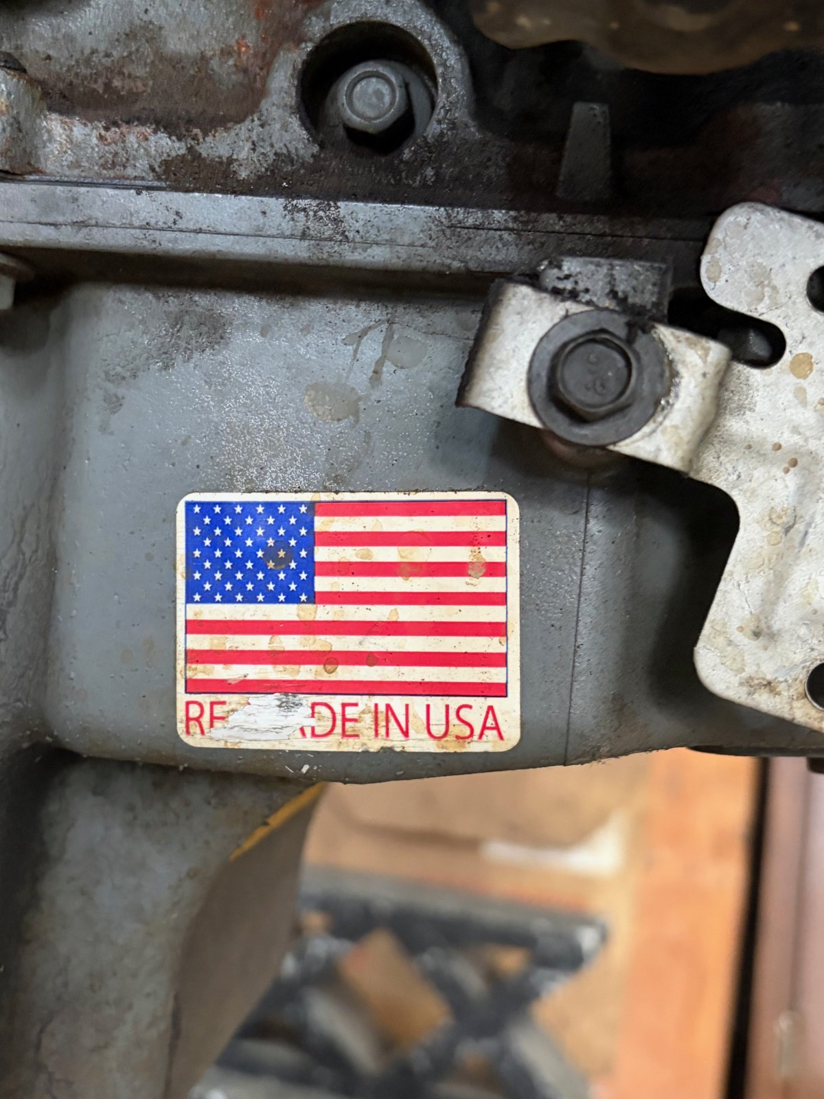

What does this sticker mean? Reman? I haven't done any legwork on engine ID yet.

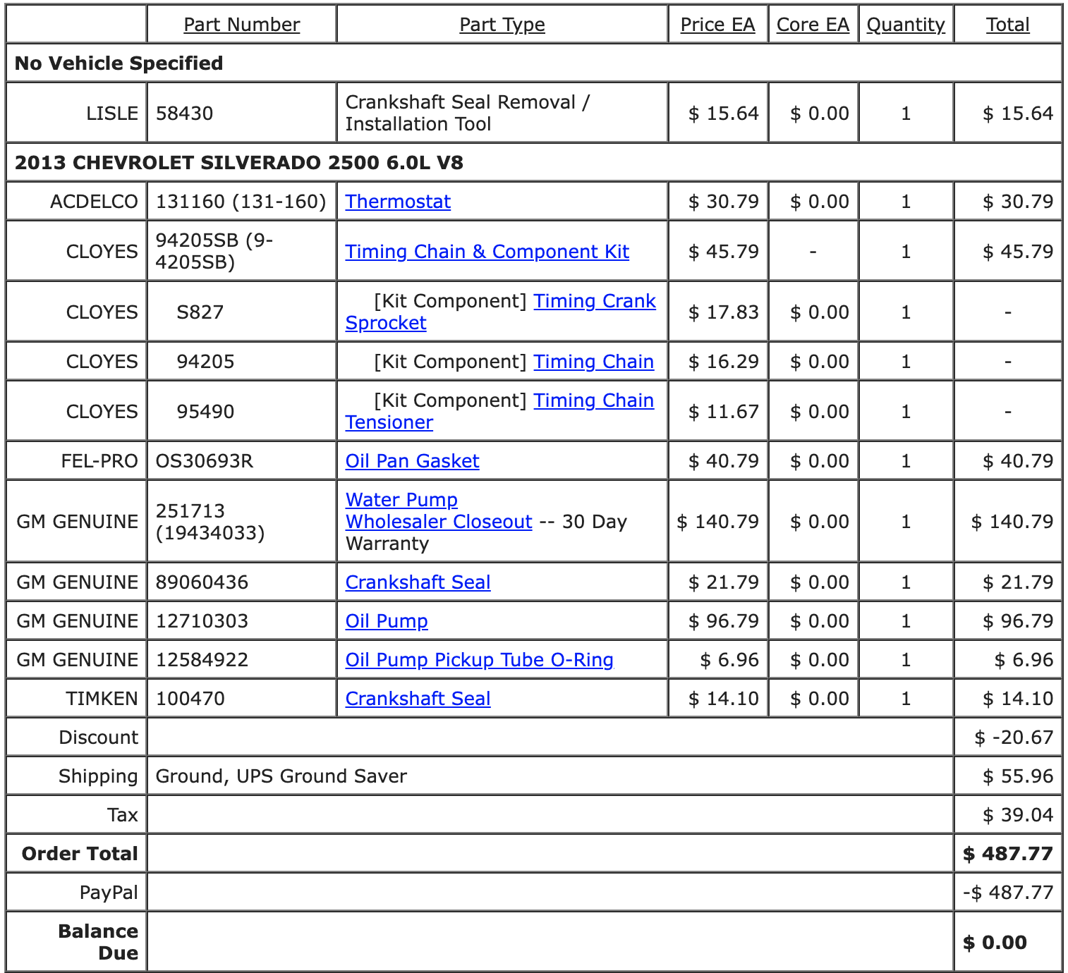

Here's what I've ordered from RockAuto so far. I'm also going to do cam and crank sensor, just haven't ordered yet. Let me know if you see anything I'm missing. For warranty on engine, I'm required to replace water pump and thermostat, everything else is just for piece of mind.

Looks great!
That all looks legit to me. Are you also replacing the rear barbell? I don't really think it's necessary but it's not that expensive to byy a new one.
"Remade in US"?
Thanks for the tip/reminder - yes, definitely need to replace that. Cheap insurance. Ordering a billet aluminum one.
Yeah, that's what the sticker is, I'm not sure what it's all about. I googled it, didn't really find much.

I called Jasper yesterday and gave them that number - they told me the purchase date was July 2022! Didn’t have the truck mileage at time of purchase but based on average miles per year, engine should have less than 70k. Might change my calculus in parts to replace now. Thoughts on oil pump and timing chain? I haven’t taking pan or timing cover off yet - will do some assessment when I do.

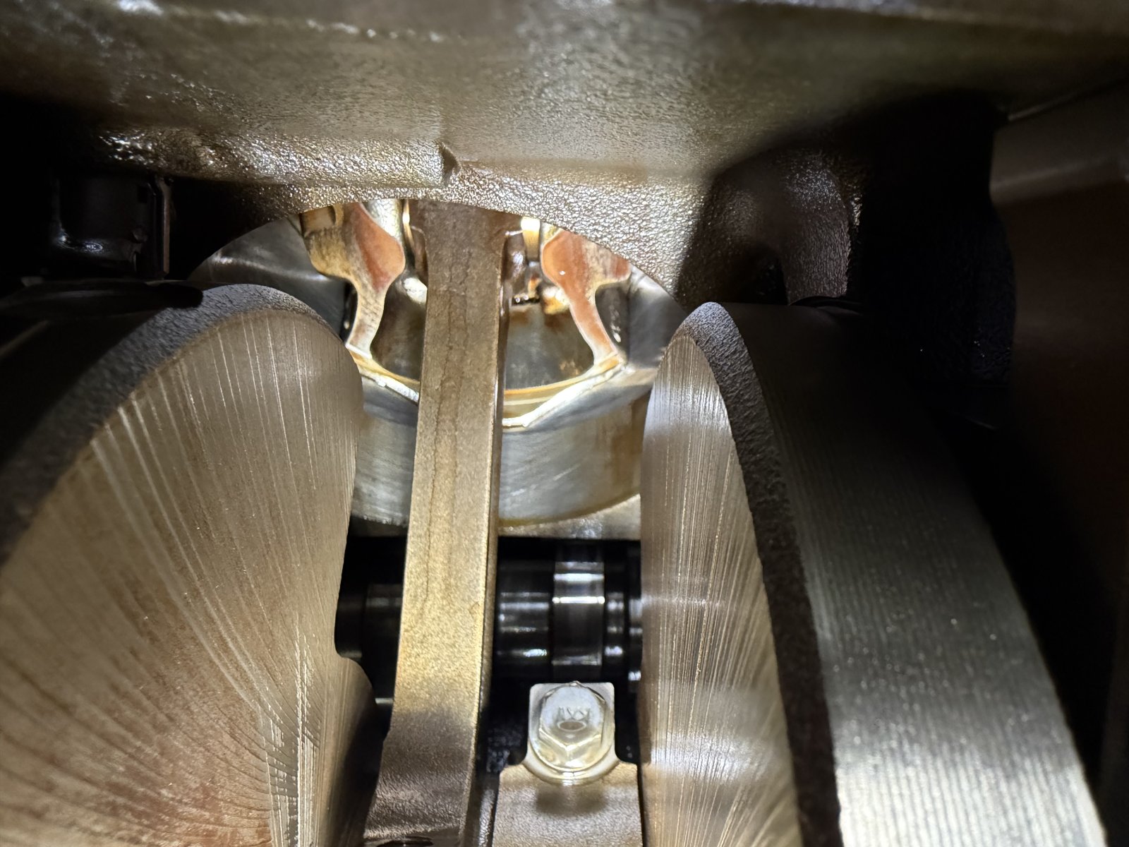

Thanks! Yeah, pretty much - I'm required to replace the water pump and thermostat for warranty coverage, but I think I can handle those. Oh and you're required to take the pan off and re-seal, so I guess I should do that. It will give me a chance to inspect bottom end.

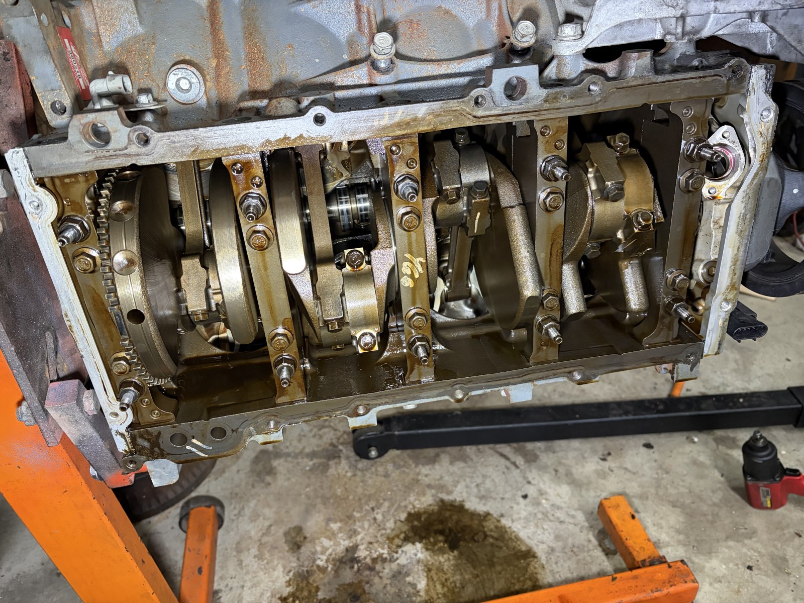

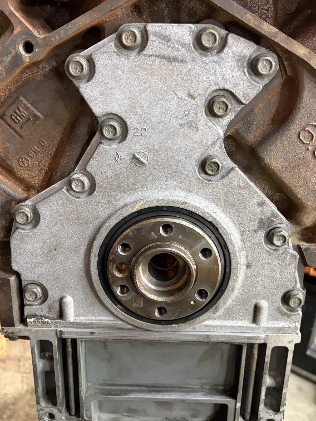

Here's everything I'm doing to the L96 before I remove LMG and install:
- Remove oil pan and windage tray. Inspect bottom end and lower cylinder walls. Replace oil pump pickup o-ring. New fel-pro pan gasket.
- Replace RMS (Genuine GM) and new rear seal cover gasket (fel-pro)
- Replace barbell with billet aluminum version
- New genuine GM exhaust manifold gaskets.
- ARP header bolts
- New AC Delco Iridium plugs
- New AC Delco water pump (came with installed thermostat and water neck)
- New fel-pro valve cover gaskets. (inspect rocker arms, etc.)
At this point, I'm not planning on taking the balancer off, removing timing chain cover, or replacing front crank seal. I saw no signs of seepage up there, so see no reason to disturb any of that. I'm a little torn on cam and crank sensors, though. Right now, I'm planning on keeping as is.
Let me know if there's anything I'm missing or if any of my logic is off.

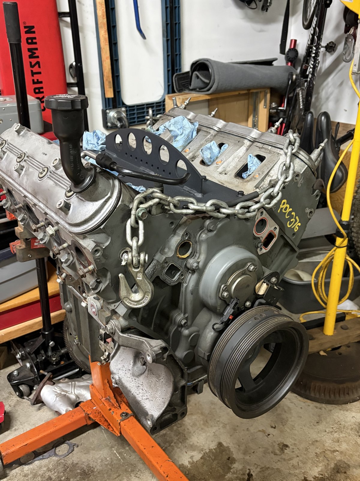

Making progress on the swap. New engine pretty close to being ready to go in. New barbell, oil pickup o-ring, RMS, rear cover gasket, pan gasket etc. added the girdle to oil pump pickup too.

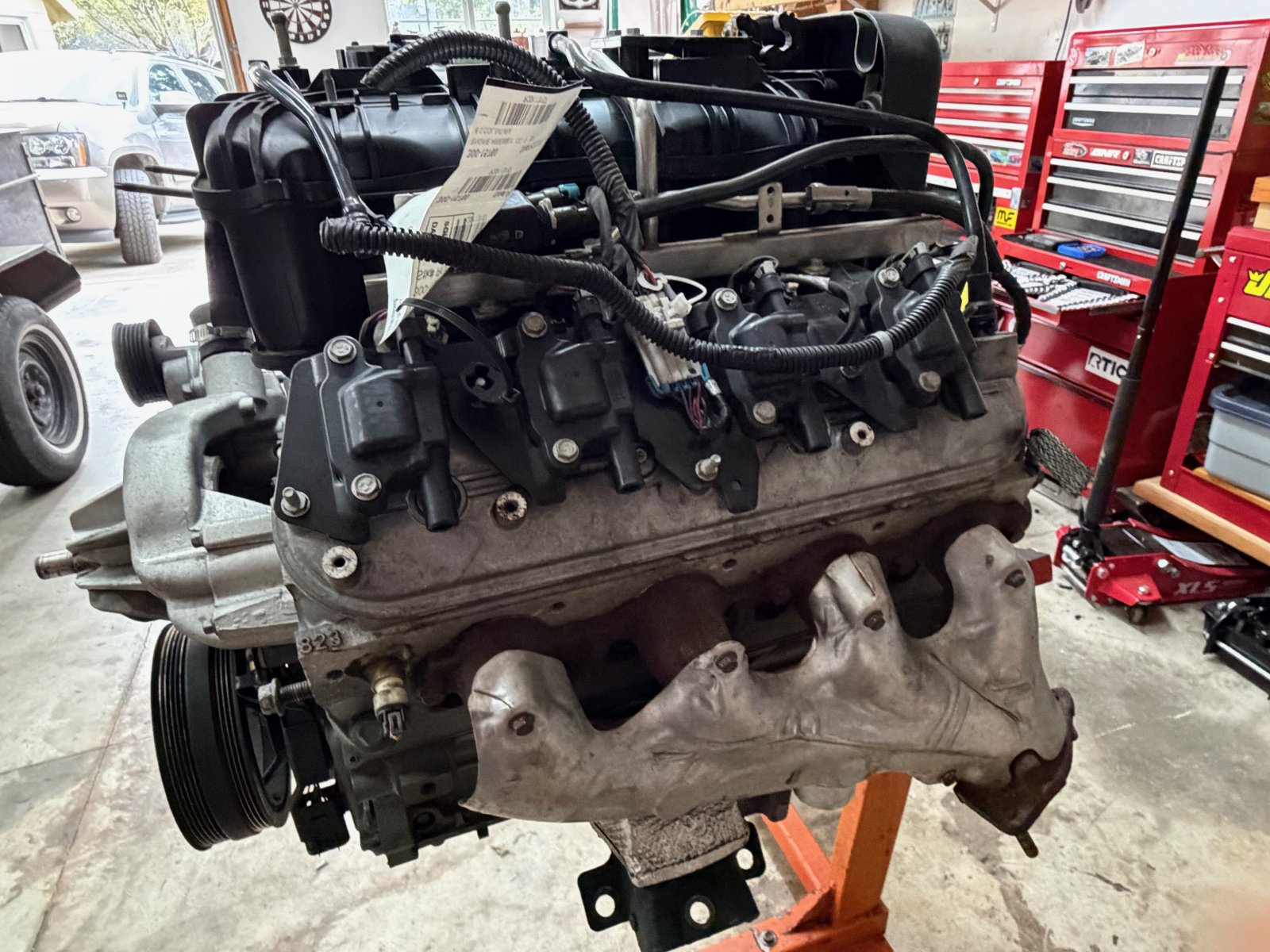

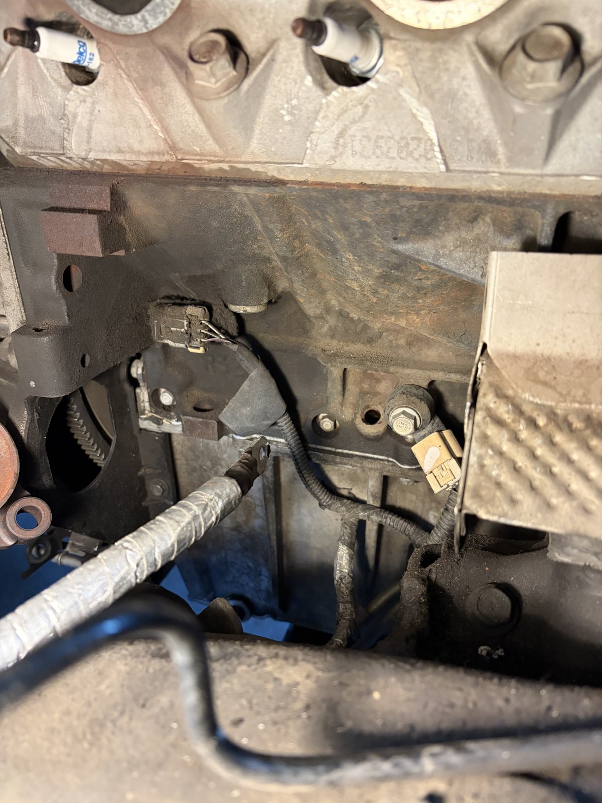

Worked a bunch last weekend on getting the LMG ready to pull. Tonight I got out all the bell housing bolts so should be the last major hurdle. Having the intake out is key for the top two bolts and exhaust manifolds out made the four side ones a breeze. In a previous post I was debating removing the core support, but I think I’m just going to go over it now. I will support the trans with a ratchet strap to the frame and then will lower the front of the truck almost to where the brake rotors will touch. My cherry picker should be able to get it up and over that way.
Question: second pic below shows two electrical connectors. The one by the motor mount secured with a bolt is a knock sensor, correct? What is the other one?

@Dave09
crank position sensor above/behind starter
Ok cool, I that’s what I was thinking but there’s another sensor by crank pulley on front that I thought was crank sensor. What is that one?
EDIT: Nvm, I now realize what I was looking at below the balancer is just the connector for the cam sensor. Didn’t realize the the wires from cam were routed down to the bottom for the connector.
