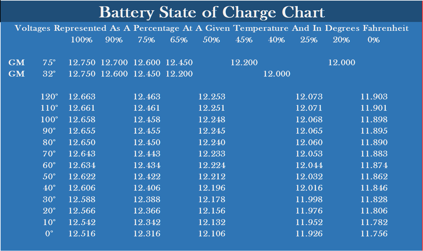

When this happened to me, it was a loose positive battery cable. After sitting overnight, what is your battery's State of Charge?
If the battery is below 65% it is considered discharged and due for replacement.
Battery isn't showing any signs of discharged state, that's why a load test is going to be more imformative then anything else
