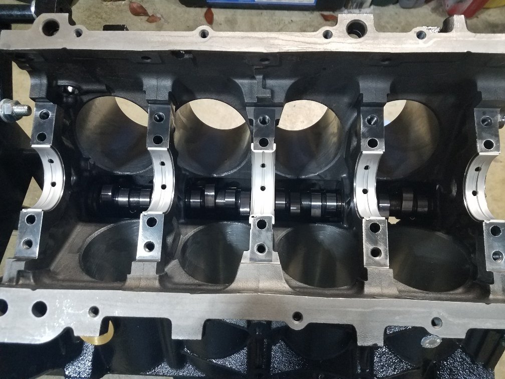

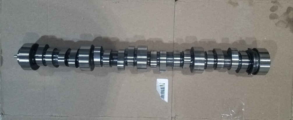

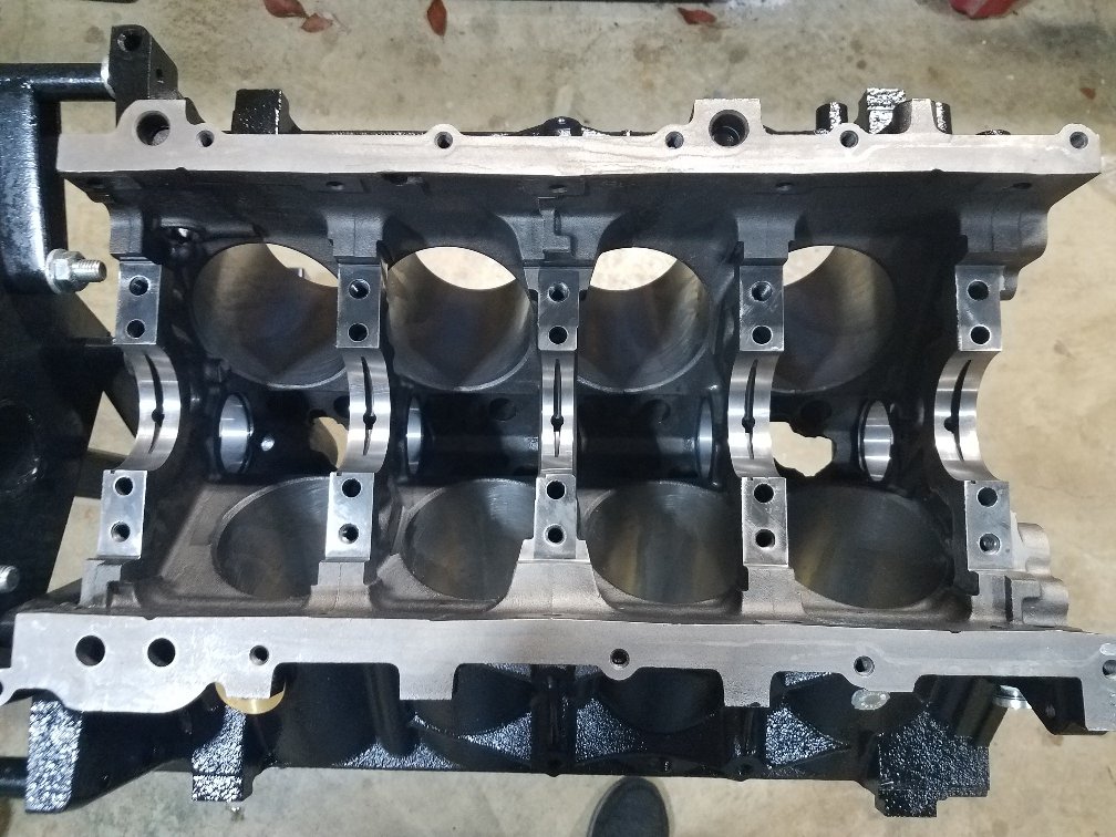

Made some progress today. Cleaned up the block some more and removed the bearing caps. Then did some additional cleaning. Made the decision to install the camshaft at this point and ensured the bearings (non factory bearings were properly lube. Cleaned and fully lubricated the camshaft and then installed it into the block.
Bearing Caps removed:
Camshaft fully cleaned:

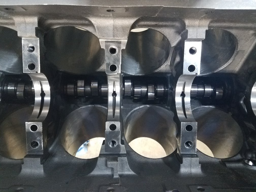

Camshaft Installed. I ended up temporarily installing (hand tight) the camshaft cover and timing sproket to keep the camshaft inplace. She rotates very smoothly with no hang up spots.

On to the crankshaft. So I needed to first plastigauge my bearings. Installed the bearings:

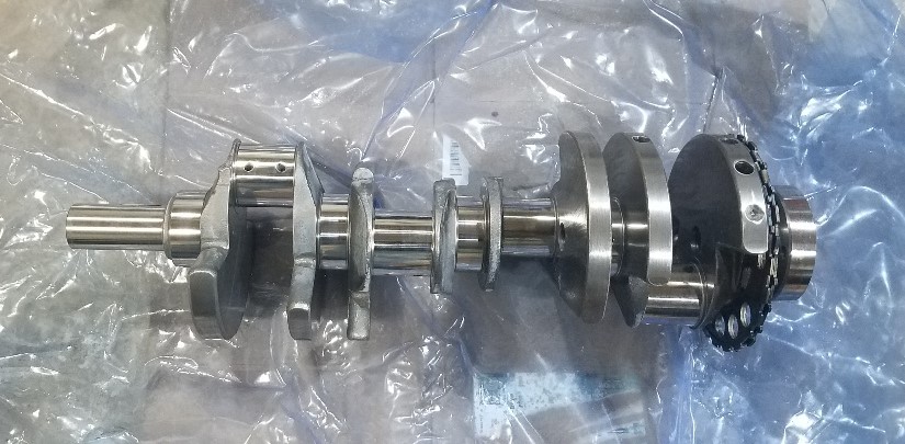

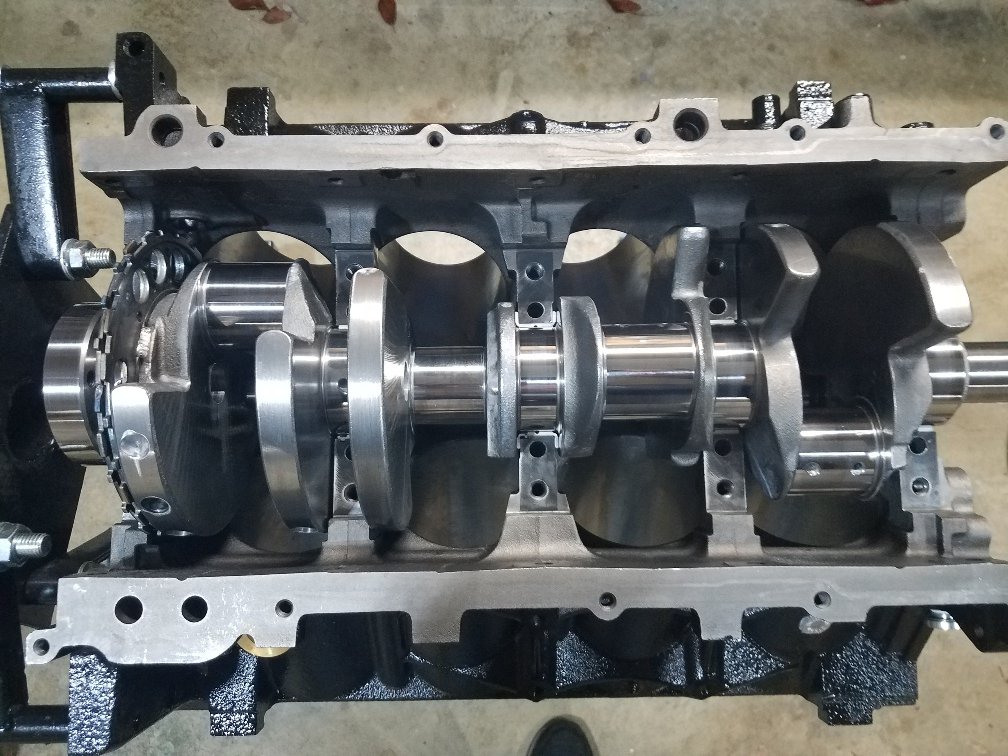

Cleaned the crankshaft:
Carefully lowered the crank in place:

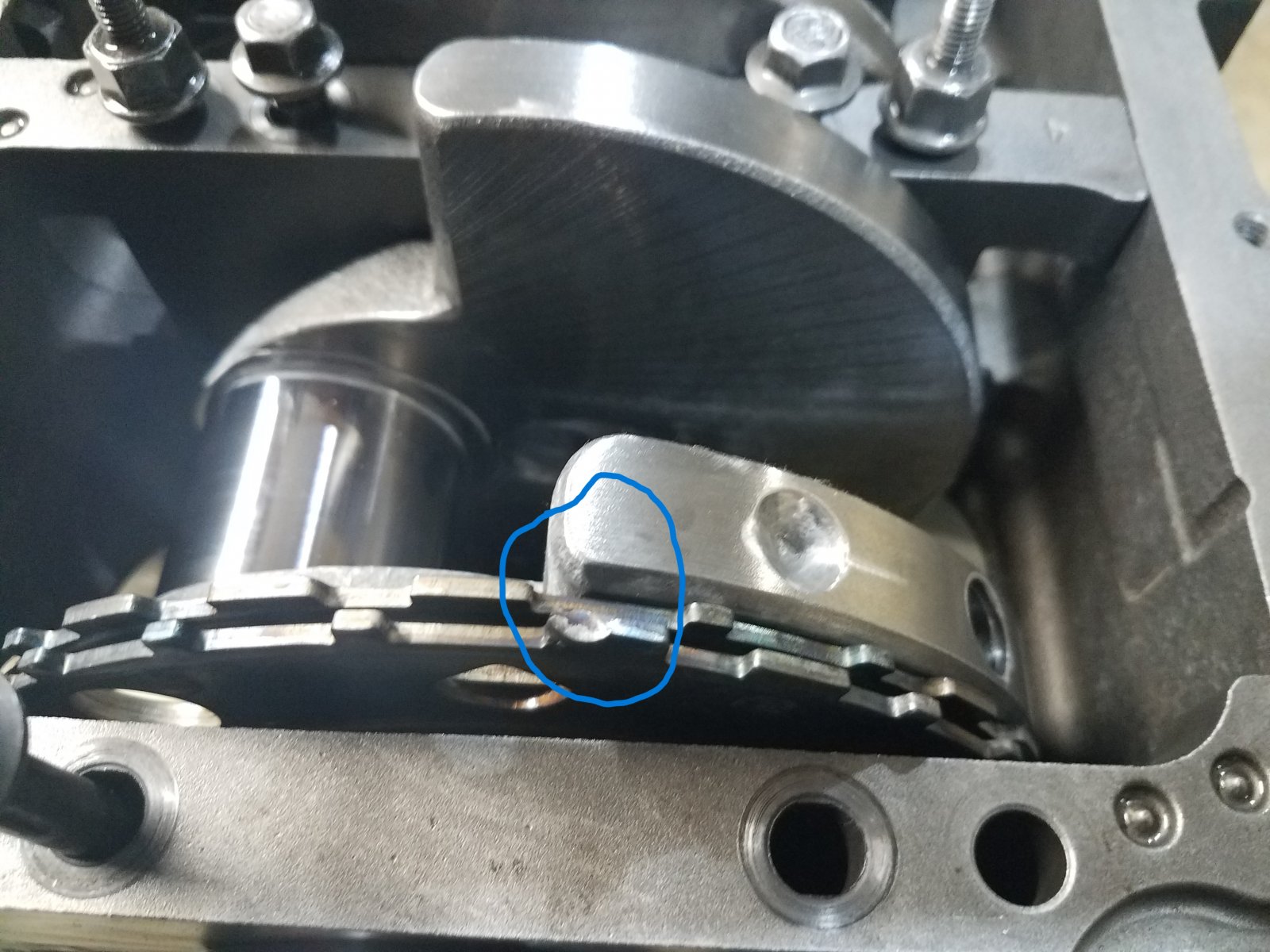

It was here that I discovered a major problem. I found some major damage to the reluctor ring.
So, obviously this is not good. I called Texas Speed and they also stated that is a problem. They gave me two options. 1. they would send me a new relucter ring and I can have my machine shop replace the damaged one. I already look at that as a possible option, but my guy is on vacation for the next three weeks and he is already backed up. 2. They would provide me a shipping label to ship it back to them for the repair. I went that route. Should get it back early January. I asked if I could continue my bearing check and they said go for it. So I did, sorry no pictures I forgot and quite frankly I was not happy at this point. However, all bearings were at .002. Disassembled the bearing caps, cleaned all bearings surfaces. Pulled the crankshaft. Boxed it up. Placed the shipping label on it and sent it off.
So another delay to the build project.

At least you noticed it before it was too late.

That sucks about the reluctor but you can’t get in a hurry building a motor. You only get to put this part of it together once so take your time and make sure everything is done right. :happy107:

Totally agree. Crazy thing, I'm not sure how I missed that damage while cleaning it. While cleaning the crankshaft it never came anywhere near anything that could damage that beefy ring - just my workbench (wood) and some lint free towels and rags. Hell my old crankshaft is still sitting on my garage floor and gets moved around and it basically still has no damage like that.

I had the same thing happen with a brand-new GM gen 4 6.0 crank.
They even shipped it in the factory GM wooden crate.
But somehow UPS managed to drop it at some point.
The reluctor had some slight bend to it, so it wobbled when spinning.
but it stayed within the sensor path.
I had a few little nicks here and there that weren't too bad, mostly looking to be sure the sensor can pick up a solid signal with the correct sizing.
At first, I started by filing them smooth, then as I worked it, it only got worse as i went to the next one. :jester:
The final "this reluctor is fkd" moment was when I found one of the teeth that was pretty much squashed, taking out a good 30% of the tooth.
I bought mine from summit racing, and they were nice enough to ship me out a replacement before they received the old one back reducing down time. :happy160:
When you get the replacement, really look over the crank.
even check for any sort of bend that the crank might have taken.
If you happen to have a dial indicator, that would be ideal.
You will probably need one anyways for finding true tdc, crank end play, and I found it helpful to calculate how far out, or how deep the piston sits in the bore so I can order the correct head gasket for my target compression ratio.
