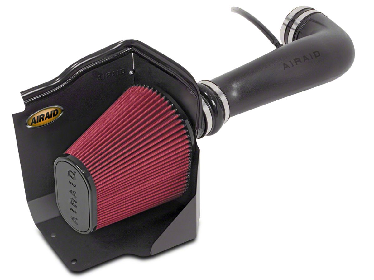

I used the air raid that just has the two sides and seal to the hood. Same filter and pipe
45,012
No top cover, just a rubber seal that seals it to the hood... In my experience, the ones with lids don't allow enough airflow through the small inlets, specially when the truck isn't moving
How much air does the engine need when the truck isn't moving? Or does yours idle at WOT?
I'd rather the engine get as much outside air as possible than suck in 120°+ engine bay heat. There's just too many gaps in the "heat shield" type enclosures.

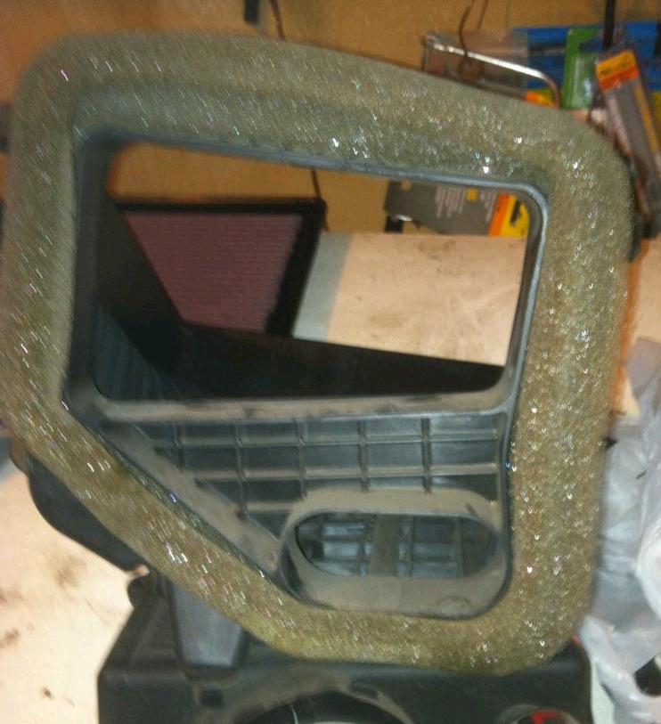

More than you would think... It can affect the quality of your idle. My intake shows NO signs of "120°+ engine bay heat". I would notice since I monitor IAT and IAT 2 very closely with my blower. Cold air doesn't help a blower if there is a restriction somewhere and a positive displacement blower like the OP is going to be using will be VERY sensitive to restriction before the throttle body and cause major HP loss. I'd take slightly warmer air with no restriction vs cold air and a restriction any day. But again, my IATs show no sign of "120°+ engine bay heat"

With my stock air box modified the way it is my IATs run about 2-5° warmer than outside temps while cruising down the highway. The only time they go up is when idling or in stop and go traffic.
