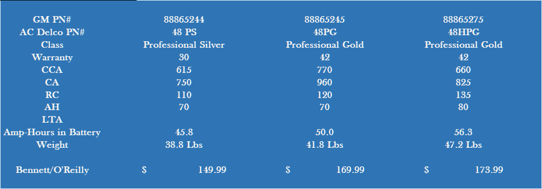

Another AC Delco battery, this time a 48HPG. It has slightly more cranking amps and has a higher reserve capacity of 135 minutes over 110 and a higher discharge capacity, 80 Amps versus 70. It weighs 8.4 pounds more, going to reduce our cargo and towing capacity! LOL

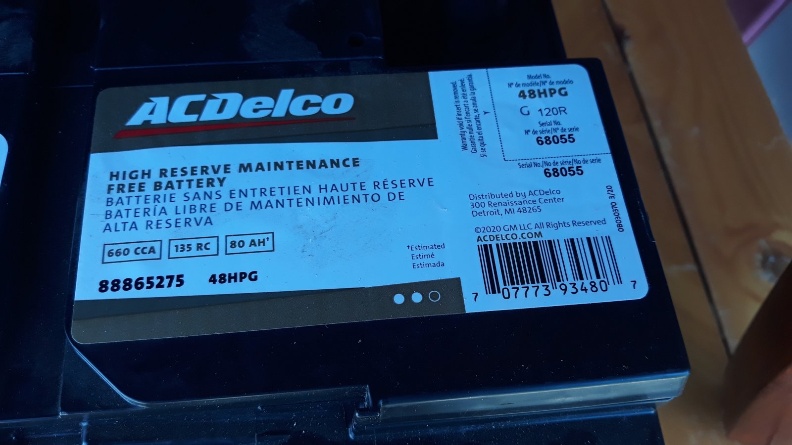

Well, I finally quit kicking the can down the road, didn't want the wife and kids to get stuck on my account so the battery was replaced today.
The ACDelco Professional Silver series battery, a 48PS, was manufactured in August of 2016 and installed in December of that year. It is listed as a 30 month battery by ACDelco; meaning free replacement if it fails inside of 30 months.
It endured several discharges including one that drained it to less than 6 volts. All of that is on these pages. In the end, the battery served for 48 months, 48,658 miles and 1,697 engine hours. It cost $129.46.
The new battery is an AC Delco Professional Gold, a 48HPG and is a 42 month battery. It was manufactured this month and cost $173.99.
These are the three that GM recommends for our trucks, they are the most compatible with our charging system. I chose this one for it's higher reserve capacity, something the 48PS was always light on. I do not need the higher cranking amps that the 48PG affords. When I was a kid and well into adulthood, we always put 900+ CCA batteries in our cars, even the little V6s!
During installation, there was a light build up of crud on the bracket that goes down the side of the battery at its base where the bolt goes through. It was wet here as well. We wiped out the battery tray with a cloth and cleaned the bracket and oiled it some. Then put anti-seize compound on all seven bolts and one of the two nuts for the battery studs. No corrosion on the ends or wires. O'Reilly Auto Parts had recently received it and I put it on the tender for the day as it was around 12.7 volts at 50 degrees.
So for those who know how batteries are made and operate, what accounts for the weight differences between these three and how does the 48PG have more cranking amps and less reserve capacity than the 48HPG? Is it the thickness or number of plates?
