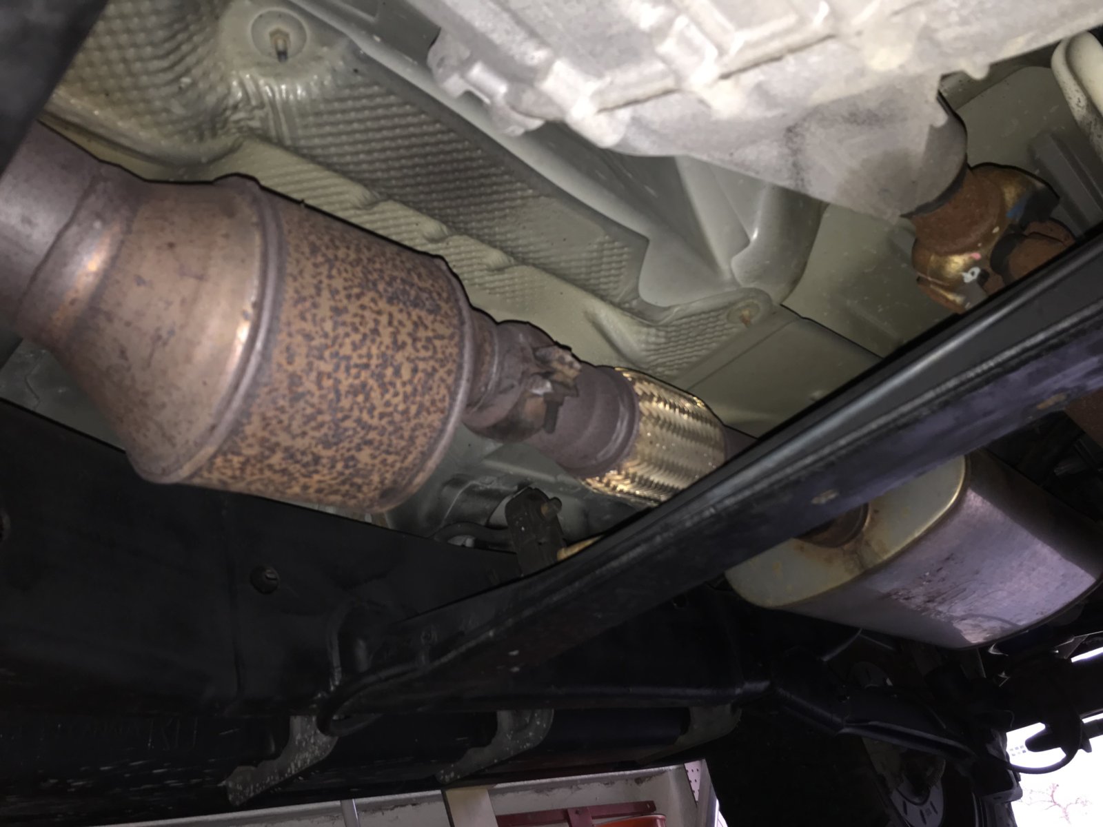

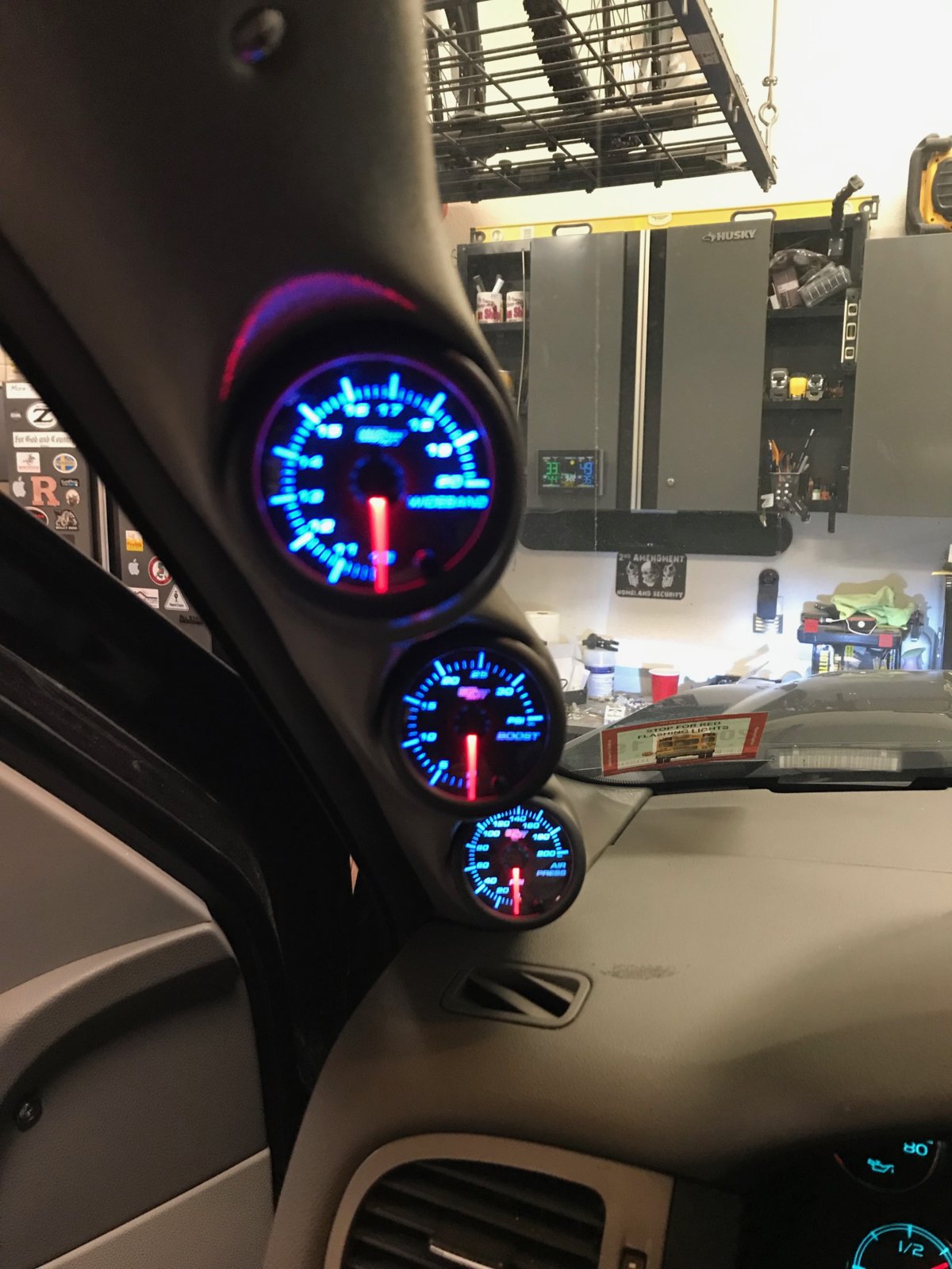

question for guys who have widened O2 sensor A/F ratio gauge, where did you place your sensor?
67RS427
Apr 5, 2017
595
1,217
Right where the Y pipe merges together if you only have one. I plan to add another so I can monitor both banks though. If you have cats, you want it before the cat 12" or so after the collector

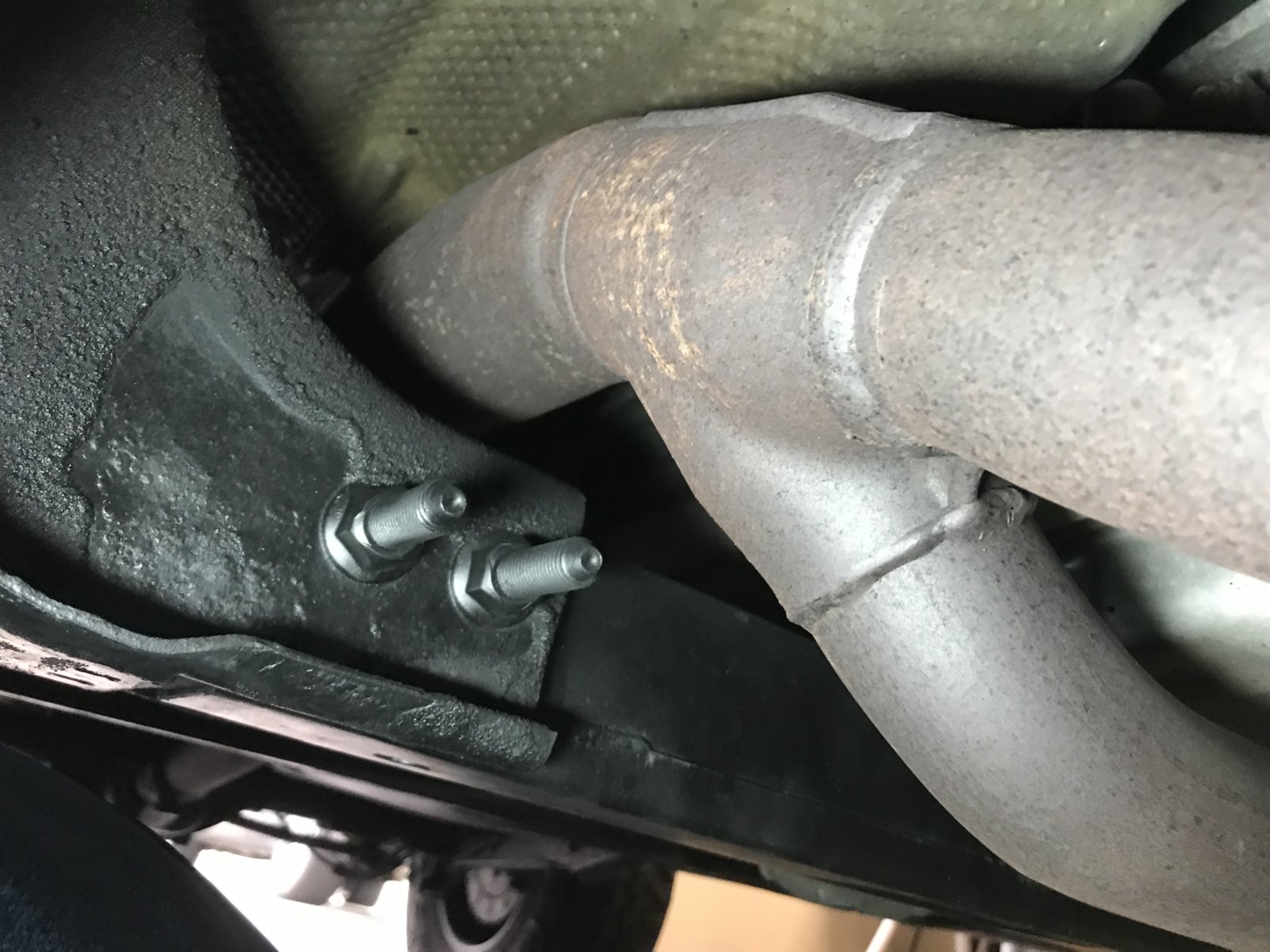

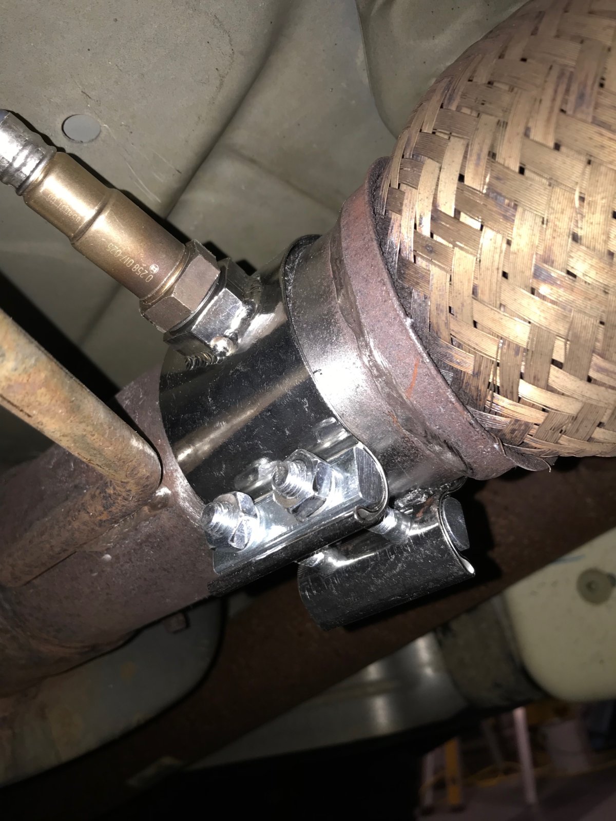

Right where the Y pipe merges together if you only have one. I plan to add another so I can monitor both banks though. If you have cats, you want it after the cat 12" or so
very tight there

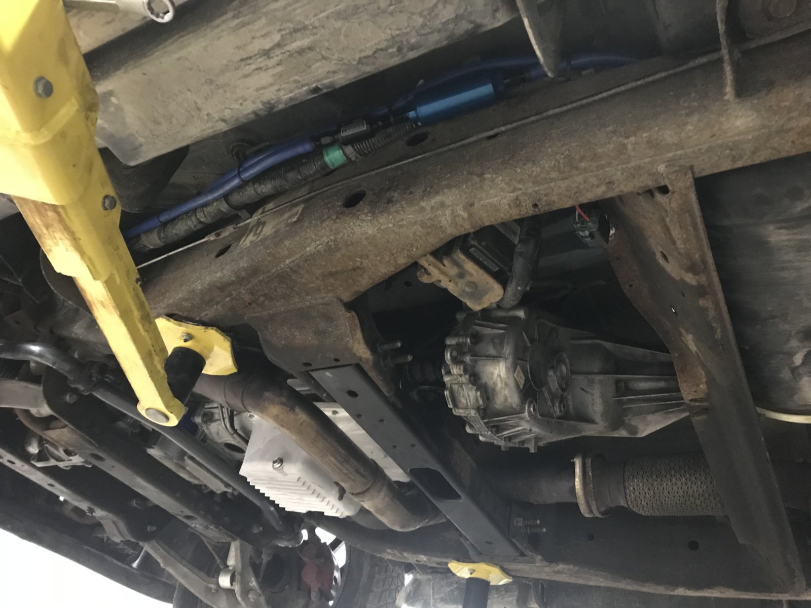

some times I wish I had the suburban lol
67RS427
Apr 5, 2017
595
1,217
some times I wish I had the suburban lolView attachment 213604
Are you keeping your cats? Plans for the rest of the exhaust? I couldn't be happier with my Kooks Headers/Y Pipe and OEM pipe back with a magnaflow muffler. You have smaller pipe so you may wanna do a cat back and get rid of that resonator.

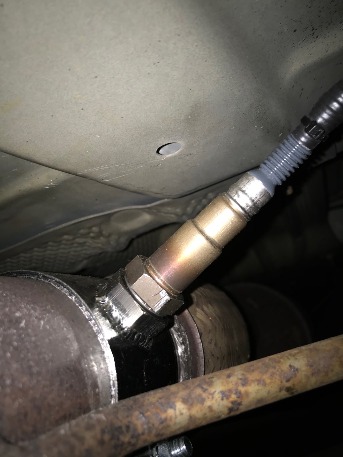

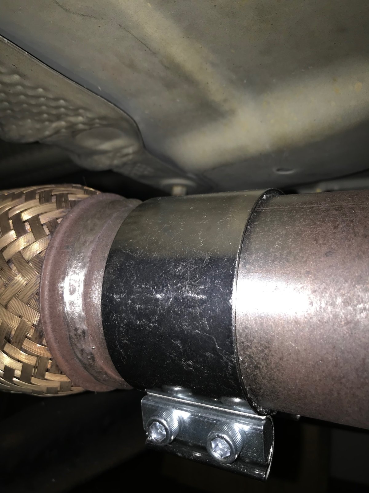

Mine being a 6.2L, I have 3.5" stainless from the Y pipe back. I put mine on the passenger bank knowing I was going to add a second one. Ideally with one, you'd want it before the flex pipe after the Y. Your pipe looks much smaller though, not sure if you have the flex pipe.
my Y pipe is 3.5" than goes down to 3"

That's pretty neat... never seen one of those before. I have always just had a local exhaust shop weld a bung into my pipes if needed.
Decided to go with the because of its good reviews, I guess if it fails it could get weld in.
