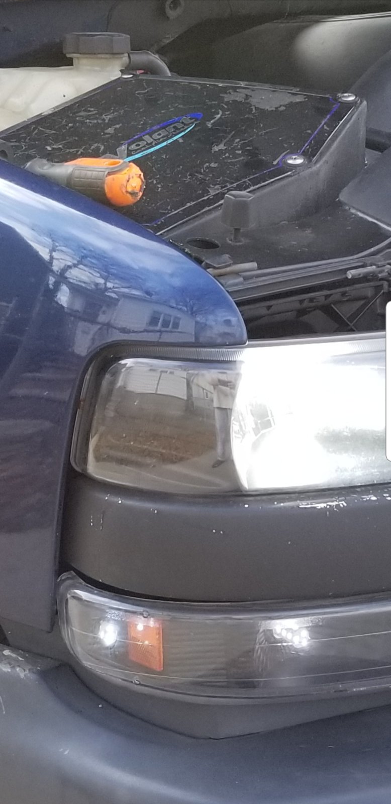

Productive day today, not sure why they don't come with under the hood light,.. Problem solved.

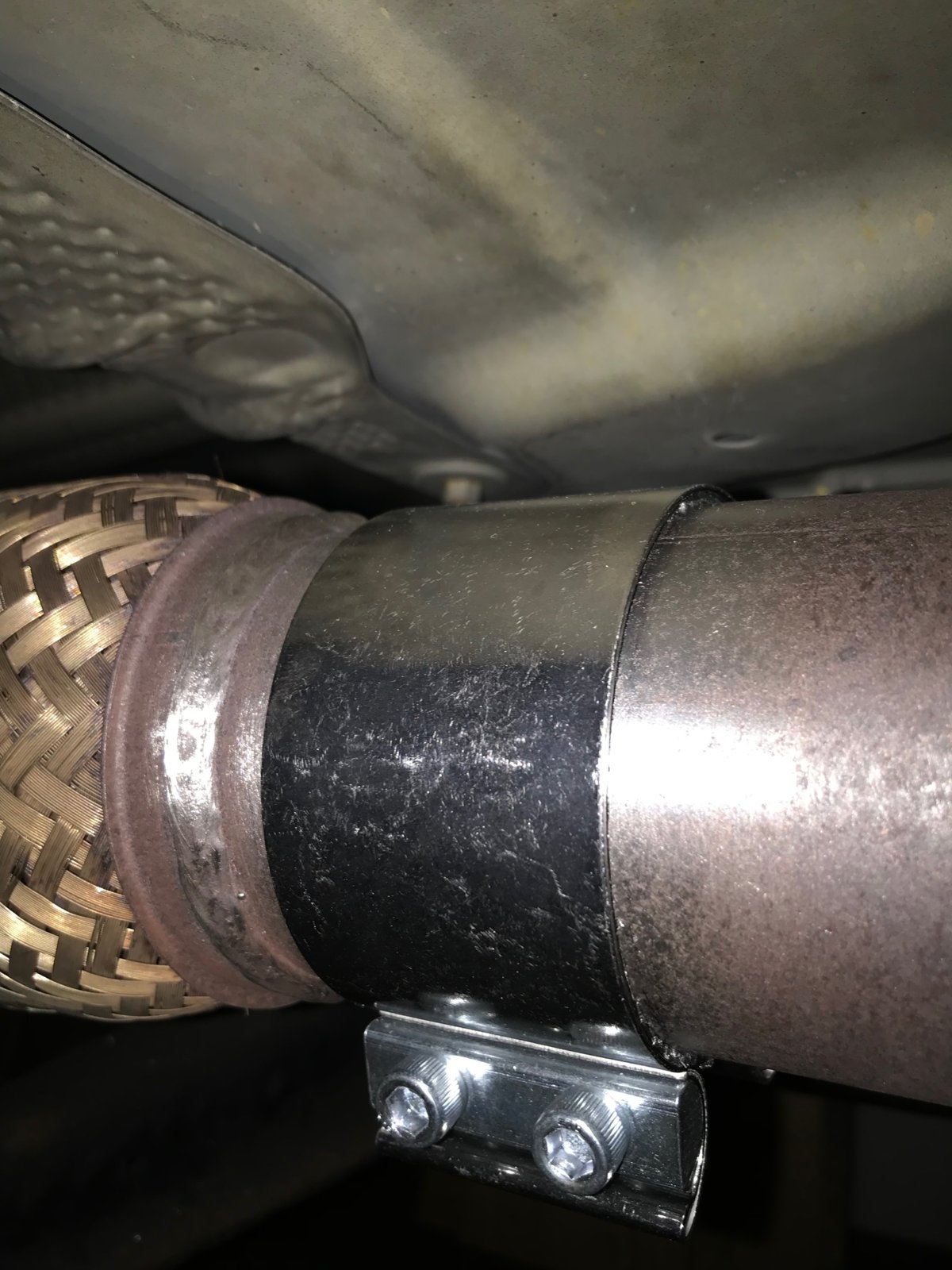

That sounds more quiet than my stock exhaust! Is that a system or just the muffler? The pipe behind the exhaust tip looked like mild steel and not original.
Lol. That’s what I was thinking too.

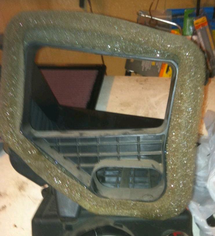

Did anyone attempt or made some type of air tube to direct cold air from the front of the truck to the air box? like an air inlet in a bumper?
The AirAid box I'm using has an extra inlet that pulls air from down below... I've never had an issue with water. I'm using just the box with a custom 5" MAF tube. The sound is great, even when the motor was stock.
I should add that the filter is freaking massive. It's a 6" inlet on the filter...
https://www.airaid.com/mobile/product.aspx?prod=203-267

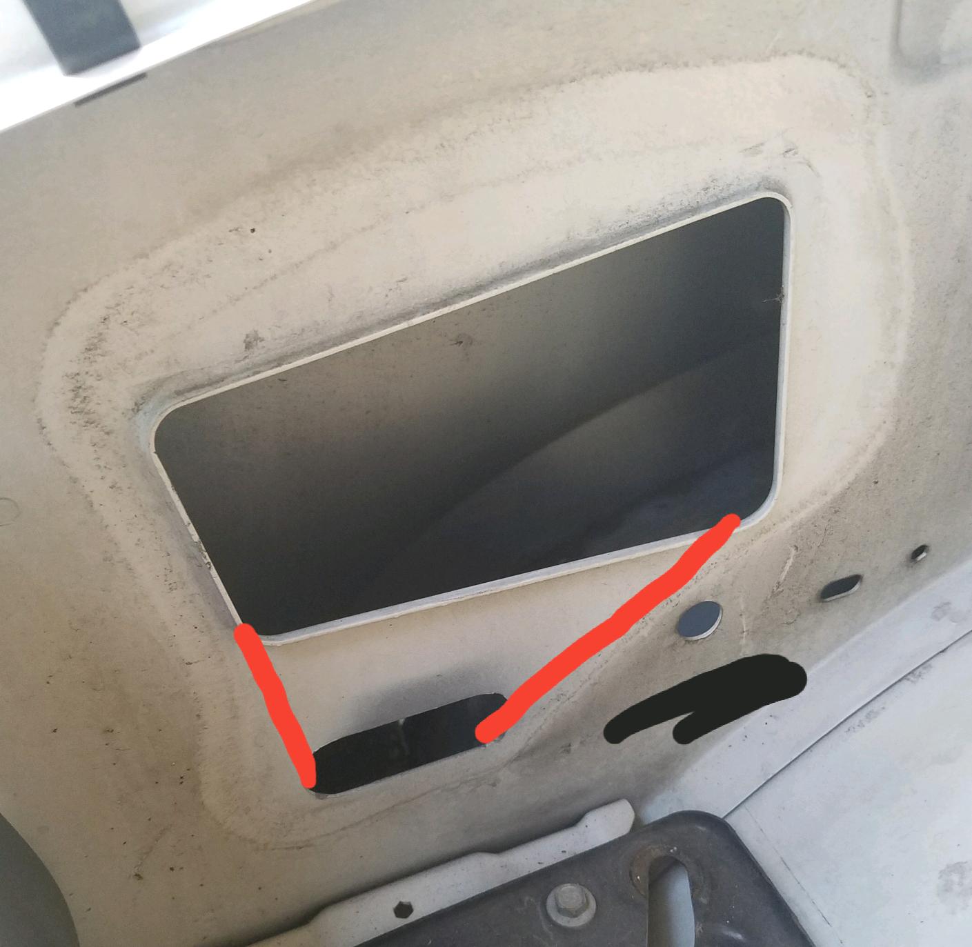

If you're cutting up the stock air box anyway....in the tray under it, theres an opening I think about a 3"hole saw will go thru

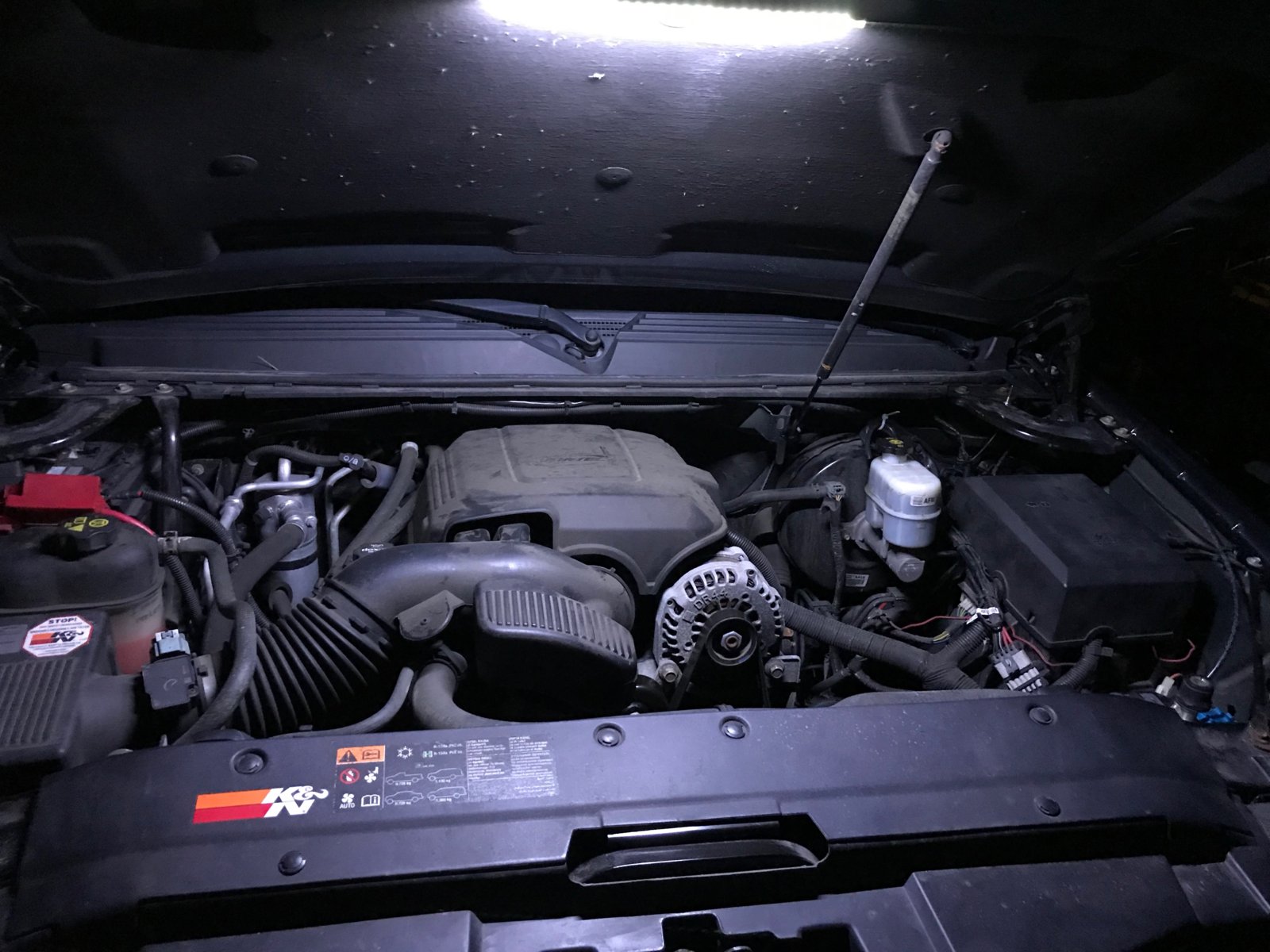

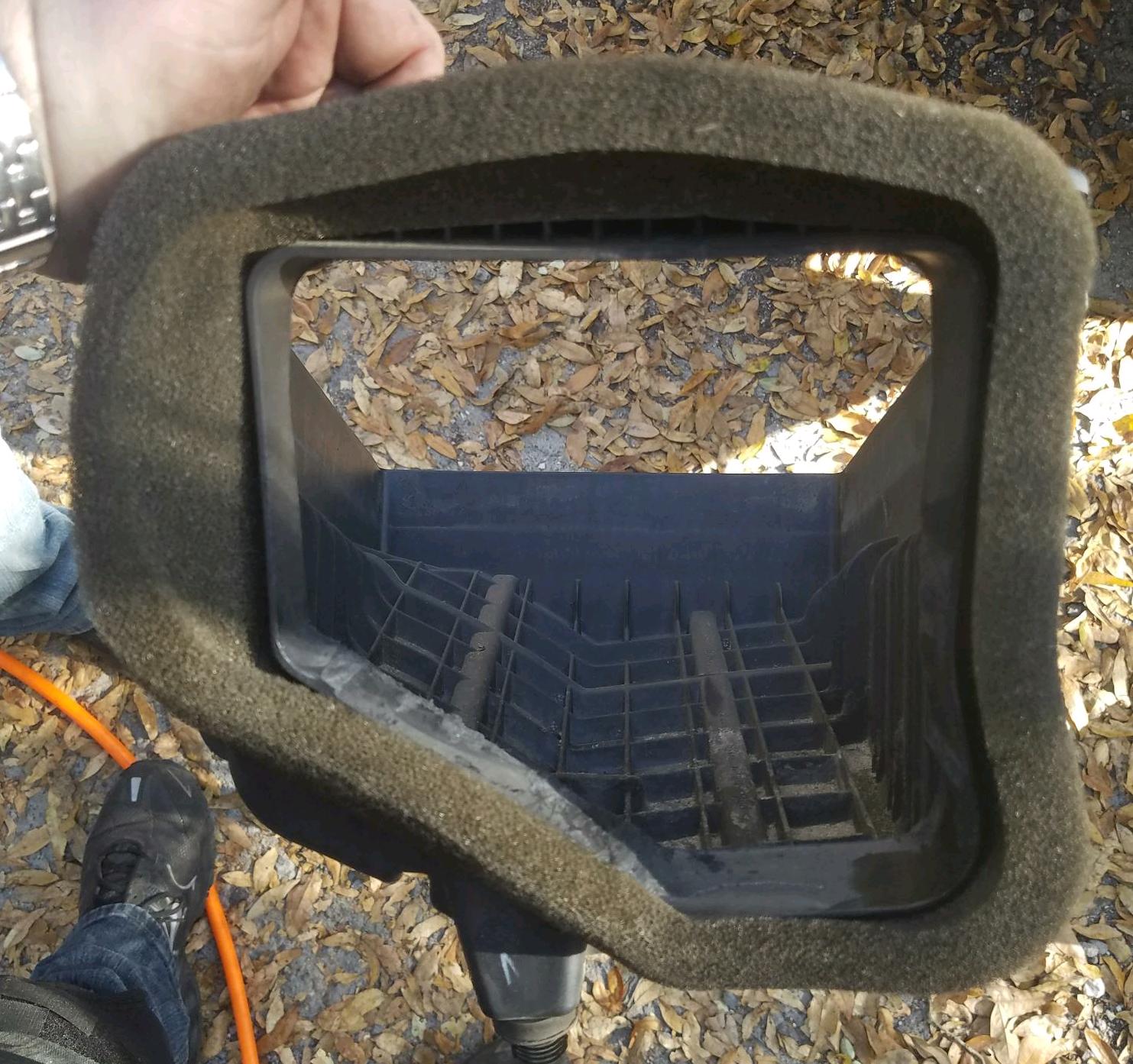

Is there a top cover?
No top cover, just a rubber seal that seals it to the hood... In my experience, the ones with lids don't allow enough airflow through the small inlets, specially when the truck isn't moving
