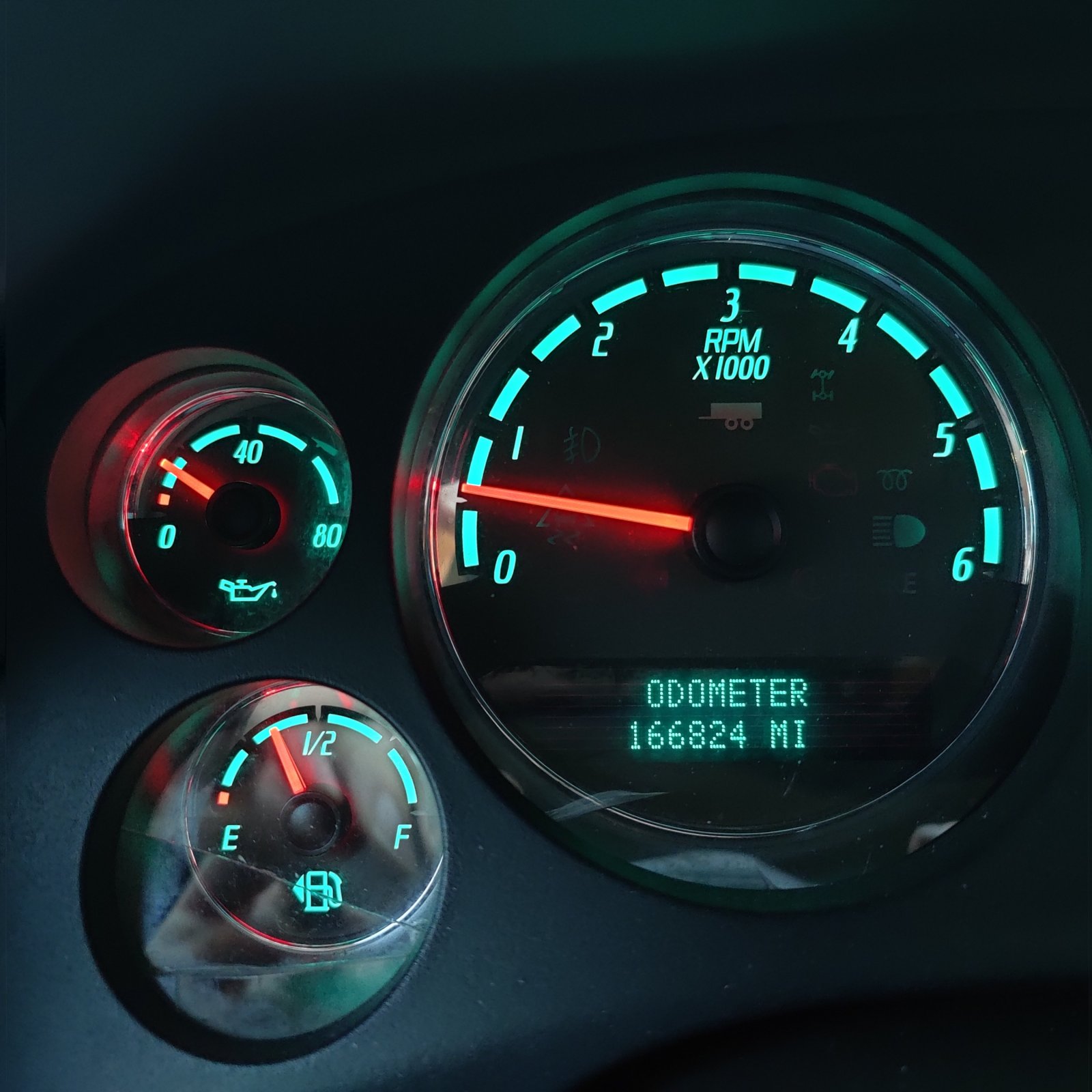

Did the pickup O ring on mine today.
Warm idle has gone from 10-15psi, to 20-25.
Cruising is 40-50psi. Acceleration is 60+. Haven't done a cold idle yet.
07 Denali, 167k miles. Unopened engine.
