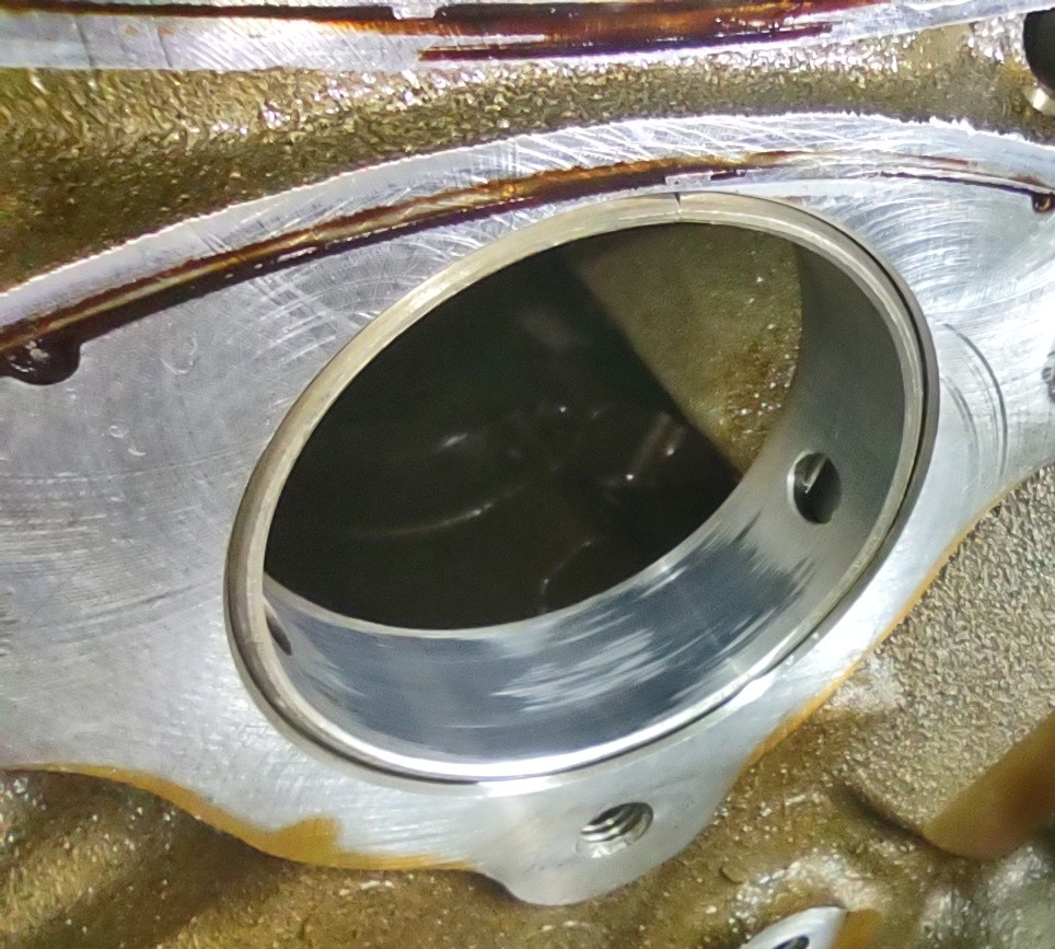

And this is what we found for the front cam bearing. Sent the scope through the rest of them and they looked like new. Was really surprised to see how well the front bearing looked.
That looks better than zero mile crate engines but I've seen pics of
There's a theory out there that says they align hone after installing the bearings at the factory due to cheap casting shift. others say it's just the lowest possible quality cam bearing anyone has ever seen to save a buck

I've heard from multiple sources that the factory align homes the bearings after install..... But not 100% sure that I buy that. If the bores were that far off, and replace the cam bearings, you'd never get the cam in. And it seems like if it did, you wouldn't be able to turn it. Anybody object to that theory? LOL
