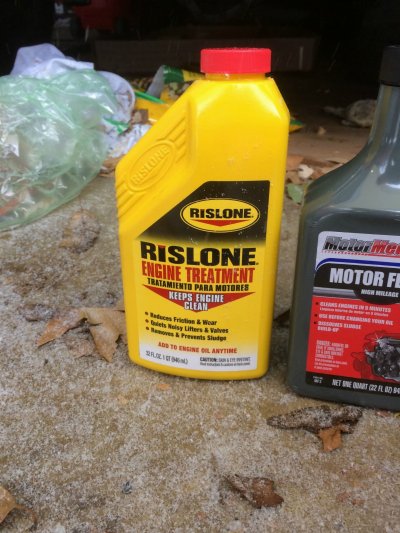

WHAT SEEMS TO HAVE SOLVED THIS FOR ME....
I came to the conclusion that part of the problem was cheap oil filters. Whether this part is true or not I'm not 100% certain but either way it's part of my fix. Prior to the lifter issue I'd been using K&N oil filters. So I got back to that and started using K&N oil filters again. This is not necessary I'm sure but it's one I like for a multitude of reasons. I also used a couple of additives in my oil change for February. The first one was a motor flush that you add, let the motor run for 5 minutes and then change the oil. This is to break down any sludge that may be present and clean the engine real well
I then changed the oil using Valvoline Max Life synthetic motor oil and the K&N oil filter. After a LOT of research I also used a product called Rislone
I only used this with the one oil change. I'm now about 5000 or miles after this treatment (and two normal oil changes) and have not had the issue come back even after a 1600 miles road trip. I even let one oil change go 3500 miles just to see how it was holding up and seeing if I could make the low oil pressure issue happen again but could not.
So this is what I've found thus far. I my add more to this as I learn more. Hopefully this helps someone resolve this issue. It's a VERY frustrating issue.
