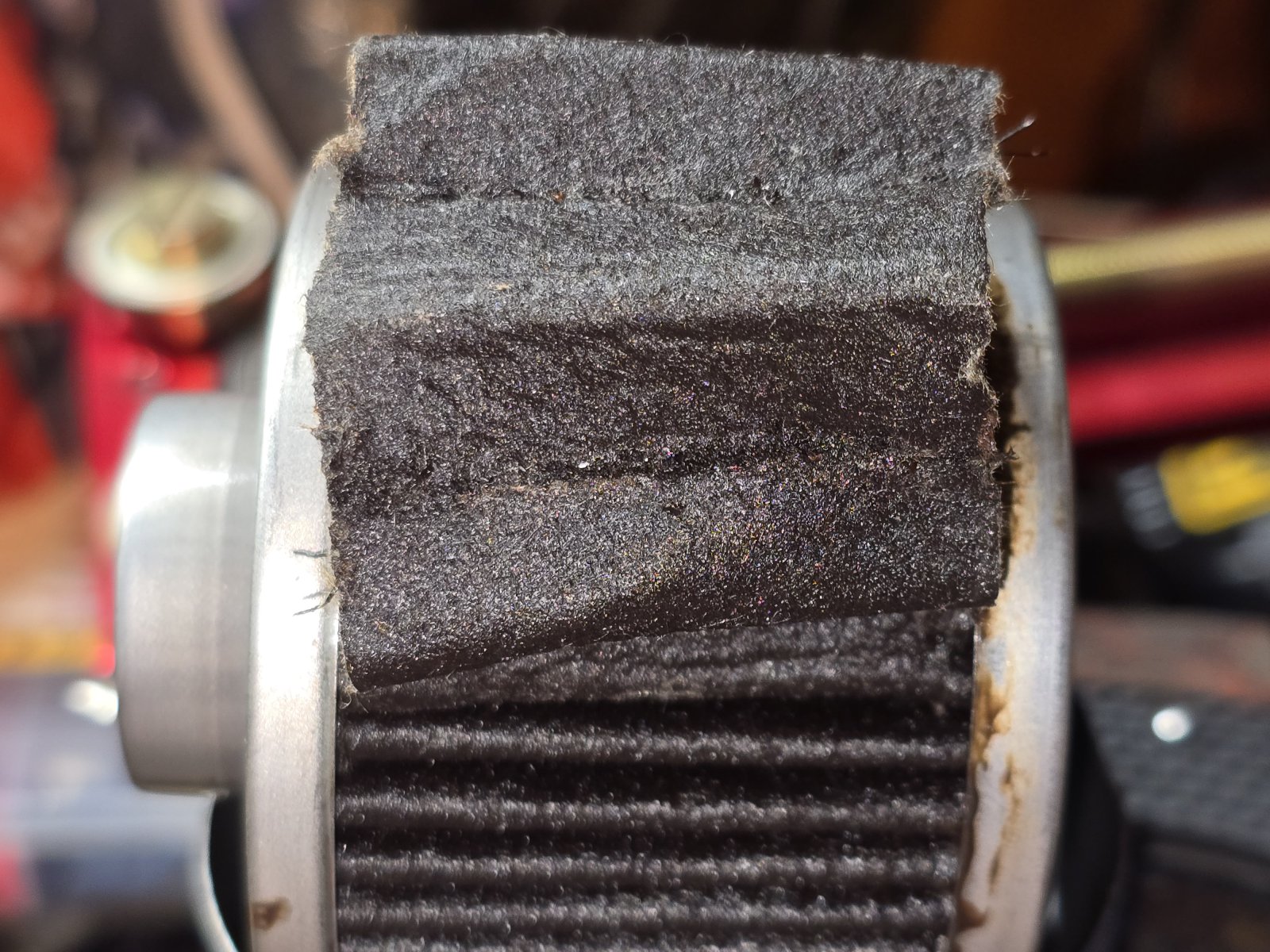

Currently at 180k. I took a photo but they don't show up very well. I just did an oil change. When I cut the filter open, I found maybe 2-4 specs per pleat.
Located in Aurora.
Might want to send an oil sample in for analysis.
I just ordered a few bottles from Blackstone. That's the next step in this plan.

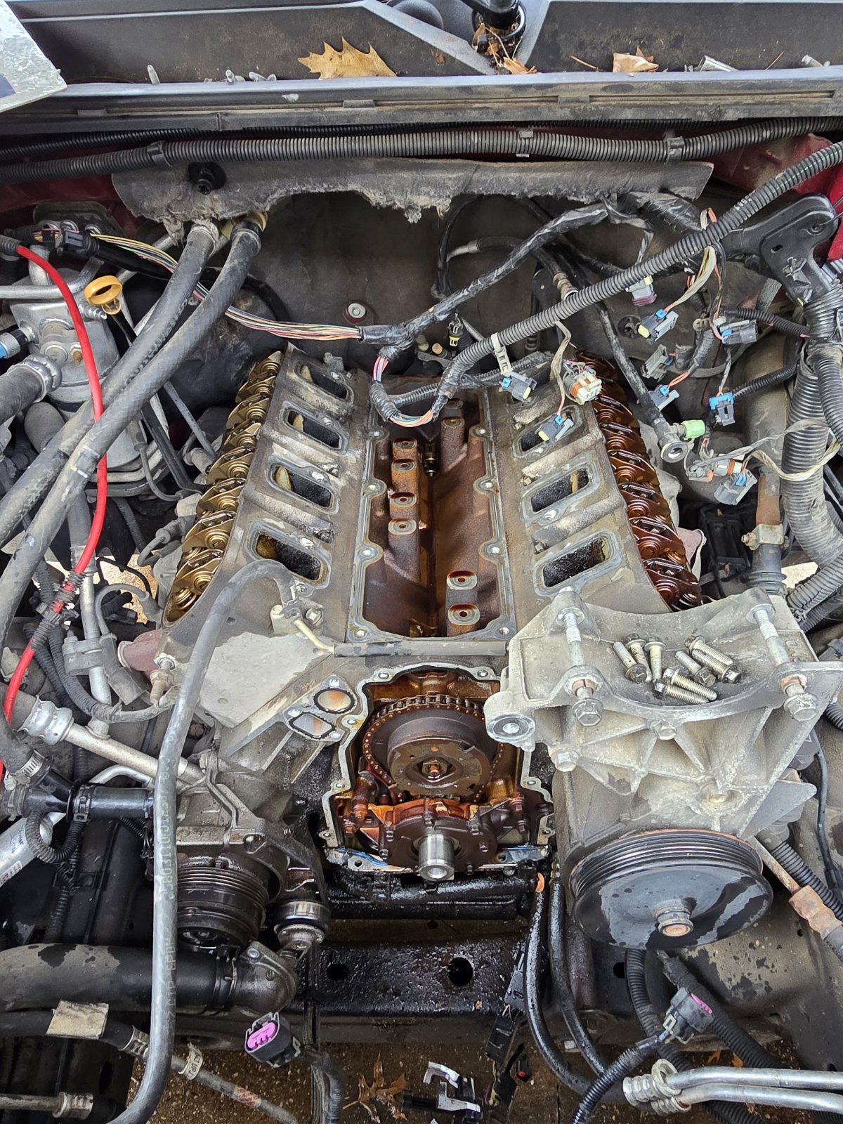

I also wanted to give a quick update to something I discovered.
About a month ago, I dumped about 2k into it. I replaced every front suspension component. Ball joints and tie rod ends were mevotech and the front struts were replaced with genuine gm. (ouch). So far with replacing the rear air shocks and the fronts with genuine gm, it seriously rides like a brand new vehicle. I couldn't be happier. With that said, I replaced MOST of the gaskets around the motor. This includes the Valley cover, valve covers, front timing gasket and front main seal. Not sure what happened to the front main seal, but it ended up coming off when I pulled the crank shaft pully. As stated previously, I forgot to replace the orings where the valley cover meets the block so I'm going to replace those next time I tear into it. It'll likely be this spring.
Now, I've been running Fram Synthetic Endurance oil filters (I know their lower tier options are garbage). I used to run Wix but was having issues finding some. When I was picking up oil, I came across those at walmart. I found a couple of write ups on them that showed them to very well built. So I thought, hey, what the heck. Well... I still believe they're built very will but something I didn't notice until I put it side by side with an Ac delco filter, the inlet holes are TINY on the Fram compared to the AC Delco filter. Previous years that don't require high flow oil pump applications, this probably would have worked just fine. However, with the oil pumps now flowing a higher volume of oil for AFM and VVT, the tiny inlet holes just cant keep up. So with the fram, cold idle pressures were around 30 and would increase momentarily while the oil heated up (then come back down). The AC Delco cold idle pressures are 45. With fresh mobile 1 Advanced synthetic 10w-30 the hot pressures do still drop down to ~15psi. I've seen them on live data drop to 11psi when the AC cycles.
All of that to say, I'm going to send an oil sample to blackstone and see what the analysis shows. From there, I make a plan of action and report back. But I'll likely end up replacing oil pump and maybe the timing chain anyways.
Also... All of the filters that I have found are just absolutey tiny. Are there any larger ones that will fit this application correctly? I'm all for a higher oil capacity as well as more filter media surface area.
