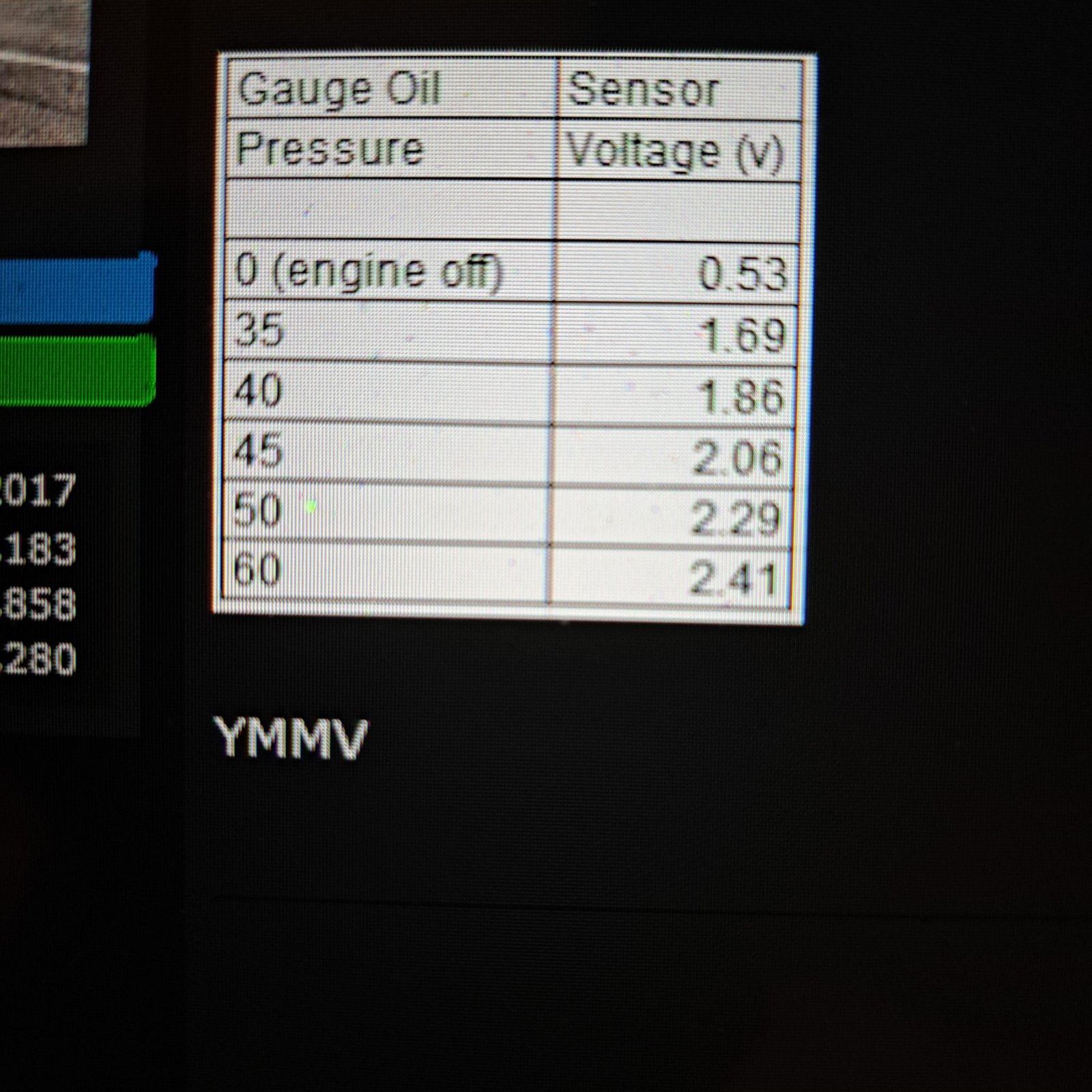

Your live data scanner will not give pressure. It gives voltages that relate ro a pressure amount. I believe @Fless has the voltage chart. Maybe this is it.

A 2008 (NNBS) will have a PID for oil pressure.
Another guy I work with had a Bluetooth scanner that does the 2 way communication. Looked it up with his app and it showed it. What the gauge is reading is the same as the sensor. I’m going to get a mechanical gauge hooked up to make sure.
