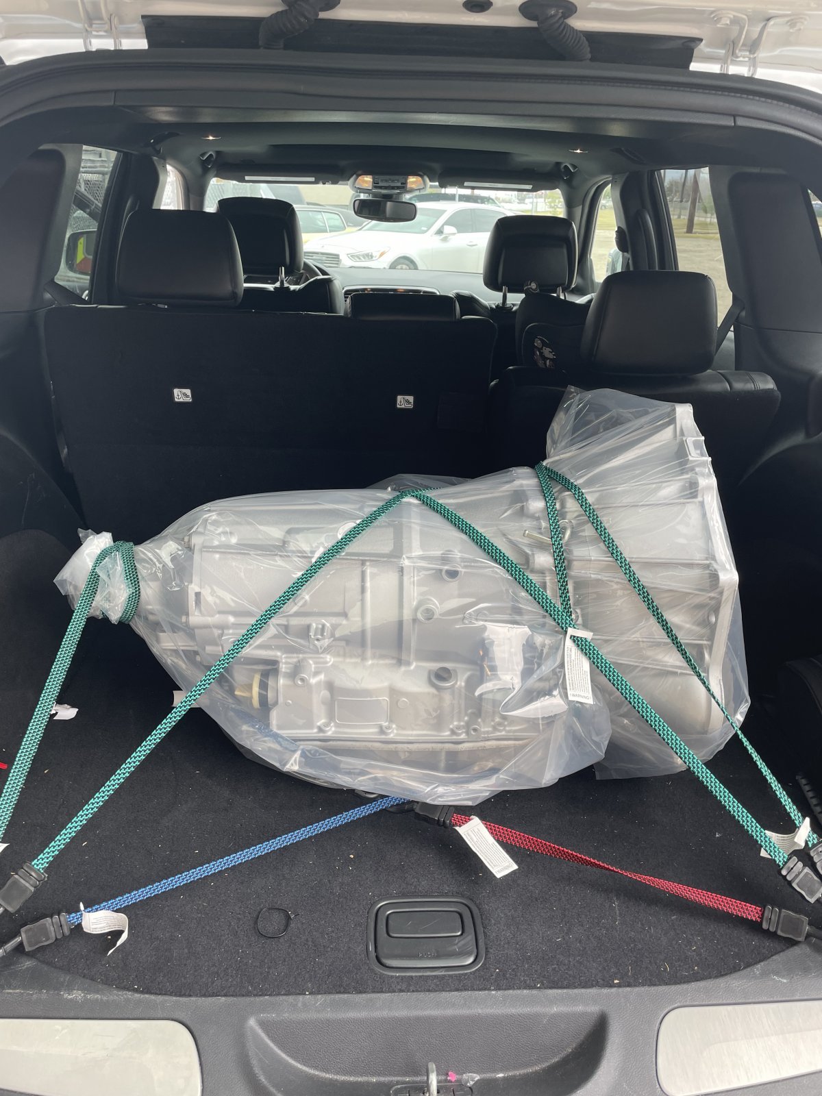

Well, I made the 260ish mile drive down to Houston to Circle D, and dropped off my 6L80E, and after talking to Glen there for a while, I'm glad that I did. The only downside is that he says they are possibly as much as three months out to get it rebuilt, so it looks like I'm going to be waiting for a while. I do have some other small jobs to tackle on the Tahoe while I wait, so I'll continue to post here while I do those, but I think it's going to be a while before I have much of consequence to say. While I was in Houston I also made it into Circle D Specialties (they do torque converters, not to be confused with Circle D transmissions) and ordered a new Pro Series 300mm torque converter with a 2600 stall. I think that will pair well with the cam based on the recommendation of Texas Speed. Glen also recommended a tuner in the Fort Worth area, and when I got home and looked them up, it turns out that they are in the same small town west of Fort Worth that I live in, and only a few miles away from me. So it looks like I have found my tuner.
Awesome turn of events. I'm very much pleased with my Circle D converter. With their reputation, I'd certainly follow their lead on a tuner. It's icing on the cake that it's someone local to you.

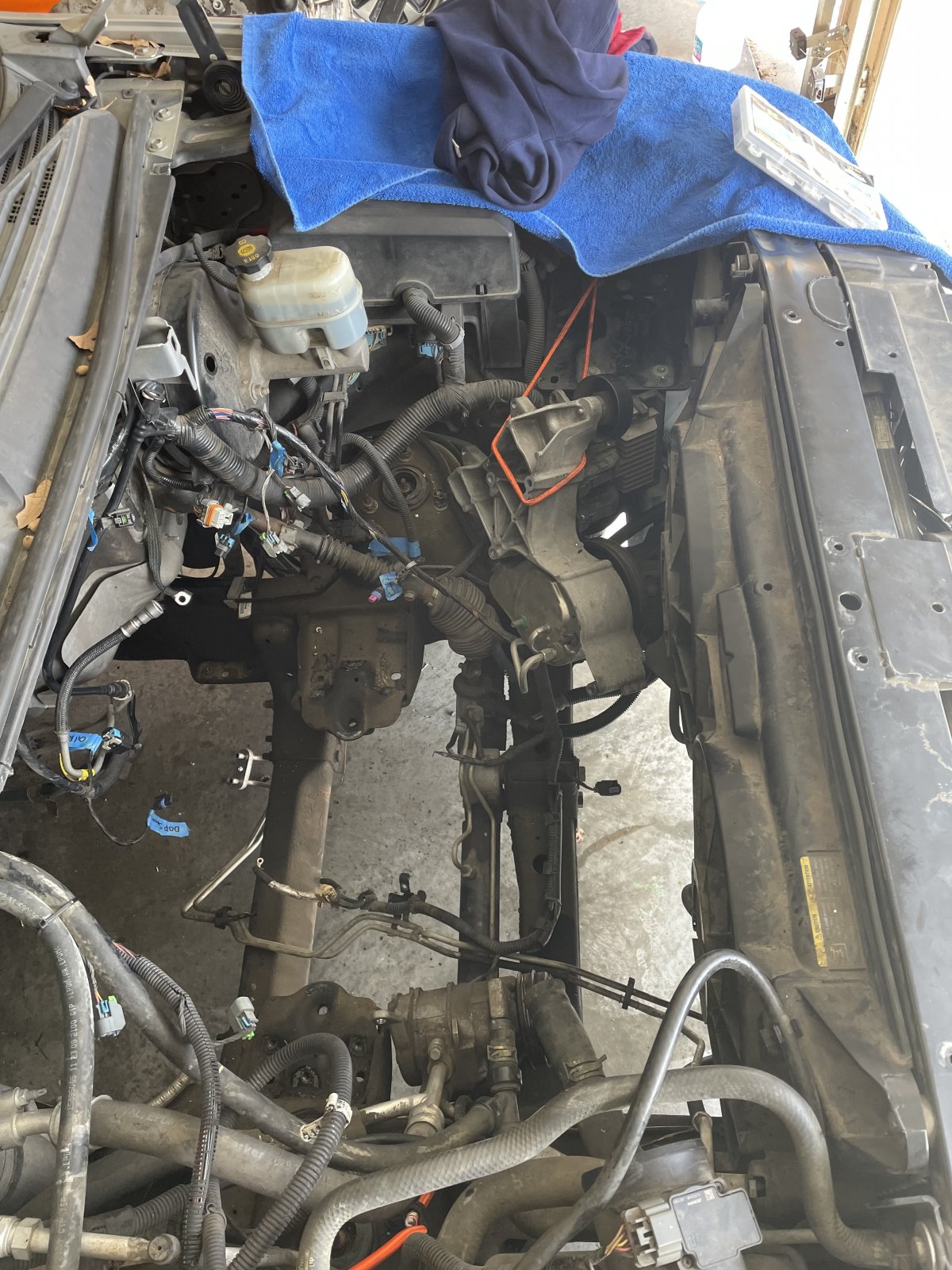

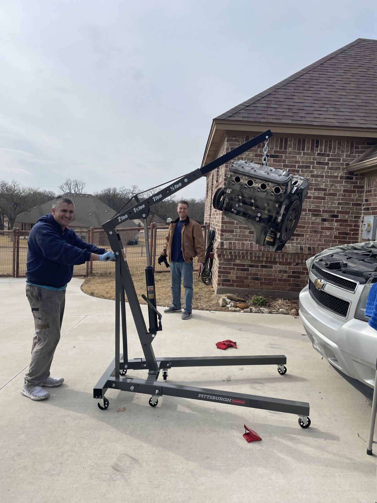

Well folks, big news - the 5.3 is out of the Tahoe!
I've spent quite a bit of time over the last several days pulling connectors, unbolting accessories, labeling things, and cataloging them. I've put every fastener I've removed into labeled zip-lock bags and have a computer spreadsheet of every fastener, bracket, connector, hose, etc that I've touched. My plan is to create a checklist or job-guide to ensure that I put everything back, and try to get everything in the correct order to avoid the two steps forward - one step back issues that usually follow (at least for me) when i try to put something back together from memory.
Anyway, today one of my USMC buddies stopped by for a few hours. The only things left to do today were to remove a few miscellaneous hoses and connectors, get the power steering pump and ac compressor and associated brackets clear of the engine, and then unbolt the mounts. We got everything done until there was just one bolt remaining in each mount, and then pushed the Tahoe far enough outside so that the garage ceiling wouldn't interfere with the hoist. She came right out, easy as could be. Amazingly, we did not miss a single wire or hose, and so it was just a matter of my buddy and I holding some harnesses and hoses clear while my wife worked the hoist. The trick of spinning the engine worked like a charm. We rotated the front of the engine to the passenger side, and it went very smoothly. I didn't get pictures until it was out unfortunately, but here it is:

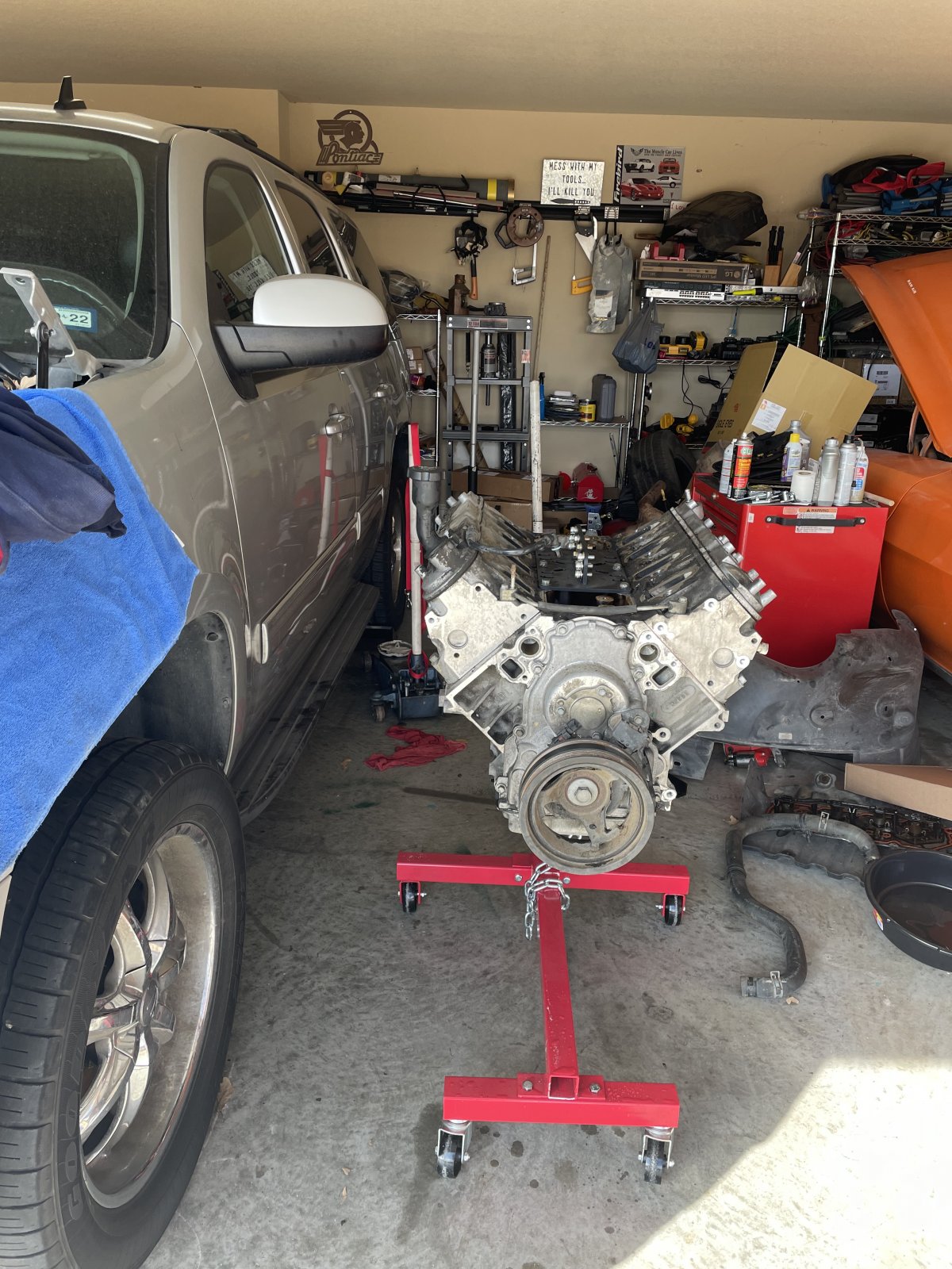

After that we pushed the Tahoe back in, transferred the engine to my engine stand, and got everything back in the garage.
I am going to spend some time while I wait for the new engine and rebuilt transmission, cleaning the engine compartment, and re-looming some or all of the wiring harness. Here is the empty engine bay:

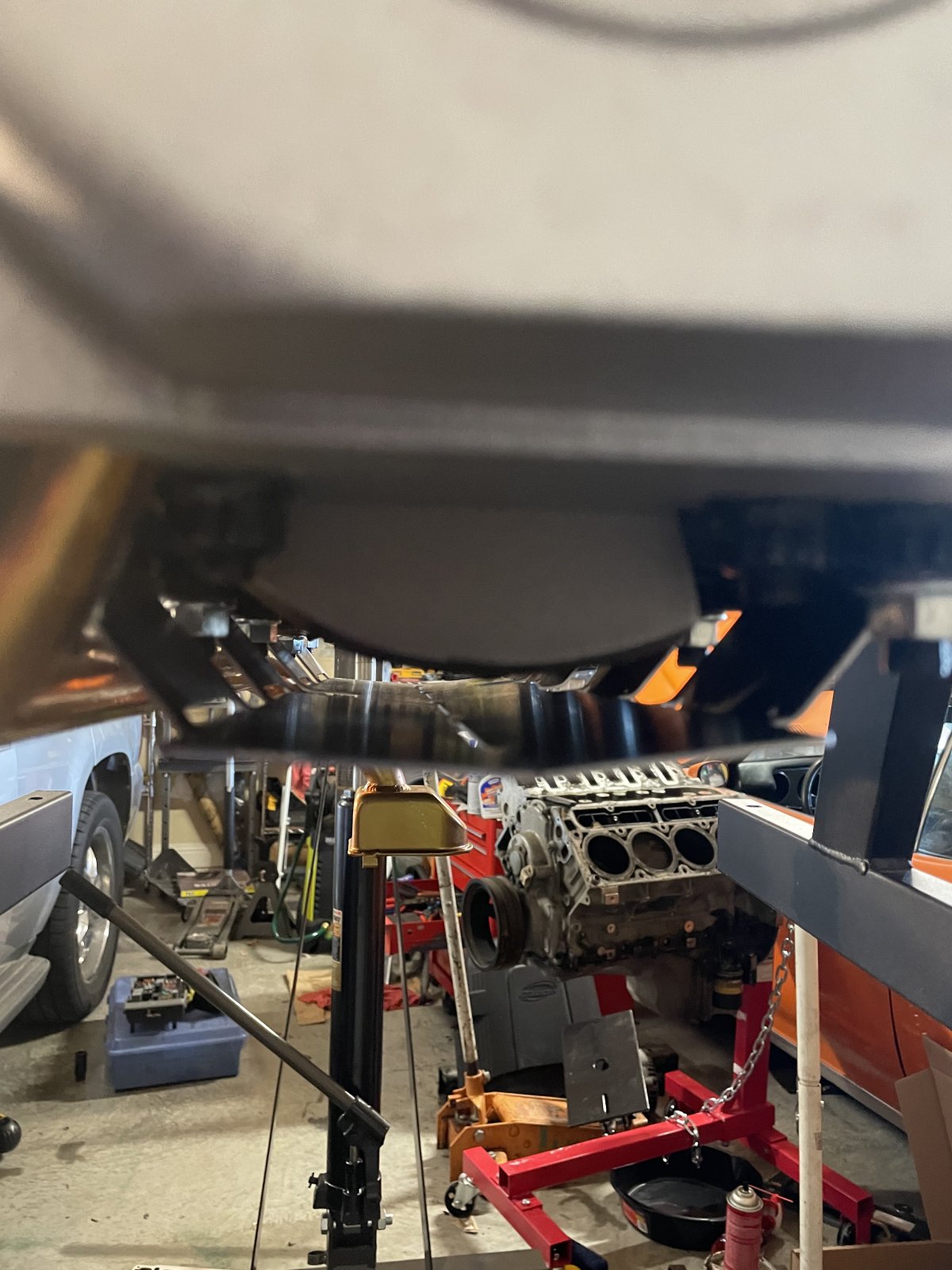

Looking forward, I am thinking that if I were to jack the back end of the truck up as high as my ceiling would allow, I MIGHT be able to slide the engine and transmission in as one unit. I could also push the Tahoe fully outdoors for that operation to get the rear end even higher. Has anyone tried doing it that way?

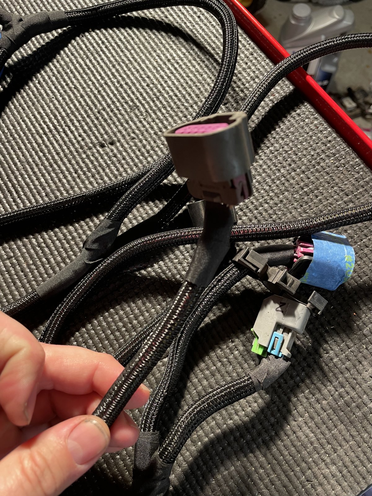

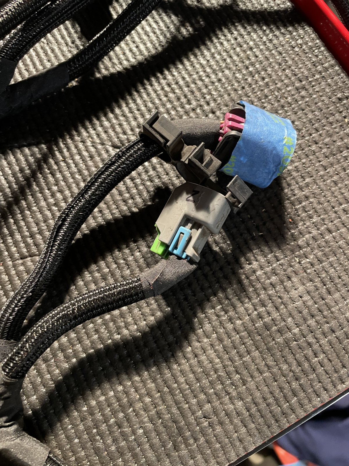

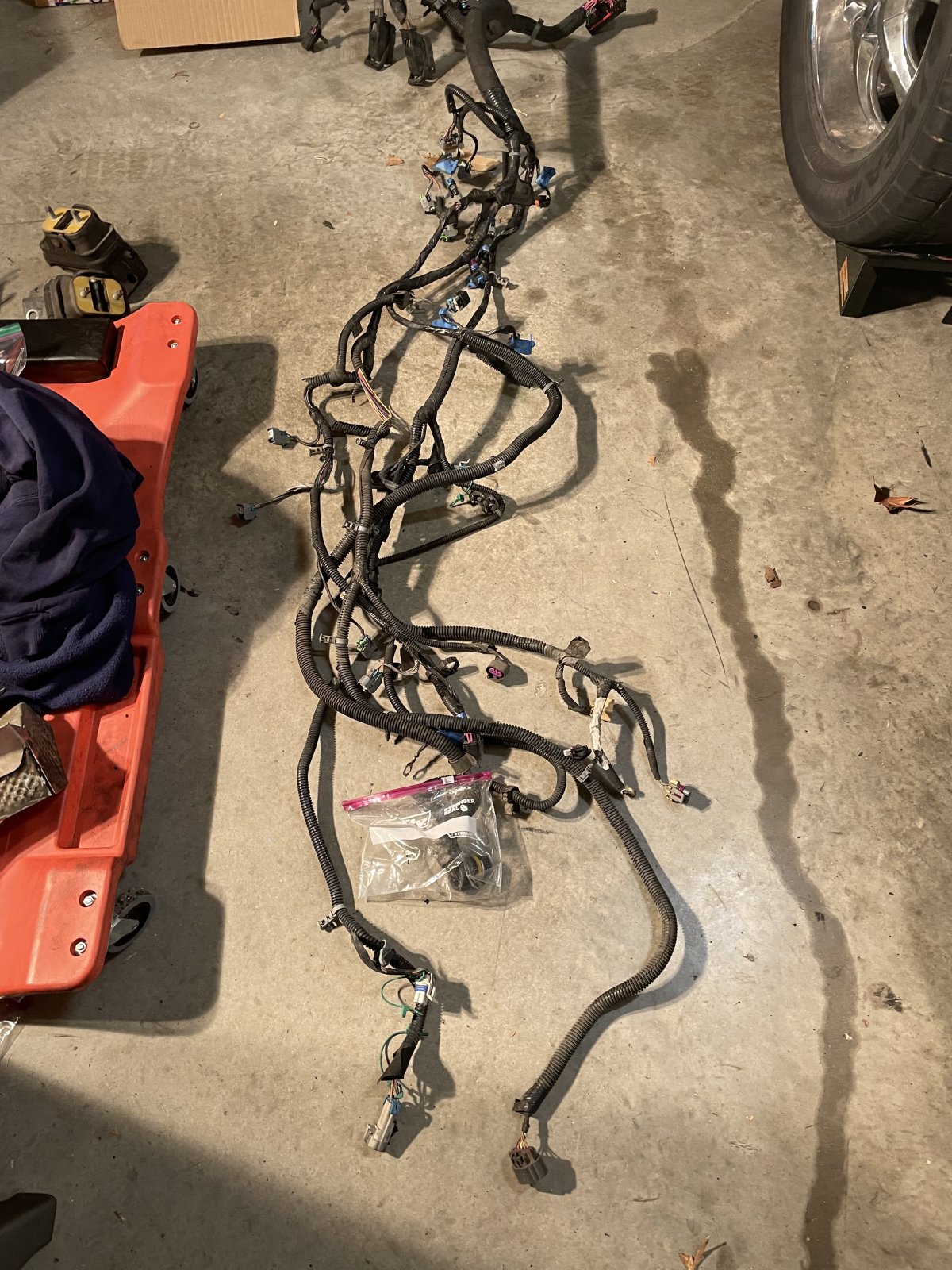

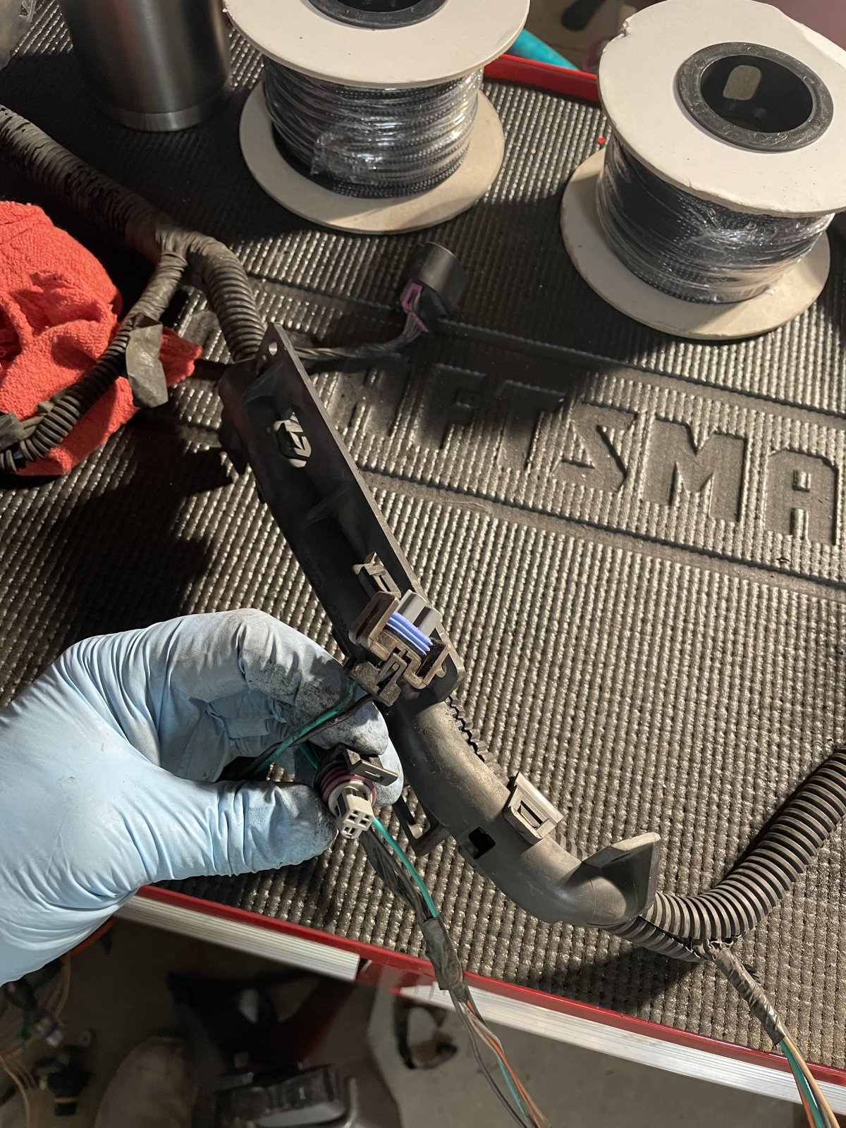

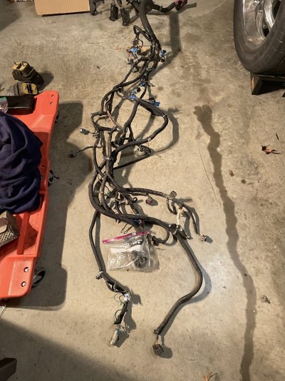

I've been looking for little projects to keep myself busy while I wait on my engine and transmission. One thing that I noticed is that the factory looming on my engine wiring harness was looking pretty rough. It was brittle in places, and sections were completely missing in other places. In fact I had a couple of spots where the plastic was completely missing for several inches. I decided to pull the harness out of the vehicle (which I hope that I don't come to regret when I put it back together) and redo the loom on the entire harness. I am using Tessa cloth tape, and split PET loom. I ordered several different sizes of the loom material to try to keep things as clean as possible as the harness thickness changes as it branches out. My pictures are not great, but here are a couple of before shots:
And here are a couple of after shots:
This has been pretty smooth, and kind of enjoyable to do, so now I am considering doing other harnesses in the vehicle, such as the wiring to the headlights, etc.
I also just bought a significant amount of Kilmat, Boom Mat spray, and associated items for sound deadening, and I guess once the looming is complete I am going to move on to pulling out the interior to install my new stereo and backup camera, and sound treat the full interior.

That loom work is beautiful! Is the woven loom the 'split PET loom' you referred to? The engine bay of my Escalade is lousy with brittle and degraded cable looms. I like your idea! Please elaborate on the materials you are using.
Thanks!
Seth - The stuff I am using is this:
I bought it in several sizes, 1/4, 3/8, 1/2, 3/4, and 1 inch. I think I also got some 1.25 inch. I probably didn't need all of those sizes, but this is the first time I'm doing this and so I'm figuring it out as I go. I'll try to post up which sizes I actually used once I am complete. The tape is this:
For puting it all back together I also bought these:
There are two more styles of specialized zip ties that were on the harness that I am still trying to find. If I do find them I'll let you know where.

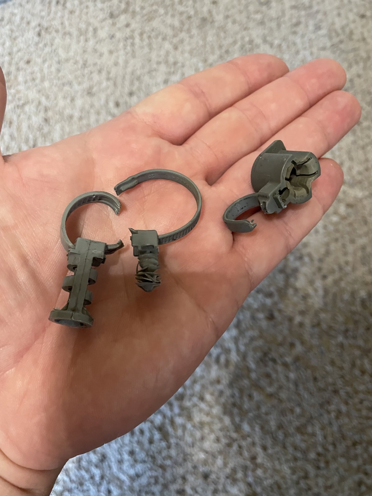

Here is a picture of all three:
The one in the middle is relatively easy to find replacements for:
The ones on the right and left...not so easy. I found something similar to the one on the right, but I could only find it in 1000 packs, and the price was something like $200 for that many. Eventually I ordered these:
They are not identical to either, and I haven't received them yet, so I don't know for sure if they will work, but I am hopeful that they can be used to replace both the left and right style from my picture above. I'll let you know once they get here.

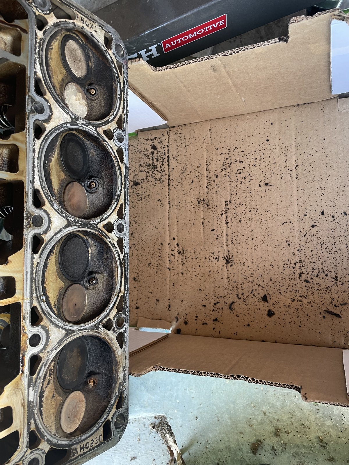

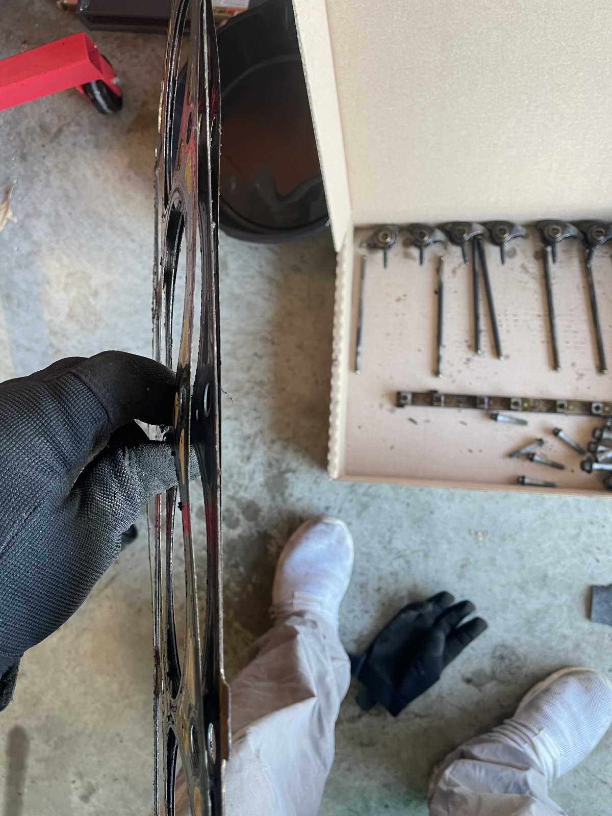

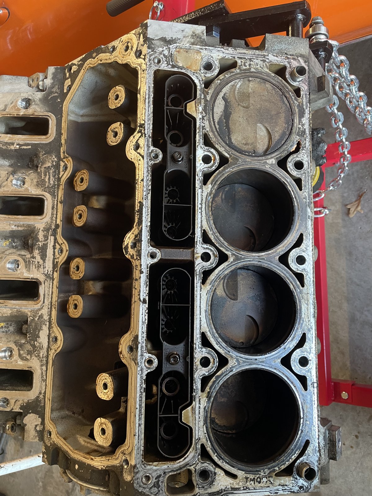

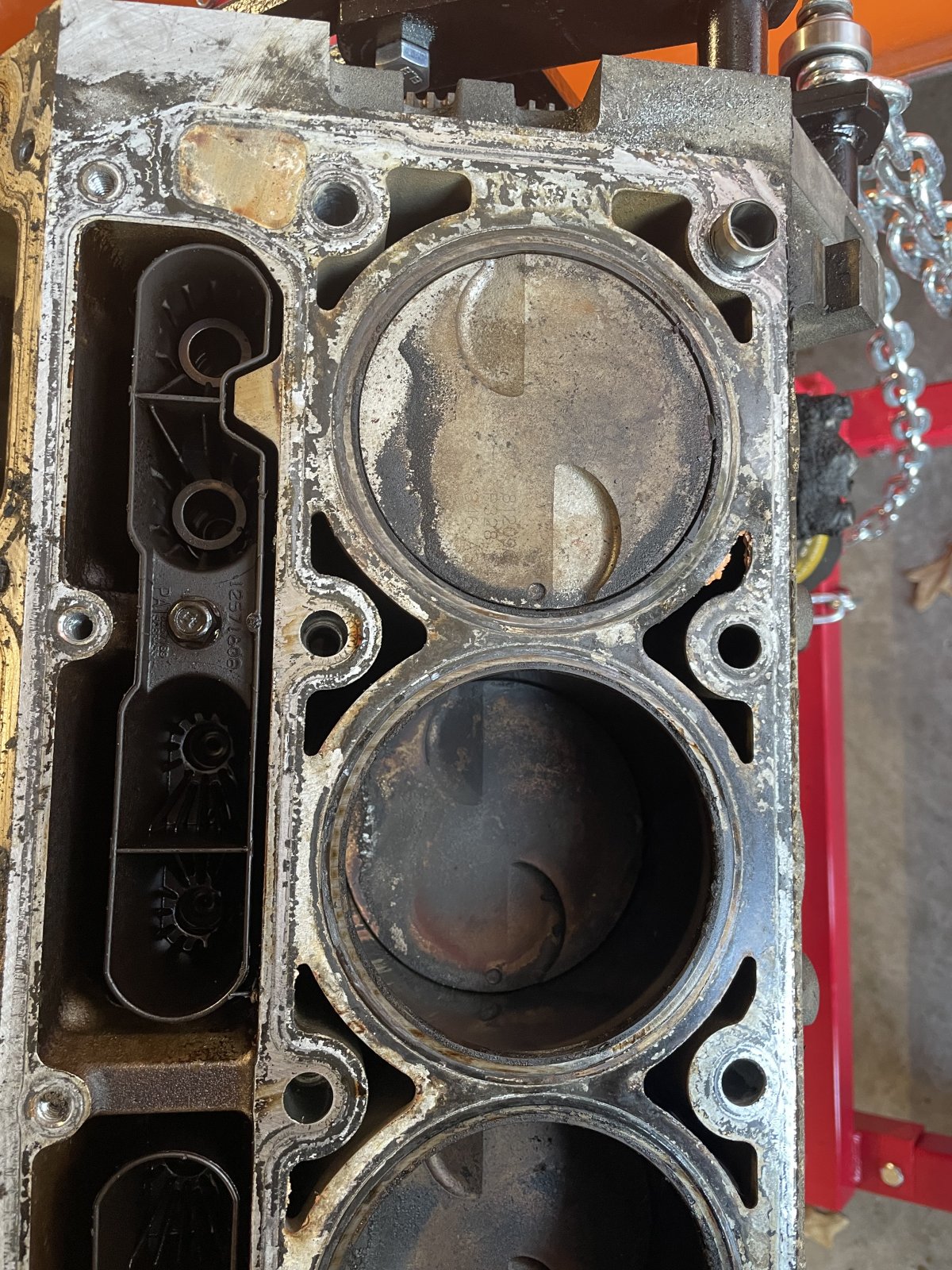

I pulled the driver side head off of the old engine just to see if I could see anything wrong in the vicinity of the #7 cylinder, which was giving me a lot of misfires, and fouling plugs.
You can see that the build up on the #7 piston is a different color. In addition, the electrode end of the spark plug was slightly rusty, which is just visible in the last picture, so as I pretty much knew, coolant was getting into that cylinder. The third picture is the head gasket from that side. Should it spread apart like that? Or is that indicative of a blown gasket? I am hoping that the block and heads are OK. Didn't notice any obvious cracks, but I need to clean it up more before I can be certain.
View attachment 362771View attachment 362772View attachment 362773View attachment 362774
In other news, Texas Speed called me, and the new engine should be finished tomorrow, but I am looking at either next week, or the week after before I can make the drive down to get it due to work conflicts. Still, it is exciting that progress is being made!
Smoking gun. Yes, it's normal for the gasket to separate like that. Are my eyes messing with me or is there some corrosion in the water passage adjacent to the #7 cylinder?

Head gasket is normal.. MLS = Multi Layered Steel... Pretty much a Must on
alum head and/or alum blocks so seal correctly...
I use the cometics on my traditional small block chevys since I use alum heads
and boost/nitrous..

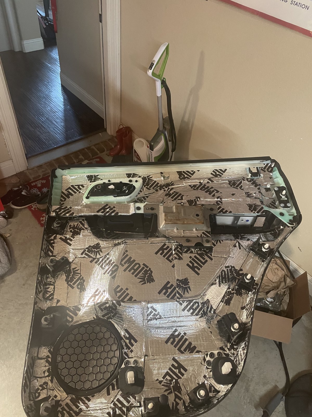

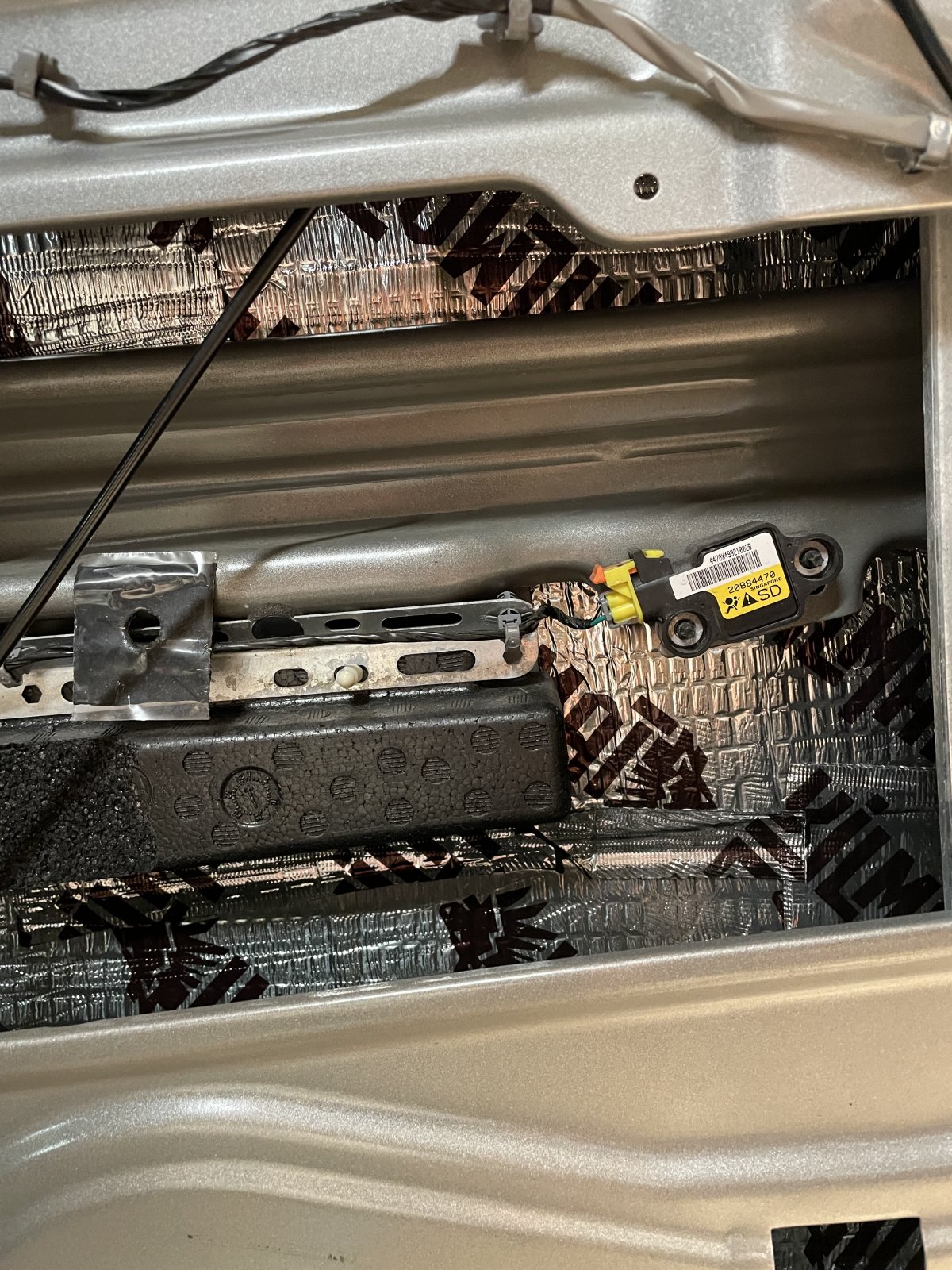

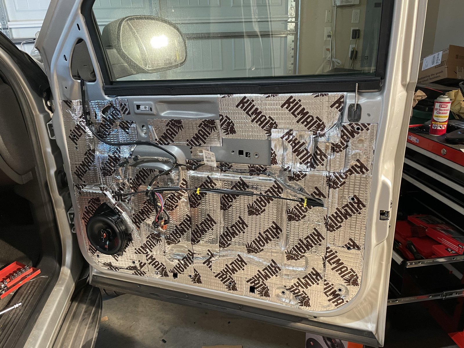

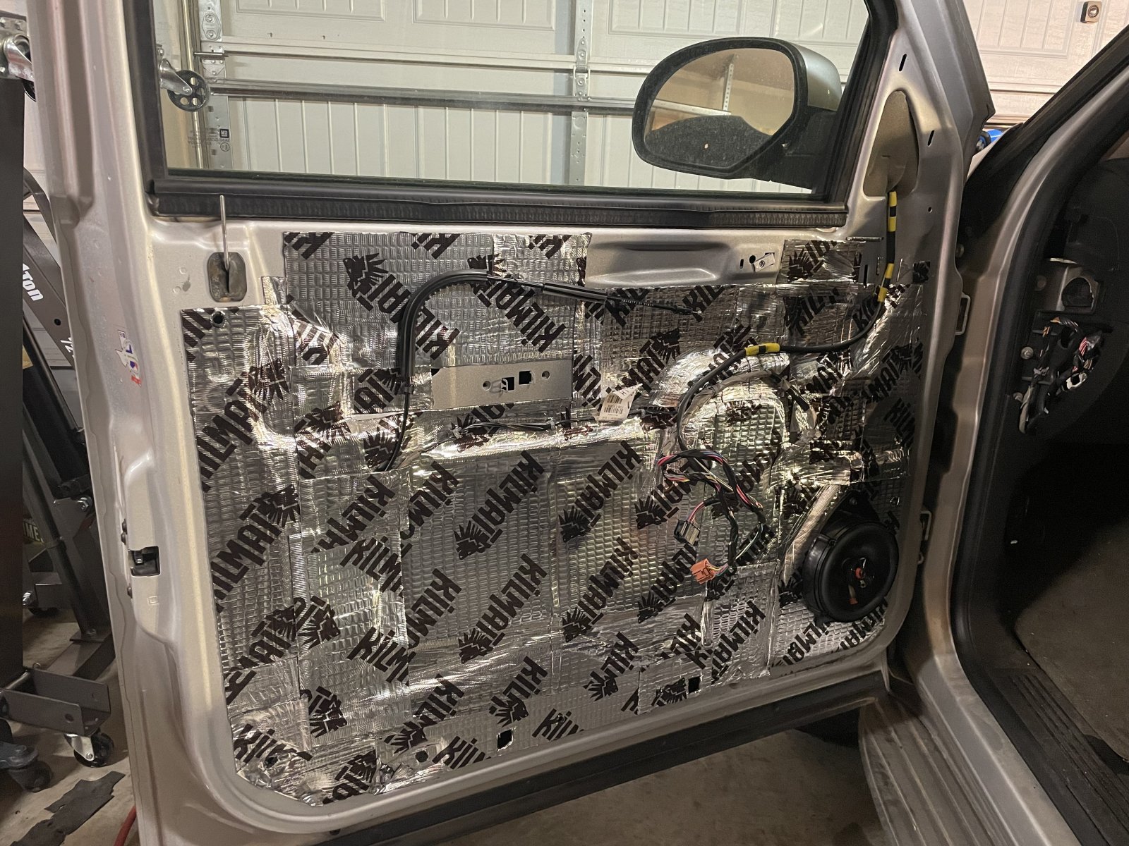

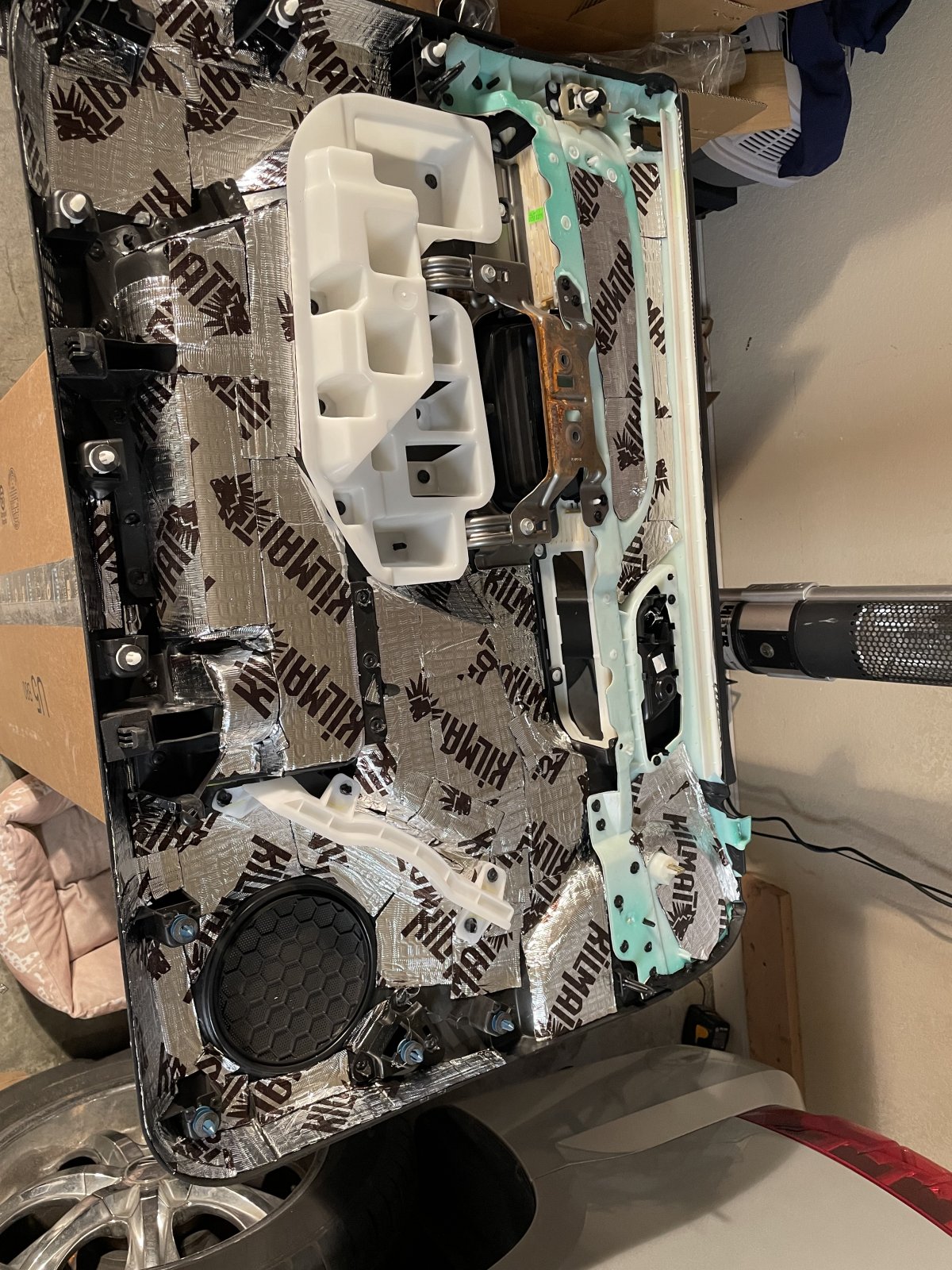

I have not posted in a while because i have been busy between work and working on the Tahoe, but progress has been made. I spent quite a few hours working on sound deadening the doors. I purchased Killmat, which is similar to Dynamat, but significantly more affordable. Eventually I will do the entire interior, including under the carpet, on the metal of the roof, and some stuff in the dash. But for now I just want to get the doors complete and buttoned back up. I also installed my JBL speakers on the doors while I was at it.
I got as much coverage on the inside of the outer door skins as I could.
I didn't take any pictures of it, but I also ordered a a large quantity of accoustic foam, simialr to what you see on the inside of a recording studio, and cut pieces to fill all the voids inside the door panels. Not inside the door, because I didn't want to interfere with the windows going up and down, but in the back of the plastic door panels. All four doors are compelte, although I need to go back in and trim the Killmat away from a couple of mounting locations to get the door panels to sit flush. Overall, this job was easy, but also very time consuming.

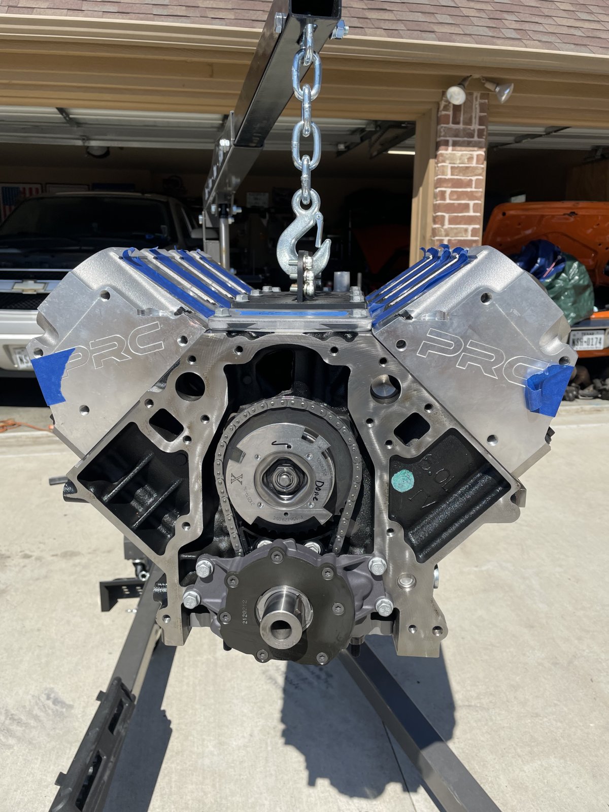

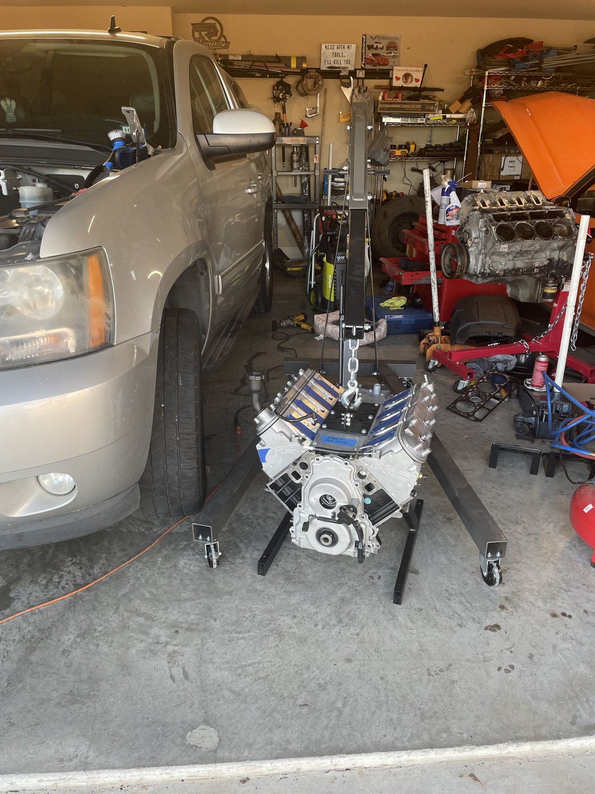

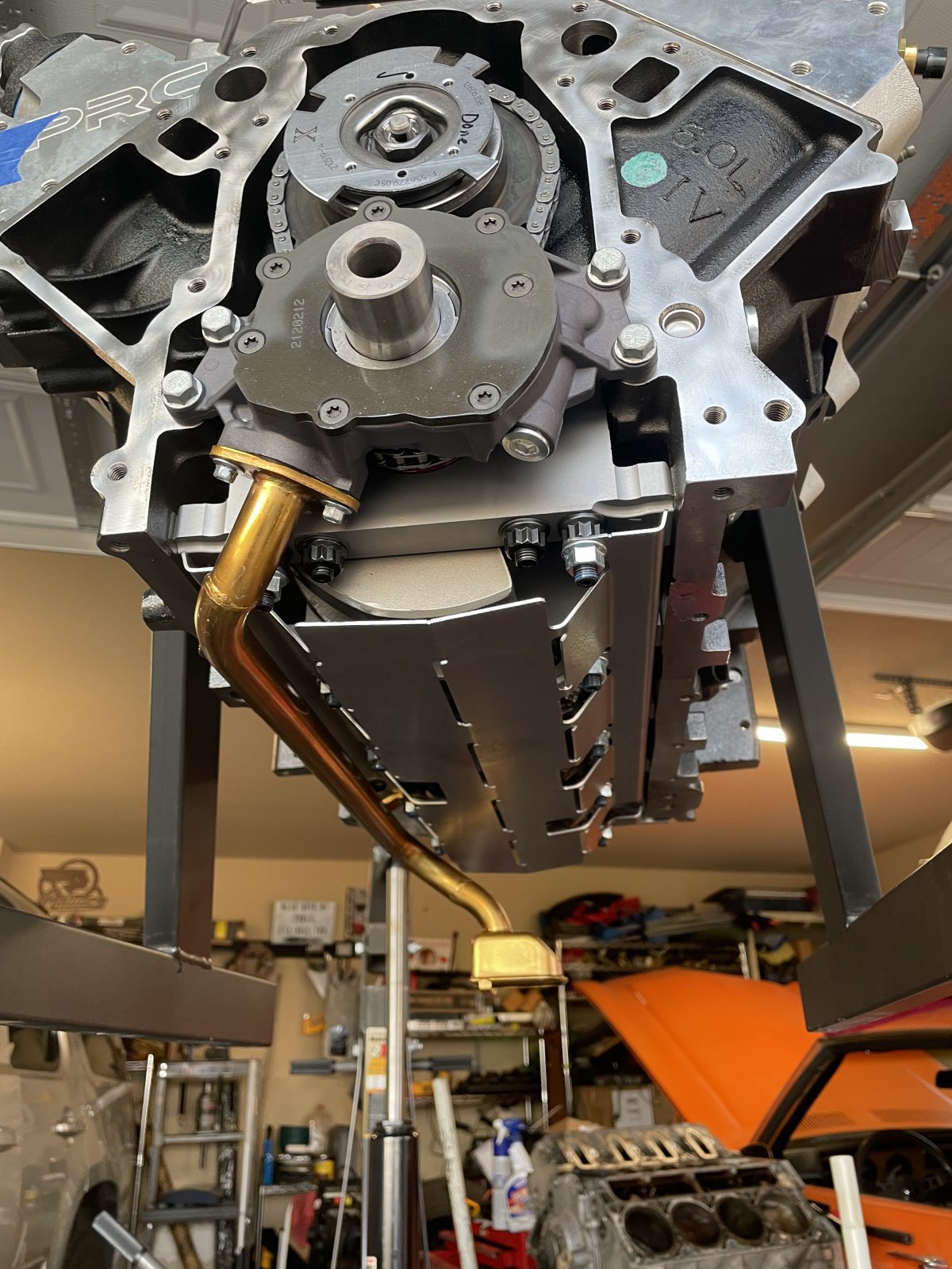

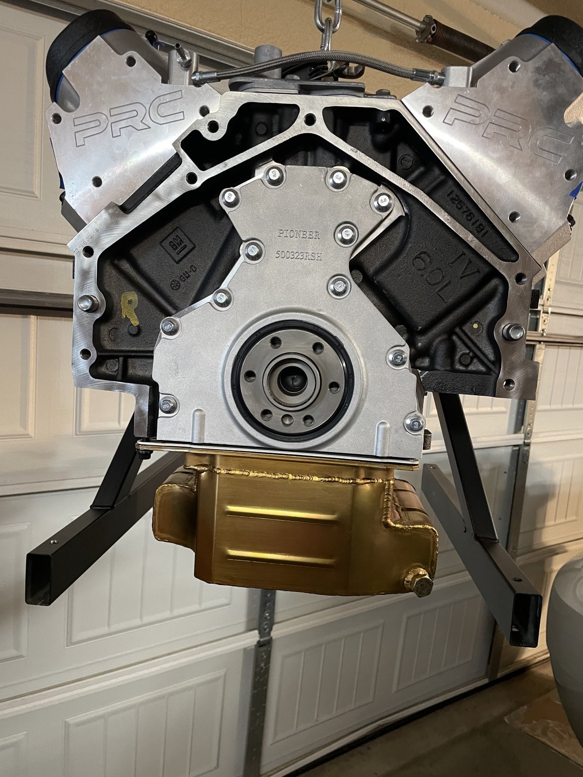

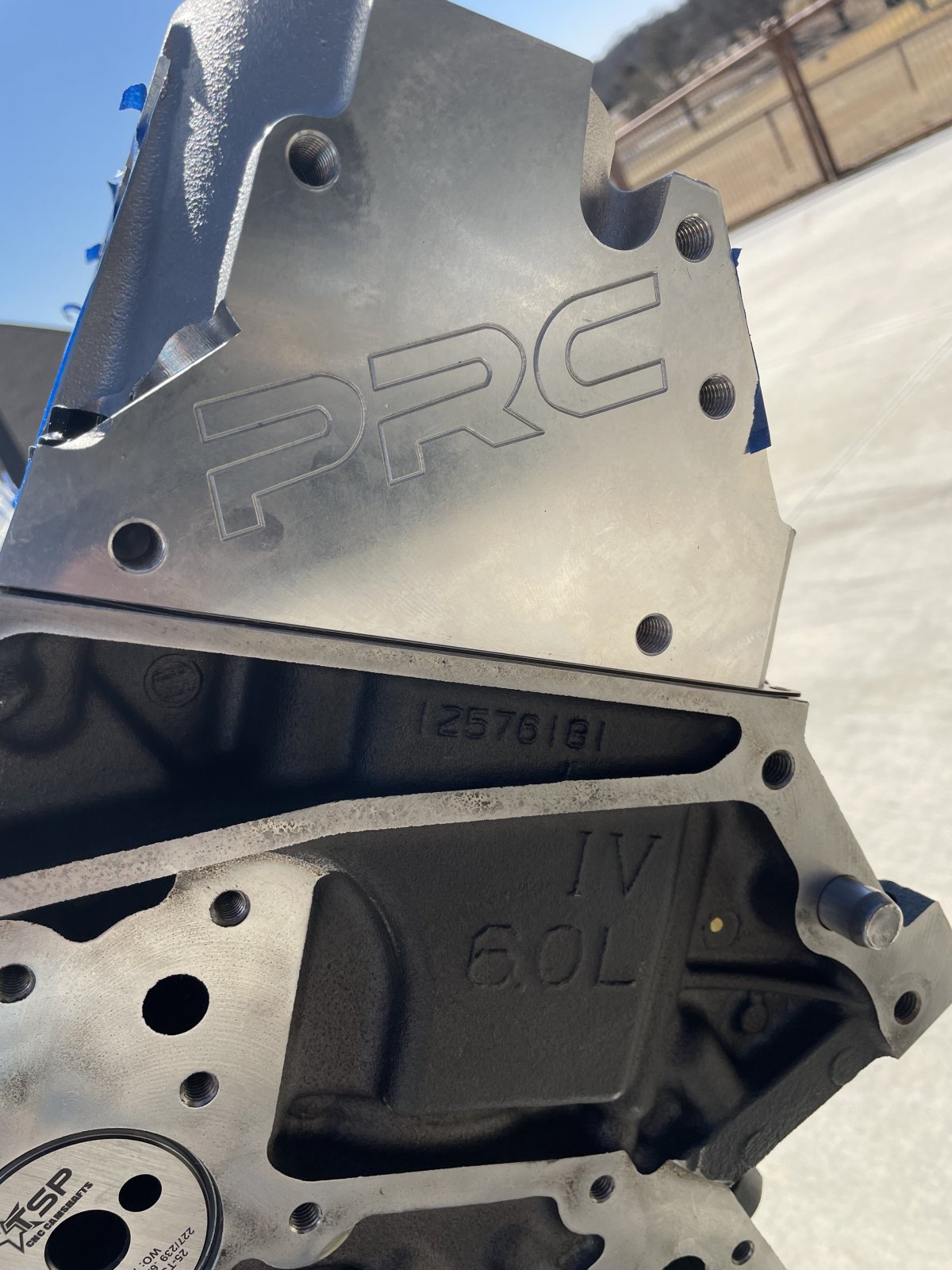

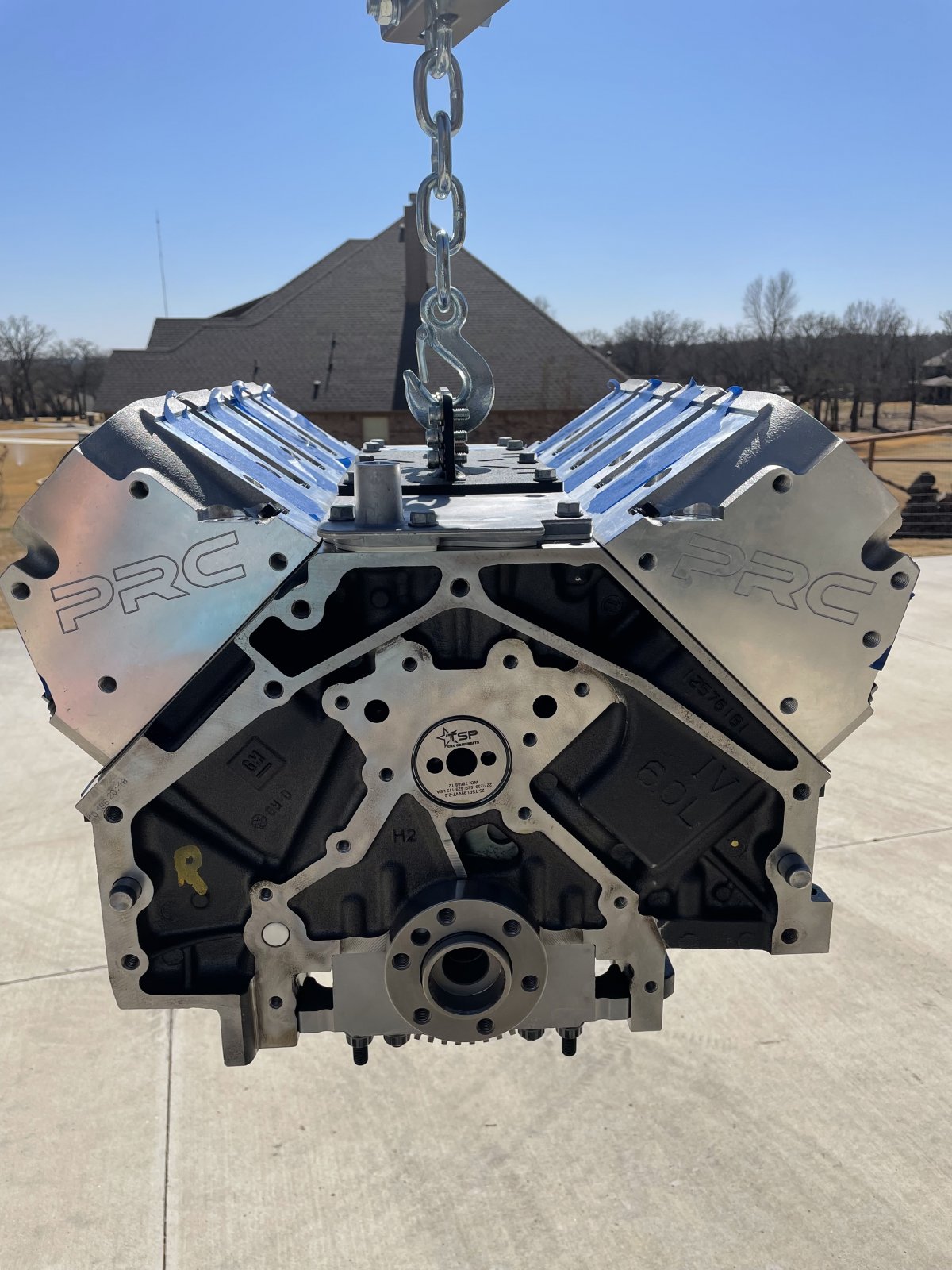

I had a lot of work to get the engine ready to go into the Tahoe. In particular, the front and rear covers and seals, as well as the windage tray, oil pickup, and oil pan needed to be installed. I bought a Milodon 31507 low profile oil pan, which I like because is has kick outs on the sides for extra capacity, and internal trap doors to ensure that the pickup always has oil even in a turn or under hard acceleration or deceleration. What I don't' care for is that the back of the oil pan is very different from stock, and lacks the bolt holes for the lower transmission bellhousing bolts. In addition, the two rear bolts that go into the rear cover need to be much shorter than the stock bolts, but the pan does not come with them. I had an ARP bolt kit, but had to find replacements for those two bolts which I found frustrating. You also have to use a Milodon oil pickup with the oil pan, but I didn't necessarily mind that because the Milodon pickup has two bolt holes where it attaches to the oil pump, and I made sure to put two bolts in it, vice the stock single bolt. Of course I put a new O-ring on the pickup, and lubricated and sealed it with SuperLube silicone O-ring grease. For the windage tray, I purchased a Mast motorsports 401-015 stroker windage tray, which gives plenty of clearance for my stroked engine. Here are the oil pickup and windage tray installed:
And here is a view of the gap between the windage tray and the crank weights and rod caps and bolts:
I turned the engine over by putting a breaker bar on the harmonic dampener bolt just to be sure.
I got a used but cleaned and repainted (I think) GM front cover, and ordered a new rear cover. Of course, new gaskets and seals were included as appropriate. Here is the back of the block with everything installed:
In addition, you might notice that the steam crossover in this picture on the back of the heads. The old heads had tapped bolt holes but eh water passages were blocked off. The water passages on the new engien are open. I decided that instead of blocking them off I'd install this flexible crossover, and then plumb it tothe front portion of the system. More to come on that once the engine is installed.

In addition, the transmission rebuild is complete (in about half the time that I was quoted by CircleD no less!), and I drove down to Houston to pick it up.
My new torque converter took about a week longer than the transmission, but it was finally finished late last week, and CircleD shipped it to me free, and overnight. I have a friend coming over later this week to help me, and I am hoping to have the engine and transmission bolted back in the car. I also had my headers ceramic coated, and picked them up a coupe of days ago:

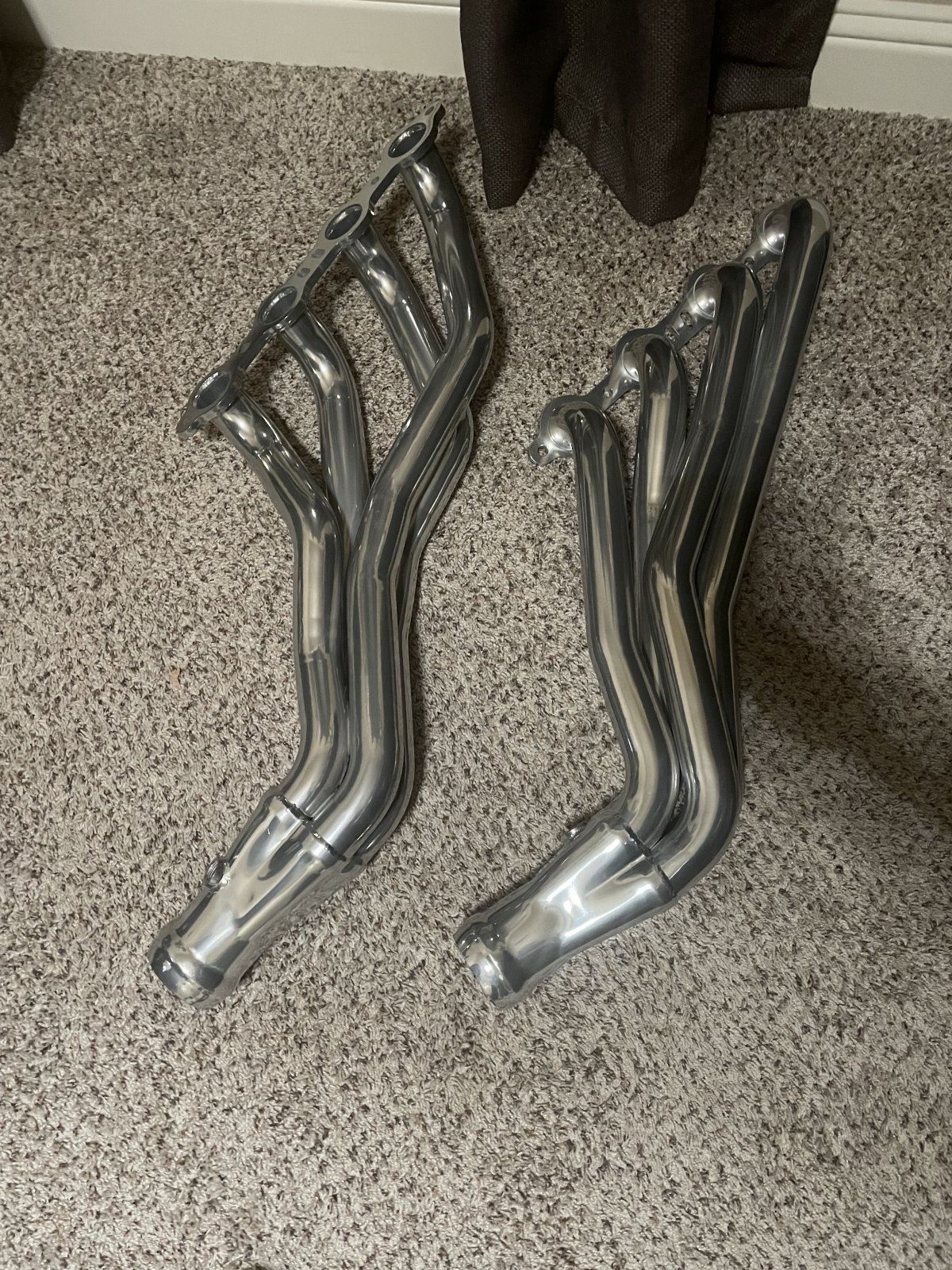

We'll see how it goes, but right now the plan is to get the engine in the bay, and a few inches up off the mounts, install the headers, and then lower the engine the last few inches. I'm told that having it up a few inches will make installing the headers significantly easier.
