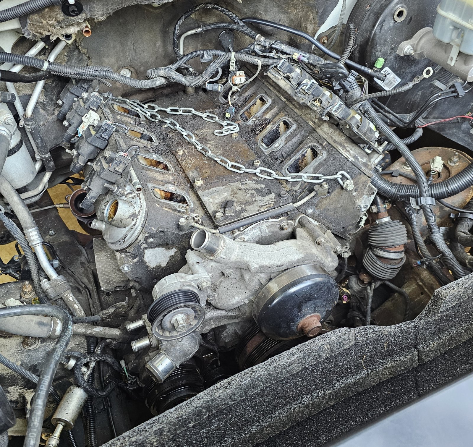

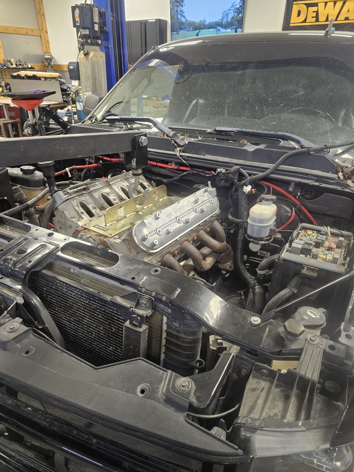

Thanks for opinions and info, everyone. I agree that some of these choices are personal preference. Removing things like fender liners may be easier for some, and not for others. I've removed both sides multiple times for various things, and having done so, I can do it more quickly now. Driver's side motor mount was tricky for me, even with front diff out, and the skirt out helped.
I'm pretty set on removing the core support and going out the front now. I may try and keep AC lines intact and just move to the side, but haven't decided on that one yet.
