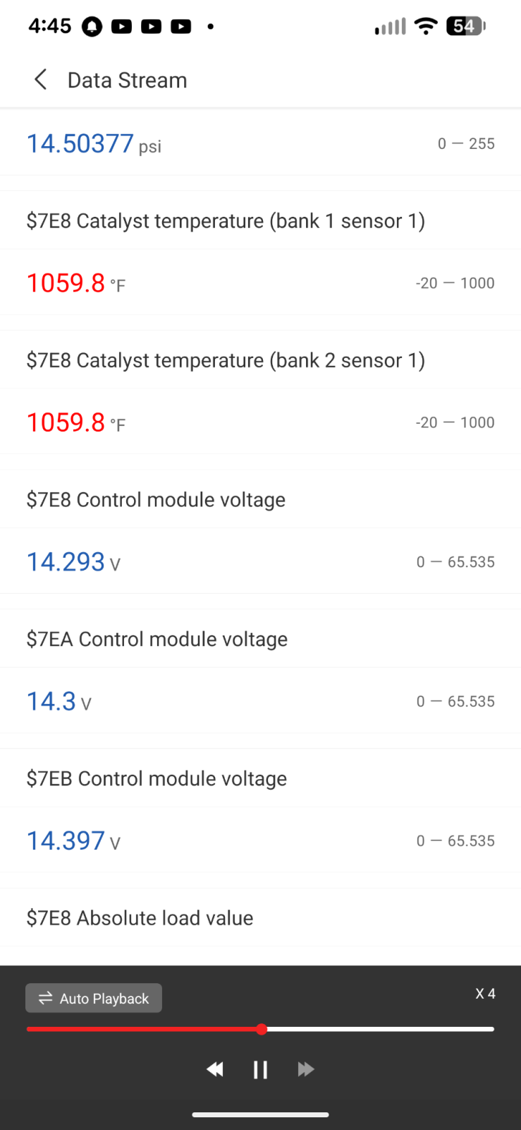

I do have some codes stored, but no MIL illuminated. Some of them may be set since they haven't run yet. I've attached the full report. I've replaced the purge valve since it was contaminated and stuck from charcoal migration through the EVAP system. I do get large negative fuel tank pressures around the time it dies out. I've attached a screen shot of the catalytic converter temps when it died most recently. It will die at idle, but it will stumble under load.

Those just look like incomplete tests..
How much negative pressure?
Might unplug purge valve to see if it still happens..
