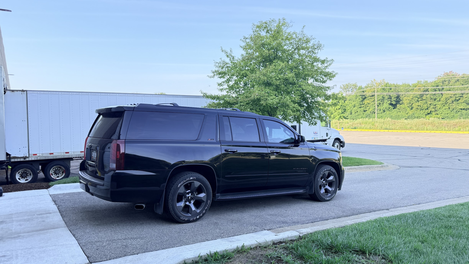

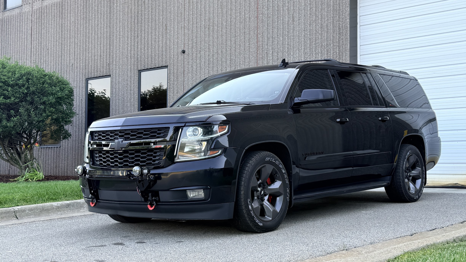

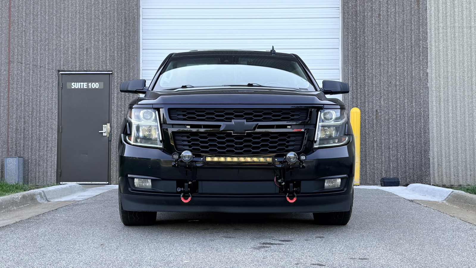

Its been a while now truck is running great and treating me well.
Its converted to run on Flex Fuel and I run that stuff any chance I get. It does get poor gas millage but at 2.99/gal I cant really complain.
Things upgraded to date:
AIRAID intake tube.
Aftermarket magneride struts and shocks ~350$ and are running as the oem ones did. Only reason to change them is one of the front struts froze up.
MBRP Exhaust installed.
Light bar from GMT900 along with Silverado tow hooks with D Rings.
GM Performance brake upgrade on the front axle.
We have wireless controller for the AUX lights. And the grille was upgraded since the original one was broken.
Out back it has LED tail lights upgrade along with liftgate struts. RAM wheels.
zinc
Aug 2, 2025
15
Clean. What exhaust tip is that? Looks good and better than the round one the MBRP comes with.
LSCALADE
LSCALADE
May 6, 2025
255
663
zinc
Aug 2, 2025
15
Nice, thanks, ordering it now. I'm also going for no-chrome. I painted the MBRP one black but it still doesn't look right. Other than that happy with the exhaust, easy to fit and sounds pretty good while not being too loud/droney on the highway.
