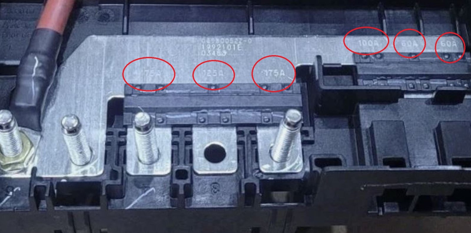

the $199 diagnostic you posted a photo of noted the 300amp fuse was blown. That fuse is part of the BATTERY TOP panel, that whole panel is one big fusible link, each red power connector on it has it's own separate rating, so like 175amp, 125amp, 100amp, etc. If you look at it closer you will see numbers stamped into it for each outlet.
so if even one link is burnt out the whole piece has to be replaced, it is not repairable.
could you bypass a link with a external fuse, ya but that's janky at best and you would still have to buy a decent fuse & connectors to do so
each of those red cables goes to different modules, when one link burns out the rest still have power but then either it wont start or half the system is not working because it's part dead.
I would at the very least use a meter a check each of those links for continuity. I could be wrong but I don't know of any other main fuse on the k2's
**ALSO if you find one or more burnt out, find out why before just replacing the panel because there not exactly cheap and if there is a short to ground, etc it will just immediately blown again

I used a multimeter to test continuity. The fuse is blown at the first post from the positive connection. It has a piece of conduit on it not a single copper wire connection like the other two.
