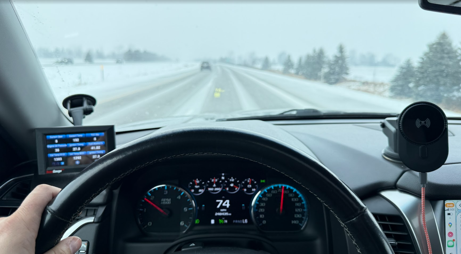

This may be the first real experience driving on fresh snow, its been ice and slush roads up to today and I am quite happy that I picked a suburban with 4x4 system. The 50/50 power split gives so much more confidense than my Escalade whcih is AWD and tends to send more power to the rear and on a few occasions on hard forward accelaration the back end wants to step out and it can scare the living c*ap out of you because it acts like a Mustang. But while it does scarry stuff it also likes to rotate under power and even drift which is fun. But the suburban is the better choice for people who dislike side movments when moving forwards.

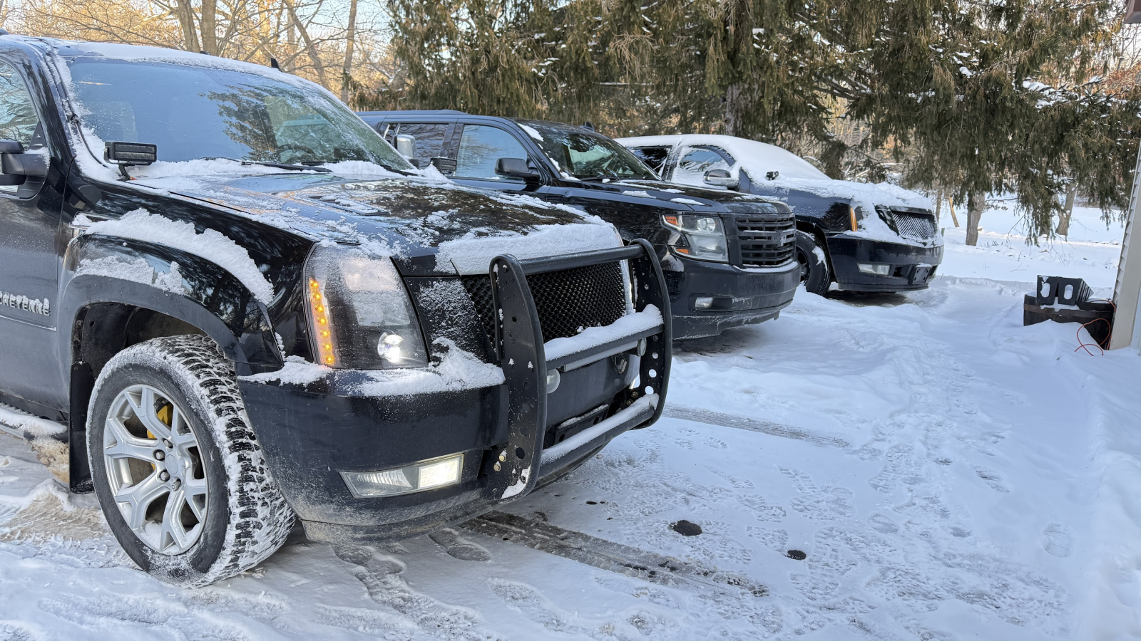

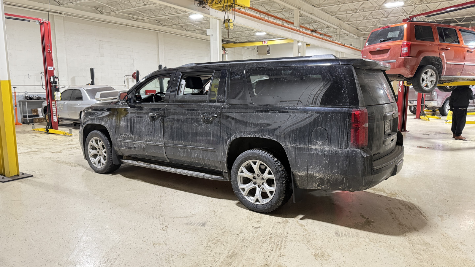

This weekend the weather was brutal around -11F and wind and snow so it was time to take the truck to a heated shop and do a top down inspection.
Replaced engine oil with Valvoline Restore & Protect 5W30.
Transmission oil filter and fluid was replaced.
Transfer Case fluid repalced.
Front diff fluid looked ok. Will be replaced in the summer along with the rear diff.
Transmission internals looked good if not excelent.
Installed mud flaps becase behind the rear bumper there had to be 25lbs of snow/ice piled up deep behind the bumper.
and gave the old girl a wash.
There were codes for catalytic efficiency P0420 and P0430 and both of those have dissapeared and the engine is runnign very smooth but I did run through 2 tanks of Chevron Techtron injector cleaner and whatever that did it smoothed out the idle and removed every hint of vibration from the engine.
Replaced the thermostat. It was showing as if it was 185F on the gague but in reality it was sitting at 145 on the OBD scanner.
Oil catch can is next on my list of things to do.
And all 3 chilling in the freesing temps waiting to be driven.

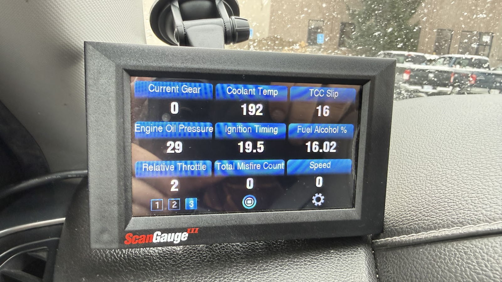

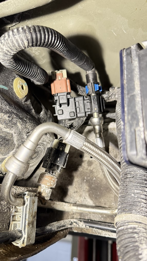

Installed a flex fuel sensor so we can run some E85 on the L83. GM says that on E85 this produces around 385hp which would be a welcome gain.

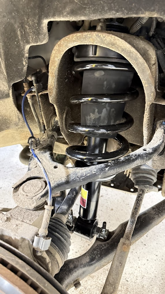

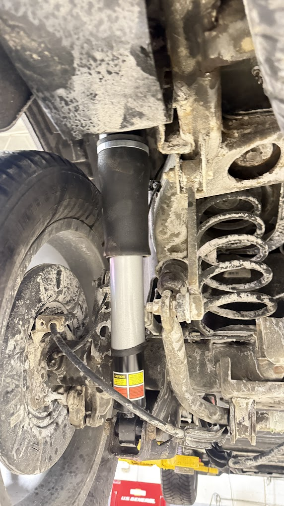

Installed new MagRide rear shocks. The difference is incredible. The old ones were working fine but the air lift was leaking and this now rides fantastic and the air leveling works as it should.
Full inspection. Car checks out from all aspects and it now has 248,000miles and is ready for the journey to 300k.
Front diff fluid was a little dirty but is now changed and the only thing left to do is rear diff which will be done another day.
LSCALADE
LSCALADE
May 6, 2025
227
603
Tuned thorugh HP tuners to enable the Flex Fuel sensor. I was at 9.77 on 87 fuel. After 2 gal of fuel added it jumped to 16% so its reading perfectly.

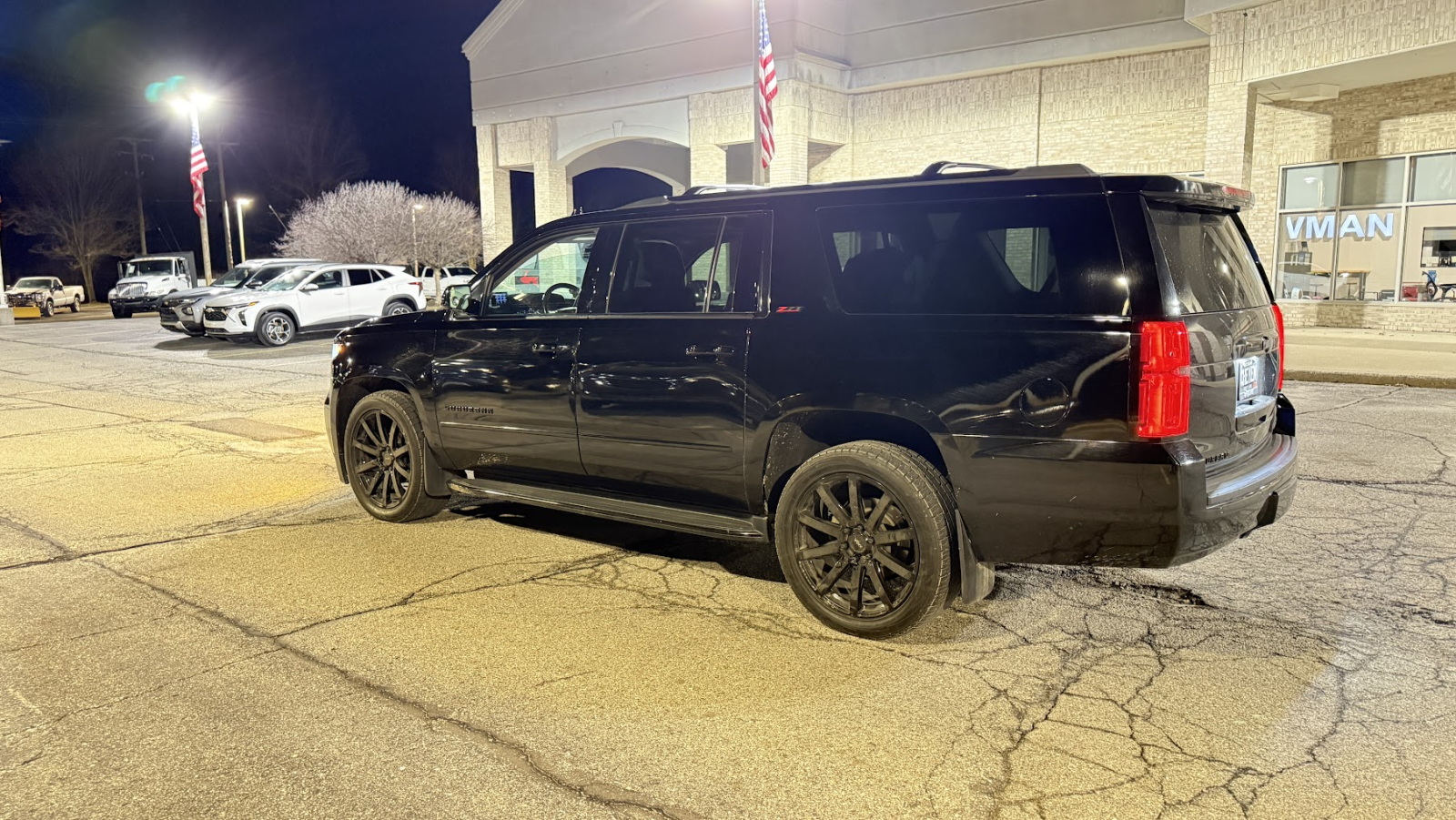

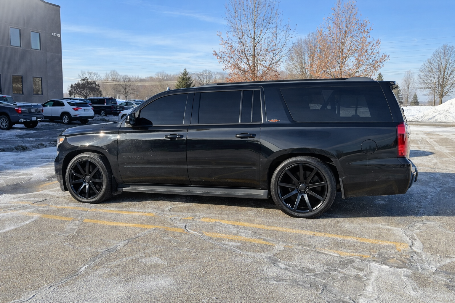

Made some changes that I like very much and looks like I’ll be ordering a drop kit and window tint next. Black wheels pictured are off my Escalade.

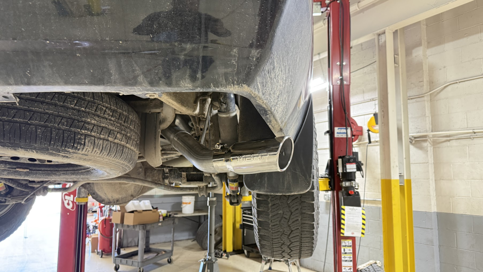

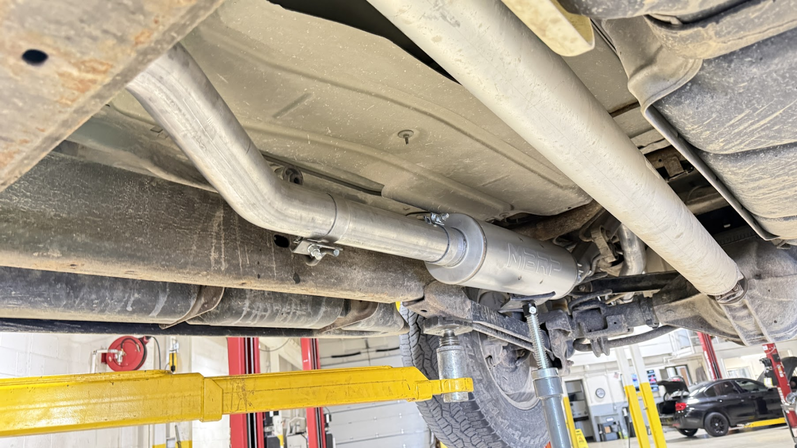

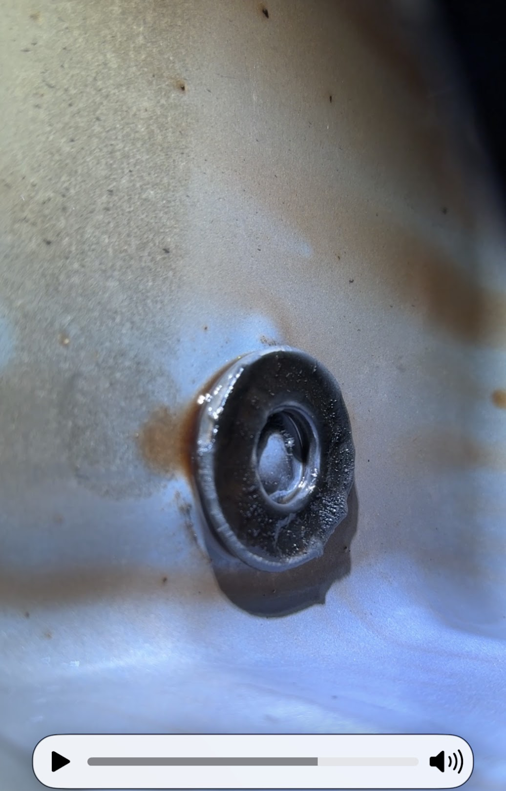

Found the flapper valve seized up, went to try and free it up and the flapper door must have fallen off and rattlign around in the muffler... solution, just throw a new 3" exhaust on it.
Its a little bit loud but it quiets down when you are cruising. I may be adding a second muffler down the road. Overal fit was 10/10 and while on the lift I swapped front struts too. 2hrs start to finish.

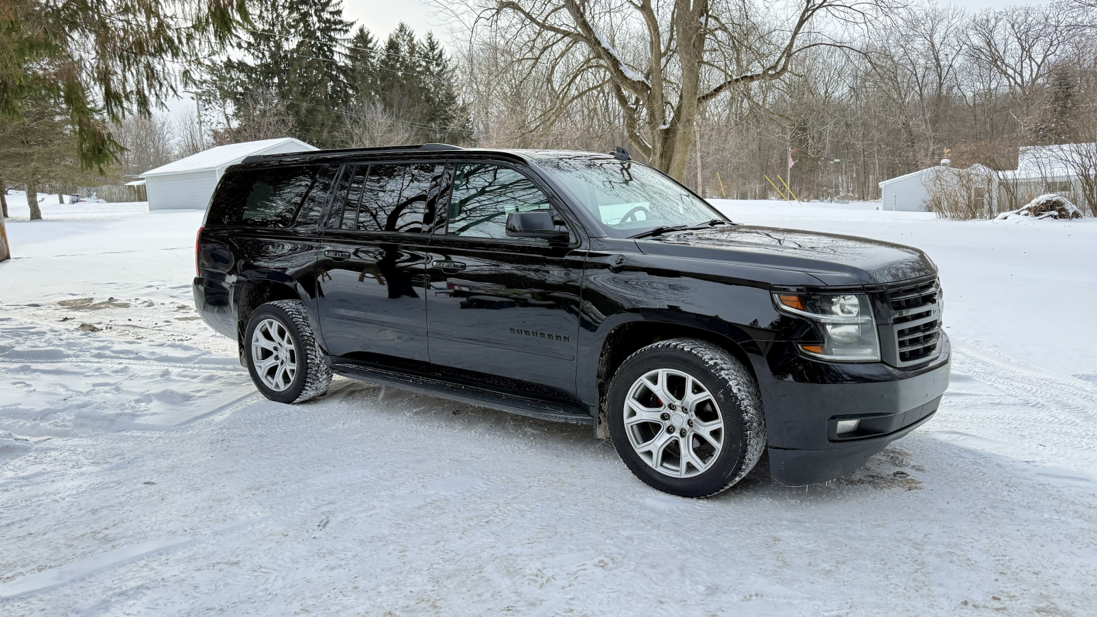

Couldnt wait and I swapped in the summer wheels to see how it will look! Cant wait for good weather.
This thing gets a wash every day and its impossible ot keep it clean with all the mud on the roads around me.

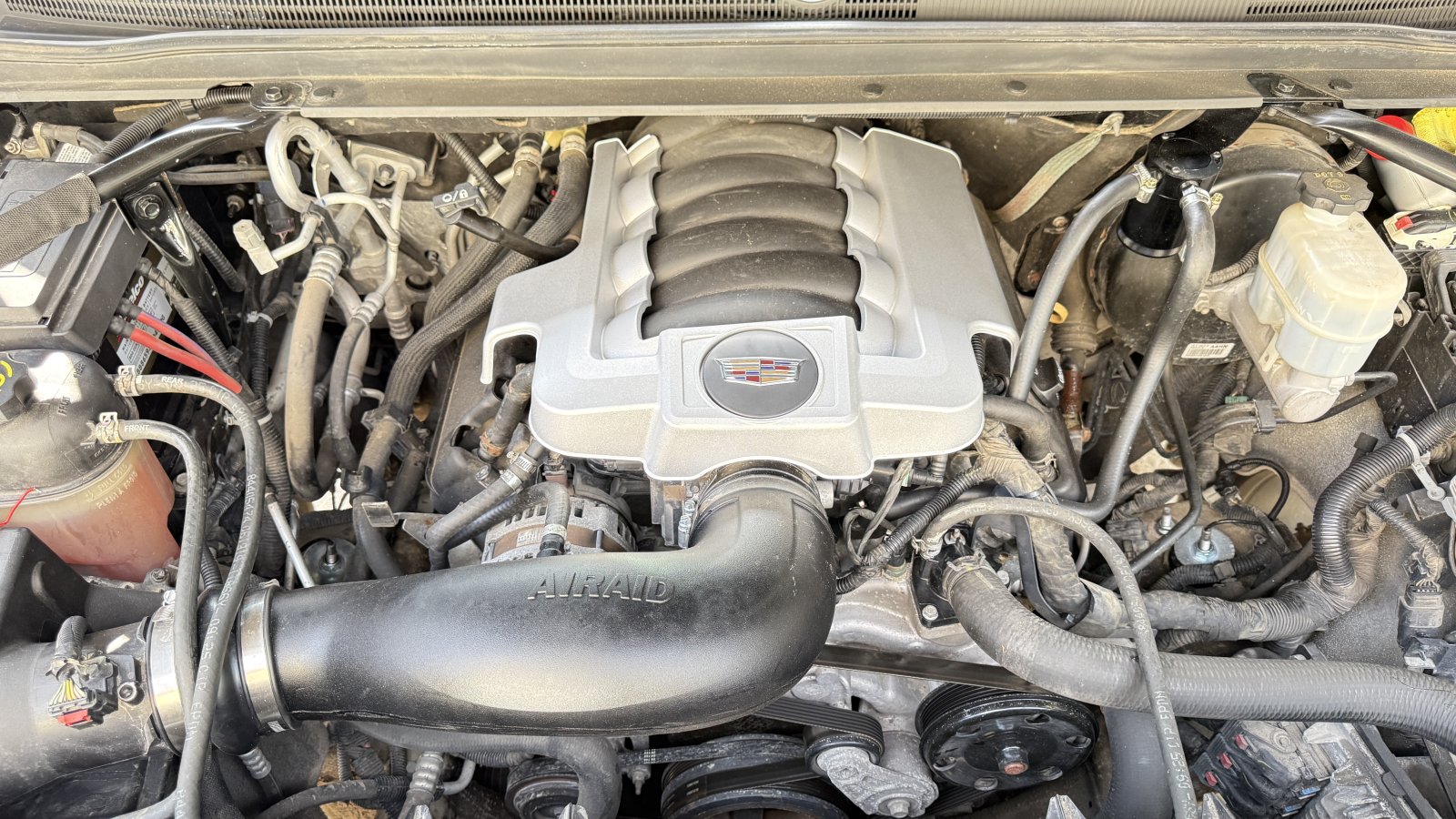

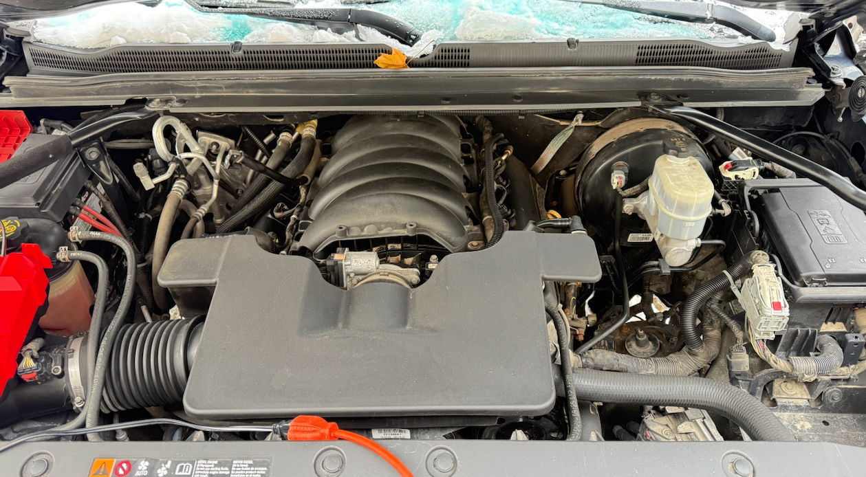

For anyone interested in the factory engine cover from L87 Amazon sells genuine ones for about 77$. I wanted to hide some of the hoses and injector wiring and this was perfect. I have a 5.3L and it fits as if it was meant to have one from the factory.
