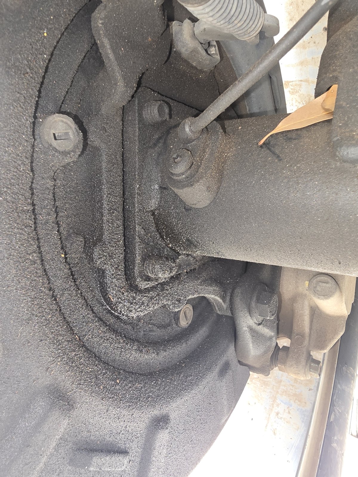

I thought I updated this but apparently not. Yes there is leakage around the left rear backing plate(edit:added a picture of the leakage below). I took it to a shop and they said wheel bearings. So I replaced both rear wheel bearings and seals and the sound is still exactly the same. What would cause the leaking from the backing plate? Also on the side with the leakage around the backing plate, I had a HELL of a time getting the axle in and out. I had to use a slide hammer to get it out the first time. I dont believe thats normal.
So I put the stethoscope on the differential and the noise is 100% from the diff. As my knowledge is very limited with differential work i guess im going to have to pony up to get it looked at yet again, by a different shop.
So I put the stethoscope on the differential and the noise is 100% from the diff. As my knowledge is very limited with differential work i guess im going to have to pony up to get it looked at yet again, by a different shop.View attachment 485260
Yeah, that leakage is a classic sign of a failing axle seal on that side. But I'm confused - didn't you just replace that bearing and seal?
Yes, a slide hammer is sometimes needed to get the axle shafts out after removing the c-clips on the diff side.
You might be money ahead to go to a junkyard and pick up a low-mileage used rear axle assembly that's in good shape. I have 255K on my 07's original rear axle and nary a leak in all of that time. Still dry as a bone, so they can last a long time.

Yeah these axle seals are sorta troublesome. Have had to replace one on both of our trucks.
Actually also replaced the axle on our Sub at the same time, there was scoring where the seal lives and I didn’t want to do the job twice.
Makes a damned mess when it leaks, that’s for sure, and can also foul the parking drum and/or brake rotor/pad if it leaks enough.
