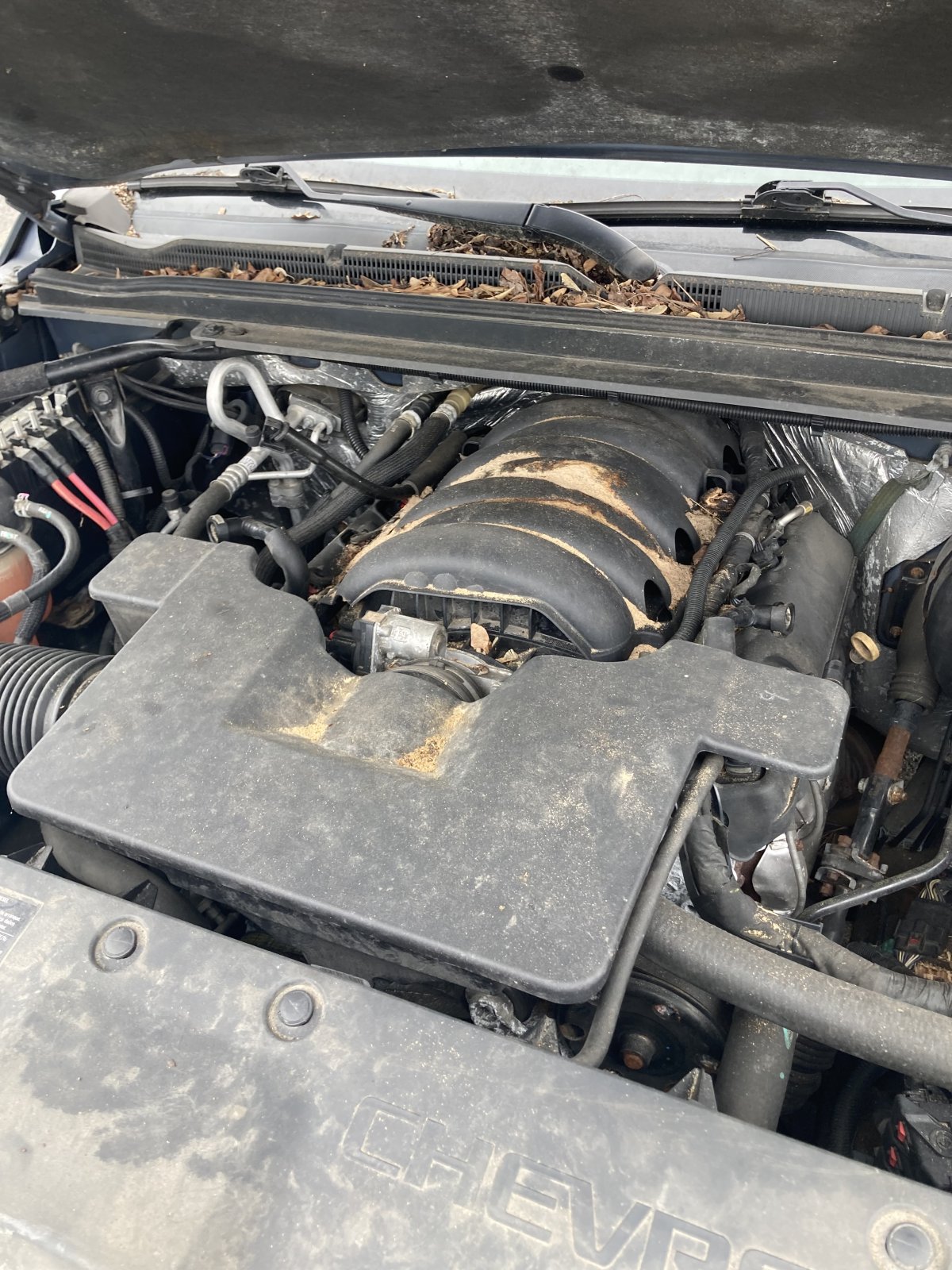

Bigburb3500
Jun 7, 2024
854
1,340

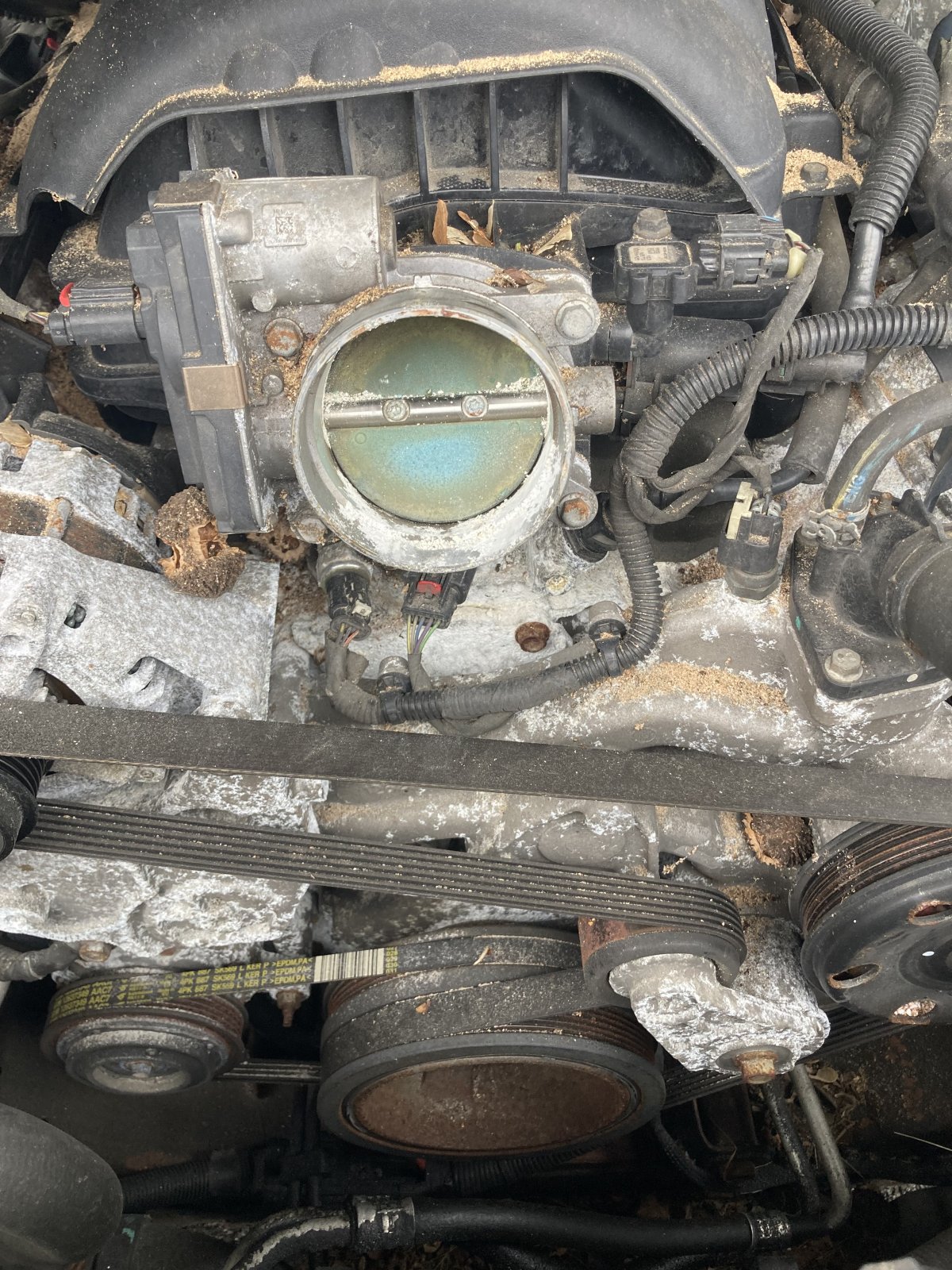

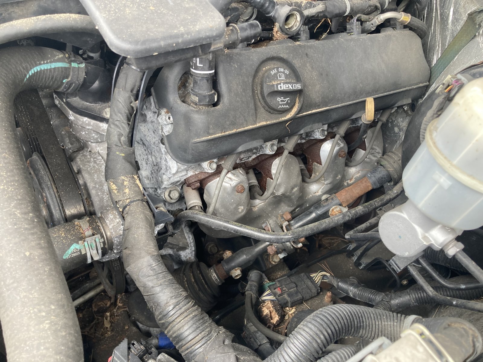

If you manually open the butterfly, what does it look like? This really doesn’t look “bad”… it just looks like it needs a bit of cleaning and that’s it. Are any fuses blown?

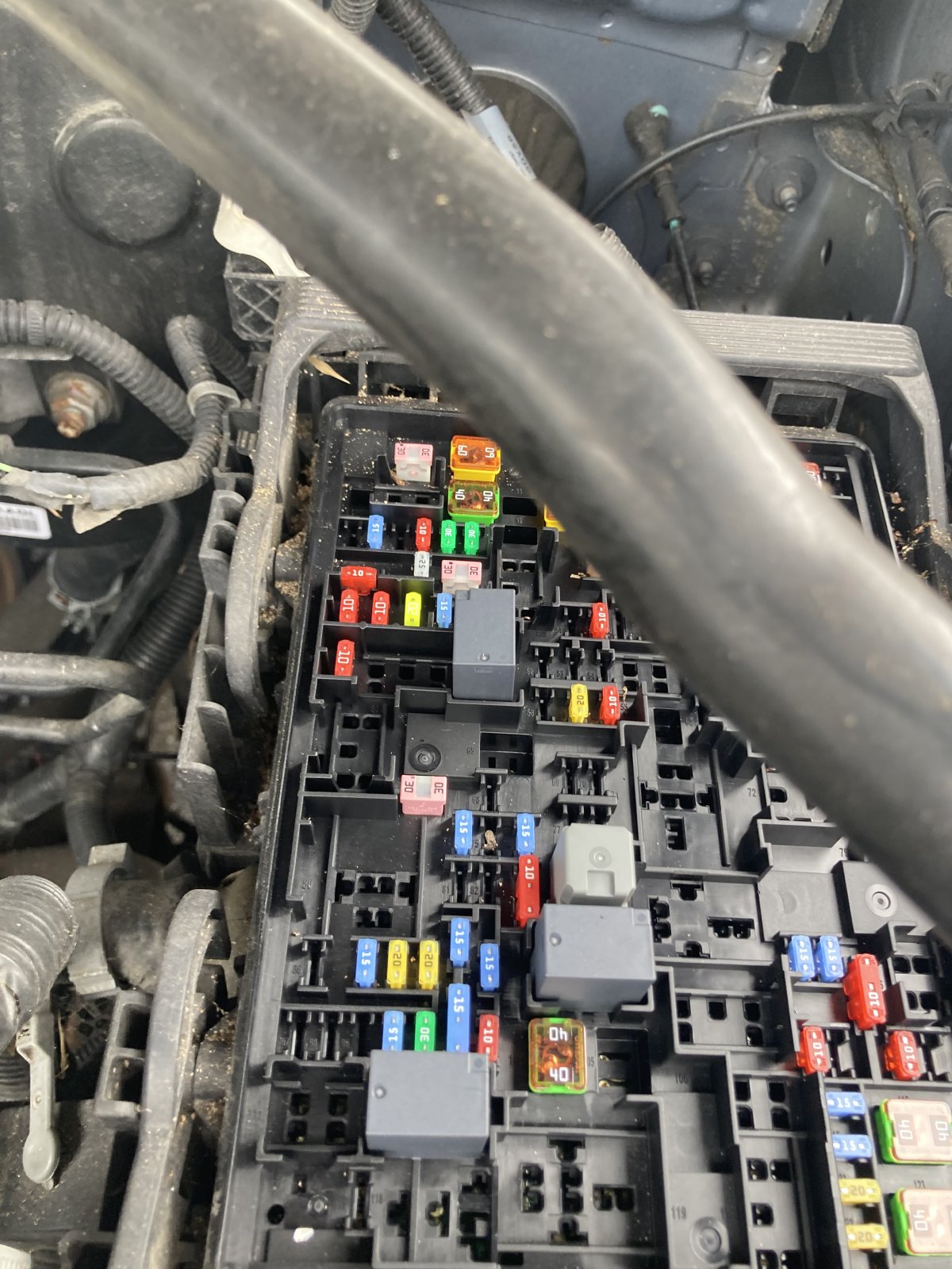

**I see that the 300AMP fuse if blown. With the new starter and fuse it might be fine…
30,698
48,333

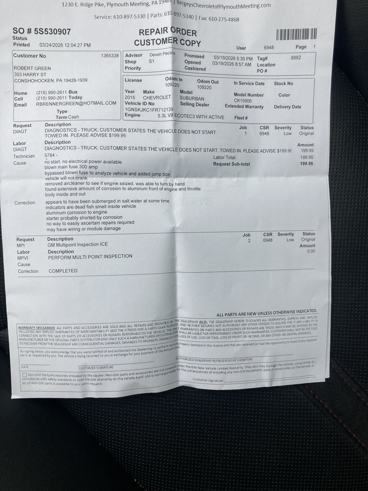

This is what the dealer service record says
don't go back there, that guy didn't want to work on it.
from the pictures it does not appear to be all that bad, it has been exposed to moisture and has been sitting otherwise standard dirty engine compartment.
put those intake connectors back on, pressure wash it. pull the starter and bench test.
then your going to need a new fuse (the battery top connector, there about $120) and check for any direct short that could have blown the fuse.
as for the throttle body you "could" clean it rigorously or just grab a used one from a auto dismantler/junk yard
**if any of the other battery top fuse were blown that "could" be a reason for no start as well, it's basically a fusible-link

Dealer says the truck smells like fish and looks like it was possibly submerged. I think there is more to this story.
If you have a vehicle that smells like fish and the dealer wrote that it must be a real shit box.
BURN IT.

Or the dealer sees a "sale" opportunity.
