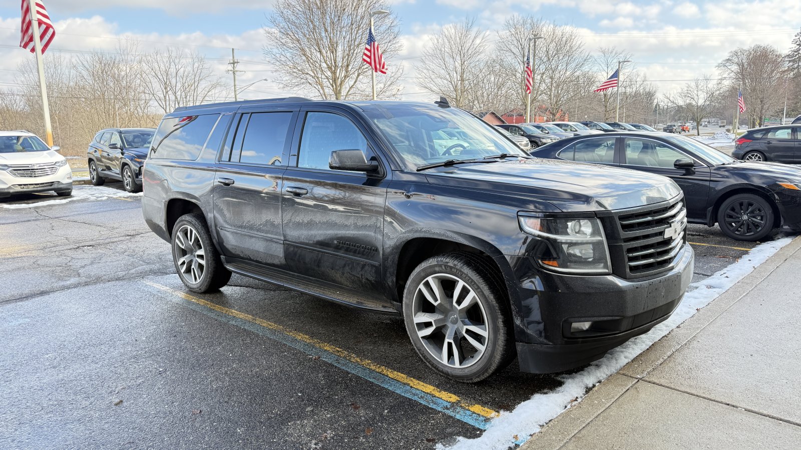

Hello folks, I am an owner of 2 3rd gen Escalades, both old both with over 200k miles, I know them well and they have been great partners.
I have an opportunity to buy a 2020 Suburban Premier with over 250,000 miles. The vehicle was driven 42k/year and received regular oil changes about once every 7000mi but religiously followed and done at the same oil change place.
Seems to have all the maintenance windows done, such as coolant flushes, transmission flush etc.
Trans was replaced at 130k miles.
Now with such high millage what would you reccomend, is this a vehicle that is on its last leg? Due for 2nd transmission? Lifters? Looking for advice on anyone with high millage and the type of repairs you have had to do.
Seems to drive ok, no noises, but the millage worries me a little bit. Will be going to scan it with a scan tool to look for any potential hints of problems to come.

Drove it. It’s solid, needs motor mount on the left side. Tail light leds are out and has codes for catalytic converters. So I’ll be picking it up in the next few days. It was owned by someone who only used the driver seat a put about 160mi a day and traveled quite a lot and changed the oil religiously. Did not spare cost on dealer maintenance either. Trans and TC replaced at 130k. Decided at such a sharp discount it’s worth it for me. This is also a model pre covid so it did not see cost cutting like the rest of them past 2020.
