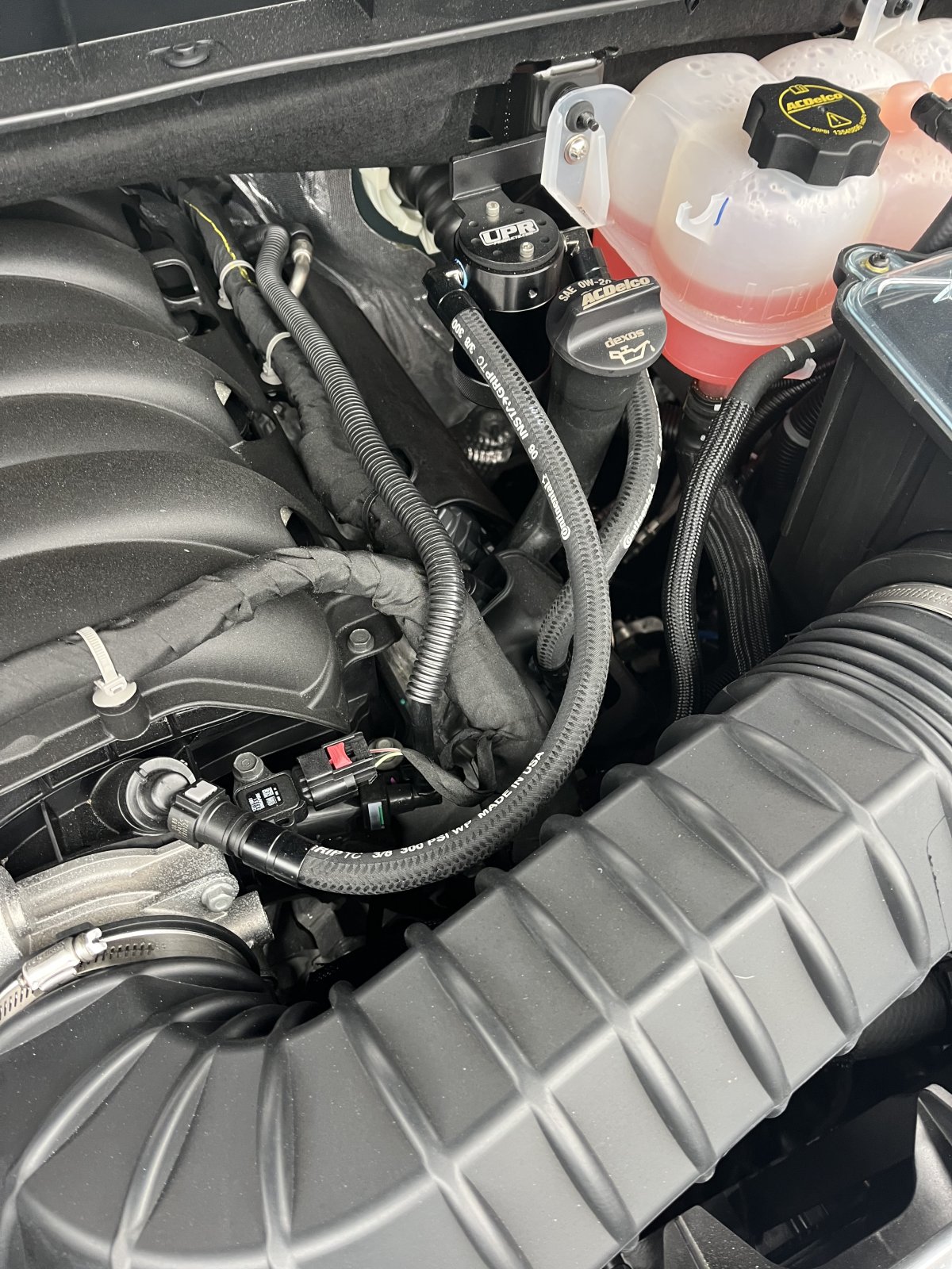

I like to run a catch can in any DI motor for sure. Read up on it it’s up to you.
After I had to pull the intake and walnut blast the valves in my 2015 and seeing all the oil in there I run them on any vehicle I care about.
Interesting, i tried looking up the UPR kit you have, and it looks little different, but still something i might need to add to my burb
Yep that’s the one I had in my 2015 I installed after I cleaned out all the valves to keep them nice and clean. It worked well. It would fill up between oil changes.
I have a 2026 now is why the picture I posted looks different.
