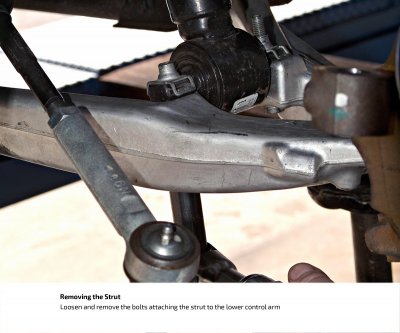

Good write up on the repair. One thing I found when replacing oil pan gasket is you do not have to totally remove the front diff. If you remove the lower shock bolt that is under the axle shaft, then the diff bolts, it allows the axle shafts to drop down further thus allowing the diff to drop a few inches lower.

This is a example of what I mean. See how the lower shock bolt is in the way if there was a axle shaft above it?

From my experience you do not need to remove the differential to get the pan out, like mykeyss said. You can just unbolt it and let it drop down a few inches and the pan can slid in and out fine. That's what I did. Saves you a lot of time and effort for sure.

Honestly, I didn't find it that bad. You don't have to drop the whole diff. It's enough to loosen the passenger side mount and the bolts for the CV axle flange, and let it hang. I then dropped the steering rack and let it hang from the tie rods and also removed the cross member. I could do the job again in 2 hours and am just about to because I'm putting a new oil pump in now. An air impact wrench was worth its weight in gold for the job.
