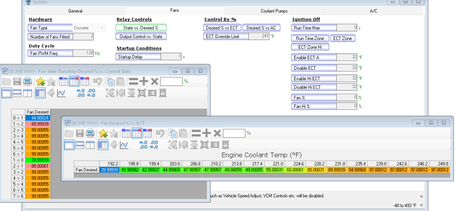

192.2degF is the floor.
Stock fan on @201.2 degF.
Stock aux fan will turn on @231.8 degF.

(718)-
192 . . . 196 . . . 199 . . . 203 . . . 207 . . . 210 . . . 214 . . . 217 . . . 221 . . . 225 . . . 228 . . . 232 . . . 235 . . . 239 is already overheating anyway ...
40% . . . 45% . . 50% . . 55% . . 60% . . 65% . . . 70% . . 75% . . . 80% . . 85% . . 90% . . . 95% . . 96% . . . 97%
For whatever it's worth, fans don't really need to be on under 199F, forward motion should provide the radiator enough headwind -
unless the AC is on, in which case the AC psi should determine fan setting by overriding the above settings.
