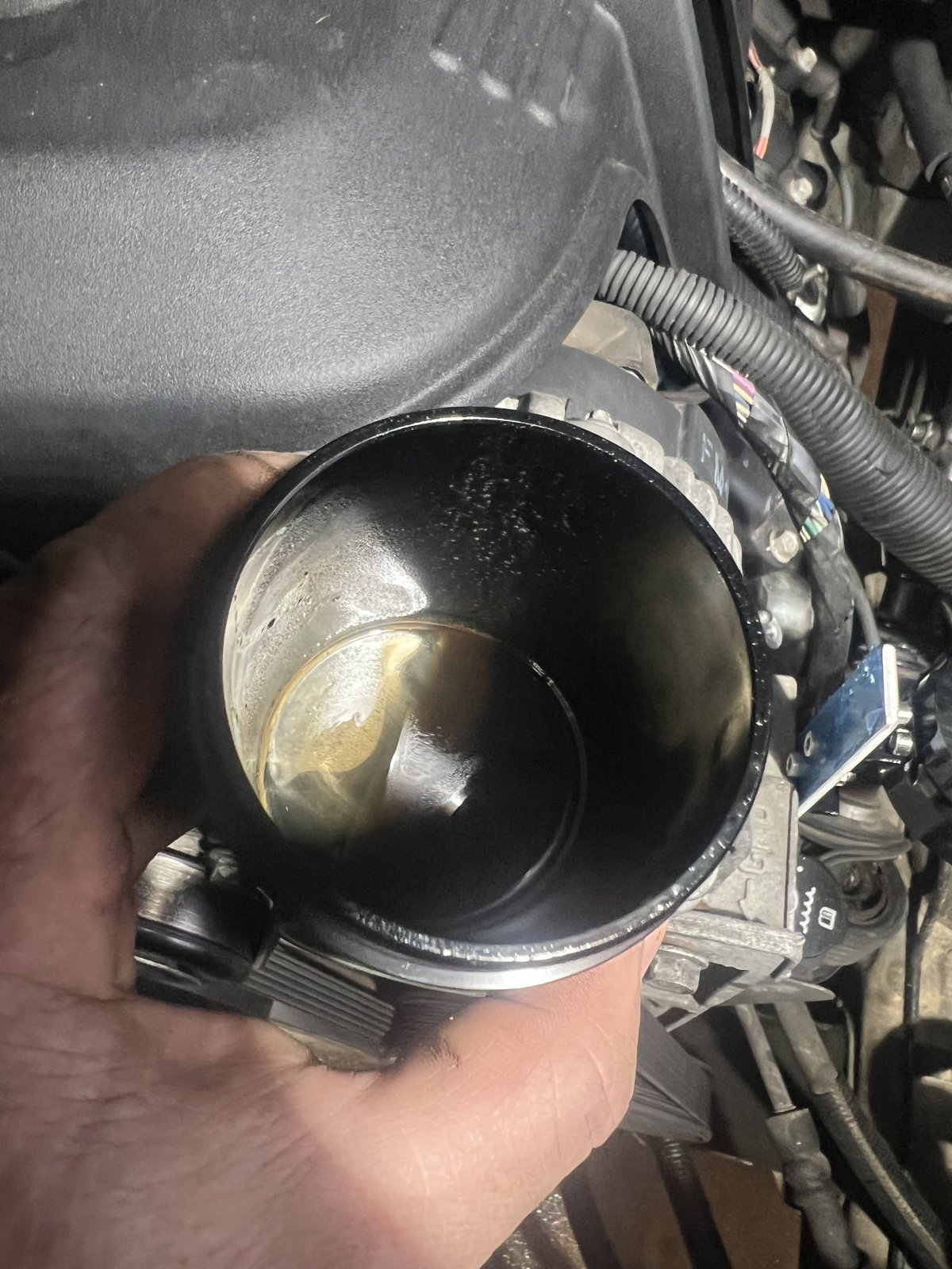

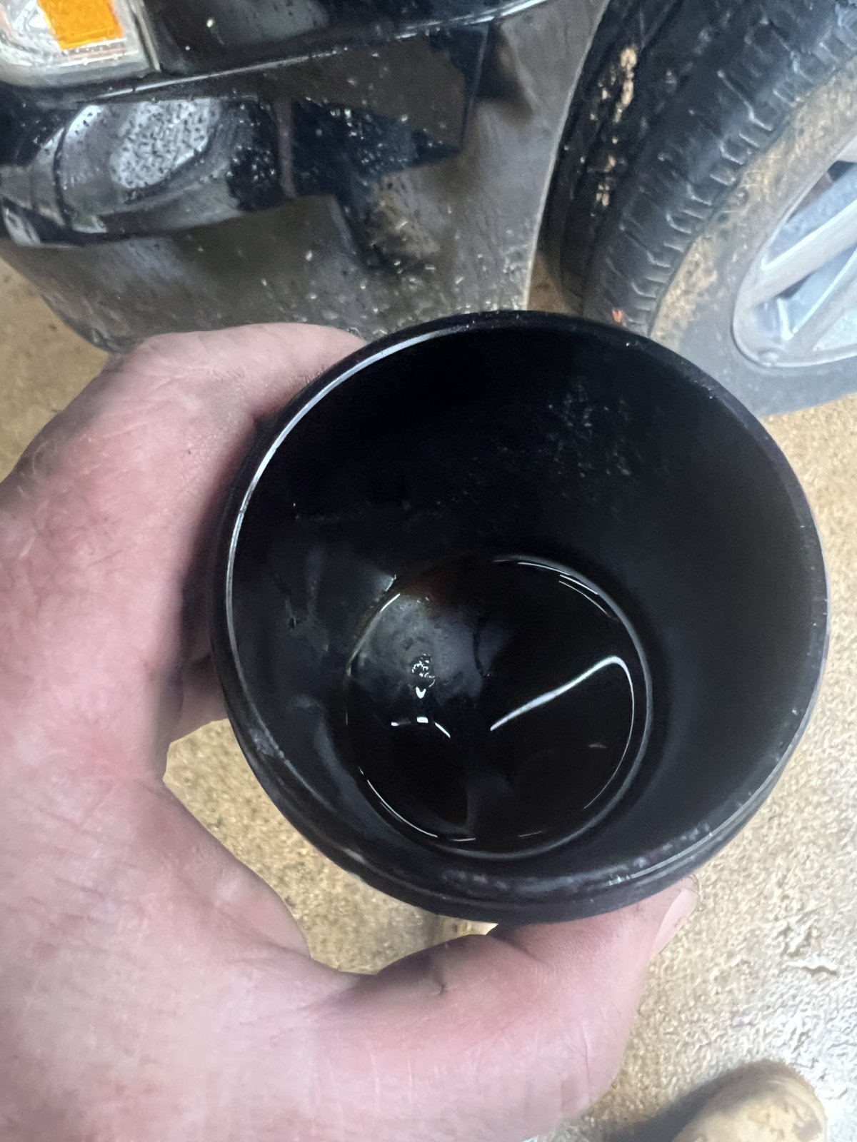

I have pulled a few ounces of oil out of the catch can twice in the last 1k miles

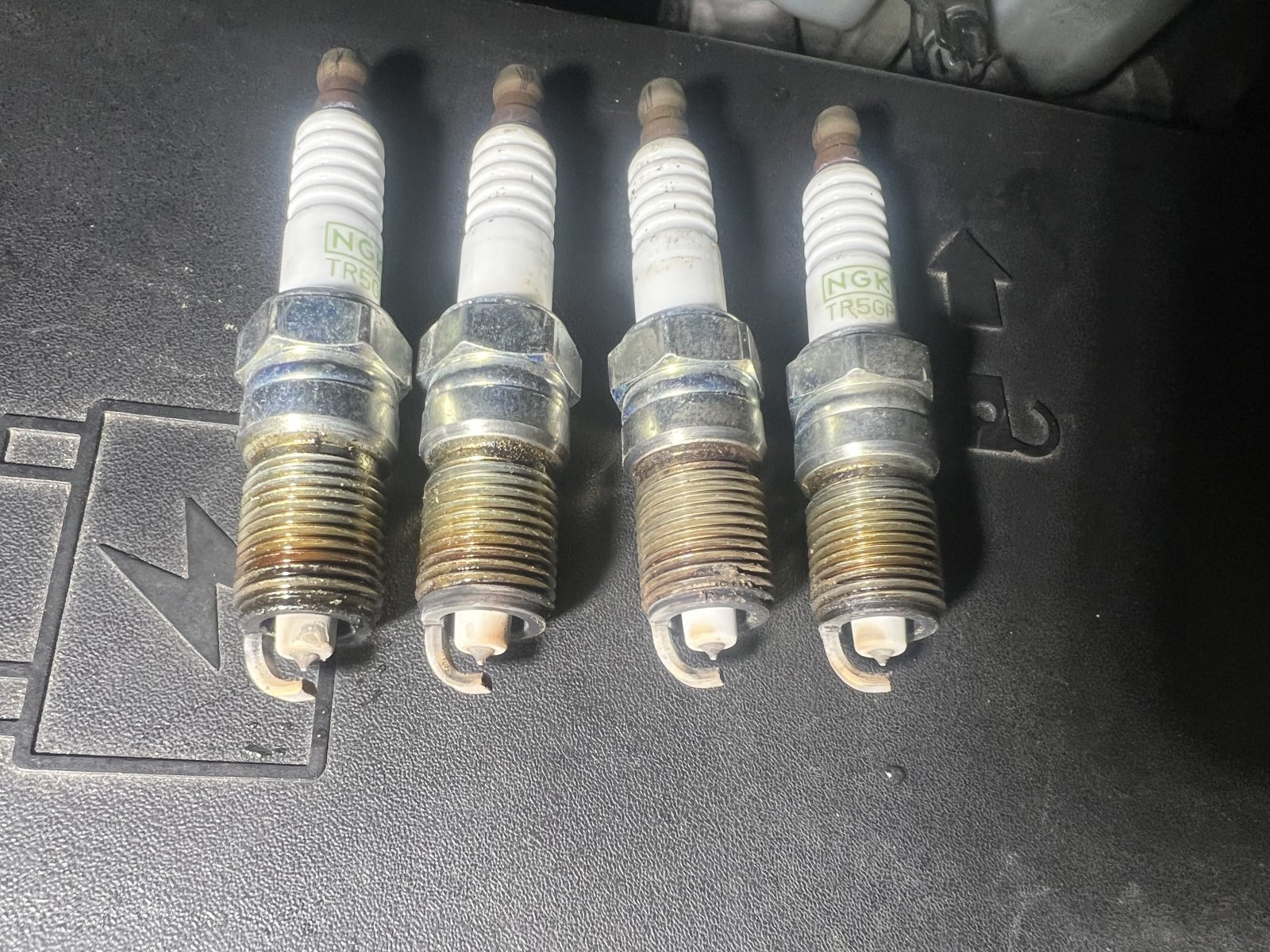

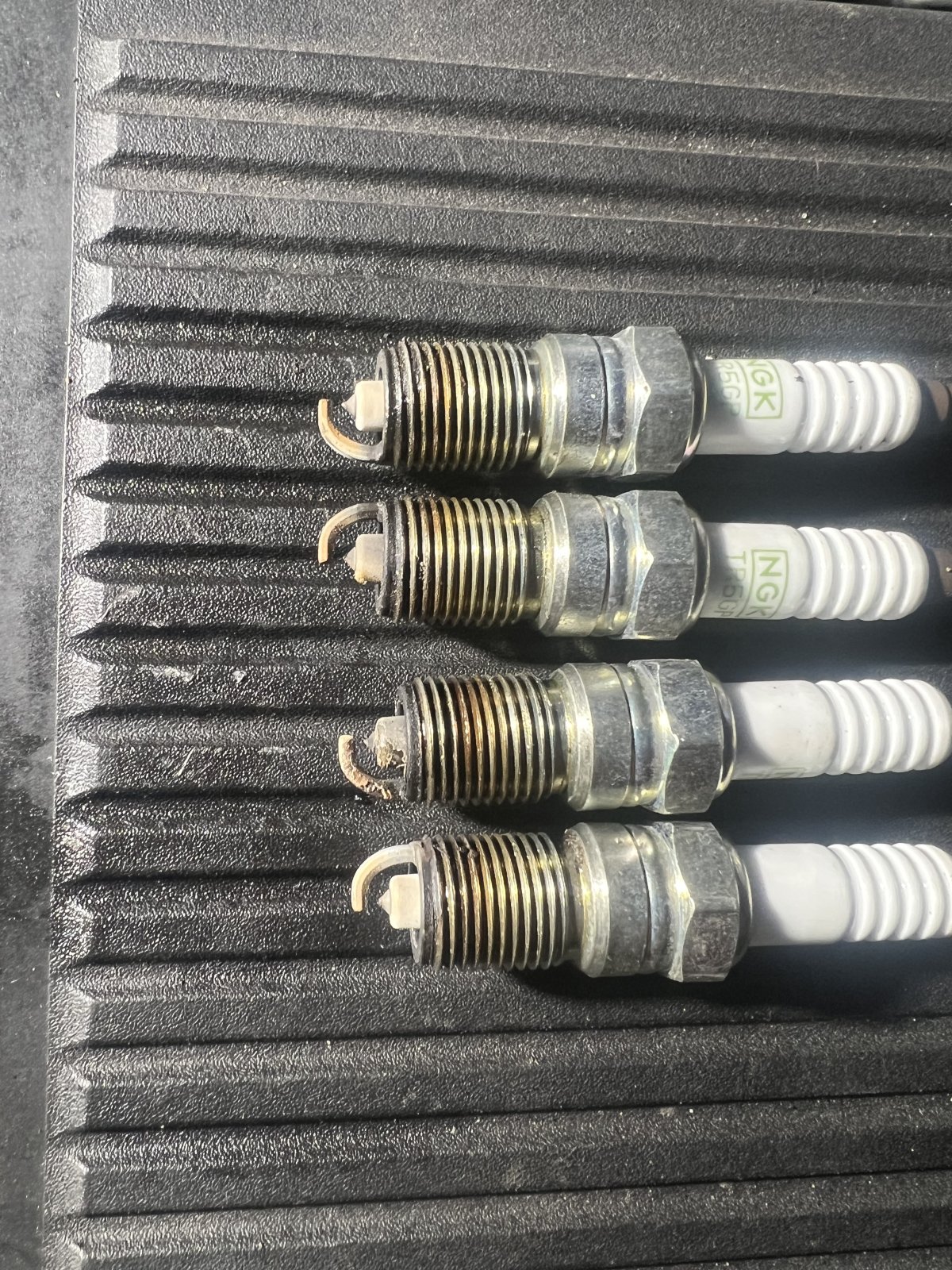

Also these spark plugs have 5k on them

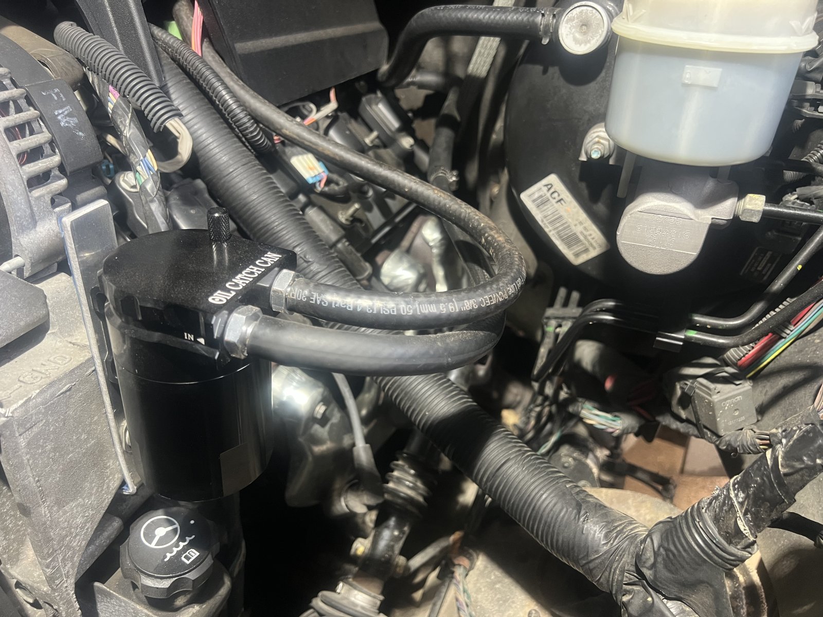

I put a pic of the catch can setup I think I’m going to switch the hoses around
I can't tell from your photo, but does the 'IN' hose go to the valve cover, and the 'OUT' hose for to the the intake manifold?

Yes that’s how it it routed. The problem is inside the can there is a screw on baffle over the port of the IN side that has some steel wool in it.
The other side that goes to the manifold is just open which would make it easy to suck up oil.

I would leave it as is. That bronze filter(?) on the in port will filter the incoming air and help to collect the oil mist. Once it's soaked with oil it drips out.
On the suction side the oil would get sucked into the engine. I would think anyway.

Point of a catch can is to give oil vapors space and time to condense and separate.
Hopefully the engine gets the fractions of the oil vapors (as well as fuel vapors) that remain gaseous when given a chance to cool,
while the oil vapor fractions that more easily condense to liquid get trapped by the catch can.
(Which is why catch cans should be WIDER, and should be protected from heat ...)

You're OK as you are. If you keep the catch can below 3/4 full, the captured oil is heavy enough that it won't get sucked upward in the catch can and into the intake manifold.

I’ll leave it like it is then.
