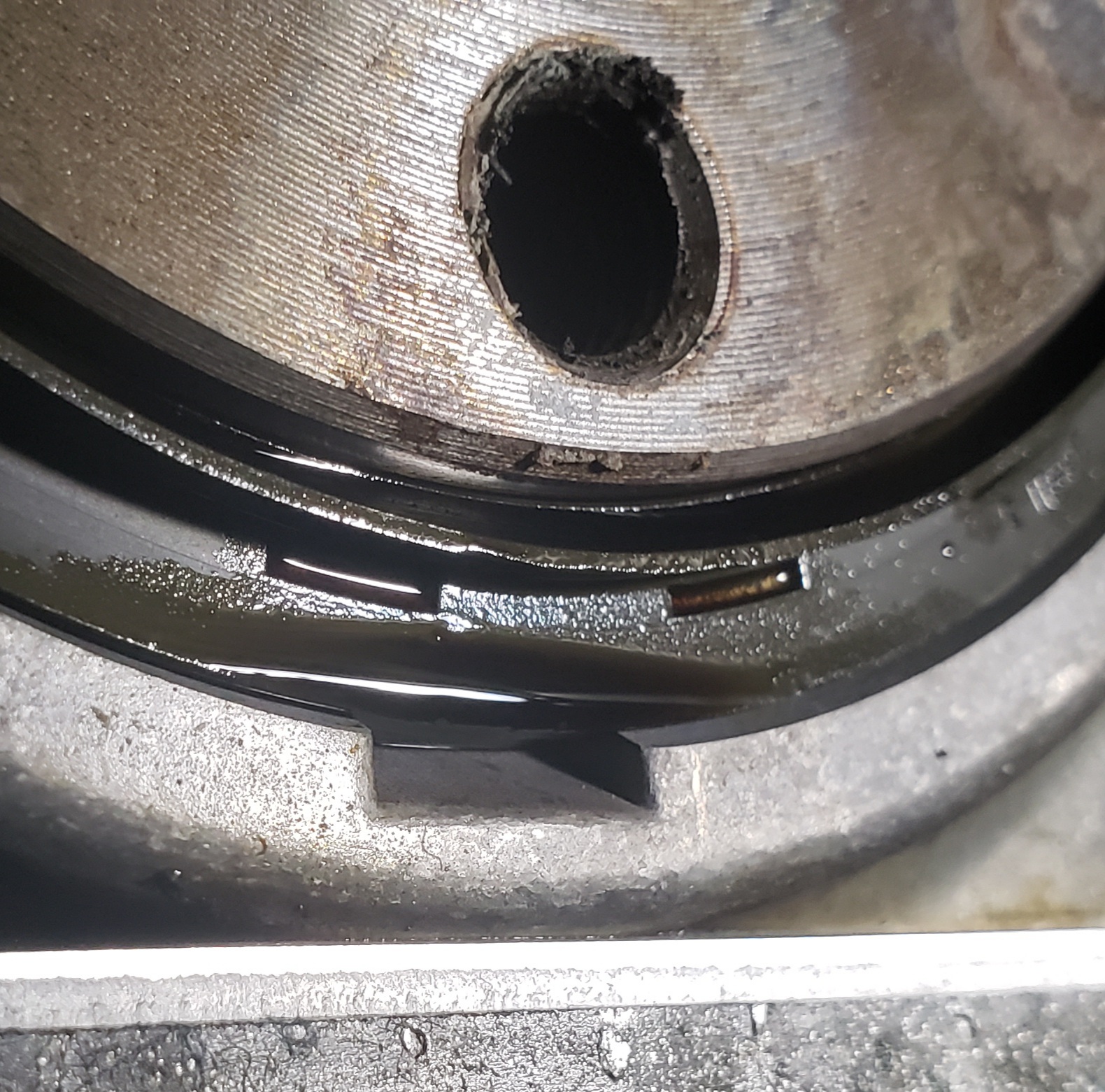

I know the leak is not from the oil pressure sensor, the valve cover gaskets or the oil cooler gasket. All have been replaced less than 6 months ago and all have been inspected showing no leaking.
As far as I know that leaves either the oil pan gasket, rear main seal or the rear cover gasket. How do you determine where the leak is actually from as the repair is different for both?

I think that is a tough one to determine..
Have heard of people looking through the bellhousing inspection cover, and using dye, and it's still hard to tell.
Seems like the rear cover leaks more often than the actual rear main seal.
I'm planning to do oilpan first.. but am not getting my hopes up in case it's the rear cover..

I have also read the rear cover gasket leaks more than the rear seal but the work is the same. Transmission has to come out to replace either. If you take it to a shop that's about $1200 to replace a $40 part.
I'm going to try this stuff first "AT 205". I have seen lots of positive videos using it and a very long thorough test that showed it does in fact soften the old seals and they return to the original size which just may seal it back up. For $20 I'll try it and cross my fingers. Pulling the transmission in my driveway in this Denali is about as much fun as pulling the fuel tank.

Before you use the AT 205 product, let's hear from @OR VietVet , as he recently referred to some product of pellets that work real well, and is used by GM.

The pellets stuff is the GM "pills" that GM uses for the cooling system.
AT 205 and other additives, IMO are snake oil. Nothing works better than the part/seal/gasket replacement and having a completely clean and dry sealing surface. If I am installing any part that has a rubber seal in place already, I use a very thin smear of "Blue Goo" on the surface of the seal to allow for seal movement during install and tensioning and it actually helps the sealing process as well. Not a gob of it, just a very light smear. Use GM parts where available.
I am completely convinced and know that some of the biggest reasons that there are oil leaks, is that way too many times, the vehicle owner pushes the oil change intervals because they believe some of the crap info that the oil companies use when selling. Use a good quality filter and IMO, change the "synthetic oil" every 4 months or 4k miles. If you use the dash cluster oil change reminder, good luck to you. If you believe the oil companies and think it is ok to go a tear or crazy miles in between oil changes, again, good luck to you.
The oil is the "blood of the engine". Oil changes are cheap compared to leak repairs and you can always know the price ahead of time.
Too many times I see people here and at other forums, BRAG about oil change intervals. IMO, they are just kidding themselves.

And often overlooked source is the VLOM plate, or valley cover plate gasket if you have AFM deleted.
Almost every VLOM plate I have removed has had at least four or five bolts loose.... Resulting in the leak at the rear of the engine up top.
I've never actually ran across the rear cover leaking. Usually it's been either the oil cooler line block, rear corners of the oil pan gasket or the rear main with a very slight leak, not enough to really drip, but it sure makes a mess

The way I look at is it will either stop the leaking or it won't. If it doesn't then I still have to fix it but for $20 it's worth the try.

The engine has many parts that lubricate through small holes, inserting stop leak into your oil system can plug holes needed to lubricate. I have never been a fan of oil system stop leaks.
In the past year I did the rear main seal on my 2003 and on the 2008 Denali 6.2L. It is great to finally have no oil leaks.
