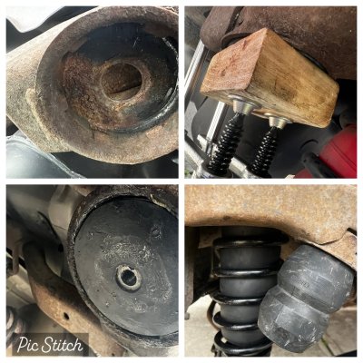

Got a pretty good deal on some Timbren bump stops from someone who never installed them.
Installed on a 2003 Tahoe Z71.
Had bump stop contact with LCA on driver side only prior to swap. Timbren are significantly taller.
Size comparison (front).
Installed:
Need to take it for a ride and have them settle in.
Have not replaced the rear ones yet.
Size comparison (rear).

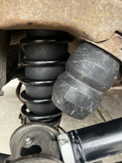

UPDATE —
Installed the rear bump stops a while back.
Rear suspension settled nicely when using a U-Haul auto transport.
Disassembled the bump stops to install it in the receiver cup on the frame. The instructions did not work… improvised..IMG_2769.jpeg
