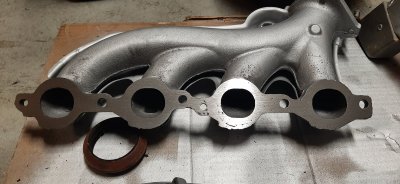

I finally got the short block fully assembled. Few things that threw me for a curve...
1. That stupid rear main seal. I am glad I pulled it off and did the RTV. I could push it out by hand with ease. Front one wasn't RTV'd but is in like a rock. I did however, get a little RTV on the lip of the seal. Hopefully doesn't hurt anything, I worked really hard to clean it off (see picture)
2. Stripped bolt in oil pump was no issue. I pulled it back out, cleaned the threads with a tap. Then put the bolt back on with proper torque spec and blue lock tight. Hopefully holds as good as if I didn't nothing wrong to begin with :eek:
3. Stupid exhaust manifold mistake haha. I used electrolysis to clean off rust before painting it but backwards for a little while. It pitted the manifold mating surfaces. I took a belt sander and sanded them down for about 30 minutes. Then checked for flatness was good to 10 thousands but 5 could start to slip through. I still have a bit of pitting in the surface. I'm not sure if that will cause a heat stress / air pockets and wear the gasket out?

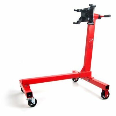

Lastly, Engine stand is top heavy. It wants to flip the head side down. Is there a trick to these to get them re adjusted? I feel like I've got the motor as low as it will go on the stand. Last motor I built on a cardboard box in my living room haha. Was a PITA but I got it done.

Your manifolds look nicely restored. As long as they mate to head with the gasket you'll be fine.
I think the speed engineering headers look good (future mod). Inexpensive for stainless and includes the cross over and flange.
Engine stand wants to flip over? Most have a cylinder in the back where they slide into a sleeve with holes.
That way the engine can be rotated for assembly. A pin inserted into a hole serves as a lock.
The handle in the back serves as a lever to rotate.
Hope that helps.....
